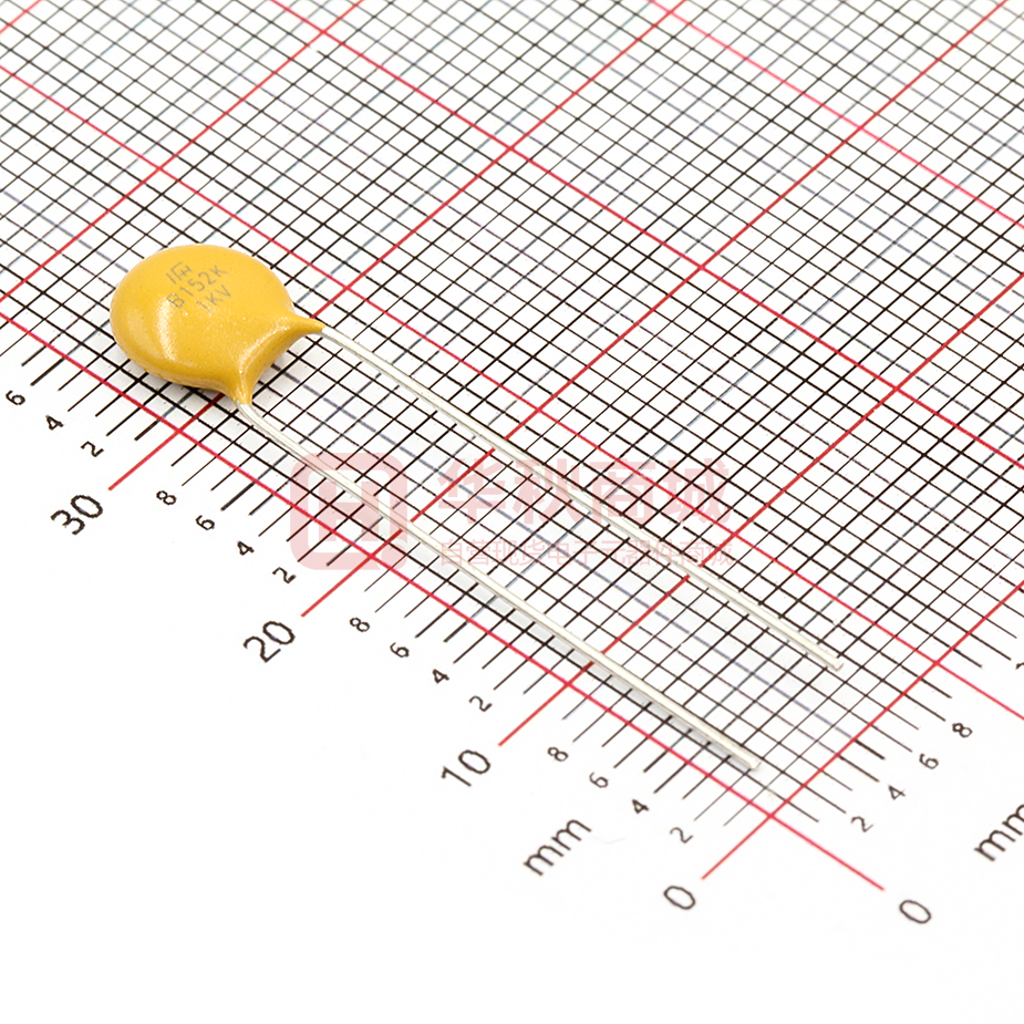

    直插陶瓷电容/独石电容 CAP_D7X3.5MM_TM 1.5nF ±10% 1KV Y5P
CT81-N7Y5P1B152KSEW 数据手册
CERAMIC DISC CAPACITOR Product Part Number Expression M 2 CT81 1 1 5 3 Y5V 4 5 5 B 6 102 7 M 8 T 9 E 10 Product Type Product Type Type code CC81 High voltage temperature compensation capacitor CT1 Low voltage high dielectric constant disk ceramic capacitor CT81 High voltage high dielectric constant disk ceramic capacitor CS1 Semiconductor disk ceramic capacitor CT7 Alternating current disk ceramic capacitor 2 Voltage Code F Code Rated Voltage 50V L N M 500V 1KV 2KV Q P 3KV 4KV S 6KV U W X Y 250 VAC 400VAC Z 8KV 10KV 15KV The Code Chip Diameter Range 3 Code 5 6 10 12 Diameter(mm) 4.5-5.4 5.5-6.4 9.5-10.4 11.5-12.4 4 ( EIA ) Temperature Characteristics ( temperature coefficient and EIA code): TemperatureCharacteristics USE code Temperature range EIA code Capacitance with temperature change rate NP0 C0H N750 U2J SL S2L Y5P Y5P Y5R Y5R Y5U Y5U +22/-56% Y5V Y5V +22/-82% 0 60PPM/ 750 120PPM/ +140~-1000PPM/ -25~-+85 10% 15% 207 5 Lead style Code lead Style 1 (16-28mm) Straight lead (16~28m) 3 short lead( cut the feet) 4 Tape straight lead 5 Tape small inside kink 6 Tape large inside kink Special Straight lead 7 6 9 Outside kink 0 vertical kink lead Lead Spacing B Code D 7.5 0.5 5.0 0.5 7 E K 10.0 0.5 12.5 0.5 Standard capacitance 100 10PF 560 56PF 821 820PF 102 1000PF ----- ----- pF 3 0 Note: The unit of standard capacitance if consisting of 3 digits, the first and second digits stand for effective value of the Standard capacitance;third digit indicates the number of zeros. 8 Capacitance Tolerance Code Tolerance 9 K 10% Z 20% +80%~-20% Packing style Code Packing style 10 M S T bulk Taping Coating style code Coating style E P Epoxy resin 208 Phenol resin CERAMIC DISC CAPACITOR Product Structure and Overall Dimensions Lead shape 209 Packing style Bulk Taping products Taping products ( P 0 =12.7mm F=5.0mm,F=7.5mm) Taping products(P 0 =15.0mm,F=7.5mm) Taping products(P 0 =15.0mm,F=10.0mm) 210 CERAMIC DISC CAPACITOR Packing style products paking Packing style Lead spacing F=5.0 Bulk F=7.5 Bulk Taping(P0=12.7mm D
