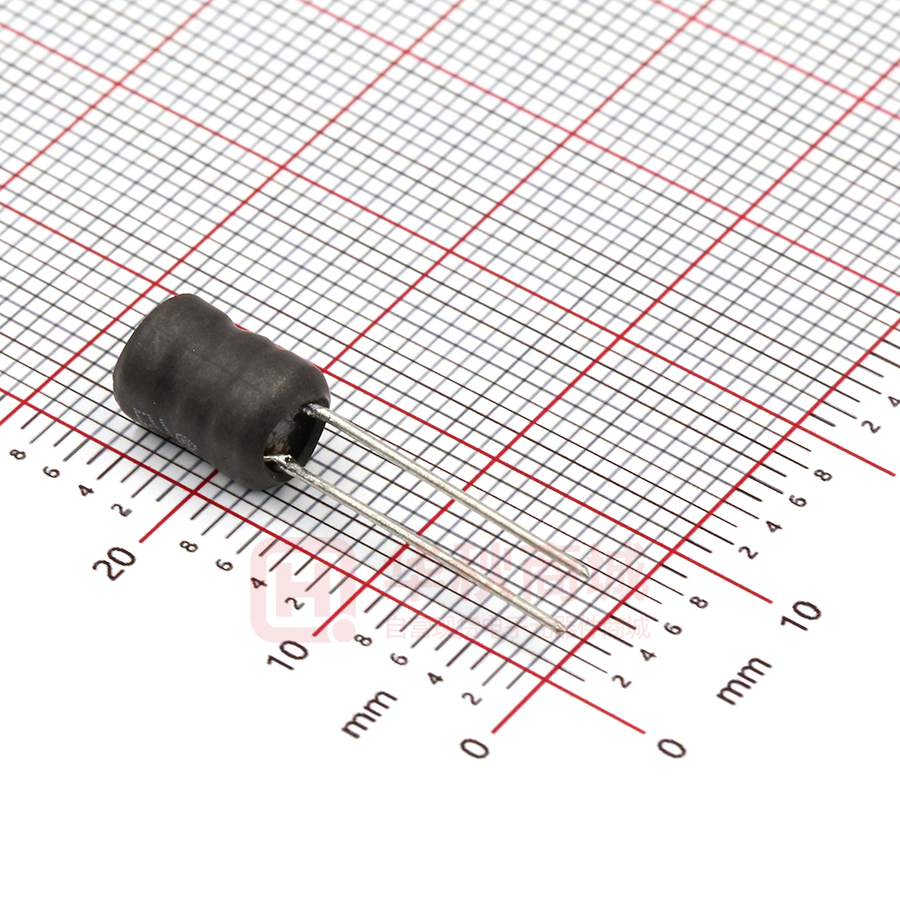

    功率电感 330µH ±10% IND_D8X10MM_TM 10.00mm Φ8.00 x 10.00mm - -
VLU0608-331KB 数据手册
VL VL TYPE VERTICAL FIXED INDUCTORS HOW TO ORDER FOR EXAMPLE VL U 0608 220 K P A B C D E F B A Envelopment configuration Product type UL UL sleeve U B Resin VL Vertical fixed inductor PET PET sleeve P M Magnetic shielding C D Dimensions(mm) Nominal inductance( H) Type Cmax 0406 4.5 7.0 0608 8.0 10.0 0810 10.5 12.5 0912 12.0 14.5 1012 12.5 14.5 Amax The first two digits are significant, and the third digit is number of zero For example 101=100 H 5R6=5.6 H R22=0.22 H F E Packaging style Tolerance J 5.0% K 10% M 20% F P 154 Bulk Tape VL VL TYPE VERTICAL FIXED INDUCTORS ( ) STRUCTURE(EXTERNAL DIIMENSIONS) d c P A B Dimensions(mm) Type C(max) A(max) B(min) P d 0406 4.5 7.0 15.0 0.50 0.05 2.0 1.0 0608 8.0 10.0 15.0 0.60 0.05 2.5 1.0 0810 10.5 12.5 15.0 0.60 0.05 3.5 1.5 0912 12.0 14.5 15.0 0.65 0.05 5.0 1.5 1012 12.5 14.5 15.0 0.65 0.05 6.0 1.5 # The products can be customized according to customer requirement. & PACKAGING STYLE&QUANTITYE Codel Dim. Tol. P0 P1 P2 d 12.7 12.7 3.85 6.35 0.6 1.0 0.2 0.7 0.4 P 0.1 h 0 1.0 W W0 W1 W2 H0 H1 D0 I F 18.5 12 9 1.5 15-20 35.0 4.0 1.4 5.0 0.5 Max 1.0 1.0 1.0 1.5 Bulk Packaging styie Quantity 200pcs # Packaging according to customer's requirement 155 1500pcs 0.2 Max 0.8
