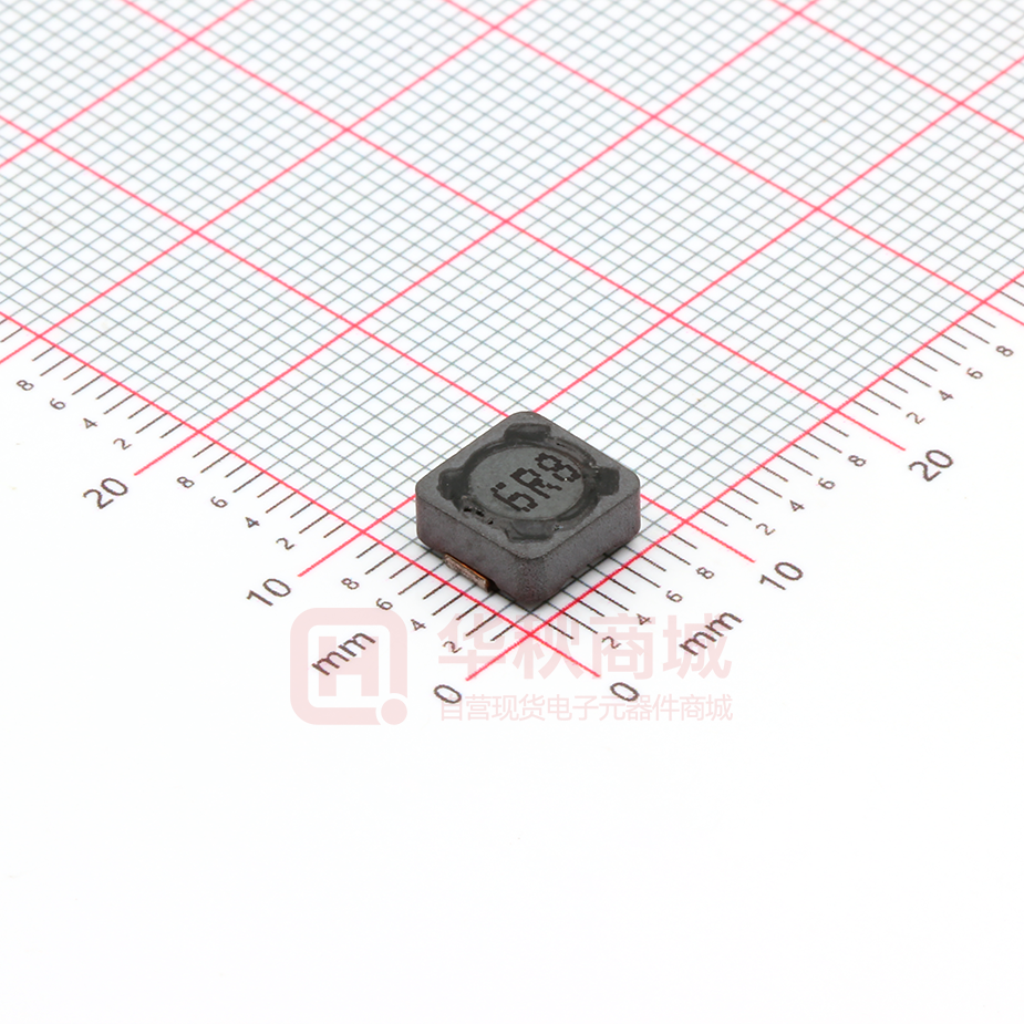

    功率电感 6.8µH ±20% 65mΩ IND_7.3X7.3MM_SM
YPRH0703-6R8M 数据手册
SMD Power Inductors -YPRH0703 Series ■ Features ● High current type. ● Ferrite bobbin core and compact size. ● Low core loss for high frequency power application. ● Large terminal surface for good PCB bonding. ● Operating temperature:-40℃ ~ +125℃. ■ Applications ● Portable communication equipment. ● Notebook PC,digital camera,LCD television set. ● Power supply for VTR,OA equipment. ● DC/DC converters. ■ Product Identification ⑴ :Type ⑵ :Dimensions ⑶ :Inductance value ⑷ :Inductance Tolerance;N=±30%,M=±20%,K=±10% ■ Shapes and Dimensions (Unit:mm) TYPE A B C max D E F Ref. G Ref. H Ref. YPRH0703 7.30±0.5 7.30±0.5 3.5 5.40±0.2 1.8 1.6 4.8 2.2 深圳市益嘉源电子有限公司 http://www.yjycoin.com Tel:0755-27803896 Fax:0755-27803897 -1- SMD Power Inductors -YPRH0703 Series ■ YPRH0703 Series Part Number Inductance (uH) L Test Frequency Max.DC Resistance MAX.Rated Current (KHz) (Ω) (A) YPRH0703-R33□ 0.33 100 0.059 6.94 YPRH0703-1R0□ 1.00 100 0.018 5.20 YPRH0703-1R2□ 1.20 100 0.020 4.20 YPRH0703-2R2□ 2.20 100 0.025 3.50 YPRH0703-3R3□ 3.30 100 0.035 2.50 YPRH0703-4R7□ 4.70 100 0.038 2.26 YPRH0703-6R8□ 6.80 100 0.065 1.81 YPRH0703-100□ 10.0 100 0.072 1.68 YPRH0703-120□ 12.0 100 0.098 1.52 YPRH0703-150□ 15.0 100 0.130 1.33 YPRH0703-180□ 18.0 100 0.140 1.20 YPRH0703-220□ 22.0 100 0.190 1.07 YPRH0703-270□ 27.0 100 0.210 0.96 YPRH0703-330□ 33.0 100 0.240 0.91 YPRH0703-390□ 39.0 100 0.320 0.77 YPRH0703-470□ 47.0 100 0.360 0.76 YPRH0703-560□ 56.0 100 0.470 0.68 YPRH0703-680□ 68.0 100 0.520 0.61 YPRH0703-820□ 82.0 100 0.690 0.57 YPRH0703-101□ 100 100 0.790 0.50 YPRH0703-121□ 120 100 0.890 0.49 YPRH0703-151□ 150 100 1.270 0.43 YPRH0703-181□ 180 100 1.450 0.39 YPRH0703-221□ 220 100 1.650 0.35 YPRH0703-271□ 270 100 2.310 0.32 深圳市益嘉源电子有限公司 http://www.yjycoin.com Tel:0755-27803896 Fax:0755-27803897 -2- SMD Power Inductors -YPRH0703 Series Part Number Inductance (uH) L Test Frequency Max.DC Resistance MAX.Rated Current (KHz) (Ω) (A) YPRH0703-331□ 330 100 2.620 0.28 YPRH0703-391□ 390 100 2.940 0.26 YPRH0703-471□ 470 100 4.180 0.24 YPRH0703-561□ 560 100 4.670 0.22 YPRH0703-681□ 680 100 5.730 0.19 YPRH0703-821□ 820 100 6.540 0.18 YPRH0703-102□ 1000 100 9.440 0.16 ※ The saturation current value is the DC current value having inductance decrease down to 30%.(at 20℃) ※ The temperature rise current value is the DC current value having temperature increase up to 40℃. (at 20℃) ※ The rated current is the DC current value that satisfies both of current value saturation current value and temperature rise current value. 深圳市益嘉源电子有限公司 http://www.yjycoin.com Tel:0755-27803896 Fax:0755-27803897 -3- SMD Power Inductors -YPRH0703 Series ■ Taping Dimensions(Unit:mm) TYPE MPQ W A B C D E P K T YPRH0703 1000 16±0.3 7.7±0.1 7.7±0.1 6.75 7.5±0.1 3.65±0.1 12±0.1 3.85 Ref 0.35±0.05 ■ Reel Dimensions(Unit:mm) TYPE W W1 W2 W3 A B C D YPRH0703 330±2.00 16.4±1.50 22.40 Max 15.90 Min 13.0±0.50 21.0±0.80 2.0±0.50 100 Min 深圳市益嘉源电子有限公司 http://www.yjycoin.com Tel:0755-27803896 Fax:0755-27803897 -4- SMD Power Inductors -YPRH0703 Series ■ Direction of rolling ■ Cover tape peel off condition Cover tape peel force shall be 0.1N to 1.3N. Reference peel speed 300±10mm/min. 深圳市益嘉源电子有限公司 http://www.yjycoin.com Tel:0755-27803896 Fax:0755-27803897 -5-
