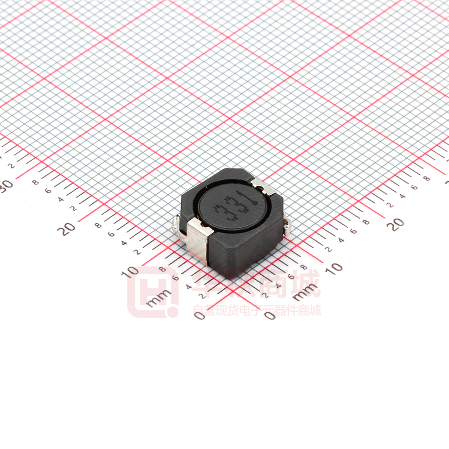

SMD Power Inductors
-YPRH105R Series
■ Features
● Ultra low profile.
● Magnetic shielded for low radiation.
● Bobbin ferrite core and compact size.
● Low core loss for high frequency power application.
● Large terminal surface for good PCB bonding.
● Operating temperature:-40℃ ~ +125℃.
■ Applications
● Portable communication equipment.
● Notebook PC,digital camera,LCD television set.
● Power supply for VTR,OA equipment.
● DC/DC converters.
■ Product Identification
⑴ :Type
⑵ :Dimensions
⑶ :Inductance value
⑷ :Inductance Tolerance;N=±30%,M=±20%,K=±10%
■ Shapes and Dimensions (Unit:mm)
TYPE
A
B
C max
D
E
F Ref.
G Ref.
H Ref.
YPRH105R
10.2±0.3
10.0±0.3
4.8±0.3
3.0
1.2
1.6
7.3
