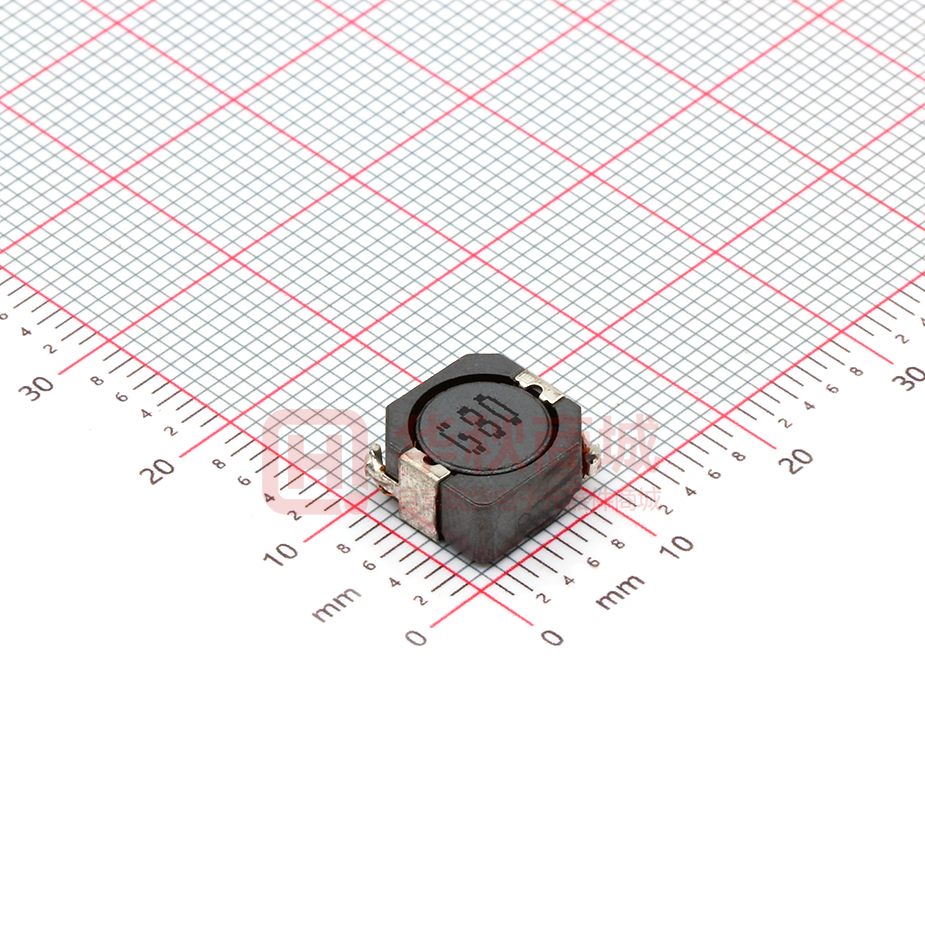

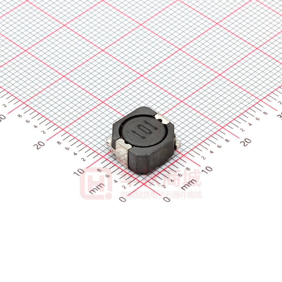

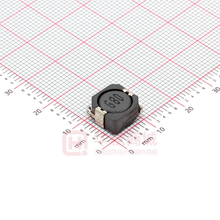

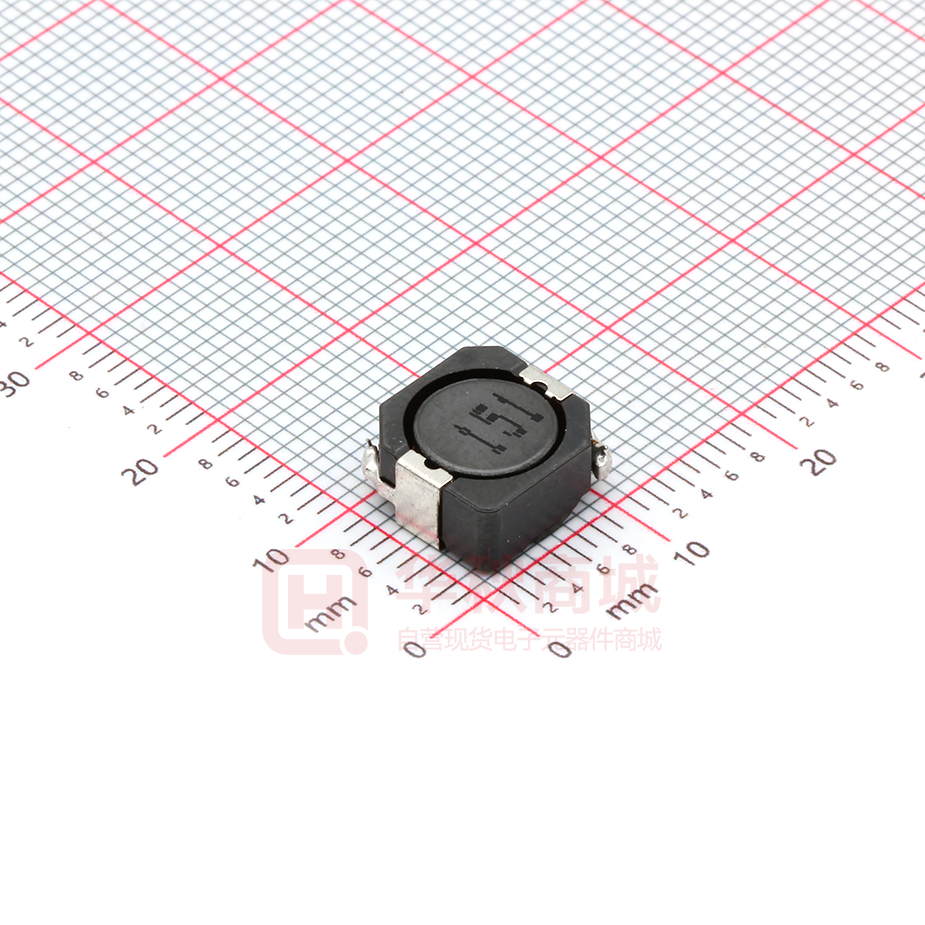

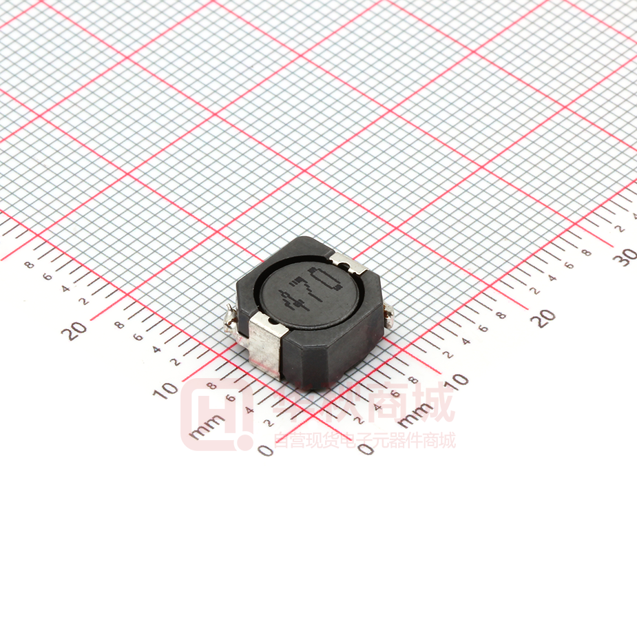

SMD Power Inductors -YPRH105R Series ■ Features ● Ultra low profile. ● Magnetic shielded for low radiation. ● Bobbin ferrite core and compact size. ● Low core loss for high frequency power application. ● Large terminal surface for good PCB bonding. ● Operating temperature:-40℃ ~ +125℃. ■ Applications ● Portable communication equipment. ● Notebook PC,digital camera,LCD television set. ● Power supply for VTR,OA equipment. ● DC/DC converters. ■ Product Identification ⑴ :Type ⑵ :Dimensions ⑶ :Inductance value ⑷ :Inductance Tolerance;N=±30%,M=±20%,K=±10% ■ Shapes and Dimensions (Unit:mm) TYPE A B C max D E F Ref. G Ref. H Ref. YPRH105R 10.2±0.3 10.0±0.3 4.8±0.3 3.0 1.2 1.6 7.3 3.2 深圳市益嘉源电子有限公司 http://www.yjysmd.com.cn Tel:0755-27803896 Fax:0755-27803897 -1- SMD Power Inductors -YPRH105R Series ■ YPRH105R Series Part Number Inductance (uH) Test Freq. DCR MAX. Saturation Heat Rating (KHz) (Ω) Current (A) Current (A) YPRH105R-R80□ 0.80 100 0.005 9.50 13.50 YPRH105R-1R5□ 1.50 100 0.006 8.30 10.50 YPRH105R-2R2□ 2.20 100 0.008 7.50 9.25 YPRH105R-3R3□ 3.30 100 0.011 6.50 7.80 YPRH105R-4R7□ 4.70 100 0.013 6.10 6.40 YPRH105R-6R8□ 6.80 100 0.018 5.40 5.40 YPRH105R-8R2□ 8.20 100 0.020 5.00 4.85 YPRH105R-100□ 10.0 100 0.026 4.50 4.45 YPRH105R-120□ 12.0 100 0.033 3.80 4.00 YPRH105R-150□ 15.0 100 0.041 3.40 3.60 YPRH105R-180□ 18.0 100 0.046 3.10 3.20 YPRH105R-220□ 22.0 100 0.061 2.90 2.95 YPRH105R-270□ 27.0 100 0.069 2.60 2.70 YPRH105R-330□ 33.0 100 0.084 2.50 2.40 YPRH105R-390□ 39.0 100 0.106 2.25 2.30 YPRH105R-470□ 47.0 100 0.130 2.00 2.00 YPRH105R-560□ 56.0 100 0.149 1.90 1.90 YPRH105R-680□ 68.0 100 0.201 1.60 1.65 YPRH105R-820□ 82.0 100 0.227 1.45 1.50 YPRH105R-101□ 100 100 0.253 1.35 1.35 YPRH105R-121□ 120 100 0.303 1.18 1.28 YPRH105R-151□ 150 100 0.370 1.10 1.12 YPRH105R-181□ 180 100 0.419 1.00 1.04 YPRH105R-221□ 220 100 0.500 0.94 0.94 YPRH105R-271□ 270 100 0.672 0.80 0.84 深圳市益嘉源电子有限公司 http://www.yjysmd.com.cn Tel:0755-27803896 Fax:0755-27803897 -2- SMD Power Inductors -YPRH105R Series Part Number Inductance (uH) Test Freq. DCR MAX. Saturation Heat Rating (KHz) (Ω) Current (A) Current (A) YPRH105R-331□ 330 100 0.812 0.73 0.75 YPRH105R-391□ 390 100 0.953 0.70 0.70 YPRH105R-471□ 470 100 1.289 0.54 0.60 YPRH105R-561□ 560 100 1.430 0.52 0.54 YPRH105R-681□ 680 100 1.599 0.51 0.52 YPRH105R-821□ 820 100 1.768 0.48 0.50 YPRH105R-102□ 1000 100 1.989 0.42 0.48 ※ The saturation current value is the DC current value having inductance decrease down to 30%.(at 20℃) ※ The temperature rise current value is the DC current value having temperature increase up to 40℃. (at 20℃) ※ The rated current is the DC current value that satisfies both of current value saturation current value and temperature rise current value. 深圳市益嘉源电子有限公司 http://www.yjysmd.com.cn Tel:0755-27803896 Fax:0755-27803897 -3- SMD Power Inductors -YPRH105R Series ■ Taping Dimensions(Unit:mm) TYPE W A B C D E P K Ref T MPQ YPRH105R 24±0.3 10.8±0.1 10.8±0.1 10.75 11.5±0.1 4.75±0.1 16±0.1 4.95 0.35±0.05 800 ■ Reel Dimensions(Unit:mm) TYPE W W1 W2 W3 A B C D YPRH105R 330±2.0 24.4±1.50 30.4MAX 23.9 Min 13.0±0.50 21.0±0.80 2.0±0.50 100 Min 深圳市益嘉源电子有限公司 http://www.yjysmd.com.cn Tel:0755-27803896 Fax:0755-27803897 -4- SMD Power Inductors -YPRH105R Series ■ Direction of rolling ■ Cover tape peel off condition Cover tape peel force shall be 0.1N to 1.3N. Reference peel speed 300±10mm/min. 深圳市益嘉源电子有限公司 http://www.yjysmd.com.cn Tel:0755-27803896 Fax:0755-27803897 -5-
