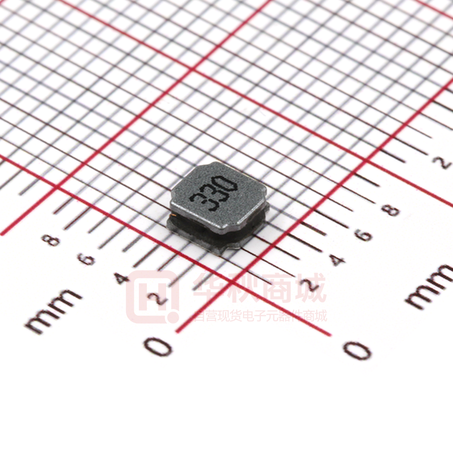

PRS
PRS SERIES SMD POWER INDUCTORS
FEATURES
Low profile.
Magnetic shielde construction.
SMT type.
APPLICATION
Mobile Phone,PDA ,LCD display etc.
DC/DC converters etc.
DC/DC
ORDERING CODE
8040
PRS
M
150
(L
Product Code
T
W T)
(mm)
