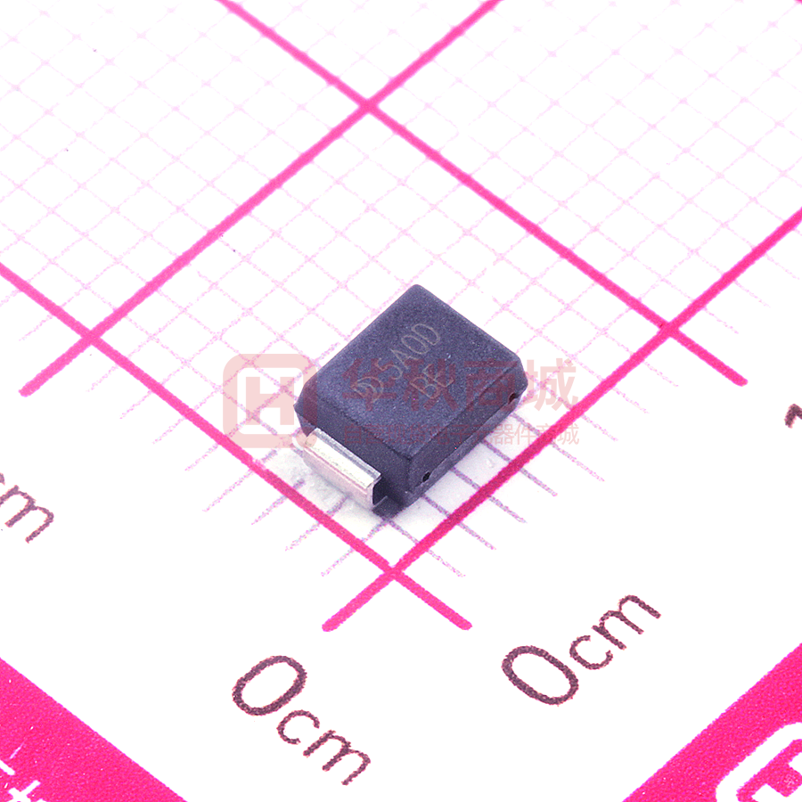

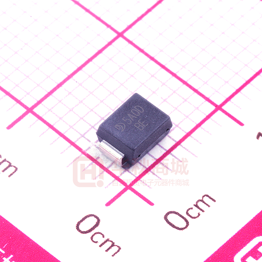

SMBJ12CA
SMBJ12CA
    JINGDAO(晶导微电子)
    SMB(DO-214AA)
    ESD抑制器/TVS二极管 Vrrm=12V Vbr(min)=13.3V Vc=19.9V@Ipp =30.2A
SMBJ12CA 数据手册
山东晶导微电子有限公司 SMBJ Series Jingdao Microelectronics Surface mount transient voltage suppressor power 600 watts Stand-Off Voltage:5.0V~440V FEATURES • For surface mounted applications in order to optimize board space. • Low profile package • Glass passivated junction • Low inductance • Plastic package has Underwriters Laboratory Flammability PINNING PIN DESCRIPTION 1 Cathode 2 Anode Unipolar MECHANICAL DATA • Case: SMB • Terminals: Solderable per MIL-STD-750, Method 2026 • A pprox. Weight: 0.055g / 0.002oz Bipolar Simplified outline SMB and symbol Maximum Ratings and Electrical characteristics Ratings at 25 °C ambient temperature unless otherwise specified. Parameter Peak Pulse Power Dissipation on 10/1000 s waveform ( Note1,Note2, Fig.1). Symbol Value Unit P PPM 600 W 100 A Peak Forward Surge Current,8.3ms Single Half Sine-Wave Superimposed on Rated Load, (JEDEC Method) (Note 3,Fig4). (UNI) Peak Pulse Current on 10/1000 us waveform (Note 1, Fig 3) I PPM see Table 1 A Typical Junction capacitance at VR=4V, f=1MHz CJ 390 pF I FSM V ESD1 V ESD2 30 30 kV Typical Thermal Resistance Junction to Ambient(Note 2) RθJA 100 °C/W Operating Junction Temperature and Storage Temperature Range T j , T stg -65 ~ +150 °C Contact Air ESD Voltage per IEC6100-4-2 NOTES: 1. Non-repetitive current pulse, per Fig.3 and derated above T A = 25°C per Fig. 2. 2 2. Mounted on 5 mm (0.13mm thick) land areas. 3. Measured on 8.3ms,single half sine-wave or equivalent square wave,duty cycle=4 pulses per minute maximum. 4. Peak pulse power waveform is 10/1000μS. 2017.01 SMB-TVS-SMBJ Series -600W Page 1 of 5 Characteristics at Ta = 25°C Reverse Stand-off Voltage Type UNI Table 1 BI Breakdown Voltage Test Current V BR @ I T Maximum IT Reverse Leakage V mA μA V RMW Min Max V V Package Max. Clamp Peak Pulse Voltage Current V C @ I PP V SMB I PP Device Marking Ccode A UNI BI 600W Transient Voltage Suppresso SMBJ5.0A SMBJ5.0CA 5 6.4 7 10 800 9.2 65.3 KE AE SMBJ6.0A SMBJ6.0CA 6 6.67 7.37 10 800 10.3 58.3 KG AG SMBJ6.5A SMBJ6.5CA 6.5 7.22 7.98 10 500 11.2 53.6 KK AK AM SMBJ7.0A SMBJ7.0CA 7 7.78 8.6 10 200 12.0 50.0 KM SMBJ7.5A SMBJ7.5CA 7.5 8.33 9.21 1 100 12.9 46.6 KP AP SMBJ8.0A SMBJ8.0CA 8 8.89 9.83 1 50 13.6 44.2 KR AR SMBJ8.5A SMBJ8.5CA 8.5 9.44 10.4 1 20 14.4 41.7 KT AT SMBJ9.0A SMBJ9.0CA 9 10 11.1 1 10 15.4 39.0 KV AV SMBJ10A SMBJ10CA 10 11.1 12.3 1 5 17.0 35.3 KX AX SMBJ11A SMBJ11CA 11 12.2 13.5 1 1 18.2 33.0 KZ AZ SMBJ12A SMBJ12CA 12 13.3 14.7 1 1 19.9 30.2 LE BE SMBJ13A SMBJ13CA 13 14.4 15.9 1 1 21.5 28.0 LG BG SMBJ14A SMBJ14CA 14 15.6 17.2 1 1 23.2 25.9 LK BK SMBJ15A SMBJ15CA 15 16.7 18.5 1 1 24.4 24.6 LM BM SMBJ16A SMBJ16CA 16 17.8 19.7 1 1 26.0 23.1 LP BP SMBJ17A SMBJ17CA 17 18.9 20.9 1 1 27.6 21.8 LR BR SMBJ18A SMBJ18CA 18 20 22.1 1 1 29.2 20.6 LT BT SMBJ20A SMBJ20CA 20 22.2 24.5 1 1 32.4 18.6 LV BV SMBJ22A SMBJ22CA 22 24.4 26.9 1 1 35.5 16.9 LX BX SMBJ24A SMBJ24CA 24 26.7 29.5 1 1 38.9 15.5 LZ BZ SMBJ26A SMBJ26CA 26 28.9 31.9 1 1 42.1 14.3 ME CE SMBJ28A SMBJ28CA 28 31.1 34.4 1 1 45.4 13.3 MG CG SMBJ30A SMBJ30CA 30 33.3 36.8 1 1 48.4 12.4 MK CK SMBJ33A SMBJ33CA 33 36.7 40.6 1 1 53.3 11.3 MM CM SMBJ36A SMBJ36CA 36 40 44.2 1 1 58.1 10.4 MP CP MR CR SMBJ40A SMBJ40CA 40 44.4 49.1 1 1 64.5 9.3 SMBJ43A SMBJ43CA 43 47.8 52.8 1 1 69.4 8.7 MT CT SMBJ45A SMBJ45CA 45 50 55.3 1 1 72.7 8.3 MV CV SMBJ48A SMBJ48CA 48 53.3 58.9 1 1 77.4 7.8 MX CX SMBJ51A SMBJ51CA 51 56.7 62.7 1 1 82.4 7.3 MZ CZ SMBJ54A SMBJ54CA 54 60 66.3 1 1 87.1 6.9 NE DE DG SMBJ58A SMBJ58CA 58 64.4 71.2 1 1 93.6 6.5 NG SMBJ60A SMBJ60CA 60 66.7 73.7 1 1 96.8 6.2 NK DK SMBJ64A SMBJ64CA 64 71.1 78.6 1 1 103.0 5.9 NM DM SMBJ70A SMBJ70CA 70 77.8 86 1 1 113.0 5.3 NP DP SMBJ75A SMBJ75CA 75 83.3 92.1 1 1 121.0 5.0 NR DR SMBJ78A SMBJ78CA 78 86.7 95.8 1 1 126.0 4.8 NT DT SMBJ85A SMBJ85CA 85 94.4 104 1 1 137.0 4.4 NV DV SMBJ90A SMBJ90CA 90 100 111 1 1 146.0 4.1 NX DX SMBJ100A SMBJ100CA 100 111 123 1 1 162.0 3.7 NZ DZ SMBJ110A SMBJ110CA 110 122 135 1 1 177.0 3.4 PE EE SMBJ120A SMBJ120CA 120 133 147 1 1 193.0 3.1 PG EG SMBJ130A SMBJ130CA 130 144 159 1 1 209.0 2.9 PK EK SMBJ150A SMBJ150CA 150 167 185 1 1 243.0 2.5 PM EM SMBJ160A SMBJ160CA 160 178 197 1 1 259.0 2.3 PP EP ER SMBJ170A SMBJ170CA 170 189 209 1 1 275.0 2.2 PR SMBJ180A SMBJ180CA 180 201 222 1 1 292.0 2.1 PT ET SMBJ188A SMBJ188CA 188 209 231 1 1 304.0 2.0 PB EB SMBJ200A SMBJ200CA 200 224 247 1 1 324.0 1.9 PV EV SMBJ220A SMBJ220CA 220 246 272 1 1 356.0 1.7 PX EX SMBJ250A SMBJ250CA 250 279 309 1 1 405.0 1.5 PZ EZ SMBJ300A* SMBJ300CA* 300 335 371 1 1 486.0 1.3 QE FE SMBJ350A* SMBJ350CA* 350 391 432 1 1 567.0 1.1 QG FG SMBJ400A* SMBJ400CA* 400 447 494 1 1 648.0 0.9 QK FK SMBJ440A* SMBJ440CA* 440 492 543 1 1 713.0 0.9 QM FM 山东晶导微电子有限公司 SMBJ Series Jingdao Microelectronics Fig.2 Forward Current Derating Curve 100 Non-Repetive Pulse.Wavefom Shown in Figure.3 T A=25°C 10 1.0 0.1 0.1 1 10 100 1000 10000 PEAK PULSE POWER(PPP)OR CURRENT(Ipp) DERATINGIN PERCENTAGE% P PPM ,PEAK PULSE FORWARD ,kW Fig.1 Peak Pulse Power Rating Curve 100 80 60 40 20 0 25 I ppm ,Peak Pulse Current (%) Peak Value Pulse Width (td) is Defined as the Point where the Peak. Current Decayst to 50% of Ipp I ppm 80 Half Value-I pp /2 60 10/1000usec Waveform as Defined bye R.E.A. 40 20 0 0 1.0 2.0 3.0 4.0 I FSM ,PEAK FORWARD SURGE CURRENT, AMPERES T A =25°C 100 125 150 175 120 100 80 60 40 20 T,TIME,ms 2017.01 100 Fig.4 Maximum Non-Repetitive Peak Forward Surge Current Fig.3 Pulse Waveform t f =10usec 75 T A ,AMBIENT TEMPERATURE,°C td,PULSE WIDTH ,us 120 50 T J =T J max 8.3ms Single Half Sinepwave JEDEC Method 0 1 10 100 Number of Cycles at 60Hz www.sdjingdao.com Page 4 of 5 山东晶导微电子有限公司 SMBJ Series Jingdao Microelectronics PACKAGE OUTLINE SMB Plastic surface mounted package; 2 leads L A A1 C A b D E E1 VM A SMB mechanical data UNIT mm mil A1 L C b 5.59 0.20 1.5 0.305 2.11 3.3 5.08 0.05 0.8 0.152 1.91 155 220 7.9 59 12 83 200 2.0 32 6 75 E1 A E D max 2.44 4.70 3.94 min 2.13 4.06 max 96 185 min 84 160 130 The recommended mounting pad size 2.2 (86) 2.4 (94) 2.8 (110) 2.4 (94) mm Unit : (mil) 2017.01 www.sdjingdao.com Page 5 of 5
