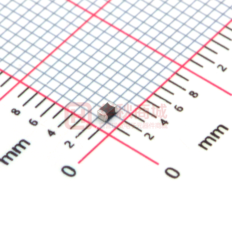

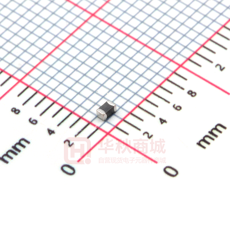

    功率电感 2.2μH ±20% 300mΩ 0603 40MHz
MPL1608S2R2MHT 数据手册
Multilayer Chip Power Inductor – MPL Series Operating Temp. : -40℃~+85℃ FEATURES High DC bias current due to developed material Low DC resistance Low profile and thin thickness Monolithic structure for high reliability Excellent solderability and high heat resistance No cross coupling due to magnetic shield ● ● ● ● ● ● APPLICATIONS DC-DC converter circuits for mobile phones, DSCs, DVCs, HDDs, PDAs, etc. ● PRODUCT IDENTIFICATION MPL 2012 S 2R2 M ① ② ③ ④ ⑤ H ⑥ ② ① MPL Chip Power Inductor ③ Feature Type S L C 1608 [0603] 1.6×0.8 2012 [0805] 2.0×1.25 2016 [0806] 2.0×1.6 2520 [1008] 2.5×2.0 Nominal Inductance Example Nominal Value R47 0.47μH 4R7 4.7μH ⑥ (Internal Code) ⑤ ⑦ T ⑦ ④ External Dimensions (L×W) (mm) Type T D H W Y Inductance Tolerance M ±20% N ±30% Packing Tape & Reel Thickness 0.5mm 0.9mm 1.1mm 1.25mm SHAPE AND DIMENSIONS Unit: mm [inch] Sunlord Type L W 1608 [0603] 1.6±0.15 [.063±.006] 0.8±0.15 [.031±.006] 2012 [0805] 2.0 (+0.3, -0.1) [.079 (+.012, -.004)] 1.25±0.2 [.049±.008] 2016 [0806] 2.0 (+0.3, -0.1) [.079 (+.012, -.004)] 1.6±0.2 [.063±.008] 2520 [1008] 2.5±0.2 [.098±.008] 2.0 (+0.3, -0.1) [.079 (+.012, -.004)] T 0.5±0.1 [.020±.004] 0.8±0.15 [.031±.006] 0.5±0.1 [.020±.004] 0.9±0.1 [.035±.004] 1.25±0.2 [.049±.008] 0.9±0.1 [.035±.004] 0.9±0.1 [.035±.004] 1.1±0.1 [.043±.004] Specifications subject to change without notice. Please check our website for latest information. a 0.3±0.2 [.012±.008] 0.5±0.3 [.020±.012] 0.5±0.3 [.020±.012] 0.5±0.3 [.020±.012] Revised 2011/03/15 Sunlord Industrial Park, Dafuyuan Industrial Zone, Guanlan, Shenzhen, China 518110 Tel: 0086-755-29832660 Fax: 0086-755-82269029 E-Mail: sunlord@sunlordinc.com SPECIFICATIONS MPL1608 TYPE Part Number Inductance L Test Freq. Min. Self-resonant Frequency DC Resistance Max. Rated Current Thickness Units μH MHz MHz Ω mA mm [inch] Symbol L Freq. S.R.F DCR Ir* MPL1608SR47□DT 0.47 5 105 0.19±25% 900 T 0.5±0.1 MPL1608LR47□HT MPL1608SR47□HT MPL1608SR68□HT MPL1608S1R0□HT MPL1608S1R5□HT MPL1608S2R2□HT 0.47 0.47 0.68 1.0 1.5 2.2 5 5 5 1 1 1 105 105 90 75 50 40 0.12±25% 0.25±25% 0.16±25% 0.20±25% 0.25±25% 0.30±25% 1200 800 1000 950 800 750 0.8±0.15 [.031±.006] Part Number Inductance L Test Freq. Min. Self-resonant Frequency DC Resistance Max. Rated Current Thickness [.020±.004] MPL2012 TYPE Units μH MHz MHz Ω mA mm [inch] Symbol L Freq. S.R.F DCR Ir* T MPL2012SR47□DT MPL2012S1R0□DT MPL2012S1R5□DT MPL2012S2R2□DT MPL2012SR47□HT MPL2012S1R0□HT MPL2012S1R5□HT MPL2012S2R2□HT MPL2012S3R3□HT MPL2012S4R7□HT MPL2012C2R2□HT MPL2012S2R2□YT MPL2012S4R7□YT 0.47 1.0 1.5 2.2 0.47 1.0 1.5 2.2 3.3 4.7 2.2 2.2 4.7 1 1 1 1 1 1 1 1 1 1 1 1 1 100 60 50 40 100 60 50 40 30 30 40 40 25 0.12±25% 0.19±25% 0.26±25% 0.34±25% 0.09±25% 0.11±25% 0.16±25% 0.25±25% 0.19±25% 0.25±25% 0.45±25% 0.33±30% 0.50±30% 1100 800 700 600 1200 1000 900 800 900 800 500 640 600 Part Number Inductance L Test Freq. Min. Self-resonant Frequency DC Resistance Max. Rated Current Thickness Units μH MHz MHz Ω mA mm [inch] Symbol L Freq. S.R.F DCR Ir* T MPL2016SR47□HT MPL2016S1R0□HT MPL2016S1R5□HT MPL2016S2R2□HT MPL2016S3R3□HT MPL2016S4R7□HT 0.47 1.0 1.5 2.2 3.3 4.7 1 1 1 1 1 1 100 70 60 50 40 30 0.06±25% 0.09±25% 0.11±25% 0.11±25% 0.12±25% 0.14±25% 1600 1400 1200 1200 1200 1100 0.5±0.1 [.020±.004] 0.9±0.1 [.035±.004] 1.25±0.2 [.049±.008] MPL2016 TYPE Sunlord Specifications subject to change without notice. Please check our website for latest information. 0.9±0.1 [.035±.004] Revised 2011/03/15 Sunlord Industrial Park, Dafuyuan Industrial Zone, Guanlan, Shenzhen, China 518110 Tel: 0086-755-29832660 Fax: 0086-755-82269029 E-Mail: sunlord@sunlordinc.com SPECIFICATIONS MPL2520 TYPE Part Number Inductance L Test Freq. Min. Self-resonant Frequency DC Resistance Max. Rated Current Thickness Units μH MHz MHz Ω mA mm [inch] T Symbol L Freq. S.R.F DCR Ir* MPL2520SR47□HT MPL2520S1R0□HT MPL2520S1R5□HT MPL2520S2R2□HT MPL2520S3R3□HT MPL2520S4R7□HT MPL2520S1R0□WT MPL2520S2R2□WT MPL2520S3R3□WT MPL2520S4R7□WT 0.47 1.0 1.5 2.2 3.3 4.7 1.0 2.2 3.3 4.7 1 1 1 1 1 1 1 1 1 1 100 60 50 40 30 25 70 40 30 25 0.04±25% 0.06±25% 0.07±25% 0.08±25% 0.10±25% 0.11±25% 0.09±25% 0.12±25% 0.12±25% 0.14±25% 1800 1600 1500 1300 1200 1100 1500 1000 1000 900 MPL2520S100□WT 10 1 15 0.30±30% 800 0.9±0.1 [.035±.004] 1.1±0.1 [.043±.004] ※□: Please specify the inductance tolerance code (M=±20%, N=±30%). ※Ir* : DC current causes temperature rise of 40℃ from 20℃ ambient TYPICAL ELECTRICAL CHARACTERISTICS Inductance vs. Frequency Characteristics Sunlord Inductance vs. DC Current Characteristics Specifications subject to change without notice. Please check our website for latest information. Revised 2011/03/15 Sunlord Industrial Park, Dafuyuan Industrial Zone, Guanlan, Shenzhen, China 518110 Tel: 0086-755-29832660 Fax: 0086-755-82269029 E-Mail: sunlord@sunlordinc.com TYPICAL ELECTRICAL CHARACTERISTICS Inductance vs. Frequency Characteristics Sunlord Inductance vs. DC Current Characteristics Specifications subject to change without notice. Please check our website for latest information. Revised 2011/03/15 Sunlord Industrial Park, Dafuyuan Industrial Zone, Guanlan, Shenzhen, China 518110 Tel: 0086-755-29832660 Fax: 0086-755-82269029 E-Mail: sunlord@sunlordinc.com
