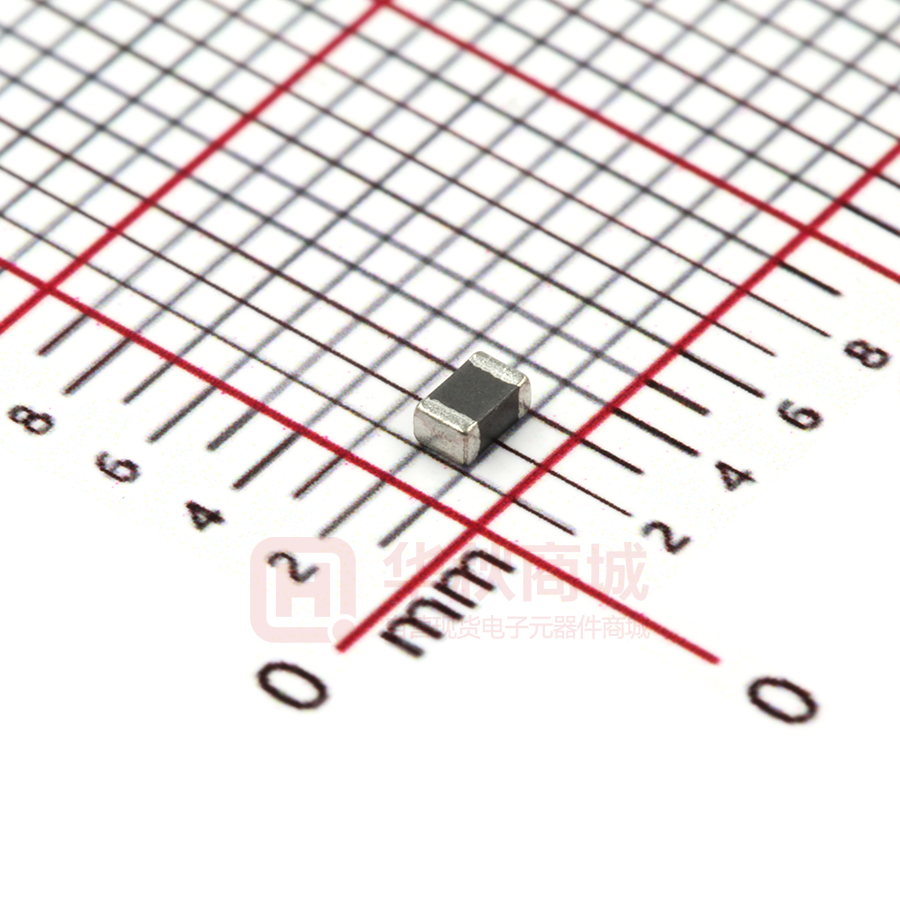

Multilayer Chip Power Inductor – MPL Series
Operating Temp. : -40℃~+85℃
FEATURES
High DC bias current due to developed material
Low DC resistance
Low profile and thin thickness
Monolithic structure for high reliability
Excellent solderability and high heat resistance
No cross coupling due to magnetic shield
APPLICATIONS
DC-DC converter circuits for mobile phones, DSCs, DVCs, HDDs, PDAs, etc.
