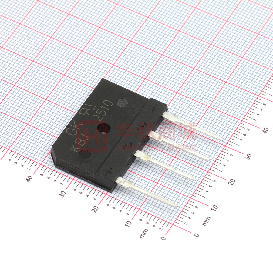

    DB-4P_30X4.6MM_TM
    直流反向耐压(Vr):1kV 平均整流电流(Io):25A 正向压降(Vf):1.05V@3A 反向电流(Ir):10A@1kV 正向浪涌电流(Ifsm):350A
KBJ2510 数据手册
KBJ25005 THRU KBJ2510 SINGLE PHASE 25.0 AMP BRIDGE RECTIFIERS VOLTAGE RANGE 50 to 1000 Volts CURRENT 25.0 Amperes KBJ 4.6 +0.2 30.0+0.3 3.6 +0.2 FEATURES 3.2 +0.2 3.5 +0.2 * Ideal for printed circuit board 20.0+0.3 * Low forward voltage * Low leakage current + 2.5 +0.2 * Mounting position: Any ~ ~ _ 11.0+ 0.2 5 4+0.2 2.2 +0.2 17.5+0.5 1.0+0.1 0.7+0.1 2.7 +0.2 10 +0.2 7.5+0.2 7.5+0.2 Dimensions in inches and (millimeters) MAXIMUM RATINGS AND ELECTRICAL CHARACTERISTICS Rating 25 C ambient temperature uniess otherwies specified. Single phase half wave, 60Hz, resistive or inductive load. For capacitive load, derate current by 20%. TYPE NUMBER 8 KBJ2510 UNITS KBJ25005 KBJ2501 KBJ2502 KBJ2504 KBJ2506 KBJ2508 Maximum Recurrent Peak Reverse Voltage Maximum RMS Voltage Maximum DC Blocking Voltage Maximum Average Forward (with heatsink Note 2) 50 35 50 100 70 100 200 140 200 400 280 400 600 420 600 800 560 800 1000 700 1000 V V V 25.0 A 4.2 A superimposed on rated load (JEDEC method) Maximum Forward Voltage Drop per Bridge Element at 3.0A D.C. Maximum DC Reverse Current Ta=25 C 350 1.05 10 A V mA at Rated DC Blocking Voltage Typical Junction Capacitance (Note 1) Typical Thermal Resistance RqJC (Note 2) Operating Temperature Range, TJ Storage Temperature Range, TSTG 500 85 0.6 mA PF C/W .375"(9.5mm) Lead Length at Tc=100 C (With heatsink) Peak Forward Surge Current, 8.3 ms single half sine-wave Ta=125 C -55 -55 +150 +150 C C NOTES: 1. Measured at 1.0MHz and applied reverse voltage of 4.0V DC. 2. Thermal Resistance from Junction to Case with device mounted on 300mm x 300mm x 1.6mm Cu Plate Heatsink. REV 1.0 2015 JAN PAGE:1/2 RATING AND CHARACTERISTIC CURVES (KBJ25005 THRU KBJ2510) FIG.2-MAXIMUM NON-REPETITIVE FORWARD SURGE CURRENT 25 AVERAGE FORWARD CURRENT,(A) WITH HEATSINK 20 Single Phase Half Wave 60Hz 15 Resistive Or Inductive Load 10 WITHOUT HEATSINK 5 0 20 40 60 80 100 120 140 160 PEAK FORWARD SURGE CURRENT,(A) FIG.1-TYPICAL FORWARD CURRENT DERATING CURVE 500 400 300 Sine Wave JEDEC method 100 0 1 CASE TEMPERATURE,( C) 8.3ms Single Half Tj=25 C 200 50 10 5 100 FIG.3-TYPICAL FORWARD FIG.4-TYPICAL REVERSE CHARACTERISTICS CHARACTERISTICS 50 50 10 10 REVERSE LEAKAGE CURRENT, (mA) INSTANTANEOUS FORWARD CURRENT,(A) NUMBER OF CYCLES AT 60Hz 3.0 1.0 Tj=25 C Pulse Width 300us 1% Duty Cycle 0.1 3.0 Tj=100 C 1.0 0.1 Tj=25 C .01 0 .2 .4 .6 .8 1.0 FORWARD VOLTAGE,(V) 1.2 1.4 .01 0 20 40 60 80 100 120 140 PERCENT OF RATED PEAK REVERSE VOLTAGE, (%) REV 1.0 2015 JAN PAGE:2/2
