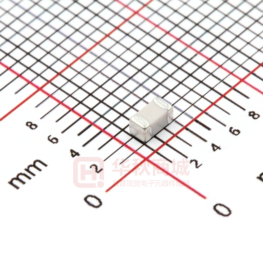

    贴片电容(MLCC) 1206 1.5nF ±5% 630V C0G(NP0)
1206N152J631CT 数据手册
Multilayer Ceramic Capacitors Approval Sheet MULTILAYER CERAMIC CAPACITORS Middle & High Voltage Series (200V to 4kV) 0402 to 1812 Sizes NP0, X7R & Y5V Dielectrics Halogen Free & RoHS compliance *Contents in this sheet are subject to change without prior notice. Page 1 of 13 ASC_Middle & High Voltage_003AE Dec. 2017 Multilayer Ceramic Capacitors Approval Sheet 1. INTRODUCTION WTC middle and high voltage series MLCC is designed by a special internal electrode pattern, which can reduce voltage concentrations by distributing voltage gradients throughout the entire capacitor. This special design also affords increased capacitance values in a given case size and voltage rating. Chips size 1206 and larger to use on reflow soldering process only. Capacitors with X7R dielectrics are not intended for AC line filtering applications. Capacitors may require protective surface coating to prevent external arcing. 2. FEATURES 3. APPLICATIONS a. b. a. b. c. d. High voltage in a given case size. High stability and reliability. Snubbers in high frequency power converters. High voltage coupling/DC blocking. DC-DC converters. Back-lighting inverters 4. HOW TO ORDER 1808 N 100 J 202 C T Size Dielectric Capacitance Tolerance Rated voltage Termination Packaging Inch (mm) 0402 (1005) 0603 (1608) 0805 (2012) 1206 (3216) 1210 (3225) 1808 (4520) 1812 (4532) Page 2 of 13 N=NP0 (C0G) B=X7R F=Y5V Two significant digits followed by no. of zeros. And R is in place of decimal point. eg.: 0R5=0.5pF 1R0=1.0pF 100=10x100 =10pF B=±0.1pF C=±0.25pF D=±0.5pF F=±1% G=±2% J=±5% K=±10% M=±20% Z=-20/+80% Two significant digits C=Cu/Ni/Sn followed by no. of zeros. And R is in place of decimal point. T=7” reeled G=13” reeled 201=200 VDC 251=250 VDC 401=400 VDC 451=450 VDC 501=500 VDC 631=630 VDC 102=1000 VDC 152=1500 VDC 202=2000 VDC 252=2500 VDC 302=3000 VDC 402=4000 VDC ASC_Middle & High Voltage_003AE Dec. 2017 Multilayer Ceramic Capacitors Approval Sheet 5. EXTERNAL DIMENSIONS Size Inch (mm) L (mm) W (mm) T (mm)/Symbol 0402 (1005) 1.00±0.05 0.50±0.05 0.50±0.05 N 0.80±0.10 0.80 +0.15/-0.10 2.00±0.15 1.25±0.10 0.80±0.07 0.80 +0.15/-0.10 0.60±0.10 0.80±0.10 1.25±0.10 1.25±0.20 0.80±0.10 0.95±0.10 1.25±0.10 1.60±0.20 0.95±0.10 1.25±0.10 1.60±0.20 2.00±0.20 2.50±0.30 2.50±0.50** 1.25±0.10 2.00±0.20 1.25±0.10 1.60±0.20 2.00±0.20 2.50±0.30 2.80±0.30 S 0603(1608) 1.60±0.10 1.60 +0.15/-0.10 0805 (2012) 2.00±0.20 1.25±0.20 3.20±0.15 1.60±0.15 3.20±0.20 1.60±0.20 3.20±0.30 2.50±0.20 3.20±0.40 2.50±0.30 3.20±0.60** 2.50±0.50** 1808 (4520) 4.50+0.5/-0.3 2.03±0.25 1812 (4532) 4.50+0.5/-0.3 1206 (3216) 1210 (3225) 3.20±0.30 3.20±0.40 Remark MB (mm) # 0.25 +0.05/-0.10 T 0.40±0.15 X A B D I B C D G C D G K L W MB # # # # # # # # # M # D K D G K M U # # # # # # # 0.50±0.20 MB Fig. 1 The outline of MLCC 0.60±0.20 (0.5±0.25)* 0.75±0.25 0.50±0.25 0.50±0.25 # Reflow soldering only is recommended. * For 1206_1000V ~3000V products. ** For 1210_100V: Cap > 1µF, 250V: Cap >0. 47µF, 400V~630V: Cap >0.22µF. 6. GENERAL ELECTRICAL DATA Dielectric Size Capacitance* Capacitance tolerance*** NP0 0.5pF to 0.033µF Cap≤5pF: C (±0.25pF) 5pF
1206N152J631CT
1. 物料型号:文档中提到了多种尺寸和电压等级的多层陶瓷电容器(MLCC),例如0402、0603、0805、1206、1210、1808和1812等尺寸,以及200V到4000V的不同额定电压。
2. 器件简介:Walsin Technology Corporation生产的中高压系列MLCC采用特殊的内部电极图案设计,可以减少电压集中,并通过整个电容器分布电压梯度。这种设计还在给定的尺寸和电压等级下提供了更高的电容值。
3. 引脚分配:文档中没有明确提到引脚分配,但是提到了不同尺寸的电容器和它们的额定电压。
4. 参数特性:文档详细列出了不同尺寸电容器的电容值、公差、额定电压、端头材料和包装方式。例如,电容值范围从0.5pF到0.033F,公差有F级(±1%)、G级(±2%)、J级(±5%)、K级(±10%)、M级(+20%)和Z级(-20/+80%)。
5. 功能详解:文档中提到了这些MLCC的应用,包括高频电源转换器中的扼流器、高压耦合/直流阻断、DC-DC转换器和背光逆变器。
6. 应用信息:电容器适用于如扼流器、高压耦合、DC-DC转换器和背光逆变器等多种应用场景。
7. 封装信息:文档提供了电容器的外部尺寸、标记和备注,以及推荐的再流焊接条件。
