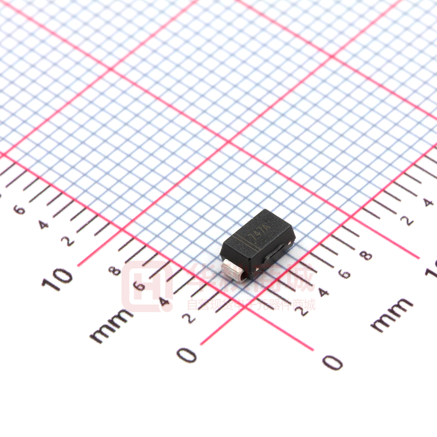

    稳压二极管 Vz=20V 19~21.2V Izt=13mA P=1W SMA
1SMA4747AG 数据手册
1SMA4728AG THRU 1SMA4777AG Silicon Planar Zener Diodes PINNING PIN FEATURES • Total power dissipation: Max. 1 W. • Wide zener reverse voltage range 3.3V to 330V. • Small plastic package suitable for surface mounted design. DESCRIPTION 1 Cathode 2 Anode 2 MECHANICAL DATA • Case: SMA • Terminals: Solderable per MIL-STD-750, Method 2026 • A pprox. Weight: 0.055g / 0.002oz 1 Simplified outline SMA and symbol Absolute Maximum Ratings And Characteristics (Ta = 25 °C) Symbol Value Unit Power Dissipation at T c =75°C PD 1 W Forward Voltage at I F = 200 mA VF 1.2 V Junction Temperature Range TJ - 55 to + 150 °C Storage Temperature Range TS - 55 to + 150 °C Parameter Fig.1 Maximum Continuous Power Derating 1.2 Power Dissipation ( W ) 1.0 0.8 0.6 0.4 0.2 0.0 25 50 75 100 125 T c ,Case Temperature (°C) REV.08 1 of 3 150 175 Characteristics at Ta = 25°C Dynamic Impedance Zener Voltage Range (1) Type Marking V ZT(at I ZT) Reverse Current I ZT Z ZT(at I ZT) IR at V R Admissible Zener Current Min(V) Nom(V) Max(V) (mA) Max (Ω) Max(μA) (V) I ZM (mA) 1SMA4728AG 728A 3.10 3.3 3.50 75 10 100 1 285 1SMA4729AG 729A 3.40 3.6 3.80 69 10 100 1 263 1SMA4730AG 730A 3.70 3.9 4.10 64 9.0 50 1 243 1SMA4731AG 731A 4.06 4.3 4.56 58 9.0 25 1 219 4.7 4.93 53 8.0 10 1 203 1SMA4732AG 732A 4.50 1SMA4733AG 733A 4.84 5.1 5.36 49 7.0 10 1 186 1SMA4734AG 734A 5.32 5.6 5.92 45 5.0 10 2 170 1SMA4735 AG 735A 5.86 6.2 6.51 41 2.0 10 3 154 1SMA4736 AG 736A 6.46 6.8 7.18 37 3.5 10 4 140 1SMA4737 AG 737A 7.12 7.5 7.88 34 4.0 10 5 127 1SMA4738 AG 738A 7.79 8.2 8.67 31 4.5 10 6 116 1SMA4739 AG 739A 8.60 9.1 9.59 28 5.0 10 7 104 1SMA4740 AG 740A 9.50 10 10.5 25 7.0 10 7 95 1SMA4741 AG 741A 10.4 11 11.6 23 8.0 5 8 86 1SMA4742 AG 742A 11.4 12 12.6 21 9.0 5 9 79 1SMA4743 AG 743A 12.4 13 14.1 19 10 5 10 71 1SMA4744 AG 744A 13.8 15 15.8 17 14 5 11 63 1SMA4745 AG 745A 15.2 16 17.1 16 16 5 12 58 1SMA4746 AG 746A 16.8 18 19.2 14 20 5 13 52 1SMA4747 AG 747A 19.0 20 21.2 13 22 5 15 47 1SMA4748 AG 748A 20.8 22 23.3 12 23 5 17 43 1SMA4749 AG 749A 22.8 24 26.0 11 25 5 18 38 1SMA4750 AG 750A 25.3 27 28.9 9.5 35 5 21 35 1SMA4751 AG 751A 28.2 30 32.0 8.5 40 5 23 31 1SMA4752 AG 752A 31.3 33 34.9 7.5 45 5 25 28 1SMA4753 AG 753A 34.2 36 37.9 7.0 50 5 27 26 1SMA4754 AG 754A 37.2 39 41.5 6.5 60 5 30 24 1SMA4755 AG 755A 40.9 43 45.6 6.0 70 1 32 22 1SMA4756 AG 756A 44.9 47 49.8 5.5 80 1 35 20 1SMA4757 AG 757A 48.6 51 54.0 5.0 95 1 38 18 1SMA4758 AG 758A 53.6 56 58.8 4.5 110 1 42 17 1SMA4759 AG 759A 58.9 62 65.6 4.0 125 1 47 15 1SMA4760 AG 760A 64.6 68 71.7 3.7 150 1 52 14 1SMA4761 AG 761A 71.2 75 78.8 3.3 175 1 56 12 1SMA4762 AG 762A 77.9 82 87.0 3.0 200 1 62 11 1SMA4763 AG 763A 86.0 91 96.0 2.8 250 1 69 10 1SMA4764 AG 764A 95.0 100 105 2.5 350 1 76 9.5 1SMA4765 AG 765A 104 110 116 2.3 450 1 84 8.6 1SMA4766 AG 766A 114 120 127 2.0 550 1 91 7.8 1SMA4767 AG 767A 125 135 142 1.9 700 1 100 7.0 1SMA4768 AG 768A 140 150 157 1.7 900 1 110 6.3 1SMA4769 AG 769A 155 165 172 1.6 1100 1 120 5.8 1SMA4770 AG 770A 170 180 191 1.4 1200 1 135 5.2 1SMA4771 AG 771A 189 200 211 1.2 1400 1 150 4.7 1SMA4772 AG 772A 209 220 231 1.0 1600 1 165 4.3 1SMA4773 AG 773A 229 240 251 1.0 1800 1 180 3.9 1SMA4774 AG 774A 249 260 271 1.0 2000 1 190 3.7 1SMA4775 AG 775A 269 280 291 1.0 2100 1 205 3.4 1SMA4776 AG 776A 289 300 315 1.0 2300 1 230 3.1 777A 313 330 346 1.0 2500 1 250 2.8 1SMA4777 AG (1) V ZT is tested with pulses (20 ms) 2 of 3 1SMA4728AG THRU 1SMA4777AG PACKAGE OUTLINE Plastic surface mounted package; 2 leads A A SMA c a VM e A HE g e E A D E HE c e g max 2.2 4.5 2.7 5.2 0.31 1.6 1.5 min 1.9 4.0 2.3 4.7 0.15 1.3 0.9 max 87 181 106 205 12 63 59 min 75 157 91 185 6 51 35 UNIT mm mil g e A D The recommended mounting pad size 2.4 (94) 1.8 (71) 1.8 (71) 1.8 (71) mm Unit : (mil) REV.08 3 of 3 a 0.3 12
