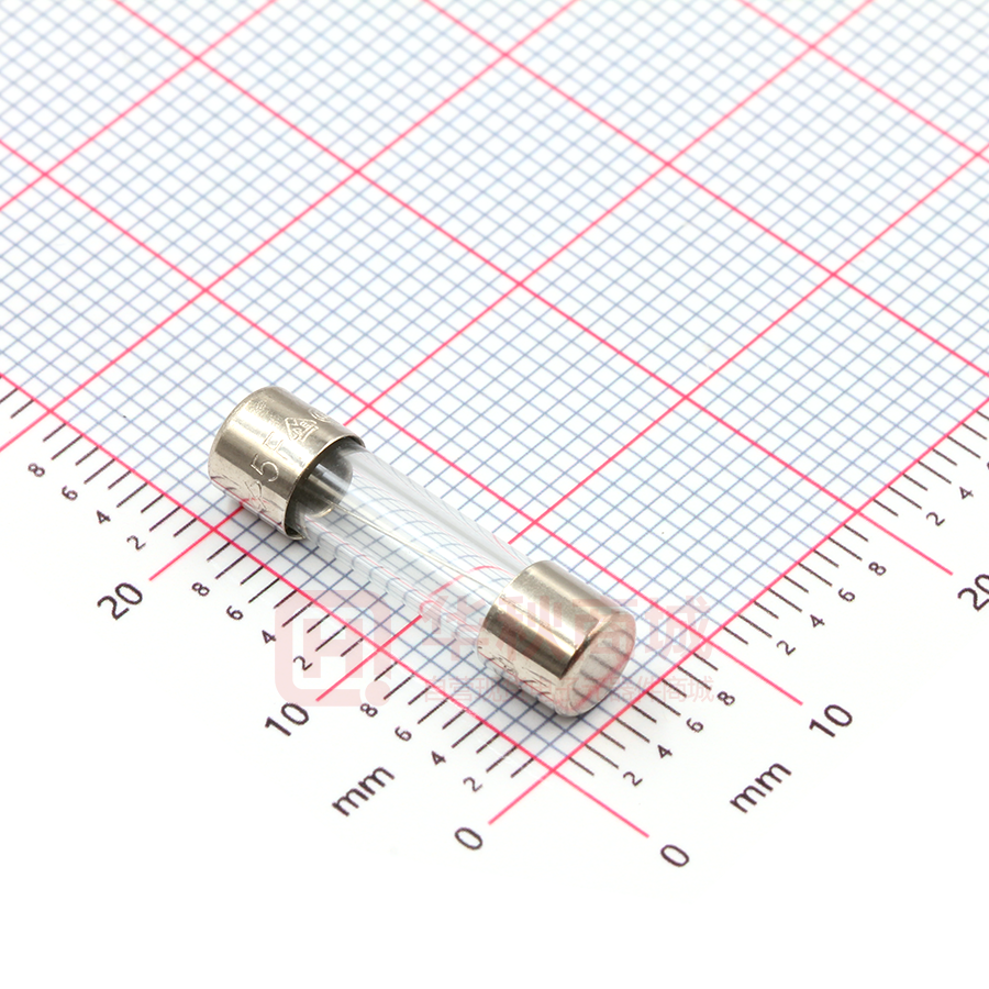

    XCFUSE(旭程)
    FUSE_D5.2X20MM
    一次性保险丝(熔断) FUSE_D5.2X20MM 250V 5A
5F.5000220000R1 数据手册
旭程电子(深圳)有限公司 XC Electronics(ShenZhen)Corp.,Ltd. 产品规格书 Fuses Specification 1.适用范围(Available range): 本保险丝适用于保护家用电器,电子仪器,电源供应器、显示器等。 For protecting instruments, power supply devices and telephone sets etc. 2. 型号定义解释(Model meaning) : 5F:快断系列产品 (5F:Quick Blow Fuses) 5T:慢断系列产品 (5T:Slow Blow Fuses) 3.相关标准(Safety Standards):GB9364 IEC60127 通过认证(Approved file No): CCC PS E JET 4.尺寸与结构(Size and Structure): 4.1 外形、结构及尺寸(The out view,construction and dimensions): 参考下图 Refer to the following figure. 页次 Page 1 of 9 XCRD-B(Ver.3.0) 旭程电子(深圳)有限公司 XC Electronics(ShenZhen)Corp.,Ltd. 编号 部件 材料 备注 No. Part Name Material Remarks 铜帽 镀镍黄铜 Brass Cap Nickel plated copper 玻璃管 玻璃 Glass Tube Glass 熔丝 合金 Fuse Element Alloy 焊锡 锡线(Sn99.3%Cu0.7%) Solder Solder wire( Sn99.3%Cu0.7%) 1 ○ 2 ○ 3 ○ 4 ○ RoHS 4.2 型号及标示 (Catalogue No.,and indication) A 表示 B 表示 备注 Indication A Indication B Remarks 额定电压/电流 商标.品名.认证 认证号 Rated Voltage/Current Trademark.Type.Approved mark Approval No. 型号 Catalogue No. VDE:40009609 5F Sereis F2L250V 5F V E CCC:2003010207097826 UR:E249609 4.3 玻璃管 (Glass Tube) 管体本体无破裂、缺损等现象,玻璃管产品须透明易辨其内部的可熔体。 The tube shall have no defects such as crack, injury and contamination. For glass tube, transparent glass in which the melting wire is clear and perceptible. 页次 Page 2 of 9 XCRD-B(Ver.3.0) 旭程电子(深圳)有限公司 XC Electronics(ShenZhen)Corp.,Ltd. 4.4 铜帽(Brass caps) 铜帽应焊接牢固,以保证在未损坏熔断体时,铜帽不能被卸脱。铜帽表面镀层应结实, 端帽两端均可承受大小至少为 5N、保持 1min 的轴向拉力。 The cap should be firmly attached so that it is not possible to remove them without damaging the fuse itself. The plated material should be firm. Each of the cap should be bear an axial pull of 5N for 1min. 4.5 焊点(Soldering joint) 焊接铜帽端时,残留的助焊剂及焊锡等异物不应超出铜帽口和沾附在保险管外表面。 Soldering joint in end cap shall not melt during normal operation and shall not have solder clips on the tube, element in view and outer surface of caps. 5.机械特性(Mechanical characteristics) 保险丝应能承受下列试验: Fuses should endure both of the following tests: 5.1 扭力试验:固定保险丝的一端铜帽,然后在另一端铜帽上顺时针和逆时针方向上顺序 施加 100g.cm 力矩,两端铜帽不应松动,管体也不应破碎。 Wresting test:Fixed one cap of the fuse,applied 100g.cm of torsion power in clockwise and counter-clockwise on the other cap, as a result, the tube shall be no damage and the cap should be no loosening. 5.2 拉力试验:固定保险丝的一端铜帽,然后在另一端铜帽上,沿水平轴方向施加 5N 的 拉力 1min,两端铜帽不应松动且管体不应破碎。 Pulling test: Fixed one cap of the fuse,applied level pull force of 5N to the other cap for 1 minute, there shall be no damage with the tube and no loosening with the caps and the pigtails. 页次 Page 3 of 9 XCRD-B(Ver.3.0) 旭程电子(深圳)有限公司 XC Electronics(ShenZhen)Corp.,Ltd. 5.3 管子强度试验:两端铜帽固定好后,在管体的中心位置施加 10N 的压力,管体不应破 碎。 Stress test: Fixed two caps of the fuse,applied the stress of 10N to the tube center , there shall be no damage with the tube . 6.电气特性(Electrical performance) 6.1 测试条件(Testing Ambient) 测试条件都应在下列大气条件下进行: All tests should be carried out under the following conditions: -温度(Surrounding temperature) :15℃~35℃; -相对湿度(Relative humidity) :45%~75%; -大气压力(Atmosphere pressure) :8.6x104 Pa~1.06x10 5 6.2 时间/电流特性(Time-current Characteristic) 电流(In ratio) 型号类别 ( Item No.) 5F 系列 5F Series 2 2A I t 参考值 150% 210% 275% >1h <30min ≥50ms ≤2s 24.09A2S 6.3 分断能力(Breaking capacity) 1)AC 250V 35A 或 10In(注:In 代表额定电流)取最大。 Breaking capacity:35A or 10In(AC250V) ,whichever is greater. 2)每一次测试,保险管能安全动作,不能出现以下现象: In each of the tests, the fuse-link shall operate satisfactorily without any of the following phenomena: -持续电弧; -permanent arcing; 页次 Page 4 of 9 XCRD-B(Ver.3.0) 旭程电子(深圳)有限公司 XC Electronics(ShenZhen)Corp.,Ltd. -引燃; -ignition; -保险管爆炸; -Bursting of the fuse-link. 注意:颜色改变不认为是不合格. NOTE:changes in color are not considered as a failure. 安全认证分断电流 Safe attestation Breaking current 型号 Model 额定电流 Rated Current 5F 系列 5F Series In≤3.15A 35A AC 250V In>3.15A 10In AC 250V  US PS E JET 6.4 时间电流特性曲线图(Time-current curves) 6.5 耐久性试验(Endurance test) 1)对保险丝通过 1.2 倍额定电流 1 小时,然后切断 15 分钟,重复此循环 100 次。 A current 1.2 In is passed through the fuse-link for a period of 1h.The current is then seitched off for a period of 15 min.The cycle is repeated 100 times. 页次 Page 5 of 9 XCRD-B(Ver.3.0) 旭程电子(深圳)有限公司 XC Electronics(ShenZhen)Corp.,Ltd. 2)然后对熔断体通以 1.5 倍额定电流 1 小时。 A current 1.5In is then passed through the fuse-link for 1h. 3)测量熔断体两端的电压降,试验后,熔断体两端的电压降的增大量不大于试验前 测得值的 10%。 Finally,the voltage drop across the fuse-lin is measured.The voltage drop across the fuse-link after the test shall not have increased by more than 10% of the value measured before the test. 4)试验后,标记仍应清晰可辨,而且诸如端帽上的焊点不应出现任何明显的劣变。 After the test,the marking shall still be legible and soldered joints on end caps,for example,shall not show and appreciable deterioration. 7.环保焊接条件 Soldering conditions(RoHS) 波峰焊/Wave solder:260℃,≤ 5S 手工焊/Hand solder: 360℃,≤1S 8. 环境特性 Environmental characteristic 8.1 温度-电流负荷比曲线 Temperature-Current Curve 8.2 贮存条件 Storage conditions 贮存温度/Storage temperature: 5℃~35℃ 贮存湿度/Storage humidity:25%~85% 贮存周期/Storage time:6 months 页次 Page 6 of 9 XCRD-B(Ver.3.0) 旭程电子(深圳)有限公司 XC Electronics(ShenZhen)Corp.,Ltd. 9.信赖性试验(Reliability test) 项目/Item 试验要求/Test Requirement 高低温试验 试验后保险丝管的电阻符合范围 High & low After test, the resistance value of the Temperature Test 高湿试验 High Humidity Test 试验条件/Test Condtiton 测试高温:85℃,测试时间:48h fuses shall be in range Test high temperature:85℃,Test time:48h 测试低温:-20℃,测试时间:48h Test low temperature:-20℃,Test time:48h 试验后保险丝管的电阻符合范围 测试温度:85℃,测试湿度:95%,测试时间:96h After test, the resistance value of the Test temperature:85℃,Test humidity:95%, fuses shall be in range Test time:96h 铜帽应固定牢固,以保证在未损坏熔断体时, 铜帽不能被卸下,铜帽表面镀层应牢固不易脱 落,每个端帽应能经受专用的设备外加轴向拉 力 5N,保持 1 分钟,玻璃管必须无缺陷破裂和 缺损。试验后保险丝管的电阻符合范围。 Cap should be firmly attached so that it is not possible to remove them without 落下、冲击实验 Falling Shock Test 保险管从 152cm 高自由落下,跌落 5 次。 damaging the fuse itself.The means of attachment shall be sufficient to withstand an axial pull of 5N applied to Falling Height:152cm Falling Times:5 each cap for 1 minute.The cap shall be nickel plated firmly.The glass tube shall have no defects injury.After such falling as shock crack and test,the resistance value of the fuses shall be in range. 振动试验 Vibration 试验后保险丝管的电阻符合范围 振幅 1.5mm,频率 10~55~10Hz,时间 2 小时 After test, the resistance value of the Amplitude:1.5mm, fuses shall be in range 10Hz,Test time:2h Frequency:10 ~ 55 ~ 10.产品标志(Marking) 10.1 保险丝上的标志应易于看清。 The marking on fuse shall be indelibly marked on the end cap and easily visible. 10.2 每个保险丝标记应包含下列内容: The symbol for every fuse shall be as prescribed below: 页次 Page 7 of 9 XCRD-B(Ver.3.0) 旭程电子(深圳)有限公司 XC Electronics(ShenZhen)Corp.,Ltd. 1)额定电流(Rated current):F2L 2)额定电压(Rated voltage):250V 3)型号名称(Catalogue code):5F 4)安全认证标志(Safety mark logo): V E 5)厂标(Trade mark): 11.包装(200PCS/包、2000PCS/盒、20000PCS/箱)仅供参考,以实际数量为准. Packaging (200PCS/Bag、2000PCS/Box、20000PCS / External Carton) 12.认证和环保/Certification and RoHS 参考附加档案/See the attached files 页次 Page 8 of 9 XCRD-B(Ver.3.0) 旭程电子(深圳)有限公司 XC Electronics(ShenZhen)Corp.,Ltd. 13.料号解释/Part No. description 5F. 2000 5F Series 2A 2 250V 1 Fuse element code 0000 Z Shape cody CR G manufactory Approual Mark RoHS 14.文件管控/Document control Edition Date Description version 1 2017-03-29 新版发行/New version 3.0 2 3 页次 Page 9 of 9 XCRD-B(Ver.3.0)
