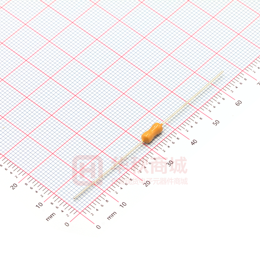

    FUSE_D2.7X7.3MM_TM
    一次性保险丝(熔断) FUSE_D2.7X7.3MM_TM 250V 2A
2T.2000242000ZHGMB01 数据手册
旭程电子(深圳)有限公司 XC Electronics(ShenZhen)Corp.,Ltd. 产 品 规 格 书 Fuses Specification 1.适用范围(Available range): 本保险丝适用于保护家用电器,电子仪器,电源供应器、显示器等。 For protecting instruments, power supply devices and telephone sets etc. 2. 型号定义解释(Model meaning) : 2T:慢断系列产品 (2T:Slow Blow Fuses) 2F:快断系列产品 (2F:Quick Blow Fuses) 3.相关标准(Safety Standards): UL248-1,UL248-14,CSA C22.2 NO.248.1-00,CSA C22.2 NO.248.14-00 通过认证(Approved file No): 4.尺寸与结构(Size and Structure): 4.1 外形、结构及尺寸(The out view,construction and dimensions): 参考下图 Refer to the following figure. 环氧树脂 页次 Page 1 of 9 XCRD-B(Ver.3.0) 旭程电子(深圳)有限公司 XC Electronics(ShenZhen)Corp.,Ltd. 编号 部件 材料 备注 No. Part Name Material Remarks 铜帽 镀镍黄铜 Brass Cap Nickel plated copper 陶瓷管 陶瓷 Ceramic Tube ceramic 带线 镀锡铜线 Pigtail stannum plated copper 熔丝 合金 Fuse Element Alloy 焊锡 锡线(Sn99.3%Cu0.7%) Solder Solder wire( Sn99.3%Cu0.7%) 绝缘涂层 环氧树脂 Insulating Coat Epxoy Resin 1 ○ 2 ○ 3 ○ 4 ○ 5 ○ ○ 6 RoHS 4.型号及标示 (Catalogue No.,and indication) 型号 Catalogue No. A 表示 备注 Indication A Remarks 额定电流 认证号 Rated Voltage/Current Approval No. 250mA-10A UR:E249609 2T/2F Sereis 页次 Page 2 of 9 XCRD-B(Ver.3.0) 旭程电子(深圳)有限公司 XC Electronics(ShenZhen)Corp.,Ltd. 4.3 管体(Tube) 管体本体无破裂、缺损等现象。 The tube shall have no defects such as crack, injury and contamination. 4.4 铜帽(Brass caps) 铜帽应焊接牢固,以保证在未损坏熔断体时,铜帽不能被卸脱。铜帽表面镀 层应结实,端帽两端均可承受大小至少为 5N、保持 1min 的轴向拉力。 The cap should be firmly attached so that it is not possible to remove them without damaging the fuse itself. The plated material should be firm. Each of the cap should be bear an axial pull of 5N for 1min. 4.5 焊点(Soldering joint) 焊接铜帽端时,残留的助焊剂及焊锡等异物不应超出铜帽口和沾附在保险管 外表面。 Soldering joint in end cap shall not melt during normal operation and shall not have solder clips on the tube, element in view and outer surface of caps. 4.6 引脚(Lead) 保险管引脚应铆接牢固,作如下测试时,保险管引脚不应有松动或损坏: The fuse-links lead should be firmly attached, At the conclusion of testing, the fuse-links lead shall remain firmly attached: 1) 拉力测试:固定保险管本体,对引脚施加 10N 的轴向拉力 1min。 Tensile: the force applied shall be 10N 2) 推力测试:固定保险管本体,对引脚施加 2N 的轴向推力 1min。 Thrust: the force applied shall be 2N 3) 弯折测试:距离铜帽约 2mm 的地方将引脚弯折 90°一次,并且施加 5N 的拉力。 Bending: the force applied shall be 5N and the number of bends shall be one。 页次 Page 3 of 9 XCRD-B(Ver.3.0) 旭程电子(深圳)有限公司 XC Electronics(ShenZhen)Corp.,Ltd. 5.机械特性(Mechanical characteristics) 保险丝应能承受下列试验: Fuses should endure both of the following tests: 5.1 扭力试验:固定保险丝的一端铜帽,然后在另一端铜帽上顺时针和逆时针方 向上顺序施加 50g.cm 力矩,两端铜帽不应松动,管体也不应破碎。 Wresting test:Fixed one cap of the fuse,applied 50g.cm of torsion power in clockwise and counter-clockwise on the other cap, as a result, the tube shall be no damage and the cap should be no loosening. 5.2 拉力试验:固定保险丝的一端铜帽,然后在另一端铜帽上,沿水平轴方向施 加 5N 的拉力 1min,两端铜帽不应松动且管体不应破碎。 Pulling test: Fixed one cap of the fuse,applied level pull force of 5N to the other cap for 1 minute, there shall be no damage with the tube and no loosening with the caps and the pigtails. 5.3 管子强度试验:保险管两端固定好后,在管体的中心位置施加 10N 的压力, 管体不应破碎。 Stress test: Fixed two caps of the fuse,applied the stress of 10N to the tube center , there shall be no damage with the tube . 6.电气特性(Electrical performance) 6.1 测试条件(Testing Ambient) 测试条件都应在下列大气条件下进行: All tests should be carried out under the following conditions: -温度(Surrounding temperature) :15℃~35℃; -相对湿度(Relative humidity) :45%~75%; -大气压力(Atmosphere pressure) :8.6x104 Pa~1.06x10 5 页次 Page 4 of 9 XCRD-B(Ver.3.0) 旭程电子(深圳)有限公司 XC Electronics(ShenZhen)Corp.,Ltd. 6.2 时间/电流特性(Time-current Characteristic) 电流(In ratio) 100% 200% 2T 系列 Series >4h ≤60s 2F 系列 Series >4h ≤60s 型号类别(Type) 6.3 分断能力(Breaking capacity) 1)AC 250V 25A 分断电流测试。 Breaking capacity test:25A (AC250V) . 2)每一次测试,保险管能安全动作,不能出现以下现象: In each of the tests, the fuse-link shall operate satisfactorily without any of the following phenomena: -持续电弧; -permanent arcing; -引燃; -ignition; -保险管爆炸; -Bursting of the fuse-link. 注意:颜色改变不认为是不合格. NOTE:changes in color are not considered as a failure. 型号 Model 额定电流 Rated Current 2T/2F 系列 2T /2F Series 250mA-10A 安全认证分断电流 Safe attestation Breaking current 25A AC 250V 页次 Page 5 of 9 XCRD-B(Ver.3.0) 旭程电子(深圳)有限公司 XC Electronics(ShenZhen)Corp.,Ltd. 6.4 时间电流特性曲线图(Time-current curves) 5A 6.3A 8A 10A 3A 4A 2.5A 1.25A 1.5A 2A 1A 500mA 750mA 300mA 350mA 400mA 200mA 250mA 10A 5A 6.3A 8A 2A 2.5A 3A 4A 1A 1.25A 1.5A 500mA 750mA 250mA 300mA 350mA 400mA 2T I-T Characteristics Curves 时间(秒) TIME(S) 200mA 2F I-T Characteristics Curves 电流(A) CURRENT(A) 电流(A) CURRENT(A) 6.5 耐久性试验(Endurance test) 对熔断体通以 1 倍额定电流不小于 4 小时, 熔断体不断开。 A current 1In is then passed through the fuse-link more than 4h the fuse-link is OK. 7. 安装方式及条件 Installation Way and Parameters 7.1 建议如下图安装方式安装 Propose that the following picture installation way is installed ≥ ≥ ≥0mm ≥ ≥ ≥ PCB 焊接处 PCB Solder Joits 焊接处 Solder Joits 7.2 环保焊接条件 Soldering conditions(RoHS) 波峰焊/Wave solder:260℃,≤ 5S 手工焊/Hand solder: 360℃,≤1S 页次 Page 6 of 9 XCRD-B(Ver.3.0) 旭程电子(深圳)有限公司 XC Electronics(ShenZhen)Corp.,Ltd. 8. 环境特性 Environmental characteristic 8.1 温度-电流负荷比曲线 Temperature-Current Curve 8.2 贮存条件 Storage conditions 贮存温度/Storage temperature: 5℃~35℃ 贮存湿度/Storage humidity:25%~85% 贮存周期/Storage time:6 months 9.信赖性试验(Reliability test) 项目/Item 试验要求/Test Requirement 高低温试验 试验后保险丝管的电阻符合范围 High & low After test, the resistance value of the Temperature Test 高湿试验 High Humidity Test fuses shall be in range 试验条件/Test Condtiton 测试高温:85℃,测试时间:48h Test high temperature:85℃,Test time:48h 测试低温:-20℃,测试时间:48h Test low temperature:-20℃,Test time:48h 试验后保险丝管的电阻符合范围 测试温度:85℃,测试湿度:95%,测试时间:96h After test, the resistance value of the Test temperature:85℃,Test humidity:95%, fuses shall be in range Test time:96h 铜帽应固定牢固,以保证在未损坏熔断体时, 铜帽不能被卸下,铜帽表面镀层应牢固不易脱 落,每个端帽应能经受专用的设备外加轴向拉 落下、冲击实验 Falling Shock Test 保险管从 152cm 高自由落下,跌落 5 次。 力 5N,保持 1 分钟,玻璃管必须无缺陷破裂和 缺损。试验后保险丝管的电阻符合范围。 Cap should be firmly attached so that it Falling Height:152cm Falling Times:5 is not possible to remove them without damaging the fuse itself.The means of 页次 Page 7 of 9 XCRD-B(Ver.3.0) 旭程电子(深圳)有限公司 XC Electronics(ShenZhen)Corp.,Ltd. attachment shall be sufficient to withstand an axial pull of 5N applied to each cap for 1 minute.The cap shall be nickel plated firmly.The glass tube shall have no defects injury.After such falling as crack shock and test,the resistance value of the fuses shall be in range. 振动试验 Vibration 试验后保险丝管的电阻符合范围 振幅 1.5mm,频率 10~55~10Hz,时间 2 小时 After test, the resistance value of the Amplitude:1.5mm, fuses shall be in range 10Hz,Test time:2h Frequency:10 ~ 55 ~ 10.产品标志(Marking) 10.1 保险丝上的标志应易于看清。 The marking on fuse shall be indelibly marked on the end cap and easily visible. 10.2 每个保险丝标记应包含下列内容: The symbol for every fuse shall be as prescribed below: 1)额定电流(Rated current):250mA-10A 2)额定电压(Rated voltage):250V 3)特性符号(Catalogue code):T/F 4)安全认证标志(Safety mark logo): 5)厂标(Trade mark): 11.包装 Packaging (2000PCS/Bag、2000PCS/Box、40000PCS/ External Carton) 2000Pcs/Bag 2000Pcs/Box 2000Pcs/Box 40000Pcs/ External Carton 页次 Page 8 of 9 XCRD-B(Ver.3.0) 旭程电子(深圳)有限公司 XC Electronics(ShenZhen)Corp.,Ltd. 12.认证和环保/Certification and RoHS 参考附加档案/See the attached files 13.料号解释/Part No. Description 例如: 2T. 0250 2T Series 250mA 2F. 0010 2T Series 10A 2 4 250V Fuse element 2 1 250V Fuse element 2000 Z H Shape code Manufactory Ceramic Body 2000 Z H Shape code Manufactory Ceramic Body G RoHS M low cap B 01 Tape Yellow G M B 02 RoHS low cap Tape Green 14.文件管控/Document control Edition Date Description version 1 2017-06-30 新版发行/New version 2.0 2 3 页次 Page 9 of 9 XCRD-B(Ver.3.0)
