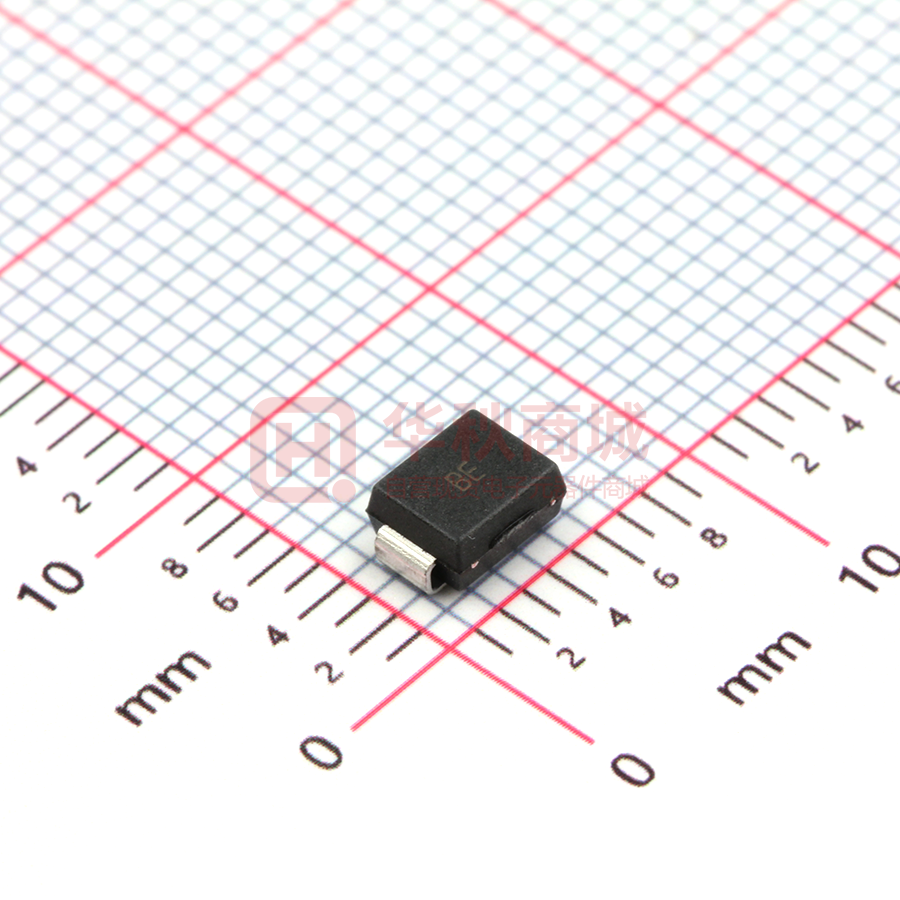

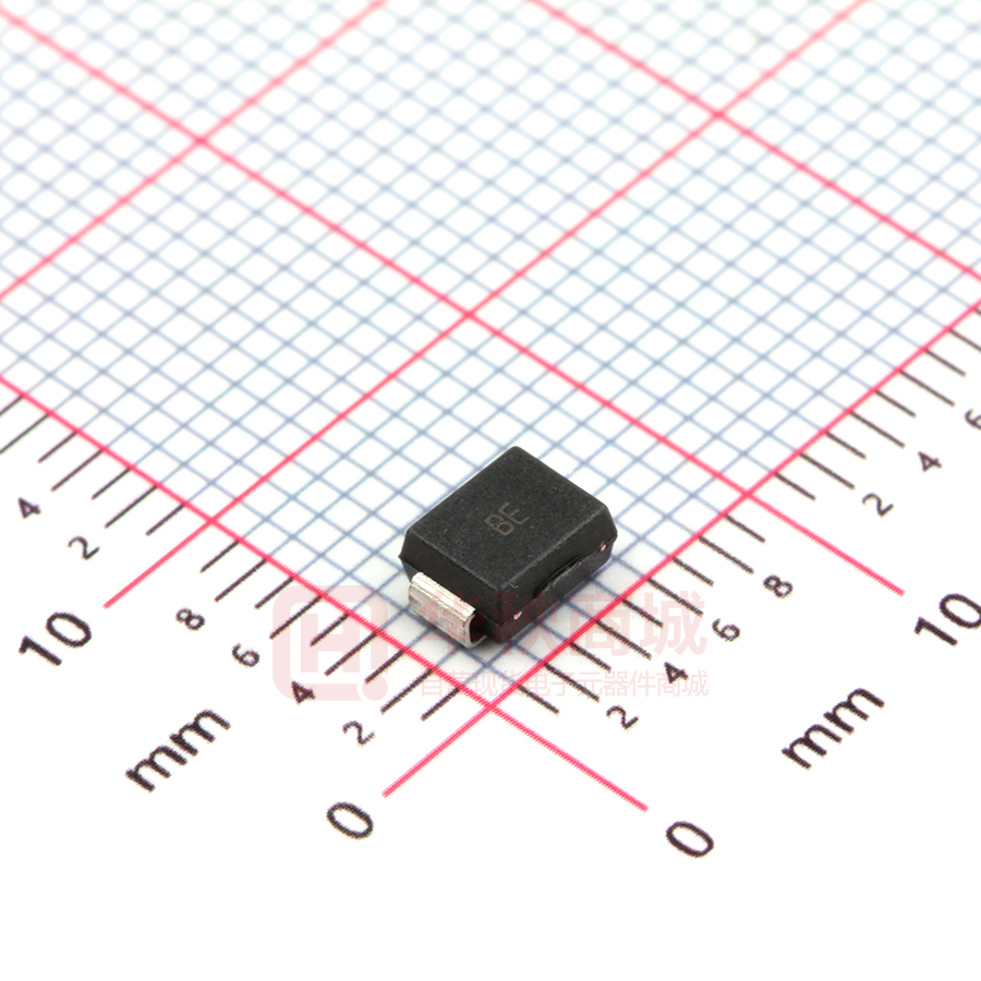

SMBJ5.0 THRU SMBJ440CA Surface mount transient voltage suppressor power 600 watts Stand-Off Voltage:5.0V~440V Features PINNING PIN DESCRIPTION 1 Cathode 2 Anode  For surface mounted applications in order to optimize board space.  Low profile package DO-214AA/SMB  Glass passivated junction  Low inductance  Plastic package has Underwriters Laboratory Flammability 2 1 Unipolar Mechanical Data  Case: SMB Bipolar  Terminals: Solderable per MIL-STD-750, Method 2026 A pprox. Weight: 0.1g / 0.0034oz Maximum Ratings and Electrical characteristics Ratings at 25 °C ambient temperature unless otherwise specified. Parameter Peak Pulse Power Dissipation on 10/1000 us waveform ( Note1,Note2, Fig.1). Symbol Value Unit P PPM 600 W 100 A Peak Forward Surge Current,8.3ms Single Half Sine-Wave Superimposed on Rated Load, (JEDEC Method) (Note 3,Fig4). (UNI) Peak Pulse Current on 10/1000 us waveform (Note 1, Fig 3) I PPM see Table 1 A Typical Junction capacitance at VR=4V, f=1MHz CJ 390 pF I FSM V ESD1 V ESD2 30 30 kV Typical Thermal Resistance Junction to Ambient(Note 2) RθJA 100 °C/W Operating Junction Temperature and Storage Temperature Range T j , T stg -65 ~ +150 °C ESD Voltage per IEC6100-4-2 Contact Air NOTES: 1. Non-repetitive current pulse, per Fig.3 and derated above T A = 25°C per Fig. 2. 2 2. Mounted on 5 mm (0.13mm thick) land areas. 3. Measured on 8.3ms,single half sine-wave or equivalent square wave,duty cycle=4 pulses per minute maximum. 4. Peak pulse power waveform is 10/1000μS. www.tw-gmc.com 1 SMBJ5.0 THRU SMBJ440CA Surface mount transient voltage suppressor power 600 watts Electrical Characteristics (TA=25℃℃) Part Number Stand-Off Voltage:5.0V~440V Device Reverse Breakdown Marking Stand-Off Voltage Code Voltage @IT Maximum Test Clamping Current Voltage @IPP Peak Reverse Pulse Leakage Current @VRWM Unidirectional Bidirectional UNI BI VRWM(V) VBR(V) IT(mA) VC(V) IPP(A) IR(μA) SMBJ5.0A SMBJ5.0CA KE AE 5.0 6.40~7.00 10 9.2 65.3 800 SMBJ6.0A SMBJ6.0CA KG AG 6.0 6.67~7.37 10 10.3 58.3 800 SMBJ6.5A SMBJ6.5CA KK AK 6.5 7.22~7.98 10 11.2 53.6 500 SMBJ7.0A SMBJ7.0CA KM AM 7.0 7.78~8.60 10 12.0 50.0 200 SMBJ7.5A SMBJ7.5CA KP AP 7.5 8.33~9.21 1 12.9 46.6 100 SMBJ8.0A SMBJ8.0CA KR AR 8.0 8.89~9.83 1 13.6 44.2 50 SMBJ8.5A SMBJ8.5CA KT AT 8.5 9.44~10.40 1 14.4 41.7 20 SMBJ9.0A SMBJ9.0CA KV AV 9.0 10.00~11.10 1 15.4 39.0 10 SMBJ10A SMBJ10CA KX AX 10.0 11.10~12.30 1 17.0 35.3 5 SMBJ11A SMBJ11CA KZ AZ 11.0 12.20~13.50 1 18.2 33.0 1 SMBJ12A SMBJ12CA LE BE 12.0 13.30~14.70 1 19.9 30.2 1 SMBJ13A SMBJ13CA LG BG 13.0 14.40~15.90 1 21.5 28.0 1 SMBJ14A SMBJ14CA LK BK 14.0 15.60~17.20 1 23.2 25.9 1 SMBJ15A SMBJ15CA LM BM 15.0 16.70~18.50 1 24.4 24.6 1 SMBJ16A SMBJ16CA LP BP 16.0 17.80~19.70 1 26.0 23.1 1 SMBJ17A SMBJ17CA LR BR 17.0 18.90~20.90 1 27.6 21.8 1 SMBJ18A SMBJ18CA LT BT 18.0 20.00~22.10 1 29.2 20.6 1 SMBJ20A SMBJ20CA LV BV 20.0 22.20~24.50 1 32.4 18.6 1 SMBJ22A SMBJ22CA LX BX 22.0 24.40~26.90 1 35.5 16.9 1 SMBJ24A SMBJ24CA LZ BZ 24.0 26.70~29.50 1 38.9 15.5 1 SMBJ26A SMBJ26CA ME CE 26.0 28.90~31.90 1 42.1 14.3 1 SMBJ28A SMBJ28CA MG CG 28.0 31.10~34.40 1 45.4 13.3 1 SMBJ30A SMBJ30CA MK CK 30.0 33.30~36.80 1 48.4 12.4 1 SMBJ33A SMBJ33CA MM CM 33.0 36.70~40.60 1 53.3 11.3 1 SMBJ36A SMBJ36CA MP CP 36.0 40.00~44.20 1 58.1 10.4 1 SMBJ40A SMBJ40CA MR CR 40.0 44.40~49.10 1 64.5 9.3 1 SMBJ43A SMBJ43CA MT CT 43.0 47.80~52.80 1 69.4 8.7 1 SMBJ45A SMBJ45CA MV CV 45.0 50.00~55.30 1 72.7 8.3 1 SMBJ48A SMBJ48CA MX CX 48.0 53.30~58.90 1 77.4 7.8 1 SMBJ51A SMBJ51CA MZ CZ 51.0 56.70~62.70 1 82.4 7.3 1 SMBJ54A SMBJ54CA NE DE 54.0 60.00~66.30 1 87.1 6.9 1 SMBJ58A SMBJ58CA NG DG 58.0 64.40~71.20 1 93.6 6.5 1 SMBJ60A SMBJ60CA NK DK 60.0 66.70~73.70 1 96.8 6.2 1 SMBJ64A SMBJ64CA NM DM 64.0 71.10~78.60 1 103.0 5.9 1 SMBJ70A SMBJ70CA NP DP 70.0 77.80~86.00 1 113.0 5.3 1 SMBJ75A SMBJ75CA NR DR 75.0 83.30~92.10 1 121.0 5.0 1 SMBJ78A SMBJ78CA NT DT 78.0 86.70~95.80 1 126.0 4.8 1 SMBJ85A SMBJ85CA NV DV 85.0 94.40~104.00 1 137.0 4.4 1 SMBJ90A SMBJ90CA NX DX 90.0 100.00~111.00 1 146.0 4.1 1 SMBJ100A SMBJ100CA NZ DZ 100.0 111.00~123.00 1 162.0 3.7 1 SMBJ110A SMBJ110CA PE EE 110.0 122.00~135.00 1 177.0 3.4 1 SMBJ120A SMBJ120CA PG EG 120.0 133.00~147.00 1 193.0 3.1 1 www.tw-gmc.com 2 SMBJ5.0 THRU SMBJ440CA Surface mount transient voltage suppressor power 600 watts Stand-Off Volta e:5.0V~440V Electrical Characteristics (TA=25℃ ℃) Device Marking Code Part Number Reverse Stand-Off Voltage Breakdown Voltage @IT Test Current Maximum Clamping Voltage @IPP Peak Pulse Current Reverse Leakage @VRWM Unidirectional Bidirectional UNI BI VRWM(V) VBR(V) IT(mA) VC(V) IPP(A) IR(μA) SMBJ130A SMBJ130CA PK EK 130.0 144.00~159.00 1 209.0 2.9 1 SMBJ150A SMBJ150CA PM EM 150.0 167.00~185.00 1 243.0 2.5 1 SMBJ160A SMBJ160CA PP EP 160.0 178.00~197.00 1 259.0 2.3 1 SMBJ170A SMBJ170CA PR ER 170.0 189.00~209.00 1 275.0 2.2 1 SMBJ180A SMBJ180CA PT ET 180.0 201.00~222.00 1 292.0 2.1 1 SMBJ190A SMBJ190CA PA EC 190.0 211.00~233.00 1 308.0 2.0 1 SMBJ200A SMBJ200CA PV EV 200.0 224.00~247.00 1 324.0 1.9 1 SMBJ210A SMBJ210CA PB ED 210.0 237.00~263.00 1 340.0 1.8 1 SMBJ220A SMBJ220CA PX EX 220.0 246.00~272.00 1 356.0 1.7 1 SMBJ250A SMBJ250CA PZ EZ 250.0 279.00~309.00 1 405.0 1.5 1 1 SMBJ300A SMBJ300CA QE FE 300.0 335.00~371.00 1 486.0 1.3 SMBJ350A SMBJ350CA QG FG 350.0 391.00~432.00 1 567.0 1.1 1 SMBJ400A SMBJ400CA QK FK 400.0 447.00~494.00 1 648.0 0.9 1 SMBJ440A SMBJ440CA QM FM 440.0 492.00~543.00 1 713.0 0.9 1 Fig.2 Forward Current Derating Curve PEAK PULSE POWER(PPP)OR CURRENT(Ipp) DERATINGIN PERCENTAGE% P PPM ,PEAK PULSE FORWARD ,kW Fig.1 Peak Pulse Power Rating Curve 100 Non-Repetive Pulse.Wavefom Shown in Figure.3 T A=25°C 10 1.0 0.1 0.1 10 1 100 1000 10000 100 80 60 40 20 0 25 I ppm ,Peak Pulse Current (%) I FSM ,PEAK FORWARD SURGE CURRENT, AMPERES T A =25°C 100 Peak Value Pulse Width (td) is Defined as the Point where the Peak. Current Decayst to 50% of Ipp I ppm 80 Half Value-I pp /2 60 10/1000usec Waveform as Defined bye R.E.A. 40 20 0 0 1.0 2.0 3.0 4.0 T,TIME,ms www.tw-gmc.com 100 125 150 175 Fig.4 Maximum Non-Repetitive Peak Forward Surge Current Fig.3 Pulse Waveform t f =10usec 75 T A ,AMBIENT TEMPERATURE,°C td,PULSE WIDTH ,us 120 50 120 100 80 60 40 20 T J =T J max 8.3ms Single Half Sinepwave JEDEC Method 0 1 10 Number of Cycles at 60Hz 3 100 SMBJ5.0 THRU SMBJ440CA Surface mount transient voltage suppressor power 600 watts Stand-Off Volta e:5.0V~440V PACKAGE OUTLINE Plastic surface mounted package; 2 leads SMB L A A1 C A b D E E1 VM A SMB mechanical data UNIT mm mil A1 L C b 5.59 0.20 1.5 0.305 2.11 3.3 5.08 0.05 0.8 0.152 1.91 185 155 220 7.9 59 12 83 160 130 200 2.0 32 6 75 E1 A E D max 2.44 4.70 3.94 min 2.13 4.06 max 96 min 84 The recommended mounting pad size 2.2 (86) 2.4 (94) 2.8 (110) 2.4 (94) mm Unit : (mil) www.tw-gmc.com 4
