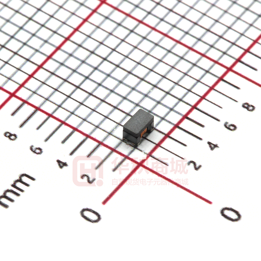

CMC0805S-900T
CMC0805S-900T
    FH(风华)
    SMD,2x1.2mm
    共模电感 330mA ±25% 350mΩ 90Ω CHOKE_2X1.2MM_SM
CMC0805S-900T 数据手册
WIRE WOUND CHIP COMMON MODE FILTERS FEATURES Minature size, suitable for SMT; With large coupling coefficient little impact on high-speed differential signal Prevention of common mode noise at high frequency; 67 2200 are optional for different noise level and signal frequency. APPLICATIONS USB lines of PC,peripheral equipments; LVDS lines of note PC,LCD; USB lines of small digital AV equipment,etc. ORDERING CODE CMC Code CMC 0805 S 900 Dimensions (L W ) (mm) 0805 2.0 1206 3.2 Design Symbol S 1.2 1.6 H Magnetically Shielded Open Magnetic T Impedance 900 90 371 370 222 2200 86 Packaging Style T B Tape&Reel Bulk WIRE WOUND CHIP COMMON MODE FILTERS DIMENSIONS Equivalent Circuit (Unit): mm/inch D E F G H I 2.0 0.2 1.2 0.2 1.2 0.2 CMC0805S (.078 .008) (.047 .008) (.047 .008) 0.45 (.018) 0.45 (.018) 2.60 (.102) 0.80 (.031) 1.20 (.047) 0.40 (.016) 3.2 0.2 1.6 0.2 1.8 0.2 CMC1206S (.126 .008) (.063 .008) (.071 .008) 0.60 (.024) 0.70 (.028) 3.70 (.146) 1.60 (.063) 1.60 (.063) 0.40 (.016) Par N0. A B C ELECTRICAL CHARACTERISTICS 0805 Series PartNumber Common Mode Impedance @100MHz( ) Rdc( ) Max Idc(mA) Max Max IR(M ) min CMC0805S-670T 67 25% 0.25 400 50 10 CMC0805S-900T 90 25% 0.35 330 50 10 CMC0805S-121T 120 25% 0.30 370 50 10 CMC0805S-181T 180 25% 0.35 330 50 10 CMC0805S-261T 260 25% 0.40 300 50 10 CMC0805S-301T 30 0 25% 0.42 290 50 10 CMC0805S-371T 370 25% 0.45 280 50 10 CMC0805S-601T 600 25% 0.60 220 50 10 Rdc( ) Max Idc(mA) Max Max IR(M ) min 1206 Series PartNumber Common Mode Impedance @100MHz( ) CMC1206S-900T 90 0.30 370 50 10 CMC1206S-161T 160 25% 0.40 340 50 10 CMC1206S-261T 260 25% 0.50 310 50 10 CMC1206S-601T 6 00 25% 0.80 260 50 10 25% 0.90 240 50 10 25% 1.00 230 50 10 25% 1.20 200 50 10 CMC1206S-801T CMC1206S-102T CMC1206S-222T 800 1000 2200 25% 87 CHARACTERISTIC CURVE FREQUENCY CHARACTERISTIC CMC0805S TYPE 1600 1200 800 400 0 1 10 Frequency[MHz] 100 1000 1 10 Frequency[MHz] 100 1000 1 10 1 10 100 75 50 25 0 CMC1206S TYPE 4000 3000 2000 1000 0 Frequency[MHz] 100 1000 350 280 210 140 70 0 Frequency[MHz] 88 100 1000 WIRE WOUND CHIP COMMON MODE FILTERS Electrical Specification Test Specified value N0. Item Test methods 0805 1206 1 Operating Temp. Range -40 ~+85 2 Storage Temp. Range -10 ~+40 CH102+1320 or HP4284A+HP42841A Test Equipment CH102+1320 or HP4284A+HP42841A Rated Current 4 Impedance 220~400mA(Max) 100MHz Test Frequency 100MHz HP4286A or HP4287A +16193A or 16197A Test Equipment HP4286A or HP4287A+16193A or 16197A 67~2200 HP4263B or HP4286A Test Equipment HP4263B or HP4286A 5 6 Rdc 0.25~1.2 (Max) TH2681 Test Equipment TH2681 60 Duration: 60S 50V Measurement voltage:50V 10M (Min) 89 Reliability Test Specified value N0. Item 1 Solderability 2 Resistance to soldering Thermal shock High Temperature storage 4 5 6 7 Low Temperature storage Damp heat (steady state) Test methods 0805 1206 At least 90% of terminal electrode is covered by new solder Appearance:No Damage ; Impedance:within 20% of initial value. Appearance:No Damage ; Impedance:within 20% of initial value. Appearance:No Damage ; Impedance:within 20% of initial value. Appearance:No Damage ; Impedance:within 20% of initial value. Appearance:No Damage ; Impedance:within 20% of initial value. Appearance:No Damage ; Vibration Terminal Strength (Pull of Test) : 260 5 Solder temp.: 260 5 10 1 Duration:10 1S emperature:-40 for 60 2min +85 for 60 2min 10 Number of cycles:10 Impedance:within 20% of initial value. 8 : 245 5 Solder temp.: 245 5 5 1 Duration:5 1S 0805 1206 0805 series 0.5Kg; 1206 series 1.0Kg 90 +85 2 Temperature:+85 96 2 Time: 96 2h -55 2 Temperature:-55 96 2 Time: 96 2h 2 2 90~95% RH Humidity:90 to 95% RH 50 2 Temperature:50 2 100 2 Duration: 100 2h 10~55~10Hz Frequency 10 to 55 to 10Hz 1.5mm Amplitude:1.5mm X Y Z 1 45 Directions: 1 hours 45minutes each in X,Y,Z direction. WIRE WOUND CHIP COMMON MODE FILTERS Reliability Test Specified value N0. 9 Item Test methods 0805 1206 Appearance:No Damage ; Drop Impedance:within 20% of initial value. Dropped 10 times on a concrete floor from a height of 1m. Flexure:20mm 10 Appearance:No Damage ; Flextrue strength Impedance:within 20% of initial value. Appearance:No Damage ; Provide 2 times the rated current of direct current between inductor terminals, Direct current error 5%, and for 5 minutes. 11 Inductors shall not have a open winding. 12 Test board:Glass -Epoxy board Thickness:0.8mm Appearance:No Damage ; Impedance:within 20% of initial value. 91 Packaging Style Tape Unit(mm) A B T 0805 1.50 2.25 1.40 1206 1.90 3.55 Type Unit(mm) A 2.10 178 B 60 C 13 D 21 E 2 W 10 Peeling off force Pull strength 0805~1206 20g ~80g 300mm/min 165 to 180 degree Speed of peeling off 10% Cover tape Plastic tape Packaging Quantity Dimension F 0805 1206 3000 2000 15000 10000 92 t 2 R 1
