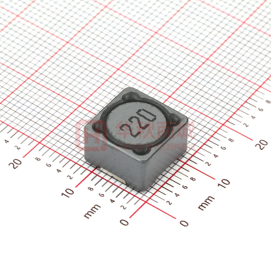

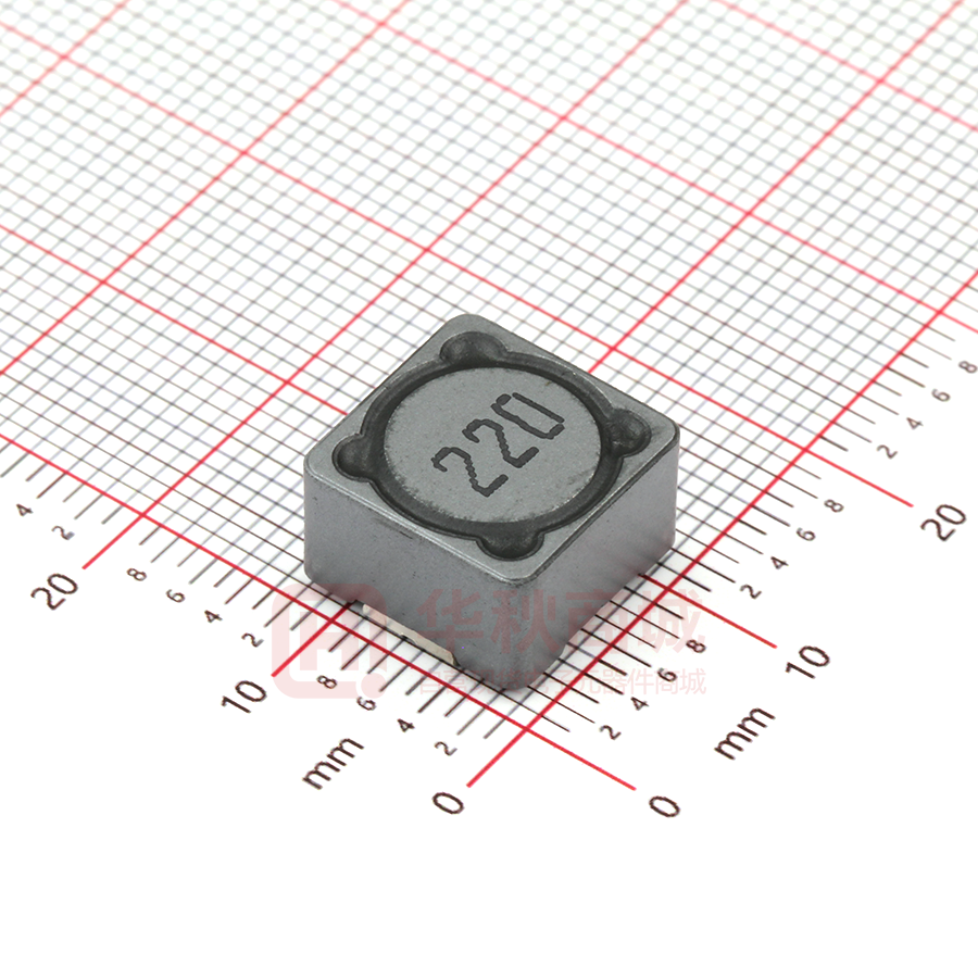

MS127-220MT
MS127-220MT
    FH(风华)
    SMD,12.2x12.2mm
    功率电感 22µH ±20% 43.2mΩ IND_12.2X12.2MM_SM
MS127-220MT 数据手册
MS MS SERIES SMD POWER INDUCTORS MS MS SERIES SMD POWER INDUCTORS FEATURES High saturation current Magnetic shielded SMT type, suitable for reflow solding. APPLICATION OA equipment, Notebook Computer , LCD LCD televisions DC/DC DC/DC converters etc. ORDERING CODE MS 101 127 M T (L Product Code MS W T) ( Dimensions (L W T) (mm) MS 73 7.3 7.3 7.3 H) Tolerance Inductance 150 15 101 100 102 1000 3.4 74 7.3 4.2 124 12.2 12.2 4.5 127 12.2 12.2 7.5 Packaging Style M 20% N 30% T B Tape&Reel Bulk SHAPE AND DIMENSIONS Unit mm Part MS62 A1 A 5.9 0.3 6.6 0.3 6.2 0.3 2.7 113 F E C B 0.3 6.6 0.3 4.6 F 0.2 1.5 0.2 Unit mm A B MS73 7.3 0.3 MS74 C D E 7.3 0.3 3.4 0.3 5.0 2.0 7.3 0.3 7.3 0.3 4.2 0.3 5.0 2.0 MS124 12.2 0.4 12.2 0.4 4.5 0.3 7.6 5.0 MS125 12.2 0.4 12.2 0.4 5.7 0.3 7.6 5.0 Ms127 12.2 0.4 12.2 0.4 7.5 0.3 7.6 5.0 Part C B A MS104R Unit mm Part MS104R A B C D E F 10.2 0.3 10.0 0.3 4.0MAX 7.8 3.0 1.2 ELECTRICAL CHARACTERISTICS MS62 Series L( Part Number 6.8 10 15 22 33 47 100 MS62-6R8NT MS 62 -100MT MS 62 -150MT MS 62 -220MT MS 62 -330MT MS 62 -470MT MS 62 -101MT Isat: H) Isat Test Freq. Tolerance 1kHz 1kHz 1kHz 1kHz 1kHz 1kHz 1kHz 30% 20% 20% 20% 20% 20% 20% DCR( )Max 0.120 0.170 0.260 0.380 0.480 0.770 1.500 Isat(A) 1.70 1.60 1.30 1.00 0.64 0.53 0.45 20% Isat: Saturation Current, the current when the inductance becomes 20% lower than its initial value. 114 MS MS SERIES SMD POWER INDUCTORS MS73 Series L( Part Number MS73-1R0NT MS73-2R2NT MS73-100MT MS73-120MT MS73-150MT MS73-180MT MS73-220MT MS73-270MT MS73-330MT MS73-390MT MS73-470MT MS73-560MT MS73-680MT MS73-820MT MS73-101MT MS73-121MT MS73-151MT MS73-181MT MS73-221MT MS73-271MT MS73-331MT MS73-391MT MS73-471MT MS73-561MT MS73-681MT MS73-821MT MS73-102MT H) 1.0 2.2 10 12 15 18 22 27 33 39 47 56 68 82 100 120 150 180 220 270 330 390 470 560 680 820 1000 Test Freq. Tolerance 30% 30% 20% 20% 20% 20% 20% 20% 20% 20% 20% 20% 20% 20% 20% 20% 20% 20% 20% 20% 20% 20% 20% 20% 20% 20% 20% Isat(A) DCR( 1kHz 1kHz 1kHz 1kHz 1kHz 1kHz 1kHz 1kHz 1kHz 1kHz 1kHz 1kHz 1kHz 1kHz 1kHz 1kHz 1kHz 1kHz 1kHz 1kHz 1kHz 1kHz 1kHz 1kHz 1kHz 1kHz 1kHz )Max 0.025 0.035 0.072 0.098 0.130 0.140 0.190 0.210 0.240 0.320 0.360 0.470 0.520 0.690 0.790 0.890 1.270 1.450 1.650 2.310 2.620 2.940 4.180 4.670 5.730 6.540 9.440 3.60 2.50 1.68 1.52 1.33 1.20 1.07 0.96 0.91 0.77 0.76 0.68 0.61 0.57 0.50 0.49 0.43 0.39 0.35 0.32 0.28 0.26 0.24 0.22 0.19 0.18 0.16 Ms74 Series L( Part Number MS74-1R0NT MS74-2R2NT MS74-100MT MS74-120MT MS74-150MT MS74-180MT MS74-220MT MS74-330MT MS74-390MT MS74-470MT MS74-560MT MS74-680MT MS74-820MT MS74-101MT MS74-121MT MS74-151MT MS74-181MT MS74-221MT MS74-271MT MS74-331MT MS74-391MT MS74-471MT MS74-561MT MS74-681MT MS74-821MT MS74-102MT Isat: H) 1.0 2.2 10 12 15 18 22 33 39 47 56 68 82 100 120 150 180 220 270 330 390 470 560 680 820 1000 Isat Test Freq. Tolerance 30% 30% 20% 20% 20% 20% 20% 20% 20% 20% 20% 20% 20% 20% 20% 20% 20% 20% 20% 20% 20% 20% 20% 20% 20% 20% 1kHz 1kHz 1kHz 1kHz 1kHz 1kHz 1kHz 1kHz 1kHz 1kHz 1kHz 1kHz 1kHz 1kHz 1kHz 1kHz 1kHz 1kHz 1kHz 1kHz 1kHz 1kHz 1kHz 1kHz 1kHz 1kHz DCR( )Max 0.022 0.030 0.049 0.058 0.081 0.091 0.110 0.170 0.230 0.260 0.350 0.380 0.430 0.610 0.660 0.880 0.980 1.170 1.640 1.860 2.850 3.010 3.620 4.630 5.200 6.000 Isat(A) 6.00 3.00 1.84 1.71 1.47 1.31 1.23 0.96 0.91 0.88 0.75 0.69 0.61 0.60 0.52 0.46 0.42 0.36 0.34 0.32 0.29 0.26 0.23 0.22 0.20 0.18 20% Isat: Saturation Current, the current when the inductance becomes 20% lower than its initial value. 115 MS104R Series L( Part Number MS104R-1R5NT MS104R-2R5NT MS104R-3R3NT MS104R-3R8NT MS104R-4R7NT MS104R-5R2NT MS104R-7R0NT MS104R-100MT MS104R-120MT MS104R-150MT MS104R-180MT MS104R-220MT MS104R-270MT MS104R-330MT MS104R-470MT MS104R-680MT MS104R-820MT MS104R-101MT MS104R-151MT MS104R-181MT MS104R-221MT MS104R-271MT MS104R-331MT MS104R-471MT H) 1.5 2.5 3.3 3.8 4.7 5.2 7.0 10 12 15 18 22 27 33 47 68 82 100 150 180 220 270 330 470 Test Freq. Tolerance 30% 30% 30% 30% 30% 30% 30% 20% 20% 20% 20% 20% 20% 20% 20% 20% 20% 20% 20% 20% 20% 20% 20% 20% 100kHz 100kHz 100kHz 100kHz 100kHz 100kHz 100kHz 100kHz 100kHz 100kHz 100kHz 100kHz 100kHz 100kHz 100kHz 100kHz 100kHz 100kHz 100kHz 100kHz 100kHz 100kHz 100kHz 100kHz DCR( )Max 0.017 0.021 0.035 0.035 0.028 0.028 0.038 0.043 0.060 0.068 0.070 0.090 0.117 0.120 0.190 0.350 0.385 0.430 0.506 0.627 0.756 0.950 1.090 1.900 Isat(A) 10.0 7.50 6.00 6.00 5.50 5.50 4.80 4.40 4.00 3.60 3.30 2.90 2.60 2.40 2.10 1.50 1.45 1.35 1.15 1.00 0.92 0.75 0.70 0.60 MS124 Series L( Part Number 1.0 1.6 3.9 4.7 6.2 6.8 10 12 15 18 22 27 33 39 47 56 68 82 100 120 150 180 220 270 330 470 1500 33000 MS124-1R0NT MS124-1R6NT MS124-3R9NT MS124-4R7NT MS124-6R2NT MS124-6R8NT MS124-100MT MS124-120MT MS124-150MT MS124-180MT MS124-220MT MS124-270MT MS124-330MT MS124-390MT MS124-470MT MS124-560MT MS124-680MT MS124-820MT MS124-101MT MS124-121MT MS124-151MT MS124-181MT MS124-221MT MS124-271MT MS124-331MT MS124-471MT MS124-152MT MS124-333MT Isat: H) Isat Tolerance Test Freq. 30% 30% 30% 30% 30% 30% 20% 20% 20% 20% 20% 20% 20% 20% 20% 20% 20% 20% 20% 20% 20% 20% 20% 20% 20% 20% 20% 20% 100kHz 100kHz 100kHz 100kHz 100kHz 100kHz 100kHz 100kHz 100kHz 100kHz 100kHz 100kHz 100kHz 100kHz 100kHz 100kHz 100kHz 100kHz 100kHz 100kHz 100kHz 100kHz 100kHz 100kHz 100kHz 100kHz 100kHz 100kHz DCR( )Max 0.008 0.009 0.018 0.022 0.028 0.028 0.035 0.038 0.050 0.057 0.066 0.080 0.097 0.132 0.150 0.190 0.220 0.260 0.308 0.380 0.530 0.620 0.700 0.876 0.990 1.300 4.000 95.000 Isat(A) 12.00 8.00 6.50 5.70 4.90 4.90 4.50 4.00 3.20 3.10 2.90 2.80 2.70 2.10 1.90 1.80 1.50 1.30 1.20 1.10 0.95 0.85 0.80 0.60 0.50 0.40 0.29 0.07 20% Isat: Saturation Current, the current when the inductance becomes 20% lower than its initial value. 116 MS MS SERIES SMD POWER INDUCTORS MS125 Series L( Part Number 1.3 2.1 3.1 4.4 5.8 7.5 10 12 15 18 22 27 33 39 47 56 68 82 100 120 150 180 220 270 330 390 470 560 680 820 1000 4700 8000 10000 MS125-1R3NT MS125-2R1NT MS125-3R1NT MS125-4R4NT MS125-5R8NT MS125-7R5NT MS125-100MT MS125-120MT MS125-150MT MS125-180MT MS125-220MT MS125-270MT MS125-330MT MS125-390MT MS125-470MT MS125-560MT MS125-680MT MS125-820MT MS125-101MT MS125-121MT MS125-151MT MS125-181MT MS125-221MT MS125-271MT MS125-331MT MS125-391MT MS125-471MT MS125-561MT MS125-681MT MS125-821MT MS125-102MT MS125-472MT MS125-802MT MS125-103MT Isat: H) Isat Test Freq. Tolerance 30% 30% 30% 30% 30% 30% 20% 20% 20% 20% 20% 20% 20% 20% 20% 20% 20% 20% 20% 20% 20% 20% 20% 20% 20% 20% 20% 20% 20% 20% 20% 20% 20% 20% 100kHz 100kHz 100kHz 100kHz 100kHz 100kHz 1kHz 1kHz 1kHz 1kHz 1kHz 1kHz 1kHz 1kHz 1kHz 1kHz 1kHz 1kHz 1kHz 1kHz 1kHz 1kHz 1kHz 1kHz 1kHz 1kHz 1kHz 1kHz 1kHz 1kHz 1kHz 1kHz 1kHz 1kHz DCR( )Max 0.012 0.014 0.017 0.020 0.021 0.024 0.025 0.027 0.030 0.034 0.042 0.051 0.065 0.068 0.075 0.110 0.120 0.140 0.198 0.220 0.230 0.290 0.400 0.460 0.510 0.690 0.770 0.860 1.200 1.340 1.900 8.280 15.000 20.000 Isat(A) 8.00 7.00 6.00 5.00 4.40 4.20 4.00 3.50 3.30 3.00 2.80 2.30 2.10 2.00 1.80 1.70 1.50 1.40 1.30 1.10 1.00 0.90 0.80 0.75 0.68 0.65 0.58 0.54 0.48 0.43 0.40 0.30 0.22 0.12 20% Isat: Saturation Current, the current when the inductance becomes 20% lower than its initial value. 117 MS127 Series L( Part Number MS127-1R0NT MS127-2R2NT MS127-3R3NT MS127-4R7NT MS127-100MT MS127-120MT MS127-150MT MS127-180MT MS127-220MT MS127-270MT MS127-330MT MS127-390MT MS127-470MT MS127-560MT MS127-680MT MS127-820MT MS127-101MT MS127-121MT MS127-151MT MS127-181MT MS127-221MT MS127-271MT MS127-331MT MS127-391MT MS127-471MT MS127-561MT MS127-681MT MS127-821MT MS127-102MT Isat: H) 1.0 2.2 3.3 4.7 10 12 15 18 22 27 33 39 47 56 68 82 100 120 150 180 220 270 330 390 470 560 680 820 1000 Isat Tolerance 30% 30% 30% 30% 20% 20% 20% 20% 20% 20% 20% 20% 20% 20% 20% 20% 20% 20% 20% 20% 20% 20% 20% 20% 20% 20% 20% 20% 20% Test Freq. 100kHz 100kHz 100kHz 100kHz 1kHz 1kHz 1kHz 1kHz 1kHz 1kHz 1kHz 1kHz 1kHz 1kHz 1kHz 1kHz 1kHz 1kHz 1kHz 1kHz 1kHz 1kHz 1kHz 1kHz 1kHz 1kHz 1kHz 1kHz 1kHz DCR( )Max 0.0070 0.0115 0.0135 0.0158 0.0216 0.0243 0.0270 0.0392 0.0432 0.0459 0.0648 0.0729 0.1000 0.110 0.140 0.160 0.220 0.250 0.280 0.350 0.390 0.560 0.640 0.700 0.980 1.070 1.460 1.640 1.820 Isat(A) 9.80 7.50 7.50 6.80 5.40 4.90 4.50 3.90 3.60 3.40 3.00 2.75 2.50 2.35 2.10 1.95 1.70 1.60 1.42 1.30 1.16 1.06 0.95 0.88 0.79 0.73 0.67 0.60 0.55 20% Isat: Saturation Current, the current when the inductance becomes 20% lower than its initial value. 118
