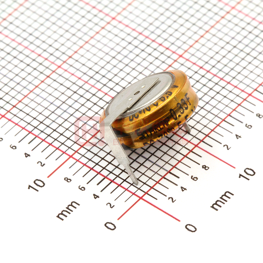

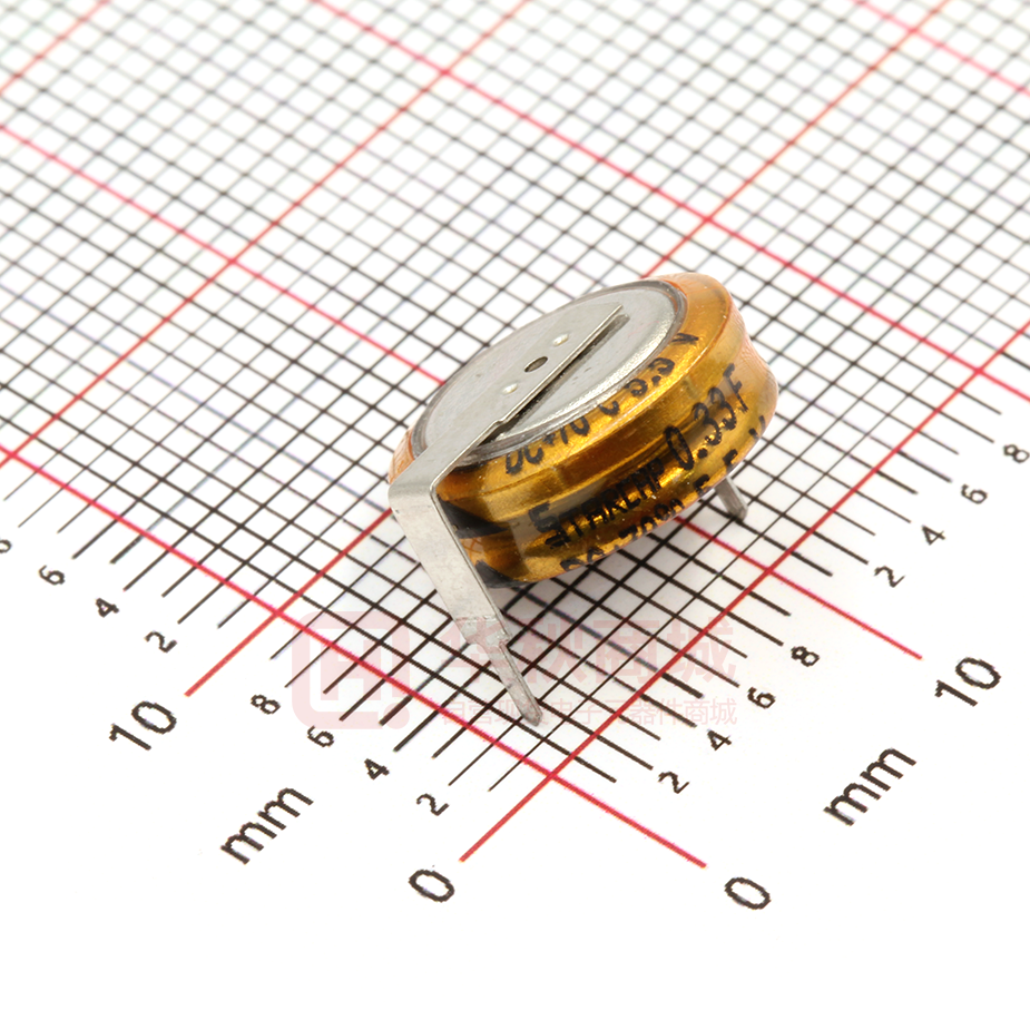

DCS series | Features | • Smaller and lighter than DCL Series • Small-sized, large capacity • Wider operating temperature range(-25~70℃) than normal batteries | Applications | • Memory back-up for Video, Audio, Cameras, CCTV, Printer, Camcorder, Telephones, Car stereo, E-meter, Toy, Computer, Notebook PC, Rice cooker, Home network etc V-TYPE H-TYPE C-TYPE | Specifications | Items Characteristics Maximum operating voltage 5.5VDC Operating temperature -25 to +70℃ Nominal Cap. range 0.047 to 0.47F Capacitance tolerance -20% to +80%(at 25℃) Characteristics at Low temperature(-25℃) Capacitance change : ≤ 50% of the initial value at +25℃ Internal resistance : Less than five times of the initial value at +25℃ After 1,000hours application of rated DC working voltage at +70℃, the capacitor shall meet the following limits. • Capacitance change : ±30% of the initial value • Internal resistance : Less than four times of the initial value Endurance After 1,000hours storage at +70℃ without load, the capacitor shall meet the specified limit for “Endurance” Shelf life | Dimensions in mm(not to scale) | V-TYPE H-TYPE C-TYPE 0,9±0,1 1,2±0,1 5,5±0,5 | Standard products | Capacitance (F) ESR (Ω, @1kHz) DCS 5R5 473 0.047 ≤ 120 DCS 5R5 104 0.10 Part Number Operating Voltage (V) V type(mm) P ΦD H 11.5 12.5 5.0 11.5 5.5 ≤ 75 11.5 12.5 5.0 11.5 0.22 ≤ 75 11.5 12.5 5.0 DCS 5R5 334 0.33 ≤ 50 11.5 12.5 DCS 5R5 474 0.47 ≤ 50 11.5 12.5 DCS 5R5 224 5.5 ΦD H H type(mm) P C type(mm) ΦD H P 10.0 13.5 7.0 5.0 5.5 10.0 13.5 7.0 5.0 11.5 5.5 10.0 13.5 7.0 5.0 5.0 11.5 5.5 10.0 13.5 7.0 5.0 5.0 11.5 5.5 10.0 13.5 7.0 5.0 Note : It is not allowed to go through reflow (IR, Atmosphere heating methods etc.) process Homepage : http://www.korchip.com Head office : 82-31-361-8031~6 (Fax : 82-31-361-8080) E-mail : starcap@korchip.com
