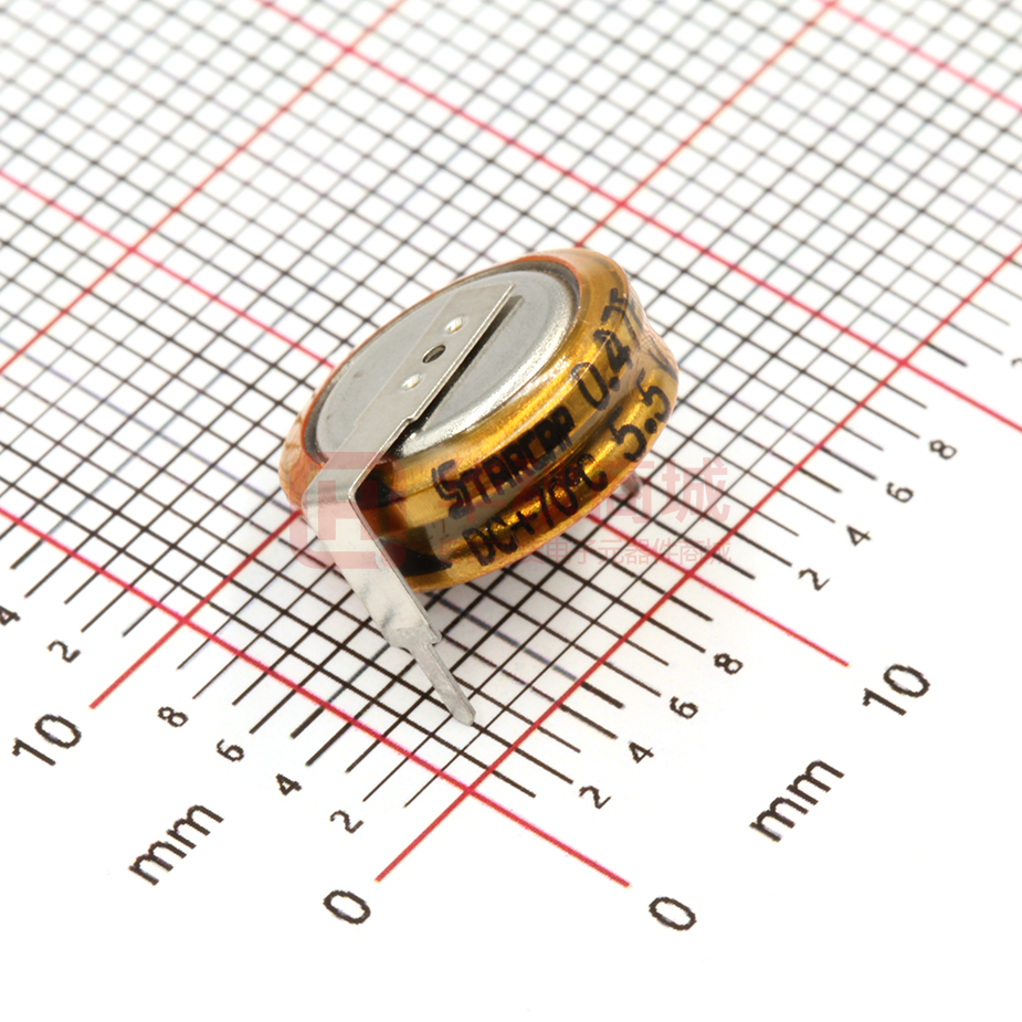

DCS series
| Features |
• Smaller and lighter than DCL Series
• Small-sized, large capacity
• Wider operating temperature range(-25~70℃) than normal batteries
| Applications |
• Memory back-up for Video, Audio, Cameras, CCTV, Printer,
Camcorder, Telephones, Car stereo, E-meter, Toy, Computer,
Notebook PC, Rice cooker, Home network etc
V-TYPE
H-TYPE
C-TYPE
| Specifications |
Items
Characteristics
Maximum operating voltage
5.5VDC
Operating temperature
-25 to +70℃
Nominal Cap. range
0.047 to 0.47F
Capacitance tolerance
-20% to +80%(at 25℃)
Characteristics
at Low temperature(-25℃)
Capacitance change : ≤ 50% of the initial value at +25℃
Internal resistance : Less than five times of the initial value at +25℃
After 1,000hours application of rated DC working voltage at +70℃, the capacitor shall meet
the following limits.
• Capacitance change : ±30% of the initial value
• Internal resistance : Less than four times of the initial value
Endurance
After 1,000hours storage at +70℃ without load, the capacitor shall meet
the specified limit for “Endurance”
Shelf life
| Dimensions in mm(not to scale) |
V-TYPE
H-TYPE
C-TYPE
0,9±0,1
1,2±0,1
5,5±0,5
| Standard products |
Capacitance (F)
ESR
(Ω, @1kHz)
DCS 5R5 473
0.047
≤ 120
DCS 5R5 104
0.10
Part Number
Operating
Voltage (V)
V type(mm)
P
ΦD
H
11.5 12.5
5.0
11.5
5.5
≤ 75
11.5 12.5
5.0
11.5
0.22
≤ 75
11.5 12.5
5.0
DCS 5R5 334
0.33
≤ 50
11.5 12.5
DCS 5R5 474
0.47
≤ 50
11.5 12.5
DCS 5R5 224
5.5
ΦD
H
H type(mm)
P
C type(mm)
ΦD
H
P
10.0 13.5
7.0
5.0
5.5
10.0 13.5
7.0
5.0
11.5
5.5
10.0 13.5
7.0
5.0
5.0
11.5
5.5
10.0 13.5
7.0
5.0
5.0
11.5
5.5
10.0 13.5
7.0
5.0
Note : It is not allowed to go through reflow (IR, Atmosphere heating methods etc.) process
