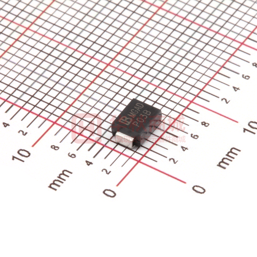

    半导体放电管 SMB VDRM=25V VT=4V IT=2.2A Ipp=80A
P0300SB 数据手册
PXXXXSX SERIES Thyristor Surge Suppressors (TSS) Data Sheet Description DO-214AA Thyristor solid state protection thyristor protect telecommunications equipment such as modems, line cards, fax machines, and other CPE. P Series devices are used to enable equipment to meet various regulatory requirements including GR 1089, ITU K.20, K.21 and K.45, IEC 60950, UL 60950, and TIA-968 (formerly known as FCC Part 68). Features Compared to surge suppression using other technologies, P Series devices offer absolute surge protection regardless of the surge current available and the rate of applied voltage (dv/dt). P Series devices: ■ Cannot be damaged by voltage ■ Eliminate hysteresis and heat dissipation typically found with clamping devices ■ Eliminate voltage overshoot caused by fast-rising transients ■ Are non-degenerative ■ Will not fatigue ■ Have low capacitance, making them ideal for high-speed transmission equipment ■ Meets MSL level 1, per J-STD-020 ■ Safety certification: UL: E244458 Electrical Parameters Parameter Definition VDRM Peak Off-state Voltage – maximum voltage that can be applied while maintaining off state VS Switching Voltage – maximum voltage prior to switching to on state VT On-state Voltage – maximum voltage measured at rated on-state current IDRM Leakage Current – maximum peak off-state current measured at VDRM IS Switching Current – maximum current required to switch to on state IT On-state Current – maximum rated continuous on-state current IH Holding Current – minimum current required to maintain on state CO Off-state Capacitance – typical capacitance measured in off state VPP Peak Pulse Voltage – maximum rated peak impulse voltage IPP Peak Pulse Current – maximum rated peak impulse current Revision:16-Sep-14 www.brightking.com PXXXXSX SERIES Electrical Characteristics Part Number VDRM (V) VS (V) VT (V) IDRM (μA) IS (mA) IT (A) IH (mA) CO (pF) VPP 10/700μs (V) IPP 10/1000μs (A) Marking P0080SA 6 25 4 5 800 2.2 50 50 2000 45 P008A P0080SB 6 25 4 5 800 2.2 50 70 4000 80 P008B P0080SC 6 25 4 5 800 2.2 50 100 6000 100 P008C P0300SA 25 40 4 5 800 2.2 50 70 2000 45 P03A P0300SB 25 40 4 5 800 2.2 50 70 4000 80 P03B P0300SC 25 40 4 5 800 2.2 50 100 6000 100 P03C P0640SA 58 77 4 5 800 2.2 150 50 2000 45 P06A P0640SB 58 77 4 5 800 2.2 150 60 4000 80 P06B P0640SC 58 77 4 5 800 2.2 150 100 6000 100 P06C P0720SA 65 88 4 5 800 2.2 150 50 2000 45 P07A P0720SB 65 88 4 5 800 2.2 150 60 4000 80 P07B P0720SC 65 88 4 5 800 2.2 150 100 6000 100 P07C P0900SA 75 98 4 5 800 2.2 150 45 2000 45 P09A P0900SB 75 98 4 5 800 2.2 150 55 4000 80 P09B P0900SC 75 98 4 5 800 2.2 150 90 6000 100 P09C P1100SA 90 130 4 5 800 2.2 150 45 2000 45 P11A P1100SB 90 130 4 5 800 2.2 150 55 4000 80 P11B P1100SC 90 130 4 5 800 2.2 150 90 6000 100 P11C P1300SA 120 160 4 5 800 2.2 150 45 2000 45 P13A P1300SB 120 160 4 5 800 2.2 150 55 4000 80 P13B P1300SC 120 160 4 5 800 2.2 150 90 6000 100 P13C P1500SA 140 180 4 5 800 2.2 150 40 2000 45 P15A P1500SB 140 180 4 5 800 2.2 150 60 4000 80 P15B P1500SC 140 180 4 5 800 2.2 150 85 6000 100 P15C P1800SA 170 220 4 5 800 2.2 150 40 2000 45 P18A P1800SB 170 220 4 5 800 2.2 150 60 4000 80 P18B P1800SC 170 220 4 5 800 2.2 150 85 6000 100 P18C P2300SA 190 260 4 5 800 2.2 150 35 2000 45 P23A P2300SB 190 260 4 5 800 2.2 150 55 4000 80 P23B P2300SC 190 260 4 5 800 2.2 150 80 6000 100 P23C Revision:16-Sep-14 www.brightking.com PXXXXSX SERIES Electrical Characteristics Part Number VDRM (V) VS (V) VT (V) IDRM (μA) IS (mA) IT (A) IH (mA) CO (pF) VPP 10/700μs (V) IPP 10/1000μs (A) Marking P2600SA 220 300 4 5 800 2.2 150 35 2000 45 P26A P2600SB 220 300 4 5 800 2.2 150 50 4000 80 P26B P2600SC 220 300 4 5 800 2.2 150 80 6000 100 P26C P3100SA 275 350 4 5 800 2.2 150 30 2000 45 P31A P3100SB 275 350 4 5 800 2.2 150 45 4000 80 P31B P3100SC 275 350 4 5 800 2.2 150 65 6000 100 P31C P3500SA 320 400 4 5 800 2.2 150 30 2000 45 P35A P3500SB 320 400 4 5 800 2.2 150 40 4000 80 P35B P3500SC 320 400 4 5 800 2.2 150 65 6000 100 P35C Notes: ·All measurements are made at an ambient temperature of 25℃. IPP applies to -40℃ through +85℃ temperature range. ·Off-state capacitance(CO) is measured at 1 MHz with a 2V bias and is typical value. Thermal Considerations Package DO-214AA/SMB Symbol Parameter Value Unit TJ Operating Junction Temperature -40 to +150 ℃ TS Storage Temperature Range -40 to +150 ℃ RθJA Junction to Ambient on printed circuit 90 ℃/W Part Number Code and Marking Revision:16-Sep-14 www.brightking.com PXXXXSX SERIES Characteristics Curves Figure 1. V-I Characteristics Figure 2. tr × td Pulse Wave-form Figure 3. Normalized Vs Change versus Junction Temperature Figure 4. Normalized DC Holding Current versus Case Temperature Revision:16-Sep-14 www.brightking.com PXXXXSX SERIES Recommended Soldering Conditions Reflow Soldering Recommended Conditions Profile Feature Pb-Free Assembly Average ramp-up rate (TL to TP) 3℃/second max. Preheat -Temperature Min (TS min) -Temperature Max (TS max) -Time (min to max) ( tS) 150℃ 200℃ 60-180 seconds TS max to TL -Ramp-up Rate 3℃/second max. Time maintained above: -Temperature (TL) -Time (tL) 217℃ 60-150 seconds Peak Temperature (TP) 260℃ Time within 5℃ of actual Peak Temperature (tP) Ramp-down Rate Time 25℃ to Peak Temperature Revision:16-Sep-14 20-40 seconds 6℃/second max. 8 minutes max. www.brightking.com PXXXXSX SERIES Dimensions (SMB/DO-214AA) Symbol Millimeters Inches Min. Max. Min. Max. L 4.06 4.70 0.160 0.185 D 3.30 3.94 0.130 0.155 D1 1.90 2.20 0.075 0.086 T 5.21 5.59 0.205 0.220 T1 0.76 1.52 0.030 0.060 d - 0.203 - 0.008 H 1.95 2.65 0.077 0.104 Packaging Tape Reel Symbol Dimension (mm) W 12.00±0.30 P0 4.00±0.10 P1 8.00±0.10 P2 2.00±0.10 D0 Φ1.55±0.05 D1 Φ1.55±0.05 E 1.75±0.10 F 5.50±0.10 A0 3.76±0.10 B0 5.69±0.10 K0 2.70±0.10 T 0.25±0.10 D2 Φ330.0±2.0 D3 Φ13.5±0.5 H 2.5±0.5 W1 16.0±1.0 Quantity: 2500PCS P0080SB: 3000PCS Revision:16-Sep-14 www.brightking.com
