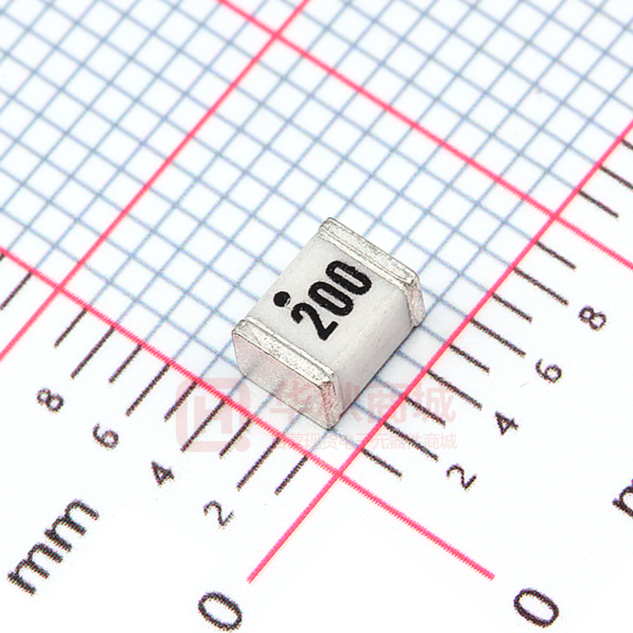

4532 SERIES
Gas Discharge Tube (GDT) Data Sheet
Features
High insulation resistance
Low capacitance (≤0.5pF)
2000A 8/20μs maximum surge current capacity in accordance with IEC61000-4-5
4KV 10/700μs maximum surge rating in accordance with ITU-TK.21
Surface mounted gas arrester
Micro-Gap Design
Size 4532(1812)
Storage and operating temperature: -40℃ ~ +85℃
Meets MSL level 1, per J-STD-020

090: Device Marking Code

Electrical Characteristics
DC
Spark-over
Voltage
Maximum
Impulse
Spark-over
Voltage
Impulse
Life
Test
Maximum
Capacitance
Nominal
Impulse
Discharge
Current
100V/s
1KV/μs
8/20μs
100A
Test
Voltage
(1MHz 1V)
8/20μs
(V)
(V)
(Times)
DC(V)
(pF)
(A)
4532-075-LF
55~95
600
300
25
1
0.5
2000
075
4532-091-LF
63~117
700
300
50
1
0.5
2000
090
4532-121-LF
84~156
700
300
50
1
0.5
2000
120
4532-151-LF
105~195
700
300
50
1
0.5
2000
150
4532-201-LF
140~260
750
300
100
1
0.5
2000
200
4532-231-LF
161~299
750
300
100
1
0.5
2000
10/700μs
230
4532-301-LF
210~390
900
300
100
1
0.5
2000
4kV
300
4532-351-LF
245~455
900
300
100
1
0.5
2000
±5 Times
350
4532-401-LF
280~520
1000
300
100
1
0.5
2000
400
4532-421-LF
294~546
1000
300
100
1
0.5
2000
420
4532-471-LF
329~611
1000
300
100
1
0.5
2000
470
4532-501-LF
350~650
1100
300
100
1
0.5
2000
500
4532-601-LF
420~780
1200
300
100
1
0.5
2000
600
Part
Number
Minimum
Insulation
Resistance
(GΩ)
Impulse
Withstanding
Voltage
Capacity
Device
Marking
Code
