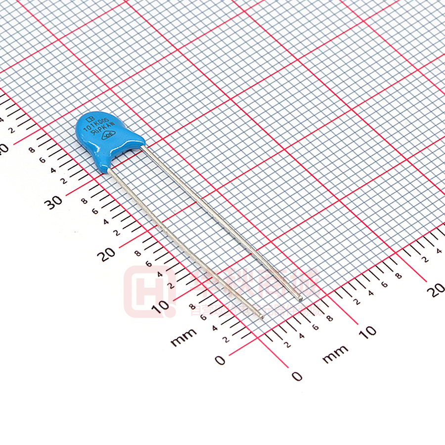

101KD05 数据手册
5Φ SERIES Metal Oxide Varistor (MOV) Data Sheet Features ■ ■ ■ ■ ■ ■ ■ ■ Wide operating voltage (V1mA) range from 18V to 750V Fast responding to transient over-voltage Large absorbing transient energy capability Low clamping ratio and no follow-on current Meets MSL level 1, per J-STD-020 Operating Temperature:-40℃ ~ +85℃ Storage Temperature:-40℃ ~ +125℃ Safety certification: UL: E327997 CSA: 246579 VDE: 40027827 Applications ■ ■ ■ ■ ■ Transistor, diode, IC, thyristor or triac semiconductor protection Surge protection in consumer electronics Surge protection in industrial electronics Surge protection in electronic home appliances, gas and petroleum appliances Relay and electromagnetic valve surge absorption Part Number Code No suffix: Bulk TB: Tape & Box TR: Tape & Reel K: ±10% D: Disk 180: 18V 101: 100V 102: 1000V Revision:13-Apr.-18 No suffix: Standard type J: High Surge type No suffix: Straight leads O: Outside crimped leads 05~53 1 / 11 www.brightking.com 5Φ SERIES Dimensions Table 1 Table 2 Unit: mm Unit: mm Symbol Dimension Model T e Model T e H 5.5~10.0 180K 1.5~4.5 1.3 221K 2.0~4.5 1.9 H1 8.0~13.0 220K 1.6~4.6 1.4 241K 2.1~4.6 2.0 L(min.) 20.0 270K 1.6~4.7 1.6 271K 2.1~4.9 2.2 L1(min.) 15.0 330K 1.7~4.9 1.5 301K 2.2~5.0 2.3 D 5.0~7.5 390K 1.6~4.8 1.6 331K 2.2~5.1 2.3 F(±0.8) 5.0 470K 1.7~4.9 1.7 361K 2.4~5.2 2.5 T Table 2 560K 1.8~5.0 1.9 391K 2.5~5.4 2.6 e(±0.8) Table 2 680K 1.9~5.2 2.2 431K 2.7~5.7 2.8 d(±0.05) 0.6 820K 1.6~4.1 1.6 471K 2.8~6.0 3.0 d1(±0.4) 1.2 101K 1.9~4.3 1.8 511K 2.9~6.2 3.2 121K 1.9~4.5 2.0 561K 3.1~6.5 3.4 151K 1.7~4.8 1.6 621K 3.3~6.5 3.7 181K 1.8~4.3 1.7 681K 3.5~6.8 4.0 201K 1.9~4.4 1.8 751K 3.8~6.9 4.1 Revision:13-Apr.-18 2 / 11 www.brightking.com 5Φ SERIES Electrical Characteristics Maximum Part Allowable Number Standard Voltage High Surge VAC(V) VDC(V) Varistor Voltage V1mA(V) Maximum Withstanding Maximum Clamping Surge Energy Voltage Current (10/1000μs) IP(A) VC(V) I (A) Standard I (A) High Surge (J) Standard Rated Power Typical Capacitance (Reference) (J) High (W) @1KHz (pf) Surge 180KD05 180KD05J 11 14 18(15~21.6) 1 40 100 250 0.4 0.6 0.01 1400 220KD05 220KD05J 14 18 22(19.5~26) 1 48 100 250 0.5 0.7 0.01 1150 270KD05 270KD05J 17 22 27(24~31) 1 60 100 250 0.6 0.9 0.01 930 330KD05 330KD05J 20 26 33(29.5~36.5) 1 73 100 250 0.8 1.1 0.01 760 390KD05 390KD05J 25 31 39(35~43) 1 80 100 250 0.9 1.2 0.01 640 470KD05 470KD05J 30 38 47(42~52) 1 104 100 250 1.1 1.5 0.01 530 560KD05 560KD05J 35 45 56(50~62) 1 123 100 250 1.3 1.8 0.01 450 680KD05 680KD05J 40 56 68(61~75) 1 145 100 250 1.6 2.2 0.01 370 820KD05 820KD05J 50 65 82(74~90) 5 150 400 800 2.5 4.0 0.1 300 101KD05 101KD05J 60 85 100(90~110) 5 177 400 800 3.0 4.1 0.1 250 121KD05 121KD05J 75 100 120(108~132) 5 210 400 800 4.0 4.9 0.1 210 151KD05 151KD05J 95 125 150(135~165) 5 260 400 800 4.1 6.5 0.1 165 181KD05 181KD05J 115 150 180(162~198) 5 320 400 800 4.9 7.5 0.1 140 201KD05 201KD05J 130 170 200(180~220) 5 355 400 800 6.5 8.5 0.1 125 221KD05 221KD05J 140 180 220(198~242) 5 380 400 800 7.5 9.0 0.1 110 241KD05 241KD05J 150 200 240(216~264) 5 415 400 800 8.0 10.5 0.1 100 271KD05 271KD05J 175 225 270(243~297) 5 475 400 800 8.5 11.0 0.1 95 301KD05 301KD05J 190 250 300(270~330) 5 520 400 800 9.0 12.0 0.1 85 331KD05 331KD05J 210 275 330(297~363) 5 570 400 800 9.5 13.0 0.1 75 361KD05 361KD05J 230 300 360(324~396) 5 620 400 800 10.0 16.0 0.1 70 391KD05 391KD05J 250 320 390(351~429) 5 675 400 800 12.0 17.0 0.1 65 431KD05 431KD05J 275 350 430(387~473) 5 745 400 800 13.0 20.0 0.1 60 471KD05 471KD05J 300 385 470(423~517) 5 810 400 800 15.0 21.0 0.1 55 511KD05 511KD05J 320 415 510(459~561) 5 845 400 800 16.0 22.5 0.1 50 561KD05 561KD05J 350 460 560(504~616) 5 920 400 800 16.8 24.0 0.1 45 621KD05 621KD05J 385 505 620(558~682) 5 1025 400 800 17.7 25.0 0.1 40 681KD05 681KD05J 420 560 680(612~748) 5 1120 400 800 21.0 29.0 0.1 35 751KD05 751KD05J 460 615 750(675~825) 5 1240 400 800 22.4 32.0 0.1 30 Notes: 1. The tolerance of varistor voltage between 18V and 27V is more than 10%. 2. Leakage Current (@83% of V1mA):IR≤50μA (180K~680K) IR≤25μA (820K~751K) Revision:13-Apr.-18 3 / 11 www.brightking.com 5Φ SERIES Electrical Ratings Items Varistor Voltage Maximum Allowable Voltage Test Condition/Description Requirement The voltage between two terminals with the specified measuring current 1mA.DC applied is called Vb. The recommended maximum sine wave voltage (RMS) or the Maximum DC voltage can be applied continuously. The maximum voltage between two terminals with the specification standard impulse current. Applied waveform: 8/20μs Maximum Clamping Voltage To meet the Specified value Rated Wattage The maximum average power that can be applied within the specified ambient temperature. Energy The maximum energy within the varistor voltage change of ±10% when one impulse of 10/1000μs or 2ms is applied. Withstanding Surge Current The maximum current within the varistor voltage change of ±10% with the standard impulse current (8/20μs) applied one time. Varistor Voltage Temp. Coefficient ≤0.05%/℃ The change of Vb shall be measured after the impulse listed below which is applied 10,000 times continuously with the interval of ten seconds at room temperature. Surge Life 5Φ series Revision:13-Apr.-18 180K to 680K 10A (8/20μs) 820K to 751K 20A (8/20μs) 4 / 11 ΔVb Vb 10% www.brightking.com 5Φ SERIES Soldering Recommendation Wave Lead Free Soldering Recommendation 300 Preheating Maximum Wave 265℃ Soldering Cooling 250 200 150 100 50 0 0 0.5 1 1.5 2 2.5 3 3.5 4 Time (minutes) Item Conditions Peak Temperature 265℃ Dipping Time 10 seconds (max.) Soldering 1 time Recommendation Reworking Conditions with Soldering Iron Revision:13-Apr.-18 Item Conditions Temperature of Soldering Iron-tip 360℃ (max.) Soldering Time 3 seconds (max.) Distance from Varistor 2mm (min.) 5 / 11 www.brightking.com 5Φ SERIES Mechanical Characteristics Items Test conditions / Methods Specifications Gradually applying the force specified and keeping the unit fixed for 10±1 sec. Tensile Strength of Terminals Bending Strength of Terminals Vibration No visible damage |ΔV1mA/V1mA |≤5% Hold specimen and apply the force specified below to each lead. Bend the specimen to 90°, then return to the original position. Repeat the procedure in the opposite direction. Frequency range: 10~55 Hz Amplitude: 0.75mm or 98m/s2 Direction: 3 mutually perpendicular directions, 2hrs each. No visible damage |ΔV1mA/V1mA |≤5% No visible damage |ΔV1mA/V1mA |≤5% Solder ability Solder Temp: 245±5℃ Dipping Time: 2±0.5 sec At least 95% of terminal electrode is covered by new solder Resistance to Soldering Heat Solder Temp: 260±5℃ Dipping Time: 10±1 sec No visible damage |ΔV1mA/V1mA |≤10% Reliability Items Test conditions / Methods Specifications High Temperature Storage Ambient Temp: 125±2℃ Duration: 1000hrs |ΔV1mA/V1mA |≤5% Low Temperature Storage Ambient Temp: -40±2℃ Duration: 1000hrs |ΔV1mA/V1mA |≤5% Ambient Temp: 40±2℃, 90~95% R.H. Duration: 1000hrs |ΔV1mA/V1mA |≤5% Humidity The conditions shown below shall be repeated 5 cycles Temperature Cycle Step Temperature (℃) Period (minutes) 1 -40±3 30±3 2 Room temperature 15±3 3 125±3 30±3 4 Room temperature 15±3 No visible damage |ΔV1mA/V1mA |≤5% High Temperature Load Ambient Temp: 105±2℃ Duration: 1000hrs Load: Max. Allowable Voltage In AC eara. |ΔV1mA/V1mA|≤10% Damp Heat Load Ambient Temp: 40±2℃, 90~95% R.H. Duration: 1000hrs Load: Max. Allowable Voltage. No visible damage |ΔV1mA/V1mA |≤10% Metal balls method, 2500Vac 1 min. No visible damage Voltage Proof Revision:13-Apr.-18 6 / 11 www.brightking.com 5Φ SERIES Maximum Surge Current Derating Curve 820KD05 to 751KD05 180KD05 to 680KD05 10000 10000 1000 1000 1 2 100 10 100 1 2 10 102 103 1045 10 106 10 1 0.1 10 10 1023 10 1045 106 10 1 100 1000 10000 0.1 10 100 Td (μs) 1000 10000 Td (μs) 820KD05J to 751KD05J 10000 1000 100 10 1 2 10 102 103 104 105 106 1 0.1 10 100 1000 10000 Td (μs) Revision:13-Apr.-18 7 / 11 www.brightking.com 5Φ SERIES Maximum Leakage Current and Maximum Clamping Voltage Curve Revision:13-Apr.-18 8 / 11 www.brightking.com 5Φ SERIES Maximum Leakage Current and Maximum Clamping Voltage Curve Revision:13-Apr.-18 9 / 11 www.brightking.com 5Φ SERIES Marking Code VDE Taping Dimensions Revision:13-Apr.-18 10 / 11 Symbol Dimension (mm) P 12.7±1.0 P0 12.7±0.3 P1 3.85±0.7 P2 6.35±1.3 F 5.0±0.8 h 0±2 W 18.0±1.0 W0 12.0±1.0 W1 9.0±0.5 W2 3.0max H 20.0±2.0 I 1.0max D0 4.0±0.2 t 0.6±0.3 B 32max www.brightking.com 5Φ SERIES Quantity Packaging Dimensions (Unit: mm) Quantity Exposure in bulk 1000pcs/bag 4bags/box Cut the feet in bulk 1000pcs/bag 4bags/box Tape & Box 1500pcs/box (180K~391K) 1000pcs/box (431K~751K) Tape & Reel 2000pcs/reel (180K~391K) 1500pcs/reel (431K~751K) Revision:13-Apr.-18 11 / 11 www.brightking.com
