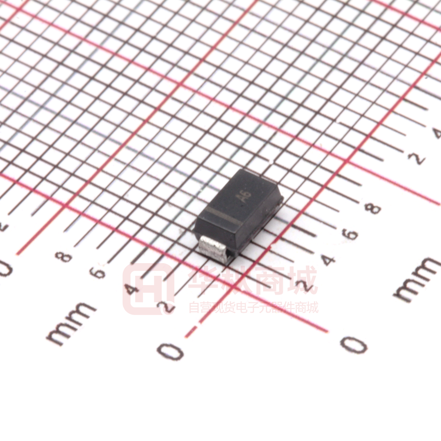

    瞬态电压抑制器VC=10.3V IPP=38.8A SMA
BV-SMAJ6A 数据手册
SMA 400W Series Version: A8 2020/8/12 eres Transient Voltage Suppressor Features Exterior IEC 61000-4-2(ESD)±15KV(air), ±8KV(contact) 400Watts peak pulse power (tp=10/1000μS) Quick response to surge voltage Low clamping voltage Moisture sensitivity level: Level 1 DO-214AC (SMA) Application Information rmation DC Port Agency Approvals Icon RS485/232/422 Description Compliance with 2011/65/EU I/O Port Compliance withIEC61249-2-21:2003 UL Certificated E232249 Schematic Symbol anode cathode BI-directional UNI-directional Part Number and Electrical Parameter Part Number Marking VR VBR VBR It Vc@IPP○1 IPP○1 IR@VR (V) min.(V) max.(V) (mA) (V) (A) (uA) BI UNI BI UNI BV-SMAJ5CA BV-SMAJ5A A5C A5 5 6.4 7 10 9.2 43.5 800 BV-SMAJ6CA BV-SMAJ6A A6C A6 6 6.67 7.37 10 10.3 38.8 800 BV-SMAJ6.5CA BV-SMAJ6.5A A6.5C A6.5 6.5 7.22 7.98 10 11.2 35.7 500 BV-SMAJ7CA BV-SMAJ7A A7C A7 7 7.78 8.6 10 12 33.3 200 BV-SMAJ7.5CA BV-SMAJ7.5A A7.5C A7.5 7.5 8.33 9.21 1 12.9 31 100 BV-SMAJ8CA BV-SMAJ8A A8C A8 8 8.89 9.83 1 13.6 29.4 50 BV-SMAJ8.5CA BV-SMAJ8.5A A8.5C A8.5 8.5 9.44 10.4 1 14.4 27.8 20 BV-SMAJ9CA BV-SMAJ9A A9C A9 9 10 11.1 1 15.4 26 10 BV-SMAJ10CA BV-SMAJ10A A10C A10 10 11.1 12.3 1 17 23.5 5 BV-SMAJ11CA BV-SMAJ11A A11C A11 11 12.2 13.5 1 18.2 22 1 BV-SMAJ12CA BV-SMAJ12A A12C A12 12 13.3 14.7 1 19.9 20.1 1 BV-SMAJ13CA BV-SMAJ13A A13C A13 13 14.4 15.9 1 21.5 18.6 1 BV-SMAJ14CA BV-SMAJ14A A14C A14 14 15.6 17.2 1 23.2 17.2 1 BV-SMAJ15CA BV-SMAJ15A A15C A15 15 16.7 18.5 1 24.4 16.4 1 BV-SMAJ16CA BV-SMAJ16A A16C A16 16 17.8 19.7 1 26 15.4 1 BV-SMAJ17CA BV-SMAJ17A A17C A17 17 18.9 20.9 1 27.6 14.5 1 1/6 www.bencent.com.cn Specifications are subject to change without notice. Customers should verify actual device performance in their specific applications SMA 400W Series Version: A8 2020/8/12 eres Transient Voltage Suppressor Part Number Marking VR VBR VBR It min.(V) max.(V) (mA) Vc@IPP○1 IPP○1 IR@VR (V) (A) (uA) BI UNI BI UNI (V) BV-SMAJ18CA BV-SMAJ18A A18C A18 18 20 22.1 1 29.2 13.7 1 BV-SMAJ20CA BV-SMAJ20A A20C A20 20 22.2 24.5 1 32.4 12.3 1 BV-SMAJ22CA BV-SMAJ22A A22C A22 22 24.4 26.9 1 35.5 11.3 1 BV-SMAJ24CA BV-SMAJ24A A24C A24 24 26.7 29.5 1 38.9 10.3 1 BV-SMAJ26CA BV-SMAJ26A A26C A26 26 28.9 31.9 1 42.1 9.5 1 BV-SMAJ28CA BV-SMAJ28A A28C A28 28 31.1 34.4 1 45.4 8.8 1 BV-SMAJ30CA BV-SMAJ30A A30C A30 30 33.3 36.8 1 48.4 8.3 1 BV-SMAJ33CA BV-SMAJ33A A33C A33 33 36.7 40.6 1 53.3 7.5 1 BV-SMAJ36CA BV-SMAJ36A A36C A36 36 40 44.2 1 58.1 6.9 1 BV-SMAJ40CA BV-SMAJ40A A40C A40 40 44.4 49.1 1 64.5 6.2 1 BV-SMAJ43CA BV-SMAJ43A A43C A43 43 47.8 52.8 1 69.4 5.8 1 BV-SMAJ45CA BV-SMAJ45A A45C A45 45 50 55.3 1 72.7 5.5 1 BV-SMAJ48CA BV-SMAJ48A A48C A48 48 53.3 58.9 1 77.4 5.2 1 BV-SMAJ51CA BV-SMAJ51A A51C A51 51 56.7 62.7 1 82.4 4.9 1 BV-SMAJ54CA BV-SMAJ54A A54C A54 54 60 66.3 1 87.1 4.6 1 BV-SMAJ58CA BV-SMAJ58A A58C A58 58 64.4 71.2 1 93.6 4.3 1 BV-SMAJ60CA BV-SMAJ60A A60C A60 60 66.7 73.7 1 96.8 4.1 1 BV-SMAJ64CA BV-SMAJ64A A64C A64 64 71.1 78.6 1 103 3.9 1 BV-SMAJ70CA BV-SMAJ70A A70C A70 70 77.8 86 1 113 3.5 1 BV-SMAJ75CA BV-SMAJ75A A75C A75 75 83.3 92.1 1 121 3.3 1 BV-SMAJ78CA BV-SMAJ78A A78C A78 78 86.7 95.8 1 126 3.2 1 BV-SMAJ85CA BV-SMAJ85A A85C A85 85 94.4 104 1 137 2.9 1 BV-SMAJ90CA BV-SMAJ90A A90C A90 90 100 111 1 146 2.7 1 BV-SMAJ100CA BV-SMAJ100A A100C A100 100 111 123 1 162 2.5 1 BV-SMAJ110CA BV-SMAJ110A A110C A110 110 122 135 1 177 2.3 1 BV-SMAJ120CA BV-SMAJ120A A120C A120 120 133 147 1 193 2.1 1 BV-SMAJ130CA BV-SMAJ130A A130C A130 130 144 159 1 209 1.9 1 BV-SMAJ150CA BV-SMAJ150A A150C A150 150 167 185 1 243 1.6 1 BV-SMAJ160CA BV-SMAJ160A A160C A160 160 178 197 1 259 1.5 1 BV-SMAJ170CA BV-SMAJ170A A170C A170 170 189 209 1 275 1.5 1 BV-SMAJ180C ② ② A180C A180 180 201 222 1 292 1.4 1 BV-SMAJ200C ② ② A200C A200 200 224 247 1 324 1.2 1 BV-SMAJ220C ② ② A220C A220 220 246 272 1 356 1.1 1 BV-SMAJ250C ② ② A250C A250 250 279 309 1 405 1.0 1 BV-SMAJ300C ② ② A300C A300 300 335 371 1 486 0.8 1 BV-SMAJ350C ② ② A350C A350 350 391 432 1 567 0.7 1 BV-SMAJ400C ② ② A400C A400 400 447 494 1 648 0.6 1 BV-SMAJ440C ② ② A440C A440 440 492 543 1 713 0.6 1 BV-SMAJ180 BV-SMAJ200 BV-SMAJ220 BV-SMAJ250 BV-SMAJ300 BV-SMAJ350 BV-SMAJ400 BV-SMAJ440 Note: Absolute maximum ratings measured at T= 25ºC RH = 45%-75% (unless otherwise noted). 1 Surge Waveform: 10/1000μS ○ 2/6 www.bencent.com.cn ② ②These part numbers do not have UL497b safety certification Specifications are subject to change without notice. Customers should verify actual device performance in their specific applications SMA 400W Series Version: A8 2020/8/12 eres Transient Voltage Suppressor Mark cathode anode UNI:AXX BI:AXXC Part Number System BV —SMAJ XX C A (1) (3) (4) (5) (2) (1) Bencent Transient Voltage Suppressor (2) Series Code (3) VR=XXV (4) BI-directional (5) Suffix ‘A’ denotes 5% tolerance devices V-I Curve IPP VC VBR VR It IR VC VBR VR IR It VR V VBR VC IR It Bi-directional Uni-directional IPP 3/6 VF IPP Parameters Definition VF Forward Voltage drop for UNI-directional VC Clamping Voltage Ipp Surge Waveform 10/1000μs VR Stand-off Voltage VBR Breakdown Voltage IR Reverse Leakage Current It Test Current Ppp Peak Pulse Power Dissipation www.bencent.com.cn Specifications are subject to change without notice. Customers should verify actual device performance in their specific applications V SMA 400W Series Version: A8 2020/8/12 eres Transient Voltage Suppressor Thermal Considerations symbol Parameter Value Unit TJ Operating Junction Temperature Range -55 to +150 ℃ TS Storage Temperature Range -55 to +150 ℃ 3.5/5 V 40 A VF IFSM Maximum Instantaneous Forward; Voltage at 25A for Unidirectional Only (Note 1) Peak Forward Surge Current, 8.3ms;Single Half Sine Wave (Note 2) Notes: 1. VF < 3.5V for single die parts and VF< 5.0V for stacked-die parts. 2. Measured on 8.3ms single half sine wave or equivalent square wave for unidirectional device only. Typical Characteristics Peak Pulse Power Rating Curve Pulse Waveform 4/6 www.bencent.com.cn Pulse Derating Curve Typical Junction Capacitance Specifications are subject to change without notice. Customers should verify actual device performance in their specific applications SMA 400W Series Version: A8 2020/8/12 eres Transient Voltage Suppressor Maximum Non-Repetitive Forward Surge Current Uni-Directional Only Steady State Power Dissipation Derating Curve Product Dimensions DO-214AC(SMA) REF. mm inch A 1.5±0.15 0.059±0.006 B 2.7±0.3 0.106±0.012 C 4.4±0.3 0.173±0.012 D 2~2.50 0.079~0.098 F 1.2±0.3 0.047±0.012 G 0~0.4 0~0.016 H 5±0.3 0.197±0.012 Recommended Soldering Pad 5/6 www.bencent.com.cn REF mm inch A 6 0.236 B 2 0.079 C 2 0.079 Specifications are subject to change without notice. Customers should verify actual device performance in their specific applications SMA 400W Series Version: A8 2020/8/12 eres Transient Voltage Suppressor Reflow Profile Reflow Condition Temperature Min. +150°C Temperature Max. +200°C Time (Min to Max) 60 – 180 seconds Average ramp up rate (Liquidus Temp (TL) to peak) TS(max) to TL - Ramp-up Rate - Temperature (TL) Reflow (Liquidus) - Temperature (TL) Peak Temp (TP) TP TP Critical Zone TL to TP 3°C/second max TL 3°C/second max Temperature Pre Heat Pb-Free Assembly 217°C 60 – 150 seconds TL TS(max) Ramp-down Preheat TS(min) TS 260+0/-5 °C Time within 5°C of actual Peak Temp (TP) TL 8-15 seconds Ramp-down Rate 6°C/s max Time 25°C to peak Temp (TP) 8 min max. Do not exceed 260°C 25 Time time to peak temperature Package Reel Information 6/6 Outline Reel (pcs) Per Carton (pcs) Reel Diameters (mm) Taping 5,000 80,000 330 www.bencent.com.cn REF. mm inch W 12±1 0.472±0.039 E 1.75±0.3 0.069±0.012 F 5.5±0.3 0.217±0.012 D0 1.55±0.15 0.061±0.006 D1 1.55±0.15 0.061±0.006 P0 4.0±0.2 0.157±0.008 P1 4.0±0.2 0.157±0.008 P2 2.0±0.2 0.079±0.008 A0 2.85±0.3 0.112±0.012 B0 5.4±0.3 0.213±0.012 D5 Ø330 Ø13 D6 Ø13.5±1.0 Ø0.531±0.039 W2 18±2.0 0.709±0.079 Carton Size(mm) L W H 360 360 385 Specifications are subject to change without notice. Customers should verify actual device performance in their specific applications
