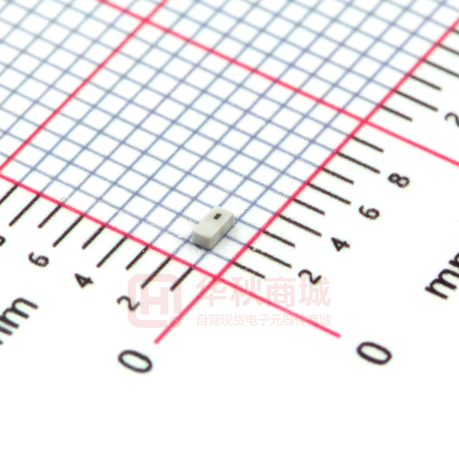

Approval sheet MULTILAYER CERAMIC BAND PASS FILTER RFBPF Series – 1608(0603)- RoHS Compliance Halogens Free Product 5150 ~ 5950 MHz Working Frequency P/N: RFBPF1608060KG8D1T *Contents in this sheet are subject to change without prior notice. Page 1 of 7 ASC_RFBPF1608060KG8D1T_V04 May 2018 Approval sheet FEATURES 3 1. Miniature footprint: 1.6 X 0.8X 0.6 mm . 2. Low Insertion loss 3. High attenuation on harmonic suppressed 4. LTCC process APPLICATIONS 1. 5150 ~ 5950 MHz working frequency. CONSTRUCTION Top view P1 P2 P3 PIN Connection 1 Input port 2 GND 3 Output port DIMENSIONS Figure Top view Side view Symbol Dimension (mm) L 1.60 ± 0.10 W 0.80 ± 0.10 T 0.60 ± 0.10 A 0.55 ± 0.10 B 0.60 ± 0.10 C 0.25 ± 0.10 D 0.23 ± 0.10 E 0.40 ± 0.10 F 0.12 ± 0.10 G 0.125 ± 0.10 Bottom view Page 2 of 7 ASC_RFBPF1608060KG8D1T_V04 May 2018 Approval sheet ELECTRICAL CHARACTERISTICS RFBPF1608060KG8D1T Specification Frequency Range 5150 ~ 5950 MHz 0.8 dB max. at 25 C 1.0 dB max. at -40 ~ 85 C 40.0 dB min. @ 30 ~ 2700 MHz Insertion Loss 45.0 dB min. @ 3400 ~ 3800 MHz Attenuation 20.0 dB min. @ 6900 MHz 20.0 dB min. @ 7250 ~ 7800 MHz 20.0 dB min. @ 10300 ~ 11700 MHz Return Loss 13 dB min. Impedance 50 Ω Power capacity 500 mW Moisture sensitivity levels MSL is LEVEL 1 (Refer to : IPC/JEDEC J-STD-020) Operating & Storage Condition (Component) Operation Temperature Range: -40C ~ +85C Storage Temperature Range: -40C ~ +85C Storage Condition before Soldering (Included packaging material) Storage Temperature Range: +5 ~ +40 ℃ Humidity: 30 to 70% relative humidity Typical Electrical Chart SOLDER LAND PATTERN SOLDER LAND PATTERN Unit : mm Line width to be designed to match 50 Ω characteristic impedance, depending on PCB material and thickness. Page 3 of 7 ASC_RFBPF1608060KG8D1T_V04 May 2018 Approval sheet RELIABILITY TEST Test condition / Test method Test item Solderability *Solder bath temperature:235  5C Specification At least 95% of a surface of each terminal JIS C 0050-4.6 *Immersion time:2  0.5 sec electrode must be covered by fresh solder. JESD22-B102D Solder:Sn3Ag0.5Cu for lead-free Leaching *Solder bath temperature:260  5C (Resistance to *Leaching immersion time:30  0.5 sec dissolution of Loss of metallization on the edges of each electrode shall not exceed 25%. Solder : SN63A metallization) IEC 60068-2-58 Resistance to soldering *Preheating temperature:120~150C, heat JIS C 0050-5.4 No mechanical damage. 1 minute. Electrical specification shall satisfy the *Solder temperature:2705C descriptions in electrical characteristics under *Immersion time:101 sec the operational temperature range within -40 Solder:Sn3Ag0.5Cu for lead-free ~ 85°C. Loss of metallization on the edges of each Measurement to be made after keeping at electrode shall not exceed 25%. room temperature for 242 hrs Drop Test JIS C 0044 Customer’s specification. *Height:75 cm No mechanical damage. *Test Surface:Rigid surface of concrete or Electrical specification shall satisfy the steel. *Times:6 surfaces for each units;2 times for each side. Vibration JIS C 0040 descriptions in electrical characteristics under the operational temperature range within -40 ~ 85°C. *Frequency:10Hz~55Hz~10Hz(1min) No mechanical damage. *Total amplitude:1.5mm Electrical specification shall satisfy the *Test times:6hrs.(Two hrs each in three mutually perpendicular directions) descriptions in electrical characteristics under the operational temperature range within -40 ~ 85°C. Adhesive Strength of Termination JIS C 0051- 7.4.3 Bending test JIS C 0051- 7.4.1 *Pressurizing force: 5N(≦0603);10N(>0603) No remarkable damage or removal of the termination. *Test time:10±1 sec The middle part of substrate shall be No mechanical damage. pressurized by means of the pressurizing rod Electrical specification shall satisfy the at a rate of about 1 mm/s per second until the descriptions in electrical characteristics under deflection becomes 1mm/s and then pressure the operational temperature range within -40 shall be maintained for 51 sec. ~ 85°C. Measurement to be made after keeping at room temperature for 242 hours Page 4 of 7 ASC_RFBPF1608060KG8D1T_V04 May 2018 Approval sheet Temperature cycle JIS C 0025 1. 303 minutes at -40C3C, No mechanical damage. 2. 10~15 minutes at room temperature, Electrical specification shall satisfy the 3. 303 minutes at +85C3C, 4. 10~15 minutes at room temperature, Total 100 continuous cycles descriptions in electrical characteristics under the operational temperature range within -40 ~ 85°C. Measurement to be made after keeping at room temperature for 242 hrs High temperature JIS C 0021 *Temperature:85C2C No mechanical damage. *Test duration:1000+24/-0 hours Electrical specification shall satisfy the Measurement to be made after keeping at room temperature for 242 hrs descriptions in electrical characteristics under the operational temperature range within -40 ~ 85°C. Humidity (steady conditions) *Humidity:90% to 95% R.H. No mechanical damage. *Temperature:402C Electrical specification shall satisfy the JIS C 0022 *Time:1000+24/-0 hrs. Measurement to be made after keeping at room temperature for 242 hrs descriptions in electrical characteristics under the operational temperature range within -40 ~ 85°C. ※ 500hrs measuring the first data then 1000hrs data Low temperature JIS C 0020 *Temperature:-40C2C No mechanical damage. *Test duration:1000+24/-0 hours Electrical specification shall satisfy the Measurement to be made after keeping at room temperature for 242 hrs descriptions in electrical characteristics under the operational temperature range within -40 ~ 85°C. Page 5 of 7 ASC_RFBPF1608060KG8D1T_V04 May 2018 Approval sheet SOLDERING CONDITION Typical examples of soldering processes that provide reliable joints without any damage are given in Fig 2, Fig 2. Infrared soldering profile ORDERING CODE RF Walsin RF device BPF Product Code BPF : Band Pass Filter 160806 0 Dimension code Unit of dimension Per 2 digits of Length, Width, Thickness : 0 : 0.1 mm e.g. : 1 : 1.0 mm K G8D1T Application Specification K : 5GHz ISM Band Design Code 160806 = Length 16, Width 08, Thickness06 Minimum Ordering Quantity: 4000 pcs per reel. PACKAGING Paper Tape specifications (unit :mm) Index Dimension (mm) Index Dimension (mm) Page 6 of 7 Ao Bo D T W 0.975 0.05 1.76 0.05 1.55 + 0.05 0.75 0.10 8.0  0.10 E F Po P1 P2 1.75  0.10 3.50  0.05 4.00  0.10 4.00  0.10 2.00  0.05 ASC_RFBPF1608060KG8D1T_V04 May 2018 Approval sheet Reel dimensions C Index A Φ178.0 Dimension (mm) B Φ60.0 A B C Φ13.0 Taping Quantity:4000 pieces per 7” reel CAUTION OF HANDLING Limitation of Applications Please contact us before using our products for the applications listed below which require especially high reliability for the prevention of defects, which might directly cause damage to the third party’s life, body or property. (1) (2) (3) (4) (5) (6) (7) (8) Aircraft equipment Aerospace equipment Undersea equipment Medical equipment Disaster prevention / crime prevention equipment Traffic signal equipment Transportation equipment (vehicles, trains, ships, etc.) Applications of similar complexity and /or reliability requirements to the applications listed in the above. Storage condition (1) Products should be used in 6 months from the day of WALSIN outgoing inspection. (2) Storage environment condition.        Page 7 of 7 Products should be storage in the warehouse on the following conditions. Temperature : +5 to +40℃ Humidity : 30 to 70% relative humidity Don’t keep products in corrosive gases such as sulfur. Chlorine gas or acid or it may cause oxidization of electrode, resulting in poor solderability. Products should be storage on the palette for the prevention of the influence from humidity, dust and son on. Products should be storage in the warehouse without heat shock, vibration, direct sunlight and so on. Products should be storage under the airtight packaged condition. ASC_RFBPF1608060KG8D1T_V04 May 2018
