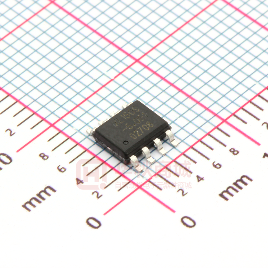

Datasheet 2A 150KHz 40V Buck DC to DC Converter XL1509 Features General Description n n n Wide 4.5V to 40V Input Voltage Range 3.3V,5V,12V, and adjustable versions Output Adjustable from 1.23V to 37V n n Maximum Duty Cycle 100% Minimum Drop Out 1.5V n n n Fixed 150KHz Switching Frequency 2A Constant Output Current Capability Internal Optimize Power Transistor High efficiency The XL1509 is a 150 KHz fixed frequency PWM buck (step-down) DC/DC converter, capable of driving a 2A load with high efficiency, low ripple and excellent line and load regulation. Requiring a minimum number of external components, the regulator is simple to use and include internal frequency compensation and a fixed-frequency oscillator. n n n n n n n n Excellent line and load regulation TTL shutdown capability ON/OFF pin with hysteresis function The PWM control circuit is able to adjust the duty ratio linearly from 0 to 100%. An enable function, an over current protection function is built inside. When second current limit function happens, the operation frequency will be reduced from 150KHz to 50KHz. An internal compensation block is built in to minimize external component count. Built in thermal shutdown function Built in current limit function Built in second current limit function Available in SOIC8 package Applications n n n n n LCD Monitor and LCD TV Digital Photo Frame Set-up Box ADSL Modem Telecom / Networking Equipment Figure1. Package Type of XL1509 Rev 2.0 www.xlsemi.com 1 Datasheet 2A 150KHz 40V Buck DC to DC Converter XL1509 Pin Configurations VIN 1 8 GND OUTPUT 2 7 GND FEEDBACK 3 6 GND ON/OFF 4 5 GND XL1509 Figure2. Pin Configuration of XL1509 (Top View) Table 1 Pin Description Pin Number 1 2 5~8 3 4 Pin Name Description Supply Voltage Input Pin. XL1509 operates from a 4.5V to 40V DC voltage. Bypass Vin to GND with a suitably large VIN capacitor to eliminate noise on the input. Power Switch Output Pin (SW). Output is the switch node that OUTPUT supplies power to the output. Ground Pin. Care must be taken in layout. This pin should be placed outside of the Schottky Diode to output capacitor GND ground path to prevent switching current spikes from inducing voltage noise into XL1509. Feedback Pin (FB). Through an external resistor divider FEEDBACK network, Feedback senses the output voltage and regulates it. The feedback threshold voltage is 1.23V. Enable Pin. Drive ON/OFF pin low to turn on the device, drive ON/OFF it high to turn it off. Floating is default low. Rev 2.0 www.xlsemi.com 2 Datasheet 2A 150KHz 40V Buck DC to DC Converter XL1509 Function Block Figure3. Function Block Diagram of XL1509 Typical Application Circuit FEEDBACK 3 VIN OUTPUT 1 XL1509-5.0 2 5~8 4 GND ON/OFF +12V CIN 470uf 35V C1 105 L1 68uh/2A 5V/2A COUT D1 180uf 35V 1N5820 OFF ON LOAD Figure4. XL1509 Typical Application Circuit 12V-5V/2A Rev 2.0 www.xlsemi.com 3 Datasheet 2A 150KHz 40V Buck DC to DC Converter XL1509 Ordering Information XL1509 E1 E1: Lead Free Packing Circuit Type Type and Reel Version ADJ: Adjust 3.3: 3.3V 5.0: 5V 12: 12V Package SOIC8 Temperature Range -40oC ~ 85oC Marking ID Lead Free XL1509-ADJE1 XL1509-3.3E1 XL1509-5.0E1 XL1509-12E1 Packing Type Supplied As 2500 Units on Tape & Reel 2500 Units on Tape & Reel 2500 Units on Tape & Reel 2500 Units on Tape & Reel XLSEMI Pb-free products, as designated with “E1” suffix in the par number, are RoHS compliant. Rev 2.0 www.xlsemi.com 4 Datasheet 2A 150KHz 40V Buck DC to DC Converter XL1509 Absolute Maximum Ratings(Note1) Parameter Symbol VON/OFF VOutput PD Value -0.3 to 45 -0.3 to Vin -0.3 to Vin -0.3 to Vin Internally limited Unit V V V V mW Input Voltage Feedback Pin Voltage ON/OFF Pin Voltage Output Switch Pin Voltage Power Dissipation Thermal Resistance (SOIC8) (Junction to Ambient, No Heatsink, Free Air) Operating Junction Temperature Storage Temperature Lead Temperature (Soldering, 10 sec) ESD (HBM) Vin VFB RJA 100 ºC/W TJ TSTG TLEAD -40 to 125 -65 to 150 260 2000 ºC ºC ºC V Note1: Stresses greater than those listed under Maximum Ratings may cause permanent damage to the device. This is a stress rating only and functional operation of the device at these or any other conditions above those indicated in the operation is not implied. Exposure to absolute maximum rating conditions for extended periods may affect reliability. Rev 2.0 www.xlsemi.com 5 Datasheet 2A 150KHz 40V Buck DC to DC Converter XL1509 XL1509-3.3 Electrical Characteristics Ta = 25℃;unless otherwise specified. Symbol Parameter Test Condition Min. Typ. Max. Unit 3.168 3.3 3.432 V - 75 - % Min. Typ. Max. Unit 4.8 5 5.2 V - 82 - % Min. Typ. Max. Unit 11.52 12 12.48 V - 90 - % Min. Typ. Max. Unit 1.193 1.23 1.267 V - 74 - % System parameters test circuit figure5 VOUT Efficiency Output Voltage ŋ Vin = 4.75V to 40V Iload=0.2A to 2A Vin=12V ,Vout=3.3V Iout=2A XL1509-5.0 Electrical Characteristics Ta = 25℃;unless otherwise specified. Symbol Parameter Test Condition System parameters test circuit figure5 VOUT Efficiency Output Voltage ŋ Vin = 7V to 40V Iload=0.2A to 2A Vin=12V ,Vout=5V Iout=2A XL1509-12 Electrical Characteristics Ta = 25℃;unless otherwise specified. Symbol Test Condition Parameter System parameters test circuit figure5 VOUT Efficiency Output Voltage ŋ Vin = 15V to 40V Iload=0.2A to 2A Vin=25V ,Vout=12V Iout=2A XL1509-ADJ Electrical Characteristics Ta = 25℃;unless otherwise specified. Symbol Parameter Test Condition System parameters test circuit figure5 VOUT Efficiency Output Voltage ŋ Vin = 4.5V to 40V Iload=0.2A to 2A Vin=12V ,Vout=3V Iout=2A Rev 2.0 www.xlsemi.com 6 Datasheet 2A 150KHz 40V Buck DC to DC Converter XL1509 Electrical Characteristics (DC Parameters) Vin = 12V for the 3.3V,5V,and Adjustable versions and Vin=24V for the 12V version, GND=0V, Vin & GND parallel connect a 220uf/50V capacitor; Iout=500mA, Ta = 25℃; the others floating unless otherwise specified. Parameters Symbol Test Condition Min. Typ. 4.5 Max. Unit 40 V Input operation voltage Vin Shutdown Supply Current ISTBY VON/OFF=5V 80 200 uA Quiescent Supply Current Iq VON/OFF =0V, VFB =Vin 2 10 mA 150 173 Khz Oscillator Frequency Fosc Switch Current Limit IL VFB =0 4 A VON/OFF High (Regulator OFF) Low (Regulator ON) 1.4 0.8 V IH VON/OFF =2.5V (OFF) 5 15 uA IL VON/OFF =0.5V (ON) 0.2 5 uA VCE VFB=0V Iout=2A 1.2 1.4 V DMAX VFB=0V 100 ON/OFF Pin Threshold ON/OFF Pin Leakage Current Input Output Saturation Voltage Max. Duty Cycle 127 Rev 2.0 % www.xlsemi.com 7 Datasheet 2A 150KHz 40V Buck DC to DC Converter XL1509 Test Circuit and Layout guidelines Figure5. Standard Test Circuits and Layout Guides Select R1 to be approximately 1K, use a 1% resistor for best stability. C1 and CFF are optional; in order to increase stability and reduce the input power line noise, CIN and C1 must be placed near to PIN1 and PIN5~8; For output voltages greater than approximately 10V, an additional capacitor CFF is required. The compensation capacitor is typically between 100 pf and 33 nf, and is wired in parallel with the output voltage setting resistor, R2. It provides additional stability for high output voltage, low input-output voltages, and/or very low ESR output capacitors, such as solid tantalum capacitors. CFF=1/(31*1000*R2); This capacitor type can be ceramic, plastic, silver mica, etc. (Because of the unstable characteristics of ceramic capacitors made with Z5U material, they are not recommended.) Rev 2.0 www.xlsemi.com 8 Datasheet 2A 150KHz 40V Buck DC to DC Converter XL1509 XL1509 Series Buck Regulator Design Procedure (Fixed Output) Conditions Output Voltage (V) 3.3 Load Current (A) 2 5 2 12 2 Max Input Voltage (V) Inductor (L1) Inductance (uh) 6 10 40 9 20 40 15 20 40 22 33 47 22 68 68 33 68 150 Output Capacitor (COUT) Through Hole Electrolytic Panasonic Nichicon HFQ Series PL Series (uf/V) (uf/V) 470/25 470/35 330/35 330/35 330/35 270/50 470/25 560/16 180/35 180/35 180/35 180/35 330/25 330/25 180/25 180/25 82/25 82/25 Rev 2.0 Surface Mount Tantalum AVX TPS Sprague Series 595D Series (uf/V) (uf/V) 330/6.3 390/6.3 330/6.3 390/6.3 220/10 330/10 220/10 330/10 100/10 270/10 100/10 270/10 100/16 180/16 100/16 120/20 68/20 68/25 www.xlsemi.com 9 Datasheet 2A 150KHz 40V Buck DC to DC Converter XL1509 XL1509 Series Buck Regulator Design Procedure (Adjustable Output) Output Voltage (V) 2 4 6 9 12 15 24 28 Through Hole Output Electrolytic Panasonic Nichicon Feedforward HFQ Series PL Series Capacitor (uf/V) (uf/V) 820/35 820/35 33nf 560/35 470/35 10nf 470/25 470/35 3.3nf 330/25 330/25 1.5nf 330/25 330/25 1nf 220/25 220/35 680pf 220/35 150/35 560pf 100/50 100/50 390pf Surface Mount Output Capacitor AVX TPS Sprague Feedforward Series 595D Series Capacitor (uf/V) (uf/V) 330/6.3 470/4 33nf 330/6.3 390/6.3 10nf 220/10 330/10 3.3nf 100/16 180/16 1.5nf 100/16 180/16 1nf 68/20 120/20 680pf 33/25 33/25 220pf 10/35 15/50 220pf Schottky Diode Selection Table Current 1A 3A Surface Through VR (The same as system maximum input voltage) Mount Hole 20V 30V 40V 50V 1N5817 1N5818 1N5819 √ 60V √ 1N5820 1N5821 1N5822 √ MBR320 MBR330 MBR340 MBR350 MBR360 SK32 SK33 SK34 SK36 30WQ03 30WQ04 30WQ05 31DQ03 31DQ04 31DQ05 SR303 SR304 SR305 √ √ √ √ SR302 Rev 2.0 SK35 SR306 www.xlsemi.com 10 Datasheet 2A 150KHz 40V Buck DC to DC Converter XL1509 Typical System Application for 3.3V Version FEEDBACK 3 VIN OUTPUT 1 XL1509-3.3 2 5~8 4 GND ON/OFF +12V CIN 470uf 35V C1 105 L1 47uh/2A 3.3V/2A COUT D1 330uf 35V 1N5820 OFF ON LOAD Figure6. XL1509-3.3 System Parameters Test Circuit Typical System Application for 5V Version FEEDBACK 3 VIN OUTPUT 1 XL1509-5.0 2 5~8 4 GND ON/OFF +12V CIN 470uf 35V C1 105 L1 68uh/2A 5V/2A COUT D1 180uf 35V 1N5820 OFF ON LOAD Figure7. XL1509-5.0 System Parameters Test Circuit Rev 2.0 www.xlsemi.com 11 Datasheet 2A 150KHz 40V Buck DC to DC Converter XL1509 Typical System Application for 12V Version FEEDBACK 3 VIN OUTPUT 1 XL1509-12 2 5~8 4 GND ON/OFF +24V CIN 470uf 50V C1 105 L1 68uh/2A 12V/2A COUT D1 180uf 25V 1N5821 OFF ON LOAD Figure8. XL1509-12 System Parameters Test Circuit Typical System Application for ADJ Version CFF 3.3n R1 1K R2 3.1K FEEDBACK 3 VIN OUTPUT 1 XL1509-ADJ 2 5~8 4 GND ON/OFF +24V CIN 470uf 50V C1 105 L1 47uh/2A 5V/2A COUT D1 470uf 35V 1N5821 OFF ON LOAD VOUT=1.23*(1+R2/R1) Figure9. XL1509-ADJ System Parameters Test Circuit Rev 2.0 www.xlsemi.com 12 Datasheet 2A 150KHz 40V Buck DC to DC Converter XL1509 Package Information SOP8 Package Mechanical Dimensions Rev 2.0 www.xlsemi.com 13
XL1509-5.0E1
物料型号:XL1509
器件简介:XL1509是一款高效率的2A 150KHz降压型DC-DC转换器,适用于宽输入电压范围(4.5V至40V),并具有可调节的输出电压(1.23V至37V)。
引脚分配:XL1509共有8个引脚,包括输入电压引脚VIN(1, 4)、输出引脚OUTPUT(2, 7)、地引脚GND(3, 5~8)、反馈引脚FB(3)和使能/关闭引脚ON/OFF(4)。
参数特性:XL1509具有100%的最大占空比、1.5V的最小降额电压、内置的优化功率晶体管、高效率、优秀的线路和负载调节能力、TTL关闭功能以及内置的热关闭、电流限制和第二电流限制功能。
功能详解:XL1509内部包含PWM控制电路,能够线性调节占空比从0到100%,并内置了过流保护功能。当发生二次电流限制时,操作频率会从150KHz降低到50KHz。内部还包含补偿块,以最小化外部组件数量。
应用信息:XL1509适用于LCD显示器、液晶电视、数码相框、设置框、ADSL调制解调器、电信/网络设备等。
封装信息:XL1509采用SOIC8封装。
