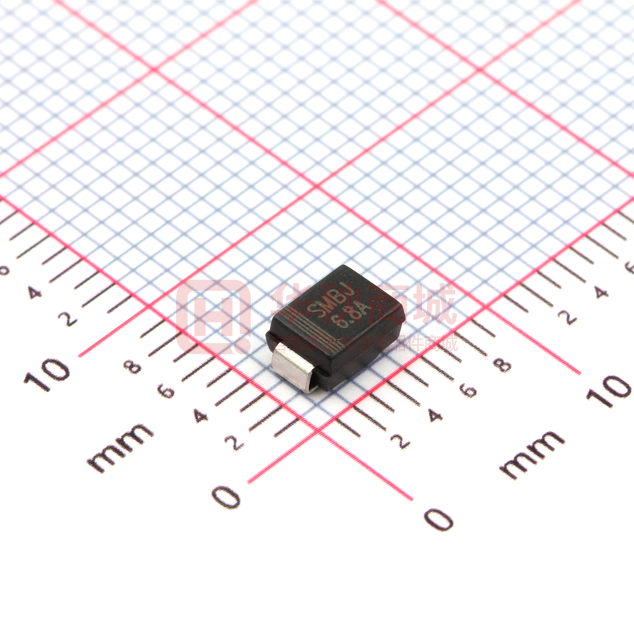

    ESD抑制器/TVS二极管 VRWM=5.8V VBR(min)=6.45V VC=10.5V@IPP=58.1A SMB
SMBJ6.8A 数据手册
SMBJ6.8(C)A Transinet Voltage Suppression Diode »Features ■ Peak power dissipation 600W @10 x 1000 us Pulse ■ Low profile package. ■ Excellent clamping capability. ■ Glass passivated junction. ■ Fast response time: typically less than 1ps from 0 Volts to BV min ■ IEC 61000-4-2 ESD 30KV(Air), 30KV(Contact) ■ ESD protection of data lines in accordance with IEC 61000-4-2 ■ EFT protection of data lines in accordance with IEC 61000-4-4 ■ Halogen free and RoHS compliant ■ Lead-free finish SMB Symbol »Mechanical Characteristics ■ CASE: SMB (DO-214AA) Molded Plastic over glass passivated junction. ■ Mounting Position: Any ■ Polarity: by cathode band denotes uni-directional device, none cathode band denotes bi-directional device. ■ Terminal: Solder plated »Maximum Ratings And Characteristics @ 25°C Ambient Temperature Parameter Peak Pulse Power Dissipation on 10/1000 us Waveform Symbol Value Units PPPM Min 600 W PD 5 W IPPM See Table 1 A IFSM 100 A TJ -55 to 150 °C TSTG -55 to 150 °C (Note 1, 2, FIG.1) Power Dissipation on Infinite Heat Sink at TL=50°C Peak Pulse Current of on 10/1000us Waveform (Note 1, FIG.3) Peak Forward Surge Current, 8.3ms Single Half Sine-Wave (Note 2. 3) Operating Junction Temperature Range Storage Temperature Range Notes: 1. Non-repetitive current pulse, per Fig.3 and derated above TA=25°C per Fig.2. 2 2. Mounted on 5.0x5.0mm (0.03mm thick) Copper Pads to each terminal. 3. Measured on 8.3ms single half sine-wave, or equivalent square wave, for Unidirectional device only. »Electrical Specification @ Tamb 25°C Type Number (Uni) (Bi) SMBJ6.8A SMBJ6.8CA Revision 2018 Maximum Reverse Breakdown Breakdown Clamping Test Voltage Stand-Off Voltage Current Voltage Max. @ IT Min. @IT Voltage @IPP Marking Peak Pulse Current Reverse Leakage @VRMW (Uni) (Bi) VRMW(V) VBR MIN(V) VBR MAX(V) IT (mA) VC(V) IPP(A) IR(uA) SMBJ 6.8A SMBJ 6.8CA 5.8 6.45 7.14 10 10.5 58.1 500 www.born-tw.com 1/5 Tra SMBJ6.8(C)A »I-V Curve Characteristics Uni-directional Bi-directional PPPM Peak Pulse Power Dissipation - Max power dissipation VRWM Reverse Stand-off Voltage - Maximum voltage that can be applied to TVS without operation VBR Breakdown Voltage – Maximum voltage that flows though the TVS at a specified current (IT) VC Clamping Voltage – Peak voltage measured across the TVS at a specified IPPM (peak impulse current) IR Reverse Leakage Current – Current measured at VR VF Forward Voltage Drop for Uni-directional »Ratings and Characteristic Curves (T =25°C unless otherwise A Fig.1 - Peak Pulse Power Rating Fig.3 – Pulse Waveform Revision 2018 noted) Fig.2 - Pulse Derating Cure Fig.4 - Typical Junction Capacitance www.born-tw.com 2/5 SMBJ6.8(C)A Voltage S ppressors »Recommended Soldering Conditons Reflow Soldering Recommended Conditions Pb-Free Assembly Profile Feature Average ramp-up rate (TL to TP) 3℃/second max. Preheat -Temperature Min (TS min) -Temperature Max (TS max) -Time (min to max) (tS) 150℃ 200℃ 60-180 seconds TS max to TL -Ramp-up Rate 3℃/second max. Time maintained above: -Temperature (TL) -Time (tL) 217℃ 60-150 seconds 260℃ Peak Temperature (TP) Time within 5℃ of actual Peak Temperature (tP) 6℃/second max. Ramp-down Rate Time 25℃ to Peak Temperature Revision 2018 20-40 seconds 8 minutes max. www.born-tw.com 3/5 SMBJ6.8(C)A Tra »Marking Code SMBJ SMBJ 6.8 C A 6.8 A »Package Outline Dimensions and Pad Layouts (DO-214AA) Dim Millimeters Inches Min Max Min Max L 4.29 4.70 0.169 0.186 D 3.40 3.79 0.134 0.150 D1 1.85 2.25 0.073 0.089 T 5.10 5.48 0.201 0.216 T1 0.76 1.52 0.030 0.060 d - 0.203 - 0.008 H 2.00 2.50 0.079 0.098 H1 1.98 2.29 0.078 0.090 »Ordering Information SMBJ XXX C A 5% VBR Voltage Tolerance Bidirectional VRWM Voltage Series Code Revision 2018 www.born-tw.com 4/5 SMBJ6.8(C)A V »Packaging Tape P0 SymboI P1 P2 D0 B T E F W B0 D1 A A B K0 SECTION B-B A0 SECTION A-A 7” Reel Dimension(mm) W 12.00±0.20 P0 4.00±0.10 P1 8.00±0.10 P2 2.00±0.10 D0 Φ1.55±0.10 D1 Φ1.5±0.10 E 1.75±0.10 F 5.50±0.10 A0 3.86±0.15 B0 5.65±0.10 K0 2.75±0.15 T 0.25±0.05 D2 Φ178.0±2.0 D3 Φ50.0Min. D4 Φ13.0±0.5 W1 16.0±2.0 Quantity: 500PCS 13” Reel D5 Φ330.0±2.0 D6 Φ13.5±0.5 H 2.5±1.0 W2 16.0±2.0 Quantity: 3000PCS Revision 2018 www.born-tw.com 5/5
