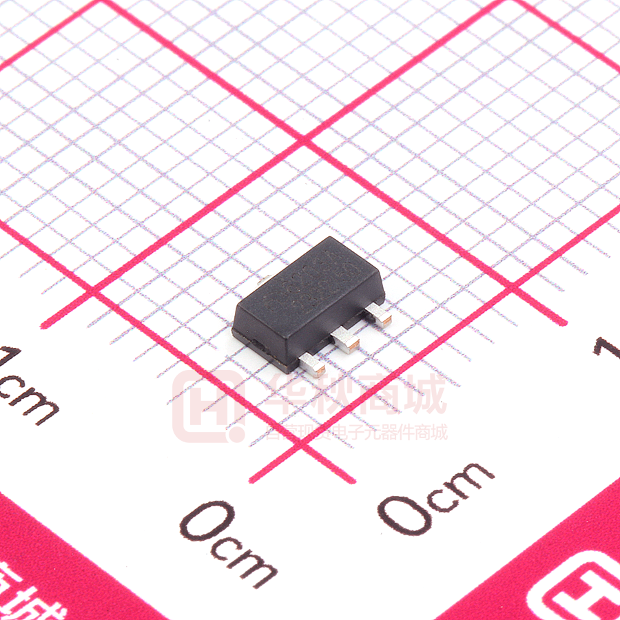

ME6203 High Input Voltage LDO Regulators ME6203 Series General Description Features The ME6203 series are highly accurate, low noise, LDO Voltage Regulators that are manufactured using CMOS technology and the input voltage of ME6203 series is in Excess of 30 V. This series contains three fixed output voltages of 3.0V, 3.3V and 5.0V that have no minimum load requirement to maintain regulation. On chip trimming adjusts the output voltage to within ±2.5% accuracy. ME6203 consists of a output current limiting, a driver transistor, a precision reference voltage and an error amplifier. Output voltage is selectable in 100mV steps between 1.5V ~ 6.0V. The Devices are available in SOT-89(500mW). z z z z z z z z z Output Current in Excess of 100mA Operating Voltage Range:7V~30V Highly Accuracy: ±2.5% Small Standby Current: 13μA(TPY.) Ripple Rejection: 40dB@1KHz(ME6203A33) Line Regulation: 0.5%(TYP.) Temperature Stability:0.5%(TYP.) Operational Temperature Range: 0℃~100℃ Small Packages:SOT-89 Typical Application z Selection Guide z z z z Consumer and Industrial Equipment Point of Regulation Portable AV equipment Battery powered equipment Cameras, video recorders Reference voltage Typical Application Circuit V01 www.microne.com.cn Page 1 of 8 ME6203 Pin Configuration SOT-89-3 Pin Assignment ME6203AXX Pin Number Pin Name Functions 1 VSS Ground 2 VIN Input 3 VOUT Output Block Diagram V01 www.microne.com.cn Page 2 of 8 ME6203 Absolute Maximum Ratings Parameter Symbol Ratings Units Input Voltage VIN 36 V Output Voltage VOUT Vss-0.3~VIN +0.3 V PD 500 mW Operating Temperature Range TOPR 0~+100 ℃ Storage Temperature Range TSTG -40~+150 ℃ Power Dissipation Lead Temperature SOT-89 260℃,10sec SOT-89 Electrical Characteristics ME6203A30 (VIN= 7V,CIN=CL=10uF,Ta=25OC, unless otherwise noted) Parameter Symbol Conditions Min. Typ. Max. Units Output Voltage VOUT(E) (Note 2) IOUT=10mA, 7V ≤VIN≤30V X 0.975 VOUT (T) (Note 1) X 1.025 V Input Voltage VIN 30 V 7 VIN= 7V 100 VIN= 24V 20 VIN= 30V 15 ∆VOUT VIN= 7V , 0mA≤IOUT≤100mA 10 30 mV Line Regulation ∆VOUT IOUT =10mA,7V ≤VIN≤30V 10 35 mV Temperature Stability ∆VOUT VIN= 7V, IOUT =10mA,0~100℃ 0.5 1.5 % Quiescent Current Is 13 18 μA short-circuit current Ishort VIN= 7V 13 30 mA Ripple Rejection Rate PSRR VIN = 12V +1Vp-pAC IOUT=5mA,1kHZ 40 Maximum Output Current IOUTMAX Load Regulation V01 www.microne.com.cn mA dB Page 3 of 8 ME6203 ME6203A33 (VIN= 7V,CIN=CL=10uF,Ta=25OC, unless otherwise noted) Parameter Symbol Conditions Min. Typ. Max. Units Output Voltage VOUT(E) (Note 2) IOUT=10mA, 7V ≤VIN≤30V X 0.975 VOUT (T) (Note 1) X 1.025 V Input Voltage VIN 30 V 7 VIN= 7V 100 VIN= 24V 20 VIN= 30V 15 ∆VOUT VIN= 7V , 0mA≤IOUT≤100mA 10 30 mV Line Regulation ∆VOUT IOUT =10mA,7V ≤VIN≤30V 10 35 mV Temperature Stability ∆VOUT VIN= 7V, IOUT =10mA,0~100℃ 0.5 1.5 % Quiescent Current Is 13 18 μA short-circuit current Ishort VIN= 7V 13 30 mA Ripple Rejection Rate PSRR VIN = 12V +1Vp-pAC IOUT=5mA,1kHZ 40 Maximum Output Current IOUTMAX Load Regulation mA dB ME6203A50 (VIN= 7V,CIN=CL=10uF,Ta=25OC, unless otherwise noted) Parameter Symbol Conditions Min. Typ. Max. Units Output Voltage VOUT(E) (Note 2) IOUT=10mA, 7V ≤VIN≤30V X 0.975 VOUT (T) (Note 1) X 1.025 V Input Voltage VIN 30 V 7 VIN= 7V 100 VIN= 24V 20 VIN= 30V 15 ∆VOUT VIN= 7V , 0mA≤IOUT≤100mA 10 40 mV Line Regulation ∆VOUT IOUT =10mA,7V ≤VIN≤30V 10 45 mV Temperature Stability ∆VOUT VIN= 7V, IOUT =10mA,0~100℃ 0.5 1.5 % Quiescent Current Is 15 18 μA short-circuit current Ishort VIN= 7V 15 30 mA Ripple Rejection Rate PSRR VIN = 12V +1Vp-pAC IOUT=5mA,1kHZ 40 Maximum Output Current IOUTMAX Load Regulation mA dB Note : 1. VOUT (T) :Specified Output Voltage 2. VOUT (E) :Effective Output Voltage V01 www.microne.com.cn Page 4 of 8 ME6203 Type Characteristics (1) Output Voltage VS. Input Voltage (IOUT=10mA, Ta = 25 °C) (2) Output Voltage Change vs. Temperature (VIN=7V , IOUT=10mA) Output Voltage Change vs. Temperature 3.5 3 2.5 2 1.5 1 0.5 0 Output Voltage Change(%) Output Voltage(V) Output Voltage VS. Input Voltage 0 4 8 0.8 0.6 0.4 0.2 0 -0.2 0 12 16 20 24 28 32 Ripple Rejection(dB) Output Voltage(V) 3.3 3.295 3.29 3.285 3.28 30 150 45 50 40 30 20 10 0 60 Output Current(mA) V01 120 Ripple Rejection vs. Frequency 3.305 15 90 (4)Ripple Rejection vs. Frequency (VIN = 12V +1Vp-pAC,IOUT=5mA, Ta = 25 °C) Output Voltage VS. Output Current 0 60 Temperature(°C) Input Voltage(V) (3)Output Voltage VS. Output Current (VIN=7V,Ta = 25 °C) 30 www.microne.com.cn 10 100 1000 10000 Frequency(Hz) Page 5 of 8 ME6203 (5)Line Transient Response ME6203A33 Ch1:Output Voltage Ch2:Input Voltage VIN=30V,IOUT=0mA,Ta = 25 °C (6)rectangle wave Transient Response ME6203A33 Ch1:Output Voltage Ch2:Input Voltage VIN:0V~20V,Ta = 25 °C VIN:10V~30V,Ta = 25 °C V01 www.microne.com.cn Page 6 of 8 ME6203 Packaging Information: SOT-89-3 V01 www.microne.com.cn Page 7 of 8 ME6203 z z z z z V01 The information described herein is subject to change without notice. Nanjing Micro One Electronics Inc is not responsible for any problems caused by circuits or diagrams described herein whose related industrial properties, patents, or other rights belong to third parties. The application circuit examples explain typical applications of the products, and do not guarantee the success of any specific mass-production design. Use of the information described herein for other purposes and/or reproduction or copying without the express permission of Nanjing Micro One Electronics Inc is strictly prohibited. The products described herein cannot be used as part of any device or equipment affecting the human body, such as exercise equipment, medical equipment, security systems, gas equipment, or any apparatus installed in airplanes and other vehicles, without prior written permission of Nanjing Micro One Electronics Inc. Although Nanjing Micro One Electronics Inc exerts the greatest possible effort to ensure high quality and reliability, the failure or malfunction of semiconductor products may occur. The user of these products should therefore give thorough consideration to safety design, including redundancy, fire-prevention measures, and malfunction prevention, to prevent any accidents, fires, or community damage that may ensue. www.microne.com.cn Page 8 of 8
