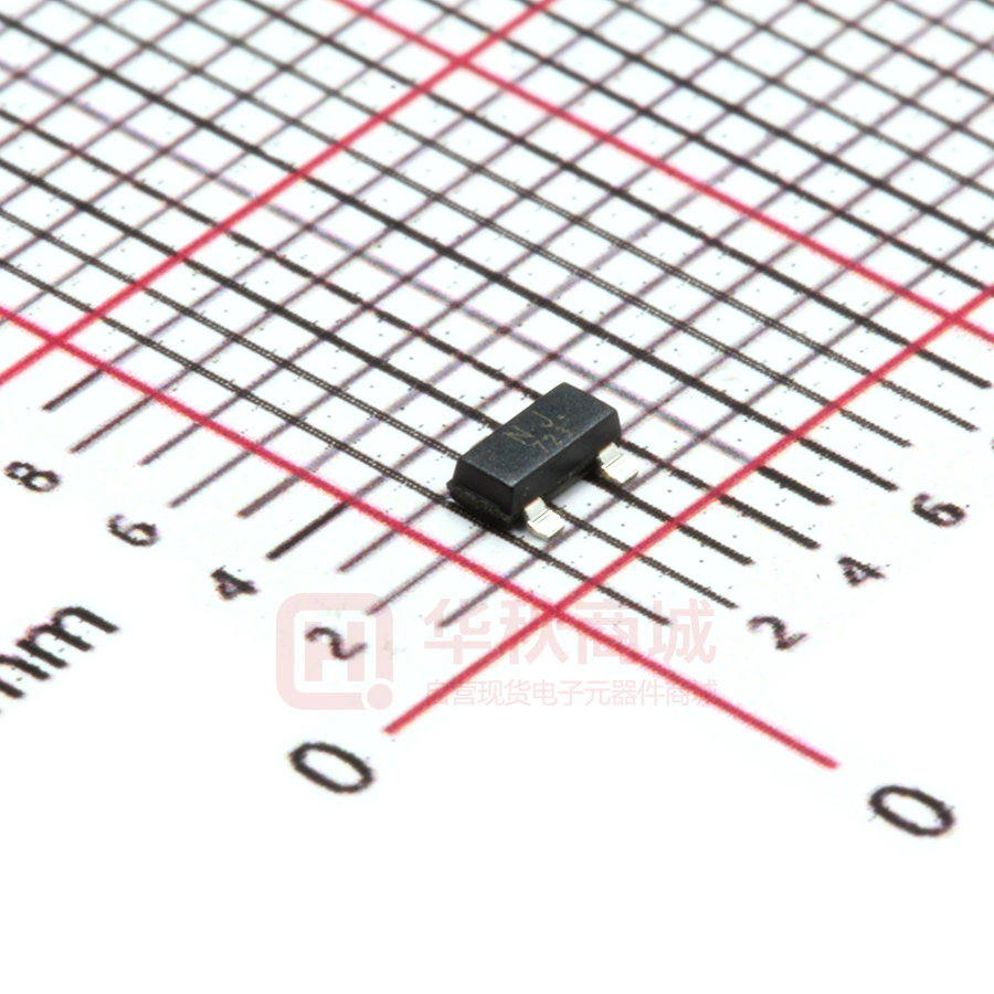

    SOT-23
    MOSFETs N-沟道 60V 700mA SOT-23
VB162KX 数据手册
VB162KX www.VBsemi.com N-Channel 60 V(D-S) MOSFET FEATURES PRODUCT SUMMARY VDS (V) RDS(on) () ID (A) 60 0.91 at V GS = 10 V 0.7 • Halogen-free According to IEC 61249-2-21 Definition • 100 % Rg and UIS Tested • Trench Power MOSFET • Compliant to RoHS Directive 2002/95/EC D TO-236 (SOT-23) G 1 G 3 S D 2 S Top View N-Channel MOSFET ABSOLUTE MAXIMUM RATINGS (TA = 25 °C, unless otherwise noted) Parameter Symbol 5s Steady State Drain-Source Voltage VDS 60 Gate-Source Voltage VGS ± 20 Continuous Drain Current (TJ = 150 °C)a TA = 25 °C TA = 70 °C Pulsed Drain Currentb Avalanche Currentb Single Avalanche Energy L = 0.1 mH Continuous Source Current (Diode Conduction)a Power Dissipationa TA = 25 °C TA = 70 °C Operating Junction and Storage Temperature Range ID 0.7 0.48 0.36 3.0 IAS 3.0 EAS 50 IS 0.7 PD V 0.55 IDM A mJ A 1.55 1.03 1.20 0.87 TJ, Tstg Unit - 55 to 150 W °C THERMAL RESISTANCE RATINGS Parameter Maximum Junction-to-Ambienta Maximum Junction-to-Foot Symbol t5s Steady State Steady State RthJA RthJF Typical Maximum 80 100 130 170 45 55 Unit °C/W Notes: a. Surface mounted on 1" x 1" FR4 board. b. Pulse width limited by maximum junction temperature. 服务热线:400-655-8788 1 VB162KX www.VBsemi.com SPECIFICATIONS (TA = 25 °C, unless otherwise noted) Limits Symbol Parameter Test Conditions Min. Typ. Max. Unit Static Drain-Source Breakdown Voltage Gate-Threshold Voltage Gate-Body Leakage Zero Gate Voltage Drain Current On-State Drain Currenta Drain-Source On-Resistancea Forward Transconductancea Diode Forward Voltage VDS VGS = 0 V, ID = 1 mA 60 VGS(th) VDS = VGS, ID = 250 µA 1.0 IGSS VDS = 0 V, VGS = ± 20 V ± 100 VDS = 60 V, VGS = 0 V 1 VDS = 60 V, VGS = 0 V, TJ = 70 °C 75 IDSS V 2.5 nA µA ID(on) VDS 15 V, VGS = 10 V RDS(on) VGS = 10 V, ID = 0.5 A 0.91  gfs VDS = 15 V, ID = 0.5 A 4 S VSD IS = 1 A, VGS = 0 V 0.8 VDS = 30 V, VGS = 10 V, ID = 0.5 A 0.37 2.5 A 1.2 V Dynamicb Total Gate Charge Qg Gate-Source Charge Qgs Gate-Drain Charge Qgd Gate Resistance Rg 3 nC 1.45 0.5 1.3 2.4 7 11  Switching Turn-On Delay Time td(on) Rise Time VDD = 30 V, R L = 33  ID  0.2 A, VGEN = 10 V, Rg = 6  tr Turn-Off Delay Time td(off) Fall Time tf Source-Drain Reverse Recovery Time trr 10 15 9 15 11 15 ns IF = 0.5 A, dI/dt = 100 A/µs50100 Notes: a. Pulse test: PW  300 µs, duty cycle  2 %. b. Guaranteed by design, not subject to production testing. Stresses beyond those listed under “Absolute Maximum Ratings” may cause permanent damage to the device. These are stress ratings only, and functional operation of the device at these or any other conditions beyond those indicated in the operational sections of the specifications is not implied. Exposure to absolute maximum rating conditions for extended periods may affect device reliability. TYPICAL CHARACTERISTICS (25 °C, unless otherwise noted) 4 4 VGS = 10 V, 9 V, 8 V 5V 3 I D - Drain Current (A) I D - Drain Current (A) 3 4V 2 3V 1 2 TC = 125 °C 1 25 °C 2 V, 1 V - 55 °C 0 0 0 2 4 6 8 VDS - Drain-to-Source Voltage (V) Output Characteristics 10 0 2 4 6 VGS - Gate-to-Source Voltage (V) 8 Transfer Characteristics 服务热线:400-655-8788 2 VB162KX www.VBsemi.com TYPICAL CHARACTERISTICS (25 °C, unless otherwise noted) 250 3.0 R DS(on) - On-Resistance () 2.5 200 C - Capacitance (pF) 2.0 1.5 VGS = 10 V 1.0 Ciss 150 100 50 0.5 Coss Crss 0 0.0 0 3 6 ID - Drain Current (A) 9 40 0 12 On-Resistance vs. Drain Current 200 2.5 VDS = 50 V ID = 0.5 A RDS(on) - On-Resistance (Normalized) VGS - Gate-to-Source Voltage (V) 160 Capacitance 20 16 12 8 4 0 0 1 2 3 4 Qg - Total Gate Charge (nC) 5 VGS = 10 V ID = 0.5 A 2.0 1.5 1.0 0.5 0.0 - 50 6 - 25 0 25 50 75 100 125 150 TJ - Junction Temperature (°C) Gate Charge On-Resistance vs. Junction Temperature 0.6 10 RDS(on) - On-Resistance () 0.5 IS - Source Current (A) 120 80 VDS - Drain-to-Source Voltage (V) TJ = 150 °C 1 0.1 TJ = 25 °C ID = 0.5 A 0.4 0.3 0.2 0.1 0.01 0.0 0.0 0.2 0.4 0.6 0.8 1.0 VSD - Source-to-Drain Voltage (V) Source-Drain Diode Forward Voltage 1.2 0 2 4 6 8 10 VGS - Gate-to-Source Voltage (V) On-Resistance vs. Gate-to-Source Voltage 服务热线:400-655-8788 3 VB162KX www.VBsemi.com 0.6 12 0.3 10 ID = 250 µA 8 0.0 Power (W) V GS(th) Variance (V) TYPICAL CHARACTERISTICS (25 °C, unless otherwise noted) - 0.3 TA = 25 °C 6 - 0.6 4 - 0.9 2 - 1.2 - 50 - 25 0 25 50 75 100 125 150 0 0.01 0.1 1 10 100 600 Time (s) TJ - Temperature (°C) Threshold Voltage Single Pulse Power 2 Normalized Effective Transient Thermal Impedance 1 Duty Cycle = 0.5 0.2 Notes: 0.1 0.1 PDM 0.05 t1 t2 1. Duty Cycle, D = 0.02 t1 t2 2. Per Unit Base = R thJA = 176 °C/W 3. T JM - TA = PDMZthJA(t) Single Pulse 4. Surface Mounted 0.01 10- 4 10- 3 10- 2 10- 1 1 Square Wave Pulse Duration (s) 10 100 600 Normalized Thermal Transient Impedance, Junction-to-Ambient 服务热线:400-655-8788 4 VB162KX www.VBsemi.com SOT-23 (TO-236): 3-LEAD b 3 E1 1 E 2 e S e1 D 0.10 mm A C 0.004" A2 C q Gauge Plane Seating Plane Seating Plane C A1 Dim 0.25 mm L L1 MILLIMETERS INCHES Min Max Min Max A 0.89 1.12 0.035 0.044 A1 0.01 0.10 0.0004 0.004 A2 0.88 1.02 0.0346 0.040 b 0.35 0.50 0.014 0.020 c 0.085 0.18 0.003 0.007 D 2.80 3.04 0.110 0.120 E 2.10 2.64 0.083 0.104 E1 1.20 1.40 0.047 0.055 e 0.95 BSC 0.0374 Ref e1 1.90 BSC 0.0748 Ref L 0.40 L1 S q 0.60 0.016 0.50 Ref 3° 0.024 0.025 Ref 0.64 Ref 0.020 Ref 8° 3° 8° ECN: S-03946-Rev. K, 09-Jul-01 DWG: 5479 服务热线:400-655-8788 5 VB162KX www.VBsemi.com 0.049 (1.245) 0.029 0.022 (0.559) (0.724) 0.037 (0.950) (2.692) 0.106 RECOMMENDED MINIMUM PADS FOR SOT-23 0.053 (1.341) 0.097 (2.459) Recommended Minimum Pads Dimensions in Inches/(mm) 服务热线:400-655-8788 6 VB162KX www.VBsemi.com Disclaimer All products due to improve reliability, function or design or for other reasons, product specifications and data are subject to change without notice. Taiwan VBsemi Electronics Co., Ltd., branches, agents, employees, and all persons acting on its or their representatives (collectively, the "Taiwan VBsemi"), assumes no responsibility for any errors, inaccuracies or incomplete data contained in the table or any other any disclosure of any information related to the product.(www.VBsemi.com) Taiwan VBsemi makes no guarantee, representation or warranty on the product for any particular purpose of any goods or continuous production. To the maximum extent permitted by applicable law on Taiwan VBsemi relinquished: (1) any application and all liability arising out of or use of any products; (2) any and all liability, including but not limited to special, consequential damages or incidental ; (3) any and all implied warranties, including a particular purpose, non-infringement and merchantability guarantee. Statement on certain types of applications are based on knowledge of the product is often used in a typical application of the general product VBsemi Taiwan demand that the Taiwan VBsemi of. Statement on whether the product is suitable for a particular application is non-binding. It is the customer's responsibility to verify specific product features in the products described in the specification is appropriate for use in a particular application. Parameter data sheets and technical specifications can be provided may vary depending on the application and performance over time. All operating parameters, including typical parameters must be made by customer's technical experts validated for each customer application. Product specifications do not expand or modify Taiwan VBsemi purchasing terms and conditions, including but not limited to warranty herein. Unless expressly stated in writing, Taiwan VBsemi products are not intended for use in medical, life saving, or life sustaining applications or any other application. Wherein VBsemi product failure could lead to personal injury or death, use or sale of products used in Taiwan VBsemi such applications using client did not express their own risk. Contact your authorized Taiwan VBsemi people who are related to product design applications and other terms and conditions in writing. The information provided in this document and the company's products without a license, express or implied, by estoppel or otherwise, to any intellectual property rights granted to the VBsemi act or document. Product names and trademarks referred to herein are trademarks of their respective representatives will be all. Material Category Policy Taiwan VBsemi Electronics Co., Ltd., hereby certify that all of the products are determined to be oHS compliant and meets the definition of restrictions under Directive of the European Parliament 2011/65 / EU, 2011 Nian. 6. 8 Ri Yue restrict the use of certain hazardous substances in electrical and electronic equipment (EEE) - modification, unless otherwise specified as inconsistent.(www.VBsemi.com) Please note that some documents may still refer to Taiwan VBsemi RoHS Directive 2002/95 / EC. We confirm that all products identified as consistent with the Directive 2002/95 / EC European Directive 2011/65 /. Taiwan VBsemi Electronics Co., Ltd. hereby certify that all of its products comply identified as halogen-free halogen-free standards required by the JEDEC JS709A. Please note that some Taiwanese VBsemi documents still refer to the definition of IEC 61249-2-21, and we are sure that all products conform to confirm compliance with IEC 61249-2-21 standard level JS709A.
