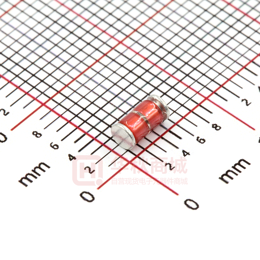

BK2-M SERIES Spark Gap (SPG) Data Sheet Features ■ ■ ■ ■ ■ ■ ■ ■ ■ ■ ■ Approximately zero leaking current before clamping voltage Less decay at on/off state. High capability to withstand repeated lightning strikes. Low electrode capacitance(≤0.8pF) and high isolation(≥100MΩ). RoHS compliant. Bilateral symmetrical. Temperature, humidity and lightness insensitive. Operating temperature: -40℃ ~ +85℃ Storage temperature: -40℃ ~ +125℃ Meets MSL level 1, per J-STD-020 Safety certification: UL: E244458 Applications ■ ■ ■ ■ ■ ■ ■ ■ ■ ■ ■ Power Supplies Motor sparks eliminating Relay switching spark absorbing Data line pulse guarding Electronic devices requiring UL497A and UL497B compliant Telephone/Fax/Modem High frequency signal transmitters/receivers Satellite antenna Radio amplifiers Alarm systems Cathode ray tubes in Monitors/TVs 2.0 Dimensions Revision:12-Aug-14 Symbol Dimension (mm) L 5.0±0.5 D Φ2.8±0.5 d Φ2.6±0.5 t 0.4±0.1 www.brightking.com BK2-M SERIES Electrical Characteristics Part Number ① DC Spark-over Voltage Minimum Insulation Resistance Maximum Capacitance (1KHz-6VMAX) Surge current capacity (8/20μs) Vs(V) Test Voltage(V) IROHM(MΩ) C(pf) BK2XX00702-M 140 50 100 0.8 1000A BK2XX01002-M 200 100 100 0.8 1000A BK2XX01102-M 220 100 100 0.8 1000A BK2XX01502-M 300 100 100 0.8 1000A BK2XX02002-M 400 250 100 0.8 1000A BK2XX02502-M 500 250 100 0.8 1000A BK2XX03002-M 600 250 100 0.8 1000A BK2XX03502-M 700 250 100 0.8 1000A BK2XX05002-M 1000 500 100 0.8 1000A Note:① Vs±XX% Test Methods and Results Items DC Spark-over Voltage Insulation Resistance Capacitance Static Life Surge Current Capacity Cold Resistance Heat Resistance Humidity Resistance Temperature Cycle Solder Ability Solder Heat Revision:12-Aug-14 Test Method Measure starting discharge voltage (Vs) by gradually increasing applied DC voltage. Test current is 0.5mA max. And the DC voltage ascends up within 100V/s(Vs<1000V) or 500V/s(Vs≥1000V). Measure the insulation resistance across the terminal at regular voltage. But the test voltage doesn’t over the DC spark-over voltage. Measure the electrostatic capacitance by applying a voltage of less than 6V (at 1KHz) between terminals. 10KV with 1500pf condenser is discharged through 0Ω resistor. 200 times at an interval of 10sec. 1.2/50μs & 8/20μs, 1000A, electrically connected with a resistor (1~2Ω), ±5 times, each time interval 60 seconds. Thereafter, outer appearance shall be visually examined. Measurement after -40℃/1000 HRS & normal temperature/2 HRS. Measurement after 125℃/1000 HRS & normal temperature/2 HRS. Measurement after humidity 90~95℃(45℃) /1000 HRS & normal temperature/2 HRS. 10 times repetition of cycle -40℃/30min →normal, temp/2 min →125℃/30min, measurement after normal temp/2 HRS. Apply flux and immerse in molten solder 230±5℃ for 3sec up to the point of 1.5mm from body. Check for solder adhesion. Measurement after lead wire is dipped up to the point of 1.5mm from body into 260±5℃ solder for 10sec. Standard Meet specified value. Rate-of-change, within ±30% insulation resistance & capacitance, conformed to rated spec. No crack and no failures Features are conformed to rated spec. Lead wire is evenly covered by solder. Conformed to rated spec. www.brightking.com BK2-M SERIES Recommended Soldering Conditions Flow Soldering Conditions Reflow Soldering Conditions 1) Time shown in the above figures is measured from the point when chip surface reaches temperature. 2) Temperature difference in high temperature part should be within 110℃. 3) After soldering, do not force cool, allow the parts to cool gradually. Hand Soldering Solder iron temperature: 350±5℃ Heating time: 3 seconds max. General attention to soldering ● High soldering temperatures and long soldering times can cause leaching of the termination, decrease in adherence strength, and the change of characteristic may occur. ● For soldering, please refer to the soldering curves above. However, please keep exposures to temperatures exceeding 200℃ to fewer than 50 seconds. ● Please use a mild flux (containing less than 0.2wt% CI). Also, if the flux is water soluble, be sure to wash thoroughly to remove any residue from the underside of components that could affect resistance. Cleaning When using ultrasonic cleaning, the board may resonate if the output power is too high. Since this vibration can cause cracking or a decrease in the adherence of the termination, we recommend that you use the conditions below. Frequency: 40kHz max. Output power: 20W/liter Cleaning time: 5 minutes max. Revision:12-Aug-14 www.brightking.com BK2-M SERIES Packaging Tape Reel Symbol Dimension (mm) W 12.00±0.20 P0 4.00±0.10 P1 4.00±0.10 P2 2.00±0.10 D0 Φ1.5±0.10 D1 Φ1.5±0.10 E 1.75±0.10 F 5.50±0.05 A0 3.00±0.10 B0 6.00±0.10 K0 3.00±0.10 T 0.30±0.05 D 178.0 d 13.0 L 15.0 Quantity: 1500PCS Revision:12-Aug-14 www.brightking.com

1. 物料型号:文档中列出了多个型号,例如BK2XX00702-M、BK2XX01002-M等,每个型号具有不同的直流火花电压(Vs)、最小绝缘电阻、最大电容(1KHz-6VMAx)和浪涌电流容量(8/20 s)。
2. 器件简介:文档提到的是一种火花间隙(Spark Gap, SPG)器件,具有零泄漏电流、高抗重复雷击能力、低电极电容和高隔离度等特点。
3. 引脚分配:文档中提供了引脚分配的表格,但具体的引脚信息和分配在文档中未明确列出。
4. 参数特性:文档提供了电气特性的详细列表,包括不同型号的直流火花电压、最小绝缘电阻、最大电容和浪涌电流容量的测试电压和结果。
5. 功能详解:文档中的功能详解部分可能指的是器件的应用场景,包括电源、电动机火花消除、继电器开关火花吸收、数据线脉冲保护等。
6. 应用信息:文档中提到了器件的应用领域,如电源、电动机火花消除、继电器开关火花吸收、电话/传真/调制解调器、高频信号发射器/接收器、卫星天线、无线电放大器、报警系统和显示器/电视中的阴极射线管。
7. 封装信息:文档列出了封装的尺寸信息,包括胶带包装和卷轴包装的详细尺寸。
