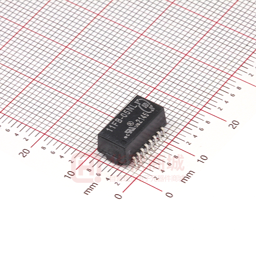

11FB-05NL
11FB-05NL
    YDS(元册)
    SMD-16P,12.8x6.9mm
    10/100BASE-T 单端口表面贴装磁性材料
11FB-05NL 数据手册
一、Mechanicals Dimensions REV. 8.89 1.0 0 9 1 10.67 8 0.635 09.2.4 Hu Li 09.7.1 Hu Li 4. Insertion Loss(dB MAX): -1.0dB(1-100MHz), -3.0dB(140MHz) 5. Return Loss(dB MIN): -16dB(5MHz), -16dB(30MHz), -13.5dB(40MHz), 5.45 4.60 1. Turn Ratio(±2%):1CT:1CT 3. CWW(100KHz/0.1V):25pF MAX SUGGESTED PAD LAYOUT 5.65 AP’PD 2. OCL(100KHz/0.1V@8mA): 350uH MIN. 0.46±0.05 -11.6dB(50MHz), -10dB(60MHz),-10dB(80MHz) 0.7±0.10 9.45 12.80 DWN 三、ELECTRICAL SPECFICATIONS@25℃: XXXX 1.27±0.10 Add Packing DATE 8.89 6.90 11FB-05NL 6.85 16 DESCRIPTION 6. HI-POT: 1500Vrms/0.5mA/60Sec or 1650Vrms/0.5mA/2Sec UNIT:mm Unless otherwise specified,all tolerances are ±0.25 二、Schematics 7. Operating Temperature:-40℃ TO +85℃ 8.POE applications current capability:350mA(MAX) 9. RoHS compliance:YES TD+ 1 TX 16 TX+ CT 2 15 CT TD- 3 14 TX- RD+ 6 CT 7 RD- 8 RX REF: BOM-AC33 元冊科技股份有限公司 YUAN DEAN SCIENTIFIC CO., LTD. 11 RX+ TITLE 10/100BASE-T SINGLE PORT SURFACE MOUNT MAGNETICS 10 CT P/N 11FB-05NL REV. 1.0 PAGE NO 1-4 DATE 2009-8-4 AP’PD Li YueSheng DWN Hu XiaoLan 9 RX- 四、Our RoHS parts just can withstand IR Reflow peak temperature: 245degC+/-5degC as the following profile: REV. Profile Feature DESCRIPTION DATE DWN AP’PD Pb-Free Assembly Average Ramp-Up Rate (Ts max to Tp) 0 3 C /second max. Preheat -Temperature Min (Ts min) -Temperature Max (Ts max) -Time (ts min to ts max) 150 C 0 200 C 60-180 seconds Time maintained above: -Temperature (TL) -Time (tL) 217 C 60-150 seconds Peak/Classification Temperature (Tp) 245±5 C 0 0 0 0 Time within 5 C of actual Peak Temperature (tp) 20-40 seconds Ramp-Down Rate 6 C/seconds max 0 6 minutes max. 0 Time 25 C to Peak Temperature 元冊科技股份有限公司 YUAN DEAN SCIENTIFIC CO., LTD. TITLE 10/100BASE-T SINGLE PORT SURFACE MOUNT MAGNETICS P/N 11FB-05NL REV. 1.0 PAGE NO 2-4 DATE 2009-8-4 AP’PD Li YueSheng DWN Hu XiaoLan REV. 五、Packing DESCRIPTION DATE DWN AP’PD Information: 1.Weight--------------0.7 grams/pcs 2.Tape & Reel------- 700 pcs 3. outer carton unit:7000pcs/box 4. outer carton unit:10 T&R/box 5.Weight: 10.5kg per carton 13.1 8 24.0 1 16 9 1 16 11.5 4.0 9 8 Mechanicals 9.9 16.0 6.05 Tape & Reel 元冊科技股份有限公司 YUAN DEAN SCIENTIFIC CO., LTD. TITLE 10/100BASE-T SINGLE PORT SURFACE MOUNT MAGNETICS P/N 11FB-05NL REV. 1.0 PAGE NO 3-4 DATE 2009-8-4 AP’PD Li YueSheng DWN Hu XiaoLan REV. 六、Packing DESCRIPTION DATE DWN AP’PD Information: 1.Weight--------------0.7 grams/pcs 2. TUBE ------- 36 pcs Size(mm) A 9.20 B 13.70 C 485.0 D 6.0 3. outer carton unit: 3600pcs/box 4. outer carton unit: 100Tube /box 5.Weight: 5.2kg per carton 元冊科技股份有限公司 YUAN DEAN SCIENTIFIC CO., LTD. TITLE 10/100BASE-T SINGLE PORT SURFACE MOUNT MAGNETICS P/N 11FB-05NL REV. 1.0 PAGE NO 4-4 DATE 2009-8-4 AP’PD Li YueSheng DWN Hu XiaoLan
