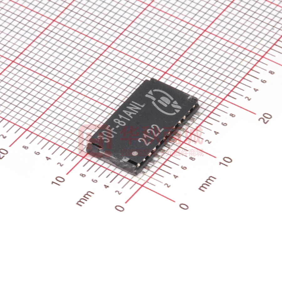

REV. 一、Mechanical Dimensions 表号:TE0115A 16.46 13.97 0 13.97 24 13 8.14 9.14 YYWW 11.35 1.27 30F-81ANL DESCRIPTION DATE DWN AP’PD 10.4.30 Hu Li 10.8.2 Hu Li Chen Hsu 15.12.2 Huang Hsu 20.1.21 Liu 1.0 Correct appearance 2.0 Correct IR&Packing 15.6.12 3.0 Add Photos 3.1 Update appearance Chen 三、ELECTRICAL SPECFICATIONS@25℃: 1. Turn Ratio(±5%): 1CT:1CT 1 12 1.98 YY:Year WW:Week 0.76 0.15TYP 1.27±0.10 2. Inductance(100KHz/0.1V@8mA):350uH MIN SUGGESTED PAD LAYOUT ∧1.4 3. Insertion Loss (dB MAX): -1.2dB(0.1MHz),-0.2-0.002*f dB(1-125MHz) 4. Return Loss (dB MIN): -16dB(0.1-40MHz), 0.46±0.05 10.35 -10 +20Log10(f/80MHz)dB(40-100MHz) UNIT:mm Unless otherwise specified, all tolerances are ±0.25 二、Schematics 5. Cross talk (dB TYP): -50dB(1MHz),-55+22Log10(f/10MHz)dB(10-100MHz) 6. CMR (dB MIN): -42dB(2MHz),-15+20Log10(f/200MHz)dB(30-200MHz) 13TD4- 15 CT 14TD4+ 17 TD3- 16 CT 18 TD3+ 19 TD2- 21 CT 20 TD2+ 23 TD1- 22 CT 24 TD1+ 7. DCR:1.6Ω MAX 8. HI-POT: 1500Vrms/0.5mA/60Sec or 1650Vrms/0.5mA/2Sec 9. Operating Temperature:0℃ TO +70℃ 10. RoHS compliance:YES 元冊科技股份有限公司 YUAN DEAN SCIENTIFIC CO., LTD. TX4-12 CT 10 TX4+11 TX3- 8 CT 9 TX3+ 7 TX2- 6 CT 4 TX2+ 5 TX1- 2 CT 3 TX1+ 1 TITLE 100/1000BASE-T FILTER P/N 30F-81ANL REV. 3.1 PAGE NO 1-3 DATE 2020-1-21 AP’PD Liu ZhiJun DWN Chen JiaPei 四、RoHS compliant type REV. DESCRIPTION DATE DWN AP’PD Our RoHS parts just can withstand IR Reflow peak temperature: 240degC MAX as the following profile: Profile Feature Pb-Free Assembly Average Ramp-Up Rate (Ts max to Tp) 0 3 C /second max. Preheat -Temperature Min (Ts min) -Temperature Max (Ts max) -Time (ts min to ts max) 150 C 0 200 C 60-120 seconds Time maintained above: -Temperature (TL) -Time (tL) 217 C 60-150 seconds Peak/Classification Temperature (Tp) 240 C MAX 0 0 0 0 Time within 5 C of actual Peak Temperature (tp) 20-40 seconds Ramp-Down Rate 6 C/seconds max 0 0 Time 25 C to Peak Temperature 6minutes max. 元冊科技股份有限公司 YUAN DEAN SCIENTIFIC CO., LTD. TITLE 100/1000BASE-T FILTER P/N 30F-81ANL REV. 3.1 PAGE NO 2-3 DATE 2020-1-21 AP’PD Liu ZhiJun DWN Chen JiaPei REV. 五、Packing DESCRIPTION DATE DWN AP’PD Information: 1.Weight--------------0.56grams/pcs 2.Tape & Reel------- 1400pcs 3. outer carton unit: 14000pcs/box 4. outer carton unit: 10T&R/box 5.Weight: 11.9kg per carton 4.0 Mechanicals 24.0 11.5 13 12 24 1 12 13 1 24 16.0 Tape & Reel 元冊科技股份有限公司 YUAN DEAN SCIENTIFIC CO., LTD. TITLE 100/1000BASE-T FILTER P/N 30F-81ANL REV. 3.1 PAGE NO 3-3 DATE 2020-1-21 AP’PD Liu ZhiJun DWN Chen JiaPei
