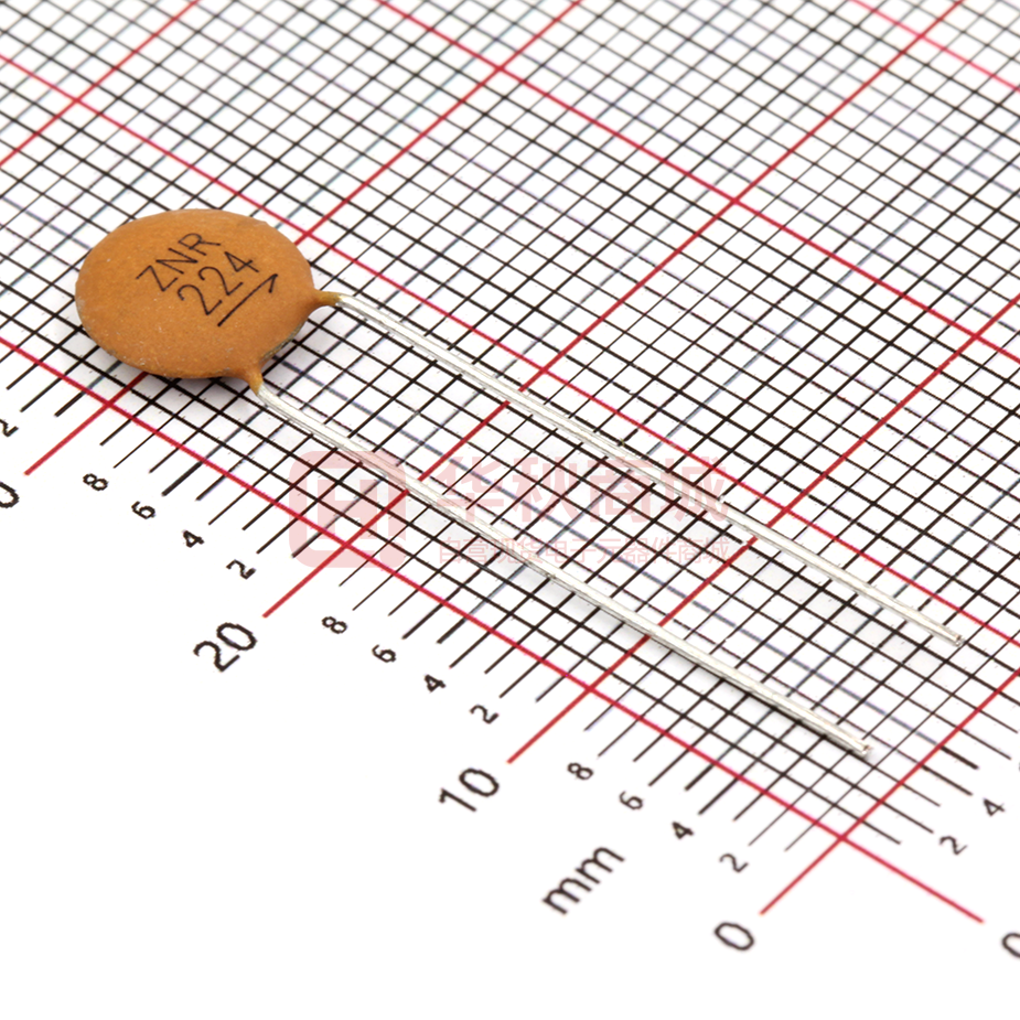

1. 规格表
DATA SHEET
产品编码
Part number
CC1H224ZC1GD3F8A3100
规格描述
Description
50V/224/Z/F5.08/直脚/L20/酚醛(黄)/Y5V(Ⅲ)/8A/ZNR
客户料号
Customer P/N
C2761732
介质类别
Dielectric class
Class 3 (Surface insulation type)
额定电压
Rated voltage
电容量
Capacitance
损耗角正切
Tangent of loss angle
耐电压
Testing voltage
50VDC
0.22uF+80%/-20%
@ 1kHz 0.1Vrms 25ºC
0.05 max @1kHz 0.1Vrms 25ºC
75VDC (Charge/discharge current 2mA max) 3s PASS
绝缘电阻
Insulation resistance
114MΩ min @ 50V 60s, RH
