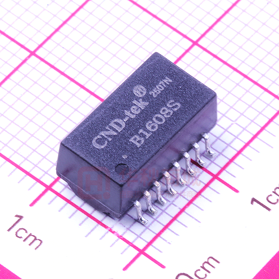

2. DIMENSIONS & MARKING
DRAWN BY: CHECKED BY: APPROVED BY: CUSTOMER:
PART NO. :B1608S
深圳磁联达电子有限公司
Shenzhen CD.com Industrial Co.,Ltd
REV.: A/0
PAGE: 2 OF 4
