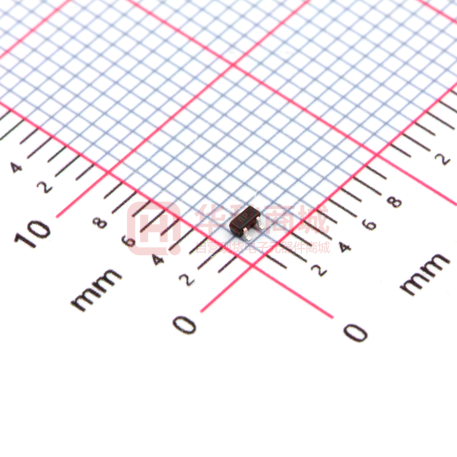

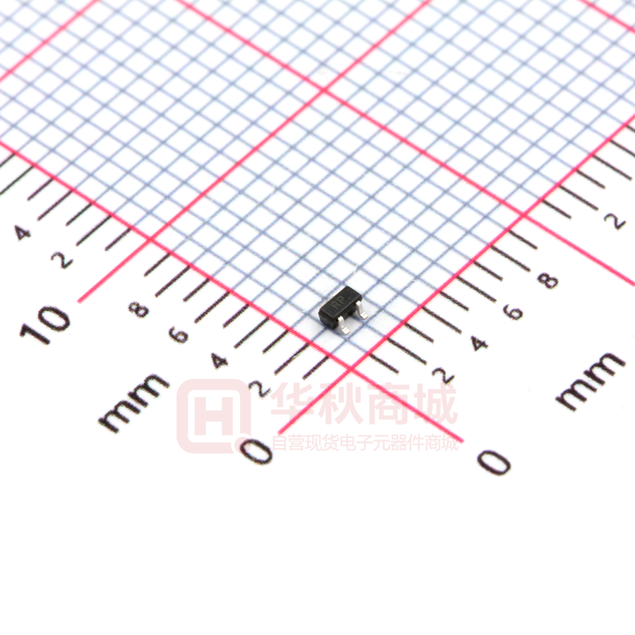

    数字晶体管(内置电阻) SOT-523 集电极电流Ic(Max):100mA 功率(Max):150mW NPN
PDTC114YE 数据手册
PDTC114YE Digital Transistor(built-in resistors) Feature  Built-in bias resistors enable the configuration of an inverter circuit without connecting external input resistors (see equivalent circuit).  The bias resistors consist of thin-film resistors with complete isolation OUT R1 IN to allow negative biasing of the input. They also have the advantage R2 GND of almost completely eliminating parasitic effects.  Only the on/off conditions need to be set for operation, making the R1=10KΩ R2=47KΩ device design easy. 3 - OUT Applications  Inverter  Interface  Driver Mechanical Characteristics 1 - IN 2 - GND Top View  Lead finish:100% matte Sn(Tin)  Mounting position: Any  Qualified max reflow temperature:260℃  Device meets MSL 1 requirements  Pure tin plating: 7 ~ 17 um  Pin flatness:≤3mil Structure NPN epitaxial planar silicon transistor (Resistor built-in type) Electrical characteristics per line@25℃( unless otherwise specified) Parameter Symbol Conditions Min. Typ. Max. Units VI(off) VCC=5V,IO=100μA - - 0.3 V VI(on) VO=0.3V,IO=1mA 1.4 - - V Output voltage VO(off) IO/II=5mA/0.25mA - 0.1 0.3 V Input current II VI=5V - - 0.88 mA IO(off) VCC=50V, VI=0V - - 0.5 μA DC current gain G1 VO=5V, IO=5mA 68 - - - Input resistance R1 - 7 10 13 KΩ Resistance ration R2/R1 - 3.7 4.7 5.7 - Transition frequency fT VCE=10V, IE= −5mA, f=100MHz - 250 - MHz Input voltage Output current Rev.06.3 1 www.prisemi.com Digital Transistor(built-in resistors) PDTC114YE Absolute maximum rating@25℃ Rating Symbol Value Units Supply voltage VCC 50 V Input voltage VIN -6 to +40 V IO 70 mA IC(MAX.) 100 mA Power dissipation Pd 150 mW Junction temperature Tj 150 ℃ Storage temperature Tstg -55 to +150 ℃ Output current Typical Characteristics 10m 100 5m 50 5 Ta=-40°C 25°C 100°C 1 0.5 500μ Ta=100°C 25°C -40°C 10 Output Current : IO(A) Input Voltage: VI(ON) (V) 1m 100μ 50μ 10μ 5μ 0.1 100μ 1μ 500μ 1m 5m 10m 50m 100m 0 1.0 1.5 2.0 2.5 3.0 Input Voltage: VI(OFF) (A) Output Current: IO(A) Rev.06.3 0.5 Fig 1.Input Voltage vs. output current Fig 2.Output current vs. input voltage @VC=0.3V (ON characteristics) @VCC=5V(OFF characteristics) 2 www.prisemi.com Digital Transistor(built-in resistors) PDTC114YE Solder Reflow Recommendation Peak Temp=257℃, Ramp Rate=0.802deg. ℃/sec 280 240 200 160 120 80 40 0 0 30 60 90 120 150 180 240 210 270 300 330 360 390 420 450 480 Time (sec) Product dimension(SOT-523) θ D b2 C (3) A1 E E1 A2 (2) (1) L e b1 L1 A e1 Rev.06.3 3 www.prisemi.com Digital Transistor(built-in resistors) PDTC114YE Millimeters Inches Dim MIN MAX MIN MAX A 0.700 0.900 0.028 0.035 A1 0.000 0.100 0.000 0.004 A2 0.700 0.800 0.028 0.031 b1 0.150 0.250 0.006 0.010 b2 0.250 0.350 0.010 0.014 c 0.100 0.200 0.004 0.008 D 1.500 1.700 0.059 0.067 E 0.700 0.900 0.028 0.035 E1 1.450 1.750 0.057 0.069 e 0.500TYP e1 0.900 L 0.020TYP 1.100 0.035 0.400REF 0.043 0.016REF L1 0.100 0.300 0.004 0.012 θ 0° 8° 0° 8° a Millimeters Dim b e d b MIN MAX a -- 0.5 b -- 0.6 c -- 1.0 d -- 1.24 e -- 0.4 c Ordering information Rev.06.3 Device Package Shipping PDTC114YE SOT-523 (Pb-Free) 3000 / Tape & Reel 4 www.prisemi.com Digital Transistor(built-in resistors) PDTC114YE IMPORTANT NOTICE and are registered trademarks of Prisemi Electronics Co., Ltd (Prisemi) ,Prisemi reserves the right to make changes without further notice to any products herein. Prisemi makes no warranty, representation or guarantee regarding the suitability of its products for any particular purpose, nor does Prisemi assume any liability arising out of the application or use of any product or circuit, and specifically disclaims any and all liability, including without limitation special, consequential or incidental damages. “Typical” parameters which may be provided in Prisemi data sheets and/or specifications can and do vary in different applications and actual performance may vary over time. All operating parameters, including “Typicals” must be validated for each customer application by customer’s technical experts. Prisemi does not convey any license under its patent rights nor the rights of others. The products listed in this document are designed to be used with ordinary electronic equipment or devices, Should you intend to use these products with equipment or devices which require an extremely high level of reliability and the malfunction of with would directly endanger human life (such as medical instruments, aerospace machinery, nuclear-reactor controllers, fuel controllers and other safety devices), please be sure to consult with our sales representative in advance. Website: http://www.prisemi.com For additional information, please contact your local Sales Representative. ©Copyright 2009, Prisemi Electronics is a registered trademark of Prisemi Electronics. All rights are reserved. Rev.06.3 5 www.prisemi.com
