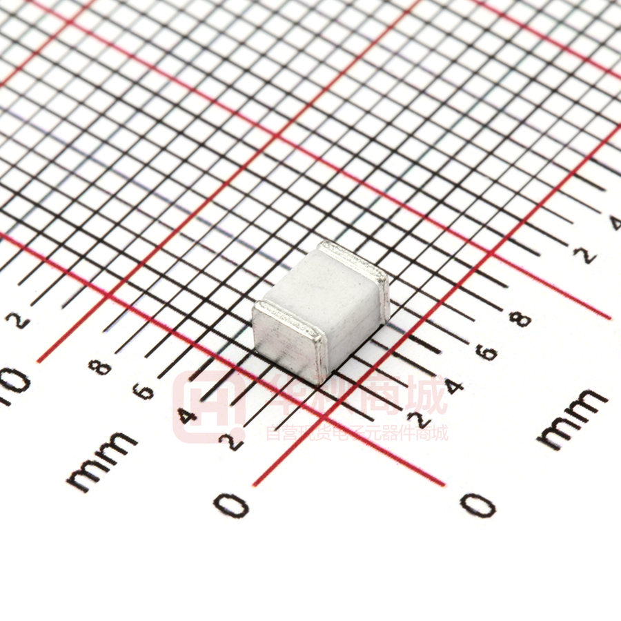

    电极数:2 直流击穿电压:400V 精度:±30% 脉冲放电电流:3kA 极间电容:0.5pF
SMD4532-400NF 数据手册
Gas Discharge Tubes(GDT) SMD4532 Series Description Gas discharge tubes (GDT) use noble gasses enclosed in ceramic tubes to provide an alternate circuit path for voltage spikes. The ceramic envelope and with nickel connectors allow for high loads. SMD4532 Gas Discharge Tubes (GDT) series has a surge rating of 2kA, 8/20μs.Offered in a Squared Surface Mount package, which helps to make pick and place on PCB process easier. This GDT series is perfectly suited for broadband equipment applications. The GDT’s low off-state capacitance is compatible with high bandwidth applications and this capacitance loading value does not vary if the voltage across the GDT changes. Electrical symbol SMD4532 Gas Discharge Tube (GDT) series are specifically designed for protection of electrical, multimedia, and communication equipment against over voltage transients in surface mount assembly applications. Features Applications l l l l l l l l l l l l Communication equipment l CATV equipment l Test equipment l Data lines l Power supplies l Telecom SLIC protection l Broadband equipment Excellent response to fast rising transients Stable breakdown voltage GHz working frequency 8/20μs Impulse current capability: 2KA Surface Mount package Non-Radioactive Ultra Low capacitance(
