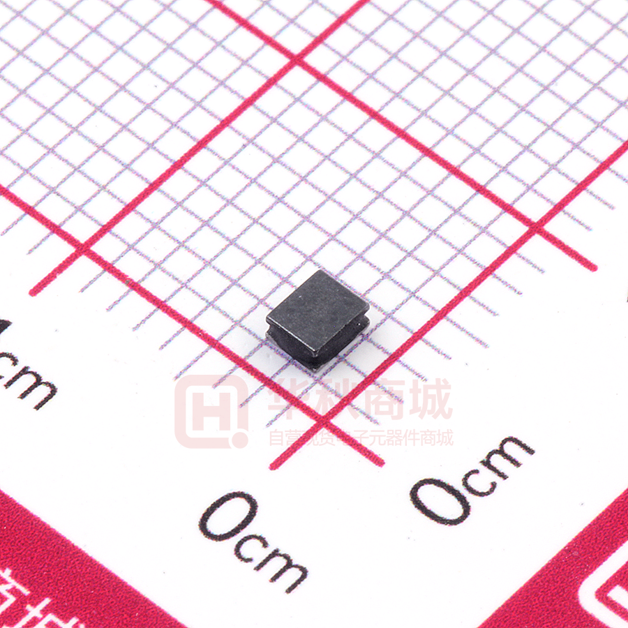

    功率电感 4.7µH ±20% 1008 1.20mm 2.50 x 2.00mm 276mΩ 1.5A
DFP252012TF-4R7M 数据手册
TAI-TECH P1 Power Inductor DFP252012TF-4R7M ECN HISTORY LIST REV DATE DESCRIPTION APPROVED CHECKED DRAWN 1.0 17/05/18 新 發 行 羅宜春 梁周虎 張光 備 註 www.tai-tech.com.tw TAI-TECH P2 Power Inductor DFP252012TF-4R7M 1. Features 1. This specification applies Low Profile Power Inductors. 2. 100% Lead(Pb) & Halogen-Free and RoHS compliant. 2. Dimension Halogen Pb Halogen-free Pb-free B A D E D C Series A(mm) B(mm) C(mm) D(mm) E(mm) DFP252012TV 2.5 -0.1/+0.2 2.0 -0.05/+0.35 1.2Max 0.85 ref. 0.80 ref. Units: mm 3. Part Numbering DFP 252012 TF A B - 4R7 M D E C A: Series B: Dimension C: Lead Free D: Inductance E: Inductance Tolerance Material 4R7=4.70uH M=±20% 4. Specification TAI-TECH Part Number DFP252012TF-4R7M Inductanc Toleranc e e (uH) (%) 4.70 Test Frequency (Hz) DCR DCR I sat I sat I rms (Ω) typ. (Ω) Max. (A) typ. (A) Max. (A) typ 0.1V/1M ±20% 0.230 0.276 1.90 Note: Isat:Based on inductance change (△L/L0:≦30%)@ ambient temp. 25℃ Irms:Based on temperature rise (△T:40℃.)Max DFP252012TF-4R7M DFP252012BF-4R7 8 Inductance(uH) 6 4 2 0 0 0.5 1 DCcurrent(A) 1.5 www.tai-tech.com.tw 2 1.60 1.50 TAI-TECH P3 5. Material List No. Description Specification a. Core Ferrite Core b. Wire Enameled Copper Wire c Glue Epoxy with magnetic powder d Terminal Ag/Ni/Sn Appearance of exposed wire tolerance limit: 1. Width direction(dimension a):Acceptable when a≦w/2 Nonconforming when a>w/2 2. Length direction(dimension b):Dimension b is not specified. 3. The total area of exposed wire occurring to each sides is not greater than 50% of coating resin area, and is acceptable. www.tai-tech.com.tw TAI-TECH P4 6. Reliability and Test Condition Item Performance Operating temperature -40~+125℃ (Including self - temperature rise) Storage temperature -40~+125℃ (on board) Test Condition Electrical Performance Test HP4284A,CH11025,CH3302,CH1320,CH1320S Inductance Refer to standard electrical characteristics list. DCR LCR Meter. CH16502,Agilent33420A Micro-Ohm Meter. Saturation DC Current (Isat) will cause L0 Saturation Current (Isat) △L≦30% typical. to drop △L(%)(keep quickly). Heat Rated Current (Irms) will cause the coil temperature rise △T(℃) without core loss. Heat Rated Current (Irms) Approximately △T≦40℃ 1.Applied the allowed DC current(keep 1 min.). 2.Temperature measured by digital surface thermometer Reliability Test Preconditioning: Run through IR reflow for 2 times.( IPC/JEDEC J-STD-020DClassification Reflow Profiles) Temperature: 125±2℃ Applied current:rated current Duration:1000±12hrs Measured at room temperature after placing for 24±2 hrs Life Test Preconditioning: Run through IR reflow for 2 times.( IPC/JEDEC J-STD-020DClassification Reflow Profiles Humidity:85±2﹪R.H, Temperature:85℃±2℃ Duration:1000hrs Min. with 100% rated current Measured at room temperature after placing for 24±2 hrs Load Humidity Moisture Resistance Appearance:No damage. Inductance:within±10% of initial value Q:Shall not exceed the specification value. RDC:within ±15% of initial value and shall not exceed the specification value Preconditioning: Run through IR reflow for 2 times.( IPC/JEDEC J-STD-020DClassification Reflow Profiles 1. Baked at50℃ for 25hrs, measured at room temperature after placing for 4 hrs. 2. Raise temperature to 65±2℃ 90-100%RH in 2.5hrs, and keep 3 hours, cool down to 25℃ in 2.5hrs. 3. Raise temperature to 65±2℃ 90-100%RH in 2.5hrs, and keep 3 hours, cool down to 25℃ in 2.5hrs,keep at 25℃ for 2 hrs then keep at -10℃ for 3 hrs 4. Keep at 25℃ 80-100%RH for 15min and vibrate at the frequency of 10 to 55 Hz to 10 Hz, measure at room temperature after placing for 1~2 hrs. Preconditioning: Run through IR reflow for 2 times.( IPC/JEDEC J-STD-020DClassification Reflow Profiles Condition for 1 cycle Step1:-40±2℃ 30±5min Step2:25±2℃ ≦0.5min Step3:125±2℃ 30±5min Number of cycles: 500 Measured at room temperature after placing for 24±2 hrs Thermal shock Oscillation Frequency: 10~2K~10Hz for 20 minutes Equipment: Vibration checker Total Amplitude:1.52mm±10% Testing Time : 12 hours(20 minutes, 12 cycles each of 3 orientations)。 Vibration www.tai-tech.com.tw TAI-TECH Item P5 Performance Shock Bending Soderability Appearance:No damage. Inductance:within±10% of initial value Q:Shall not exceed the specification value. RDC:within ±15% of initial value and shall not exceed the specification value More than 95% of the terminal electrode should be covered with solder。 Test Condition Type Peak value (g’s) Normal duration (D) (ms) Wave form Velocity change (Vi)ft/sec SMD 50 11 Half-sine 11.3 Lead 50 11 Half-sine 11.3 shocks in each direction along 3 perpendicular axes. Shall be mounted on a FR4 substrate of the following dimensions: >=0805:40x100x1.2mm =0805inch(2012mm):1.2mm 0805 inch(2012mm):1kg ,
