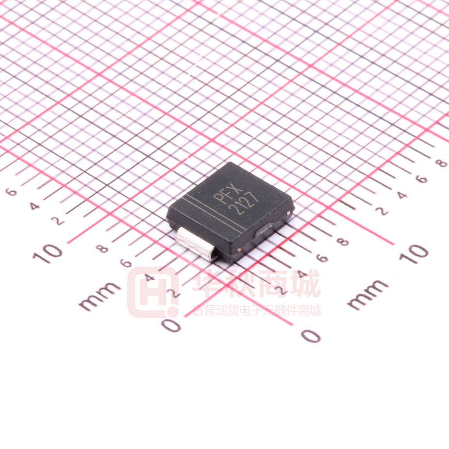

    ESD抑制器/TVS二极管 Vrwm=48V Vbr(min)=53.3V Vc= 77.4V@Ipp =38.8A SMC
SMDJ48A 数据手册
山东晶导微电子股份有限公司 Jingdao Microelectronics co.LTD SMDJ Series The SMDJ series is designed specifically to protect sensitive electronic equipment from voltage transients PINNING induced by lig htning and other transient voltage events. PIN MECHANICAL DATA • Case: SMC • Terminals: Solderable per MIL-STD-750, Method 2026 • A pprox. Weight: 0.22g / 0.0077oz DESCRIPTION 1 Cathode 2 Anode 2 Unipolar FEATURES 1 • For surface mounted applications in order to optimize board space • Low profile package Bipolar • Built-in strain relief • Glass passivated chip junction Simplified outline SMC and symbol • 3000W peak pulse power capability at lOxlOOOUs waveform, repetition rate {duty cycles):0.01 % • Excellent clamping capability • Low incremental surge resistance • Matte Tin Lead-free Plated Maximum Ratings and Thermal Characteristics (TA=25℃ unless otherwise noted) Symbol Value Unit Peak Pulse Power Dissipation at T A =25°C by 10x1000 us waveform (Fig.l)(Note l), (Note 2) P PPM 3000 W Power Dissipation on infinite heat sink at TA=50℃ P M(AV) 6.5 W Peak Forward Surge Current, 8.3ms Single Half Sine Wave (Note 3) I FSM 300 A Maximum Instantaneous Forward Voltage at 100A for Unidirectional only VF 3.5 V T j T STG -65 to 150 ℃ Typical Thermal Resistance Junction to Lead R UJL 15 Typical Thermal Resistance Junction to Ambient R UJA 75 Parameter Operating Junction and Storage Temperature Range ℃/W ℃/W Notes: 1. Non-repetitive current pulse . per Fig 3 and derated above Ta = 25℃ per Fig. 2 2. Mounted on copper pad area of 0.31x0.31" (8.0 x 8.0mm) to each terminal 3. Measured on 8.3ms single half sine wave or eguivalent square wave for unidirectional device only, duty cycle=4 per minute maximum 2017.01 SMC-TVS-SMDJ Series -3000W Page 1 of 4 山东晶导微电子股份有限公司 Jingdao Microelectronics co.LTD SMDJ Series Characteristics at Ta = 25°C Table 1 Reverse Stand-off Voltage Type UNI BI Breakdown Voltage V BR @ I T Max.Clamp Voltage Max. Peak Pulse Current Max. Reverse Leakage Package IT V C @ I PP I PP IR@VR Device Marking Ccode V A uA UNI RDE DDE RDG DDG Test Current V RMW Min Max V V V mA SMC BI SMDJ5.0A SMDJ5.0CA 5.0 6.4 7 10 9.2 326.1 800 SMDJ6.0A SMDJ6.0CA 6.0 6.67 7.37 10 10.3 291.3 800 SMDJ6.5A SMDJ6.5CA 6.5 7.22 7.98 10 11.2 267.9 500 RDK DDK SMDJ7.0A SMDJ7.0CA 7.0 7.78 8.6 10 12 250 200 PDM DDM SMDJ7.5A SMDJ7.5CA 7.5 8.33 9.21 1 12.9 232.6 100 PDP DDP SMDJ8.0A SMDJ8.0CA 8.0 8.89 9.83 1 13.6 220.6 50 PDR DDR SMDJ8.5A SMDJ8.5CA 8.5 9.44 10.4 1 14.4 208.3 20 PDT DDT SMDJ9.0A SMDJ9.0CA 9.0 10 11.1 1 15.4 194.8 10 PDV DDV SMDJ10A SMDJ10CA 10.0 11.1 12.3 1 17 176.5 5 PDX DDX SMDJ11A SMDJ11CA 11.0 12.2 13.5 1 18.2 164.8 2 PDZ DDZ SMDJ12A SMDJ12CA 12.0 13.3 14.7 1 19.9 150.8 2 PEE DEE SMDJ13A SMDJ13CA 13.0 14.4 15.9 1 21.5 139.5 2 PEG DEG SMDJ14A SMDJ14CA 14.0 15.6 17.2 1 23.2 129.3 2 PEK DEK SMDJ15A SMDJ15CA 15.0 16.7 18.5 1 24.4 123 2 PEM DEM SMDJ16A SMDJ16CA 16.0 17.8 19.7 1 26 115.4 2 PEP DEP SMDJ17A SMDJ17CA 17.0 18.9 20.9 1 27.6 108.7 2 PER DER SMDJ18A SMDJ18CA 18.0 20 22.1 1 29.2 102.7 2 PET DET SMDJ20A SMDJ20CA 20.0 22.2 24.5 1 32.4 92.6 2 PEV DEV SMDJ22A SMDJ22CA 22.0 24.4 26.9 1 35.5 84.5 2 PEX DEX SMDJ24A SMDJ24CA 24.0 26.7 29.5 1 38.9 77.1 2 PEZ DEZ SMDJ26A SMDJ26CA 26.0 28.9 31.9 1 42.1 71.3 2 PFE DFE SMDJ28A SMDJ28CA 28.0 31.1 34.4 1 45.4 66.1 2 PFG DFG SMDJ30A SMDJ30CA 30.0 33.3 36.8 1 48.4 62 2 PFK DFK SMDJ33A SMDJ33CA 33.0 36.7 40.6 1 53.3 56.3 2 PFM DFM SMDJ36A SMDJ36CA 36.0 40 44.2 1 58.1 51.6 2 PFP DFP SMDJ40A SMDJ40CA 40.0 44.4 49.1 1 64.5 46.5 2 PFR DFR SMDJ43A SMDJ43CA 43.0 47.8 52.8 1 69.4 43.2 2 PFT DFT SMDJ45A SMDJ45CA 45.0 50 55.3 1 72.7 41.3 2 PFV DFV SMDJ48A SMDJ48CA 48.0 53.3 58.9 1 77.4 38.8 2 PFX DFX SMDJ51A SMDJ51CA 51.0 56.7 62.7 1 82.4 36.4 2 PFZ DFZ SMDJ54A SMDJ54CA 54.0 60 66.3 1 87.1 34.4 2 RGE DGE SMDJ58A SMDJ58CA 58.0 64.4 71.2 1 93.6 32.1 2 PGG DGG SMDJ60A SMDJ60CA 60.0 66.7 73.7 1 96.8 31 2 PGK DGK SMDJ64A SMDJ64CA 64.0 71.1 78.6 1 103 29.1 2 PGM DGM SMDJ70A SMDJ70CA 70.0 77.8 86 1 113 26.5 2 PGP DGP SMDJ75A SMDJ75CA 75.0 83.3 92.1 1 121 24.8 2 PGR DGR SMDJ78A SMDJ78CA 78.0 86.7 95.8 1 126 23.8 2 PGT DGT SMDJ85A SMDJ85CA 85.0 94.4 104 1 137 21.9 2 PGV DGV SMDJ90A SMDJ90CA 90.0 100 111 1 146 20.5 2 PGX DGX SMDJ100A SMDJ100CA 100.0 111 123 1 162 18.5 2 PGZ DGZ SMDJ110A SMDJ110CA 110.0 122 135 1 177 16.9 2 PHE DHE SMDJ120A SMDJ120CA 120.0 133 147 1 193 15.5 2 PHG DHG SMDJ130A SMDJ130CA 130.0 144 159 1 209 14.4 2 PHK DHK SMDJ150A SMDJ150CA 150.0 167 185 1 243 12.3 2 PHM DHM SMDJ160A SMDJ160CA 160.0 178 197 1 259 11.6 2 PHP DHP SMDJ170A SMDJ170CA 170.0 189 209 1 275 10.9 2 PHR DHR 2017.01 www.sdjingdao.com Page 2 of 4 山东晶导微电子股份有限公司 Jingdao Microelectronics co.LTD SMDJ Series Fig.2 Forward Current Derating Curve 1000 Non-Repetive Pulse.Wavefom Shown in Figure.3 T A=25°C 100 10 0.31x0.31" (80 x 80mm) Copper pad Area 1.0 0.1 1 10 100 1000 10000 PEAK PULSE POWER(P PP)OR CURRENT(I PP) DERATINGIN PERCENTAGE% P PPM,PEAK PULSE FORWARD ,kW Fig.1 Peak Pulse Power Rating Curve 100 80 60 40 20 0 25 Fig.3 Pulse Waveform I ppm 10000 Bi-directional V= 0V 80 Half Value-I pp /2 60 Uni-directional V=0V 1000 Uni-directional @ VR 100 10/1000usec Waveform as Defined bye R.E.A. 40 Bi-directional @ VR 10 20 1 0 1.0 2.0 3.0 1 4.0 T,TIME,ms 100 1000 Fig.6 Maximum Non-Repetitive Peak Forward Surge Current 5 4 3 2 1 25 50 75 100 125 150 175 TA - Ambient Temperature(ºC) I FSM,PEAK FORWARD SURGE CURRENT, AMPERES 6 0 10 V BR - Reverse Breakdown Voltage (V) Fig.5 Steady State Power Derating Curve P M(AV) Steady Sate Power Dissipation (W) 175 100000 0 2017.01 150 Pulse Width (td) is Defined as the Point where the Peak. Current Decayst to 50% of Ipp Cj (pF) I ppm ,Peak Pulse Current (%) Peak Value 100 125 Fig.4 Typical Junction Capacitance T A =25°C t f =10usec 100 T A,AMBIENT TEMPERATURE,°C t d,PULSE WIDTH ,us 120 75 50 360 300 240 180 120 60 www.sdjingdao.com T J=T Jmax 8.3ms Single Half Sinepwave JEDEC Method 0 1 10 100 Number of Cycles at 60Hz Page 3 of 4 山东晶导微电子股份有限公司 Jingdao Microelectronics co.LTD SMDJ Series PACKAGE OUTLINE SMC Plastic surface mounted package; 2 leads E A A1 A C b D L E1 VM A SMC mechanical data A E D E1 A1 C L b max 2.62 7.0 6.2 8.0 0.21 0.31 1.6 3.25 min 2.00 6.5 5.6 7.6 0.05 0.15 0.9 2.75 max 103 276 244 315 8.3 12 63 128 min 79 256 220 299 2.0 5.9 35 108 UNIT mm mil The recommended mounting pad size 3.8 (150) 4.1 (160) 4.3 (170) 4.1 (160) mm Unit : (mil) 2017.01 JD 80404 1B60 Page 4 of 4
