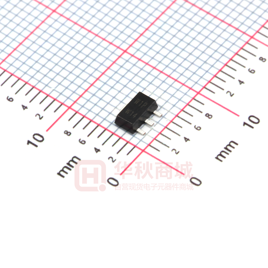

PXT2222A NPN switching transistors 2 April 2014 Product data sheet 1. General description NPN switching transistor in a medium power flat lead SOT89 (SC-62/TO-243) SurfaceMounted Device (SMD) plastic package. PNP complement: PXT2907A 2. Features and benefits • • High current: max. 600 mA Low voltage: max. 40 V 3. Applications • Switching and linear amplification 4. Quick reference data Table 1. Quick reference data Symbol Parameter Conditions Min Typ Max Unit VCEO collector-emitter voltage open base - - 40 V IC collector current - - 600 mA hFE DC current gain 100 - 300 VCE = 10 V; IC = 150 mA; Tamb = 25 °C; δ ≤ 0.02; tp ≤ 300 µs; pulsed 5. Pinning information Table 2. Pinning information Pin Symbol Description 1 E emitter 2 C collector 3 B base Simplified outline Graphic symbol C B 3 2 1 SOT89 E sym123 PXT2222A Nexperia NPN switching transistors 6. Ordering information Table 3. Ordering information Type number Package PXT2222A Name Description Version SOT89 plastic surface-mounted package; die pad for good heat transfer; SOT89 3 leads 7. Marking Table 4. Marking codes Type number Marking code [1] PXT2222A %1P [1] % = placeholder for manufacturing site code 8. Limiting values Table 5. Limiting values In accordance with the Absolute Maximum Rating System (IEC 60134). Symbol Parameter Conditions Min Max Unit VCBO collector-base voltage open emitter - 60 V VCEO collector-emitter voltage open base - 40 V VEBO emitter-base voltage open collector - 6 V IC collector current - 600 mA ICM peak collector current - 800 mA IBM peak base current - 200 mA Ptot total power dissipation [1] - 0.5 W [2] - 0.8 W [3] - 1.1 W tp ≤ 1 ms; single pulse Tamb ≤ 25 °C Tj junction temperature - 150 °C Tamb ambient temperature -65 150 °C Tstg storage temperature -65 150 °C [1] [2] [3] PXT2222A Product data sheet Transistor mounted on an FR4 Printed-Circuit Board (PCB), single-sided copper, tin-plated and standard footprint. 2 Transistor mounted on an FR4 PCB, single-sided copper, tin-plated and mounting pad for collector 1 cm . 2 Transistor mounted on an FR4 PCB, single-sided copper, tin-plated and mounting pad for collector 6 cm . All information provided in this document is subject to legal disclaimers. 2 April 2014 © Nexperia B.V. 2017. All rights reserved 2 / 15 PXT2222A Nexperia NPN switching transistors 006aaa238 1600 Ptot (mW) 1200 (1) (2) 800 (3) 400 0 - 75 - 25 25 75 125 175 Tamb (°C) 2 (1) FR4 PCB; 6 cm mounting pad for collector. 2 (2) FR4 PCB; 1 cm mounting pad for collector. (3) FR4 PCB; standard footprint. Fig. 1. Power derating curves 9. Thermal characteristics Table 6. Thermal characteristics Symbol Parameter Conditions Rth(j-a) thermal resistance from junction to ambient in free air Rth(j-sp) thermal resistance from junction to solder point [1] [2] [3] PXT2222A Product data sheet Min Typ Max Unit [1] - - 250 K/W [2] - - 156 K/W [3] - - 113 K/W - - 30 K/W Transistor mounted on an FR4 PCB, single-sided copper, tin-plated and standard footprint. 2 Transistor mounted on an FR4 PCB, single-sided copper, tin-plated and mounting pad for collector 1 cm . 2 Transistor mounted on an FR4 PCB, single-sided copper, tin-plated and mounting pad for collector 6 cm . All information provided in this document is subject to legal disclaimers. 2 April 2014 © Nexperia B.V. 2017. All rights reserved 3 / 15 PXT2222A Nexperia NPN switching transistors 006aaa235 103 Zth (K/W) duty cycle = 1 0.75 102 0.5 0.33 0.2 0.1 0.05 10 0.02 0 1 10-5 0.01 10-4 10-3 10-2 10-1 1 10 102 tp (s) 103 Mounted on FR4 PCB; standard footprint. Fig. 2. Transient thermal impedance as a function of pulse time; typical values 006aaa236 103 Zth (K/W) duty cycle = 1 102 0.75 0.33 0.5 0.2 0.1 10 0 1 10-5 0.05 0.02 0.01 10-4 10-3 10-2 10-1 1 10 102 tp (s) 103 2 Mounted on FR4 PCB; mounting pad for collector 1 cm . Fig. 3. Transient thermal impedance as a function of pulse time; typical values PXT2222A Product data sheet All information provided in this document is subject to legal disclaimers. 2 April 2014 © Nexperia B.V. 2017. All rights reserved 4 / 15 PXT2222A Nexperia NPN switching transistors 006aaa237 103 Zth (K/W) 102 duty cycle = 1 0.75 0.33 0.5 0.2 10 0.1 0.05 0.02 0 1 10-5 0.01 10-4 10-3 10-2 10-1 1 10 102 tp (s) 103 Mounted on FR4 PCB; mounting pad for collector 6 cm2. Fig. 4. Transient thermal impedance as a function of pulse time; typical values PXT2222A Product data sheet All information provided in this document is subject to legal disclaimers. 2 April 2014 © Nexperia B.V. 2017. All rights reserved 5 / 15 PXT2222A Nexperia NPN switching transistors 10. Characteristics Table 7. Characteristics Symbol Parameter Conditions Min Typ Max Unit ICBO collector-base cut-off current VCB = 60 V; IE = 0 A; Tamb = 25 °C - - 10 nA VCB = 60 V; IE = 0 A; Tj = 125 °C - - 10 µA IEBO emitter-base cut-off current VEB = 5 V; IC = 0 A; Tamb = 25 °C - - 10 nA hFE DC current gain VCE = 10 V; IC = 0.1 mA; Tamb = 25 °C 35 - - VCE = 10 V; IC = 1 mA; Tamb = 25 °C 50 - - VCE = 10 V; IC = 10 mA; Tamb = 25 °C 75 - - VCE = 10 V; IC = 10 mA; Tj = -55 °C 35 - - VCE = 1 V; IC = 150 mA; tp ≤ 300 µs; 50 - - 100 - 300 40 - - IC = 150 mA; IB = 15 mA; Tamb = 25 °C - - 300 mV IC = 500 mA; IB = 50 mA; Tamb = 25 °C - - 1 V base-emitter saturation IC = 150 mA; IB = 15 mA; Tamb = 25 °C voltage IC = 500 mA; IB = 50 mA; Tamb = 25 °C 0.6 - 1.2 V - - 2 V delay time IC = 150 mA; IBon = 15 mA; - - 15 ns tr rise time IBoff = -15 mA; Tamb = 25 °C - - 20 ns ton turn-on time - - 35 ns ts storage time - - 200 ns tf fall time - - 60 ns toff turn-off time - - 250 ns CC collector capacitance - - 8 pF - - 25 pF 300 - - MHz - - 4 dB δ ≤ 0.02; Tamb = 25 °C; pulsed VCE = 10 V; IC = 150 mA; tp ≤ 300 µs; δ ≤ 0.02; Tamb = 25 °C; pulsed VCE = 10 V; IC = 500 mA; tp ≤ 300 µs; δ ≤ 0.02; Tamb = 25 °C; pulsed VCEsat VBEsat td collector-emitter saturation voltage VCB = 10 V; IE = 0 A; ie = 0 A; f = 1 MHz; Tamb = 25 °C CE emitter capacitance VEB = 500 mV; IC = 0 A; ic = 0 A; f = 1 MHz; Tamb = 25 °C fT transition frequency VCE = 10 V; IC = 20 mA; f = 100 MHz; Tamb = 25 °C NF noise figure VCE = 5 V; IC = 200 µA; RS = 2 kΩ; f = 1 kHz; B = 200 Hz; Tamb = 25 °C PXT2222A Product data sheet All information provided in this document is subject to legal disclaimers. 2 April 2014 © Nexperia B.V. 2017. All rights reserved 6 / 15 PXT2222A Nexperia NPN switching transistors aaa-011462 600 0.8 IC (A) hFE aaa-011463 IB = 13 mA 11.7 9.1 10.4 6.5 0.6 400 7.8 5.2 3.9 (1) 2.6 0.4 (2) 200 1.3 0.2 (3) 0 10-1 1 10 102 IC (mA) 0 103 VCE = 10 V 2 4 6 8 VCE (V) 10 Tamb = 25 °C (1) Tamb = 150 °C Fig. 6. (2) Tamb = 25 °C Collector current as a function of collectoremitter voltage; typical values (3) Tamb = −55 °C Fig. 5. 0 DC current gain as a function of collector current; typical values aaa-011464 1.2 aaa-011465 1.2 VBEsat (V) VBE (V) 1.0 0.8 (1) 0.8 (1) (2) (2) 0.6 0.4 (3) 0.4 0 10-1 Fig. 7. 1 10 102 IC (mA) 0.2 10-1 103 (3) 1 VCE = 1 V IC/IB = 10 (1) Tamb = −55 °C (1) Tamb = −55 °C (2) Tamb = 25 °C (2) Tamb = 25 °C (3) Tamb = 150 °C (3) Tamb = 150 °C Base-emitter voltage as a function of collector current; typical values PXT2222A Product data sheet Fig. 8. 102 IC (mA) 103 Base-emitter saturation voltage as a function of collector current; typical values All information provided in this document is subject to legal disclaimers. 2 April 2014 10 © Nexperia B.V. 2017. All rights reserved 7 / 15 PXT2222A Nexperia NPN switching transistors aaa-011466 1 VCEsat (V) (1) (2) 10-1 (3) 10-2 10-1 1 10 102 IC (mA) 103 IC/IB = 10 (1) Tamb = 150 °C (2) Tamb = 25 °C (3) Tamb = −55 °C Fig. 9. Collector-emitter saturation voltage as a function of collector current; typical values PXT2222A Product data sheet All information provided in this document is subject to legal disclaimers. 2 April 2014 © Nexperia B.V. 2017. All rights reserved 8 / 15 PXT2222A Nexperia NPN switching transistors 11. Test information IB input pulse (idealized waveform) 90 % IBon (100 %) 10 % IBoff output pulse (idealized waveform) IC 90 % IC (100 %) 10 % t td ts tr ton tf toff 006aaa003 Fig. 10. BISS transistor switching time definition VBB RB VCC RC (probe) oscilloscope 450 Ω Vo (probe) 450 Ω R2 VI oscilloscope DUT R1 mlb826 Fig. 11. Test circuit for switching times PXT2222A Product data sheet All information provided in this document is subject to legal disclaimers. 2 April 2014 © Nexperia B.V. 2017. All rights reserved 9 / 15 PXT2222A Nexperia NPN switching transistors 12. Package outline 4.6 4.4 1.8 1.4 1.6 1.4 2.6 2.4 4.25 3.75 1 0.53 0.40 1.5 2 1.2 0.8 3 0.48 0.35 0.44 0.23 3 Dimensions in mm 06-08-29 Fig. 12. Package outline SOT89 13. Soldering 4.75 2.25 2 1.9 1.2 0.2 0.85 solder lands 1.7 1.2 4.6 solder resist 0.5 1 (3×) 4.85 1.1 (2×) 1.5 solder paste occupied area Dimensions in mm 1.5 0.6 (3×) 0.7 (3×) 3.95 sot089_fr Fig. 13. Reflow soldering footprint for SOT89 PXT2222A Product data sheet All information provided in this document is subject to legal disclaimers. 2 April 2014 © Nexperia B.V. 2017. All rights reserved 10 / 15 PXT2222A Nexperia NPN switching transistors 6.6 2.4 3.5 solder lands 7.6 0.5 solder resist occupied area 1.8 (2×) Dimensions in mm preferred transport direction during soldering 1.9 1.5 (2×) 1.9 0.7 5.3 sot089_fw Fig. 14. Wave soldering footprint for SOT89 PXT2222A Product data sheet All information provided in this document is subject to legal disclaimers. 2 April 2014 © Nexperia B.V. 2017. All rights reserved 11 / 15 PXT2222A Nexperia NPN switching transistors 14. Revision history Table 8. Revision history Data sheet ID Release date Data sheet status Change notice Supersedes PXT2222A v.5 20140402 Product data sheet - PXT2222A v.4 Modifications: • • • • • • • • • The format of this data sheet has been redesigned to comply with the new identity guidelines of NXP Semiconductors. Legal texts have been adapted to the new company name where appropriate. General description: updated. Quick refernce data: added. Thermal characteristics: Figure 2 to 4 updated. Limiting values: values of IC, ICM and IBM parameters corrected. Characteristics: Figures 5 to 9 added. Soldering information: added. Legal information: updated. PXT2222A v.4 20041122 Product specification - PXT2222A v.3 PXT2222A v.3 19990414 Product specification - PXT2222A v.2 PXT2222A v.2 19970505 Product specification - PXT2222A v.1 PXT2222A v.1 19940901 Product specification - - PXT2222A Product data sheet All information provided in this document is subject to legal disclaimers. 2 April 2014 © Nexperia B.V. 2017. All rights reserved 12 / 15 PXT2222A Nexperia NPN switching transistors In no event shall Nexperia be liable for any indirect, incidental, punitive, special or consequential damages (including - without limitation lost profits, lost savings, business interruption, costs related to the removal or replacement of any products or rework charges) whether or not such damages are based on tort (including negligence), warranty, breach of contract or any other legal theory. 15. Legal information 15.1 Data sheet status Notwithstanding any damages that customer might incur for any reason whatsoever, Nexperia’s aggregate and cumulative liability towards customer for the products described herein shall be limited in accordance with the Terms and conditions of commercial sale of Nexperia. Document status [1][2] Product status [3] Objective [short] data sheet Development This document contains data from the objective specification for product development. Preliminary [short] data sheet Qualification This document contains data from the preliminary specification. Product [short] data sheet Production This document contains the product specification. [1] [2] [3] Definition Right to make changes — Nexperia reserves the right to make changes to information published in this document, including without limitation specifications and product descriptions, at any time and without notice. This document supersedes and replaces all information supplied prior to the publication hereof. Please consult the most recently issued document before initiating or completing a design. The term 'short data sheet' is explained in section "Definitions". The product status of device(s) described in this document may have changed since this document was published and may differ in case of multiple devices. The latest product status information is available on the Internet at URL http://www.nexperia.com. 15.2 Definitions Preview — The document is a preview version only. The document is still subject to formal approval, which may result in modifications or additions. Nexperia does not give any representations or warranties as to the accuracy or completeness of information included herein and shall have no liability for the consequences of use of such information. Draft — The document is a draft version only. The content is still under internal review and subject to formal approval, which may result in modifications or additions. Nexperia does not give any representations or warranties as to the accuracy or completeness of information included herein and shall have no liability for the consequences of use of such information. Short data sheet — A short data sheet is an extract from a full data sheet with the same product type number(s) and title. A short data sheet is intended for quick reference only and should not be relied upon to contain detailed and full information. For detailed and full information see the relevant full data sheet, which is available on request via the local Nexperia sales office. In case of any inconsistency or conflict with the short data sheet, the full data sheet shall prevail. Product specification — The information and data provided in a Product data sheet shall define the specification of the product as agreed between Nexperia and its customer, unless Nexperia and customer have explicitly agreed otherwise in writing. In no event however, shall an agreement be valid in which the Nexperia product is deemed to offer functions and qualities beyond those described in the Product data sheet. 15.3 Disclaimers Limited warranty and liability — Information in this document is believed to be accurate and reliable. However, Nexperia does not give any representations or warranties, expressed or implied, as to the accuracy or completeness of such information and shall have no liability for the consequences of use of such information. Nexperia takes no responsibility for the content in this document if provided by an information source outside of Nexperia. PXT2222A Product data sheet Suitability for use — Nexperia products are not designed, authorized or warranted to be suitable for use in life support, life-critical or safety-critical systems or equipment, nor in applications where failure or malfunction of a Nexperia product can reasonably be expected to result in personal injury, death or severe property or environmental damage. Nexperia and its suppliers accept no liability for inclusion and/or use of Nexperia products in such equipment or applications and therefore such inclusion and/or use is at the customer’s own risk. Quick reference data — The Quick reference data is an extract of the product data given in the Limiting values and Characteristics sections of this document, and as such is not complete, exhaustive or legally binding. Applications — Applications that are described herein for any of these products are for illustrative purposes only. Nexperia makes no representation or warranty that such applications will be suitable for the specified use without further testing or modification. Customers are responsible for the design and operation of their applications and products using Nexperia products, and Nexperia accepts no liability for any assistance with applications or customer product design. It is customer’s sole responsibility to determine whether the Nexperia product is suitable and fit for the customer’s applications and products planned, as well as for the planned application and use of customer’s third party customer(s). Customers should provide appropriate design and operating safeguards to minimize the risks associated with their applications and products. Nexperia does not accept any liability related to any default, damage, costs or problem which is based on any weakness or default in the customer’s applications or products, or the application or use by customer’s third party customer(s). Customer is responsible for doing all necessary testing for the customer’s applications and products using Nexperia products in order to avoid a default of the applications and the products or of the application or use by customer’s third party customer(s). Nexperia does not accept any liability in this respect. Limiting values — Stress above one or more limiting values (as defined in the Absolute Maximum Ratings System of IEC 60134) will cause permanent damage to the device. Limiting values are stress ratings only and (proper) operation of the device at these or any other conditions above those given in the Recommended operating conditions section (if present) or the Characteristics sections of this document is not warranted. Constant or repeated exposure to limiting values will permanently and irreversibly affect the quality and reliability of the device. Terms and conditions of commercial sale — Nexperia products are sold subject to the general terms and conditions of commercial sale, as published at http://www.nexperia.com/profile/terms, unless otherwise agreed in a valid written individual agreement. In case an individual agreement is concluded only the terms and conditions of the respective agreement shall apply. Nexperia hereby expressly objects to applying the customer’s general terms and conditions with regard to the purchase of Nexperia products by customer. No offer to sell or license — Nothing in this document may be interpreted or construed as an offer to sell products that is open for acceptance or the All information provided in this document is subject to legal disclaimers. 2 April 2014 © Nexperia B.V. 2017. All rights reserved 13 / 15 PXT2222A Nexperia NPN switching transistors grant, conveyance or implication of any license under any copyrights, patents or other industrial or intellectual property rights. Export control — This document as well as the item(s) described herein may be subject to export control regulations. Export might require a prior authorization from competent authorities. Non-automotive qualified products — Unless this data sheet expressly states that this specific Nexperia product is automotive qualified, the product is not suitable for automotive use. It is neither qualified nor tested in accordance with automotive testing or application requirements. Nexperia accepts no liability for inclusion and/or use of nonautomotive qualified products in automotive equipment or applications. In the event that customer uses the product for design-in and use in automotive applications to automotive specifications and standards, customer (a) shall use the product without Nexperia’s warranty of the product for such automotive applications, use and specifications, and (b) whenever customer uses the product for automotive applications beyond Nexperia’s specifications such use shall be solely at customer’s own risk, and (c) customer fully indemnifies Nexperia for any liability, damages or failed product claims resulting from customer design and use of the product for automotive applications beyond Nexperia’s standard warranty and Nexperia’s product specifications. Translations — A non-English (translated) version of a document is for reference only. The English version shall prevail in case of any discrepancy between the translated and English versions. 15.4 Trademarks Notice: All referenced brands, product names, service names and trademarks are the property of their respective owners. PXT2222A Product data sheet All information provided in this document is subject to legal disclaimers. 2 April 2014 © Nexperia B.V. 2017. All rights reserved 14 / 15 PXT2222A Nexperia NPN switching transistors 16. Contents 1 General description ............................................... 1 2 Features and benefits ............................................1 3 Applications ........................................................... 1 4 Quick reference data ............................................. 1 5 Pinning information ............................................... 1 6 Ordering information ............................................. 2 7 Marking ................................................................... 2 8 Limiting values .......................................................2 9 Thermal characteristics .........................................3 10 Characteristics ....................................................... 6 11 Test information ..................................................... 9 12 Package outline ................................................... 10 13 Soldering .............................................................. 10 14 Revision history ................................................... 12 15 15.1 15.2 15.3 15.4 Legal information .................................................13 Data sheet status ............................................... 13 Definitions ...........................................................13 Disclaimers .........................................................13 Trademarks ........................................................ 14 © Nexperia B.V. 2017. All rights reserved For more information, please visit: http://www.nexperia.com For sales office addresses, please send an email to: salesaddresses@nexperia.com Date of release: 02 April 2014 PXT2222A Product data sheet All information provided in this document is subject to legal disclaimers. 2 April 2014 © Nexperia B.V. 2017. All rights reserved 15 / 15
