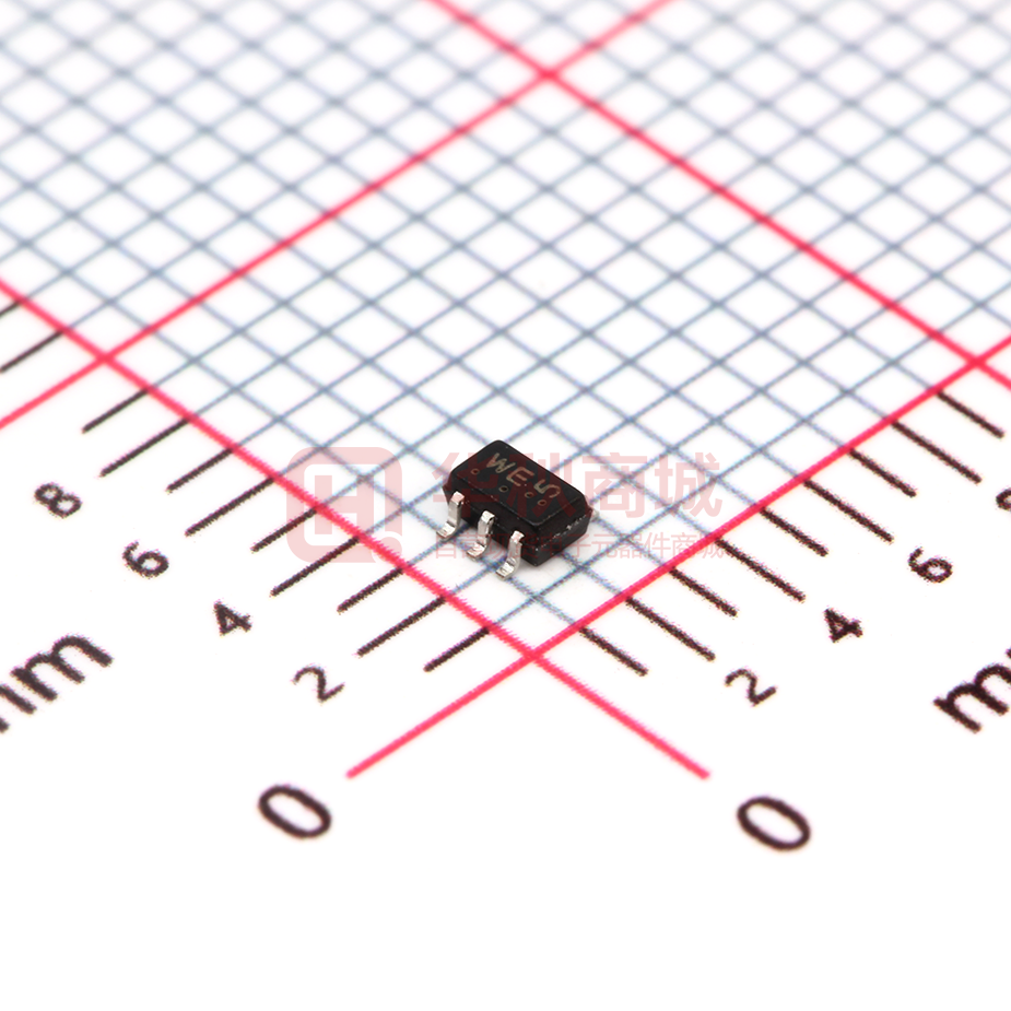

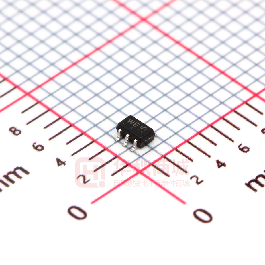

    ESD保护 4通道 VRWM=5 V VBR(Min)=6.1V Ppp=150 W SOT353-5L
ESDA6V1W5 数据手册
ESDA6V1W5 ESD Protection Array RoHS Device Halogen Free Features 4 Unidirectional Transil functions z z Breakdown voltage: z VBR = 6.1 V min. and 25 V min. z Low leakage current: < 1 mA z Very small PCB area < 4.2 mm2 typically High ESD protection level: up to 25 kV z z SOT323-5L/SOT-353 5 4 High integration 1 2 3 Applications Complies with the following standards z Computers z Printers IEC61000-4-2 Level 4 16 kV (air discharge) z Communication systems z z Cellular phones handsets and accessories z Set top boxes 9 kV(contact discharge) MIL STD 883E - Method 3015-7 Class 3 Wireline and wireless telephone sets 25 kV HBM (Human Body Model) Absolute Ratings (T amb=25°C ) Symbol PPP Parameter Peak Pulse Power (tp = 8/20μs) Value Units 150 W TL Maximum lead temperature for soldering during 10s 260 °C Tstg Storage Temperature Range -40 to +125 °C Top Operating Temperature Range -40 to +125 °C 1/4 ESDA6V1W5 ESD Protection Array Electrical Parameter Symbol Parameter VRM Stand-off voltage VBR Breakdown voltage VCL Clamping voltage IRM Leakage current IPP Peak pulse current IR Reverse current IF Forward current αT Voltage temperature coefficient VF Forward voltage drop C Capacitance Rd Dynamic Electrical Characteristics VBR Part Numbers ESDA6V1W5 VF αT C Typ.(1) Max.(2) Typ. 0v bias IR VRM IRM v mA v µA v mA Ω 10-4/°C pF 7.2 1 5 1 1.25 200 0.61 6 90 Min. Max. v 6.1 1.Square pulse IPP=15A,tp=2.5µs 2.VBR=aT*(Tamb-25°C)*VBR(25°C) 2/4 Max. IF Rd ESDA6V1W5 ESD Protection Array Typical Characteristics 100 tr 90 100 10 NOTE: Non−Repetitive Surge. PEAK VALUE IRSM @ 8 ms PULSE WIDTH (tP) IS DEFINED AS THAT POINT WHERE THE PEAK CURRENT DECAY = 8 ms 80 % OF PEAK PULSE CURRENT Ppk , PEAK SURGE POWER (WATTS) 1000 70 60 HALF VALUE IRSM/2@20US 50 40 30 tP 20 10 1 1 10 100 0 1000 t, TIME (ms) 0 90 80 80 TYPICAL CAPACITANCE (pF) 1 MHz FREQUENCY PEAK PULSE DERATING IN % OF PEAK POWER OR CURRENT @ TA = 25 ° C 100 90 70 60 50 40 30 20 10 25 50 75 100 125 150 175 60 50 40 30 20 10 0 200 0 1.0 2.0 3.0 4.0 5.0 BIAS VOLTAGE (VOLTS) Figure 3. Pulse Derating Curve Figure 4. Capacitance 1.0 100 Ipp, PEAK PULSE CURRENT (AMPS) IF , FORWARD CURRENT (A) 80 70 TA, AMBIENT TEMPERATURE (°C) 0.1 0.01 0.001 60 Figure 2. 8 x 20 ms Pulse Waveform 100 0 40 t, TIME (ms) Figure 1. Pulse Width 0 20 0.6 0.7 0.8 0.9 1.0 1.1 1.2 10 2.5 ms SQUARE WAVE 1.0 0 5.0 10 15 20 25 VF, FORWARD VOLTAGE (VOLTS) VC, CLAMPING VOLTAGE (VOLTS) Figure 5. Forward Voltage Figure 6. Clamping Voltage versus Peak Pulse Current (Reverse Direction) 3/4 30 ESDA6V1W5 ESD Protection Array SOT323-5L/SOT−353 NOTES: 1. DIMENSIONING AND TOLERANCING PER ANSI Y14.5M, 1982. 2. CONTROLLING DIMENSION: INCH. 3. 419A−01 OBSOLETE. NEW STANDARD 419A−02. 4. DIMENSIONS A AND B DO NOT INCLUDE MOLD FLASH, PROTRUSIONS, OR GATE BURRS. A G 5 4 DIM A B C D G H J K N S −B− S 1 2 3 D 5 PL 0.2 (0.008) B M M N INCHES MIN MAX 0.071 0.087 0.045 0.053 0.031 0.043 0.004 0.012 0.026 BSC −−− 0.004 0.004 0.010 0.004 0.012 0.008 REF 0.079 0.087 J C K H SOLDERING FOOTPRINT* 0.50 0.0197 0.65 0.025 0.65 0.025 0.40 0.0157 1.9 0.0748 4/4 SCALE 20:1 mm  inches MILLIMETERS MIN MAX 1.80 2.20 1.15 1.35 0.80 1.10 0.10 0.30 0.65 BSC −−− 0.10 0.10 0.25 0.10 0.30 0.20 REF 2.00 2.20
