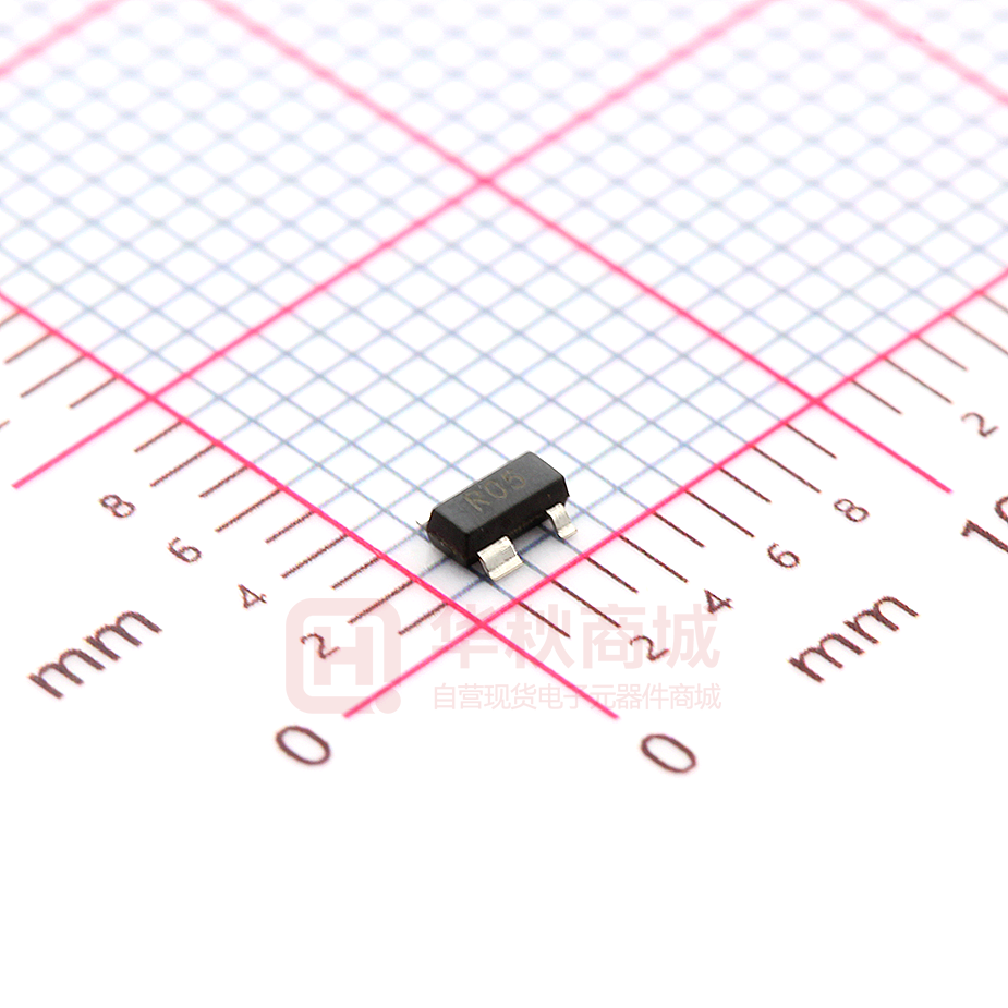

    ESD抑制器/TVS二极管 VRWM=5V VC=8.1V SOT143
CM1213-02SR 数据手册
CM1213-02SR ESD Protectlon Array RoHS Device Halogen Free SOT-143 Features 0.120(3.04) 0.110(2.80) ESD Protected for 2 high speed I/O ports 0.080(2.02) 0.071(1.80) IEC61000-4-2 (ESD) ±8kV (Contact) ,±15kV(Air). 0.038(0.96)BSC IEC61000-4-4 (FET)(5/50ns) Level-3, 20A for I/O 0.055(1.40) 0.047(1.20) 40A for Power. IEC61000-4-5 (Lightning) 6A(8/20uS) Working voltage: 5V 0.0078(0.20)BSC 0.020(0.50) 0.014(0.35) Low capacitance:1.2pF(Typ.). Fast turn-on and Low clamping voltage. 0.043(1.10) 0.035(0.90) Mechanical data Case: SOT-143 standard package, molded plastic. 0.035(0.89) 0.030(0.76) Terminals: Solder plated, solderable per MIL-STD-750,method 2026. 0.004(0.10) 0.002(0.05) 0.007(0.18) 0.004(0.09) 0.100(2.55) 0.089(2.25) Weight: 0.0108 gram(approx.). Circuit Diagram 0.024(0.60) 0.012(0.30) 4 Dimensions in inches and (millimeters) 2 3 1 Pin Configuration VDD I/O 2 4 3 1 2 GND I/O 1 1 CM1213-02SR ESD Protectlon Array Maximum Rating (at TA=25°C unless otherwise noted) Symbol Value Unit Peak pulse current ( tp = 8/20 us) IPP 6 A Operating supply voltage VDC 6 V ESD per IEC 61000-4-2(Air) ESD per IEC 61000-4-2(Contact) VESD 17 12 kV Lead soldering temperature TSOL 260 ( 10 sec) °C Tj -55 to +85 °C TSTG -55 to +150 °C VIO (GND -0.5) to (VDD +0.5) V Parameter Operating temperature Storage temperature DC voltage at any I/O pin Electrical Characteristics (at TA=25°C unless otherwise noted) Parameter Conditions Symbol Min Typ Max Unit Reverse stand-Off voltage Pin 4 to Pin 1 VRWM 5 V Reverse leakage current VRWM = 5 V, T=25°C, Pin 4 to Pin 1 ILeak 2 uA Channel leakage current VPIN 4 = 5 V, VPIN 1 = 0V, T=25°C ICH-Leak 1 uA Diode breakdown voltage IR = 1 mA,, T=25°C, Pin 4 to Pin 1 VBV Forward voltage IF = 15 mA,, T=25°C, Pin 1 to Pin 4 VF 0.8 1 V VCL 8.1 9 V Vhold 13 CIN 1.2 1.4 pF CCROSS 0.1 0.12 pF ∆CIN 0.04 0.06 pF Clamping voltage IPP= 5 A, tp=8/20us, T=25°C, Any Channel Pin to Ground ESD Holding Voltage IEC 61000-4-2 +6kV, T=25°C, Contact mode Any channel pin to ground Channel Input Capacitance Vpin4 = 5V,Vpin1= 0V, VIN=2.5V, f = 1MHz,Any channel pin to ground Channel to Channel Input Capacitance Voltage of Channel Input Capacitance Vpin4 = 5V,Vpin1= 0V, VIN=2.5V f = 1MHz,Between channel pin Vpin4 = 5V,Vpin1= 0V, VIN=2.5V f = 1MHz,Channel_x pin to ground channel_y pin to ground 2 6.2 V V CM1213-02SR ESD Protectlon Array RATING AND CHARACTERISTIC CURVES (CM1213-02SR) Fig. 2 - Clamping voltage vs. Peak pulse current 110 10.0 100 9.5 90 Clamping Voltage, ( V ) % of Rated Power or IPP Fig. 1 - Power derating curve 80 70 60 50 40 30 20 9.0 8.5 8.0 7.5 7.0 6.5 6.0 I/O pin to GND pin 5.5 10 5.0 0 0 25 50 75 100 125 4.5 150 5.0 5.5 2.0 4.5 1.8 4.0 3.5 3.0 2.5 2.0 Waveform Parameters: tr=8 μs td=20 μs 1.0 I/O pin to GND pin 0.5 6.5 7.0 Fig.4 - Typical variation of CIN v.s. VIN 5.0 Input Capacitance, ( pF ) Forward Voltage, ( V ) Fig.3 - Forward voltage v.s. forward current 1.5 6.0 Peak pulse Current, ( A ) Ambient Temperature,TA ( °C ) 1.6 1.4 1.2 1.0 0.8 VDD=5V, GND=0V, f=1MHz, T=25 O C 0.6 0.4 0.2 0.0 0.0 4.5 5.0 5.5 6.0 6.5 0 7.0 1 2 Peak pulse Current, ( A ) Transmission Line Pulsing (TLP) Current, ( A ) 1.4 VDD=5V, GND=0V, V IN 4 5 Fig. 6 - Transmission line pulsing (TLP) measurement 1.5 1.3 3 Input Voltage, ( V ) Fig. 5 - Typical variation of CIN v.s. temperature Input Capacitance, ( pF ) Waveform Parameters: tr=8 μs td=20 μs =2.5V, f=1MHz 1.2 1.1 1.0 0.9 0.8 0.7 18 16 14 V_pulse 12 Pulse from a transmission line 10 TLP_I + 100ns TLP_V 8 DUT - 6 4 I/O to GND 2 0.6 0 0.5 0 20 40 60 80 100 2 4 6 8 10 12 120 Transmission Line Pulsing (TLP) Voltage, ( V ) Temperature, ( °C ) 3 14 CM1213-02SR ESD Protectlon Array Reel Taping Specification d P0 E Index hole P1 T F W B P A C 12 o 0 D2 D1 D W1 Trailer ....... ....... End Device ....... ....... Leader ....... ....... ....... ....... 10 pitches (min) Start 10 pitches (min) Direction of Feed SOT-143 SOT-143 SYMBOL A B C d D D1 D2 (mm) 3.19 ± 0.10 2.80 ± 0.10 1.31 ± 0.10 1.55 ± 0.10 178 ± 1 50.0 MIN. 13.0 ± 0.20 (inch) 0.126 ± 0.004 0.110 ± 0.004 0.052 ± 0.004 0.061 ± 0.004 7.008 ± 0.040 1.969 MIN. 0.512 ± 0.008 SYMBOL E F P P0 P1 W W1 (mm) 1.75 ± 0.10 3.50 ± 0.05 4.00 ± 0.10 4.00 ± 0.10 2.00 ± 0.05 8.00 ± 0.30 14.4 MAX. (inch) 0.069 ± 0.004 0.138 ± 0.002 0.157 ± 0.004 0.157 ± 0.004 0.079 ± 0.002 0.315 ± 0.012 0.567 MAX 4 CM1213-02SR ESD Protectlon Array Suggested PAD Layout SOT-143 SIZE (mm) (inch) A 1.00 0.039 A1 1.40 0.055 A A C D E B 1.40 0.055 C 1.92 0.076 C1 1.72 0.068 C1 B A1 D 2.20 0.087 E 0.80 0.031 F 3.60 0.142 Standard Packaging Qty Per Reel Reel Size (Pcs) (inch) 3,000 7 Case Type SOT-143 5 A F
