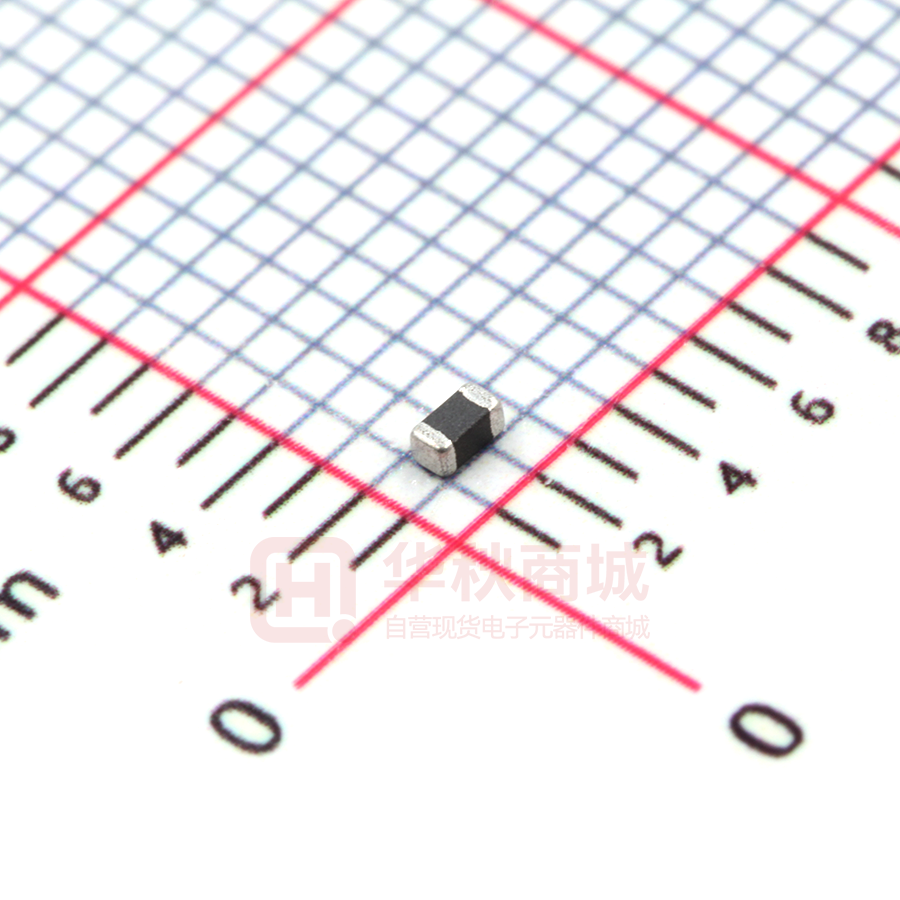

    贴片磁珠 600Ω@100MHz ±25% 500mΩ 350mA 0603
FCM1608KF-601T03 数据手册
TAI-TECH Ferrite Chip Bead(Lead Free) FCM1608-Series 1. Features 1. Monolithic inorganic material construction. Halogen 2. Closed magnetic circuit avoids crosstalk. 3. S.M.T. type. Halogen-free 4. Suitable for reflow soldering. 5. Shapes and dimensions follow E.I.A. spec. 6. Available in various sizes. 7. Excellent solderability and heat resistance. 8. High reliability. 9. 100% Lead(Pb) & Halogen-Free and RoHS compliant. 10. Operating Temperature:-55~+125℃(Including self-temperature rise) 2. Dimensions Chip Size A 1.60±0.15 B 0.80±0.15 C 0.80±0.15 D 0.30±0.20 Units: mm 3. Part Numbering FCM 1608 KF A B C A: Series B: Dimension C: Material D: Impedance E: Packaging F: Rated Current - 600 T 07 D E F LxW Lead Free Material 600=60Ω T=Taping and Reel, B=Bulk(Bags) 07=700mA 4. Specification Impedance (Ω) Test Frequency (MHz) DC Resistance (Ω) max. Rated Current (mA) max. FCM1608KF-300T07 30±25% 100 0.20 700 FCM1608KF-600T07 60±25% 100 0.20 700 FCM1608KF-121T06 120±25% 100 0.25 600 FCM1608KF-151T06 150±25% 100 0.25 600 FCM1608KF-221T05 220±25% 100 0.30 550 FCM1608KF-301T05 300±25% 100 0.35 500 FCM1608KF-471T03 470±25% 100 0.45 350 FCM1608KF-601T03 600±25% 100 0.50 350 Tai-Tech Part Number FCM1608KF-102T02 1000±25% 100 0.70 200 FCM1608HF-152T02 1500±25% 100 1.00 200 FCM1608HF-202T01 2000±25% 100 1.20 150 www.tai-tech.com.tw Downloaded From Oneyac.com TAI-TECH ● ● Tai-Tech Part Number Impedance (Ω) Test Frequency (MHz) DC Resistance (Ω) max. Rated Current (mA) max. FCM1608CF-100T07 10±25% 100 0.20 700 FCM1608CF-300T06 30±25% 100 0.25 600 FCM1608CF-600T06 60±25% 100 0.30 600 FCM1608CF-121T03 120±25% 100 0.40 300 FCM1608CF-151T03 150±25% 100 0.40 300 FCM1608CF-221T02 220±25% 100 0.60 250 FCM1608CF-301T02 300±25% 100 0.80 200 FCM1608CF-471T02 470±25% 100 0.85 200 FCM1608CF-601T01 600±25% 100 1.20 150 FCM1608CF-102T00 1000±25% 100 1.50 80 Rated current: based on temperature rise test In compliance with EIA 595 www.tai-tech.com.tw Downloaded From Oneyac.com TAI-TECH Impedance Frequency Characteristics(Typical) FCM1608KF-300T07 FCM1608KF-600T07 FCM1608KF-121T06 180 400 Z 40 20 IMPEDANCE(Ohm) 60 IMPEDANCE(Ohm) IMPEDANCE(Ohm) 80 120 Z 60 X 300 200 Z 100 X R 0 1 10 100 1000 1 FREQUENCY(MHz) R 0 10 100 1000 1 FREQUENCY(MHz) 300 600 600 100 IMPEDANCE(Ohm) 800 IMPEDANCE(Ohm) 800 Z 100 1000 FCM1608KF-301T05 400 200 10 FREQUENCY(MHz) FCM1608KF-221T05 FCM1608KF-151T06 IMPEDANCE(Ohm) X R 0 400 Z 200 Z 400 200 X X R 0 1 R 0 10 100 1 1000 X 10 R 0 100 1000 1 10 FREQUENCY(MHz) FREQUENCY(MHz) FCM1608KF-471T03 FCM1608KF-601T03 800 1000 100 1000 FREQUENCY(MHz) FCM1608KF-102T02 1200 Z Z 1000 Z 400 600 IMPEDANCE(Ohm) 600 IMPEDANCE(Ohm) 400 200 200 X X 0 1 400 200 10 100 1000 1 10 100 1 1000 FCM1608HF-202T01 IMPEDANCE(Ohm) Z 1000 X 500 100 1000 FCM1608CF-100T07 50 3000 1500 10 FREQUENCY(MHz) FREQUENCY(MHz) FCM1608HF-152T02 X R 0 2500 IMPEDANCE(Ohm) 600 0 FREQUENCY(MHz) 2000 800 R R 40 Z IMPEDANCE(Ohm) IMPEDANCE(Ohm) 800 2000 1500 1000 30 Z 20 X 10 500 R R 0 X 10 100 1000 1 FREQUENCY(MHz) 10 R 0 0 1 100 1 1000 10 FCM1608CF-300T06 1000 FREQUENCY(MHz) FREQUENCY(MHz) FCM1608CF-121T03 FCM1608CF-600T06 150 100 600 400 90 Z 60 X 300 IMPEDANCE(Ohm) IMPEDANCE(Ohm) IMPEDANCE(Ohm) 120 200 Z 100 10 1000 0 1 10 100 1000 1 FREQUENCY(MHz) 1000 200 X 100 IMPEDANCE(Ohm) IMPEDANCE(Ohm) Z 300 600 Z 400 200 0 10 100 FREQUENCY(MHz) R 0 1000 1 10 100 800 Z 600 400 X 200 X R 1000 1200 800 400 100 FCM1608CF-301T02 1000 500 10 FREQUENCY(MHz) FCM1608CF-221T02 FCM1608CF-151T03 600 IMPEDANCE(Ohm) R 0 100 FREQUENCY(MHz) 1 X R R 1 Z 200 X 30 0 400 R 0 1000 FREQUENCY(MHz) www.tai-tech.com.tw Downloaded From Oneyac.com 1 10 100 FREQUENCY(MHz) 1000 TAI-TECH Impedance Frequency Characteristics(Typical) FCM1608CF-471T02 FCM1608CF-601T01 FCM1608CF-102T00 1600 2000 Z 800 400 10 100 FREQUENCY(MHz) Z 800 1200 Z 800 400 X X R 1 1200 400 X 0 IMPEDANCE(Ohm) 1600 1200 IMPEDANCE(Ohm) IMPEDANCE(Ohm) 1600 R 0 1000 R 1 10 100 FREQUENCY(MHz) www.tai-tech.com.tw Downloaded From Oneyac.com 0 1000 1 10 100 FREQUENCY(MHz) 1000
