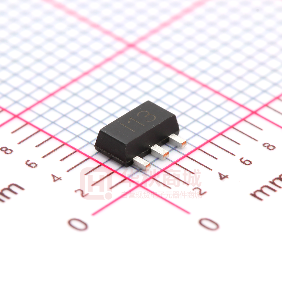

HM3400PR www.VBsemi.tw N-Channel 30-V (D-S) MOSFET FEATURES PRODUCT SUMMARY VDS (V) 30 • Halogen-free ID (A)a RDS(on) (Ω) 0.022 at VGS = 4.5 V Qg (Typ.) • TrenchFET® Power MOSFET RoHS 6.8 0.027 at VGS = 2.5 V 10 nC 6.0 COMPLIANT APPLICATIONS • Load Switches for Portable Devices D D G G S D S N-Channel MOSFET ABSOLUTE MAXIMUM RATINGS TA = 25 °C, unless otherwise noted Parameter Drain-Source Voltage Gate-Source Voltage Continuous Drain Current (TJ = 150 °C) Symbol VDS VGS TC = 25 °C TC = 70 °C TA = 25 °C TA = 70 °C Pulsed Drain Current TC = 25 °C TA = 25 °C TC = 25 °C TC = 70 °C Maximum Power Dissipation TA = 25 °C TA = 70 °C Operating Junction and Storage Temperature Range Continuous Source-Drain Diode Current Soldering Recommendations (Peak Temperature)e, f ID IDM IS PD TJ, Tstg Limit 30 ± 20 6.8a 6a 6.8 a, b , c 6 a, b, c 30 5.2 2.1b, c 6.3 4 2.5b, c 1.6b, c - 55 to 150 260 Unit V A W °C THERMAL RESISTANCE RATINGS Parameter Symbol Maximum Unit Typical t≤5s RthJA 40 50 Maximum Junction-to-Ambienta, c, d °C/W RthJF 15 20 Steady State Maximum Junction-to-Foot (Drain) Notes: a. Package limited, TC = 25 °C. b. Surface Mounted on 1" x 1" FR4 board. c. t = 10 s. d. Maximum under Steady State conditions is 95 °C/W. e. See Reliability Manual for profile. The ChipFET is a leadless package. The end of the lead terminal is exposed copper (not plated) as a result of the singulation process in manufacturing. A solder fillet at the exposed copper tip cannot be guaranteed and is not required to ensure adequate bottom side solder interconnection. f. Rework Conditions: manual soldering with a soldering iron is not recommended for leadless components. E-mail:China@VBsemi TEL:86-755-83251052 1 HM3400PR www.VBsemi.tw SPECIFICATIONS TJ = 25 °C, unless otherwise noted Parameter Symbol Test Conditions Min. VDS VGS = 0 V, ID = 250 µA 30 Typ. Max. Unit Static Drain-Source Breakdown Voltage ΔVDS /TJ VDS Temperature Coefficient VGS(th) Temperature Coefficient ΔVGS(th)/TJ Gate-Source Threshold Voltage ID = 250 µA VGS(th) VDS = VGS , ID = 250 µA Gate-Source Leakage IGSS VDS = 0 V, VGS = ± 20 V Zero Gate Voltage Drain Current IDSS On-State Drain Currenta ID(on) Drain-Source On-State Resistancea Forward Transconductancea RDS(on) gfs V 25 mV/°C - 4.0 0.6 1.5 V ± 100 nA VDS = 30 V, VGS = 0 V 1 VDS = 30 V, VGS = 0 V, TJ = 55 °C 10 VDS ≥ 5 V, VGS = 4.5 V µA A 30 VGS = 4.5 V, ID = 6.3 A 0.022 0.033 VGS = 2.5 V, ID = 4.5 A 0.030 0.045 VDS = 10 V, ID = 6.3 A 45 Ω S b Dynamic Input Capacitance Ciss Output Capacitance Coss Reverse Transfer Capacitance Crss Total Gate Charge Qg Gate-Source Charge Qgs Gate-Drain Charge Qgd Gate Resistance Turn-on Delay Time Rise Time Turn-Off Delay Time Fall Time Turn-on Delay Time Rise Time Turn-Off Delay Time Fall Time Rg 1200 VDS = 10 V, VGS = 0 V, f = 1 MHz VDS = 10 V, VGS = 10 V, ID = 6.3 A VDS = 10 V, VGS = 4.5 V, ID = 6.3 A td(off) 22 33 10 15 2.5 f = 1 MHz VDD = 10 V, RL = 1.5 Ω ID ≅ 6.7 A, VGEN = 4.5 V, Rg = 1 Ω Ω 2.4 15 25 10 15 35 55 tf 12 20 td(on) 10 15 tr td(off) nC 1.7 td(on) tr pF 220 100 VDD = 10 V, RL = 1.5 Ω ID ≅ 6.7 A, VGEN = 10 V, Rg = 1 Ω tf 12 20 25 40 10 15 ns Drain-Source Body Diode Characteristics Continuous Source-Drain Diode Current IS Pulse Diode Forward Current ISM Body Diode Voltage VSD Body Diode Reverse Recovery Time trr Body Diode Reverse Recovery Charge Qrr Reverse Recovery Fall Time ta Reverse Recovery Rise Time tb TC = 25 °C 5.2 30 IS = 6.7 A, VGS = 0 V IF = 6.7 A, dI/dt = 100 A/µs, TJ = 25 °C A 0.8 1.2 V 20 40 ns 10 20 nC 10 10 ns Notes: a. Pulse test; pulse width ≤ 300 µs, duty cycle ≤ 2 % b. Guaranteed by design, not subject to production testing. Stresses beyond those listed under “Absolute Maximum Ratings” may cause permanent damage to the device. These are stress ratings only, and functional operation of the device at these or any other conditions beyond those indicated in the operational sections of the specifications is not implied. Exposure to absolute maximum rating conditions for extended periods may affect device reliability. E-mail:China@VBsemi TEL:86-755-83251052 2 HM3400PR www.VBsemi.tw TYPICAL CHARACTERISTICS 25 °C, unless otherwise noted 10 30 VGS = 5 thru 3 V TC = - 55 °C 8 I D - Drain Current (A) I D - Drain Current (A) 24 18 VGS = 2.5V 12 6 TC = 125 °C 4 2 6 TC = 25 °C VGS = 1 V 0 0.0 0.5 1.0 1.5 VGS = 1.5 V 2.0 2.5 0 0.0 3.0 0.5 1.0 1.5 2.0 VGS - Gate-to-Source Voltage (V) VDS - Drain-to-Source Voltage (V) Output Characteristics Transfer Characteristics 1500 0.032 0.030 Ciss 0.028 C - Capacitance (pF) RDS(on) - On-Resistance (Ω) 1200 0.026 VGS = 2.5 V 0.024 0.022 VGS = 4.5 V 0.020 900 600 Coss 300 0.018 Crss 0 0.016 0 6 12 18 24 0 30 5 15 20 VDS - Drain-to-Source Voltage (V) ID - Drain Current (A) On-Resistance vs. Drain Current Capacitance 10 1.6 ID = 6 6.3 A ID = 6 6.3 A 8 VGS = 4.5 V, 2.5 V VDS = 10 V 6 VDS = 16 V 4 2 (Normalized) 1.4 R DS(on) - On-Resistance VGS - Gate-to-Source Voltage (V) 10 1.2 1.0 0.8 0 0 5 10 15 Qg - Total Gate Charge (nC) Gate Charge E-mail:China@VBsemi TEL:86-755-83251052 20 25 0.6 - 50 - 25 0 25 50 75 100 125 150 TJ - Junction Temperature (°C) On-Resistance vs. Junction Temperature 3 HM3400PR www.VBsemi.tw TYPICAL CHARACTERISTICS 25 °C, unless otherwise noted 0.050 100 ID = 6.3 A TJ = 150 °C R DS(on) - On-Resistance (Ω) I S - Source Current (A) 0.040 TJ = 25 °C 10 1 0.0 0.030 TJ = 125 °C 0.020 TJ = 25 °C 0.010 0.000 0.2 0.4 0.6 0.8 1.0 1.2 0 1 VSD - Source-to-Drain Voltage (V) 4 5 On-Resistance vs. Gate-to-Source Voltage 1.4 50 40 ID = 250 µA Power (W) 1.2 V GS(th) (V) 3 VGS - Gate-to-Source Voltage (V) Source-Drain Diode Forward Voltage 1.0 0.8 30 20 10 0.6 0.4 - 50 2 - 25 0 25 50 75 100 125 0 0.001 150 0.01 0.1 1 10 100 600 Time (s) TJ - Temperature (°C) Single Pulse Power Threshold Voltage 100 Limited by RDS(on)* 100 µs ID - Drain Current (A) 10 1 ms 1 10 ms 0.1 TA = 25 °C Single Pulse 0.01 0.1 BVDSS Limited 100 ms 1s 10 s DC 1 10 100 VDS - Drain-to-Source Voltage (V) * VGS > minimum VGS at which RDS(on) is specified Safe Operating Area, Junction-to-Ambient E-mail:China@VBsemi TEL:86-755-83251052 4 HM3400PR www.VBsemi.tw TYPICAL CHARACTERISTICS 25 °C, unless otherwise noted 18 8 15 Power (W) ID - Drain Current (A) 6 12 9 Package Limited 4 6 2 3 0 0 0 25 50 75 100 TC - Case Temperature (°C) Current Derating* 125 150 25 50 75 100 125 150 TC - Case Temperature (°C) Power Derating * The power dissipation PD is based on TJ(max) = 150 °C, using junction-to-case thermal resistance, and is more useful in settling the upper dissipation limit for cases where additional heatsinking is used. It is used to determine the current rating, when this rating falls below the package limit. E-mail:China@VBsemi TEL:86-755-83251052 5 HM3400PR www.VBsemi.tw TYPICAL CHARACTERISTICS 25 °C, unless otherwise noted 2 1 Duty Cycle = 0.5 ffecti 0.2 Notes: 0.1 PDM 0.1 0.05 t1 t2 1. Duty Cycle, D = t1 t2 2. Per Unit Base = RthJA = 80 °C/W 0.02 3. TJM - TA = PDMZthJA(t) Single Pulse 4. Surface Mounted 0.01 10-4 10-3 10-2 10-1 1 Square Wave Pulse Duration (s) 10 100 600 Normalized Thermal Transient Impedance, Junction-to-Ambient 2 Normalized Effective Transient Thermal Impedance 1 Duty Cycle = 0.5 0.2 0.1 0.1 0.05 0.02 Single Pulse 0.01 10-4 10-3 10-2 10-1 Square Wave Pulse Duration (s) 1 10 Normalized Thermal Transient Impedance, Junction-to-Foot E-mail:China@VBsemi TEL:86-755-83251052 6 HM3400PR www.VBsemi.tw Package outline - SOT89 D A C D1 E H E1 L B e B1 DIM e1 Millimeters Inches Min Max Min Max A 1.40 1.60 0.550 0.630 B 0.44 0.56 0.017 B1 0.36 0.48 C 0.35 D D1 DIM Millimeters Inches Min Max Min Max E 2.29 2.60 0.090 0.102 0.022 E1 2.13 2.29 0.084 0.090 0.014 0.019 e 1.50 BSC 0.059 BSC 0.44 0.014 0.017 e1 3.00 BSC 0.118 BSC 4.40 4.60 0.173 0.181 H 3.94 4.25 0.155 0.167 1.62 1.83 0.064 0.072 L 0.89 1.20 0.035 0.047 Note: Controlling dimensions are in millimeters. Approximate dimensions are provided in inches E-mail:China@VBsemi TEL:86-755-83251052 7 HM3400PR www.VBsemi.tw Disclaimer All products due to improve reliability, function or design or for other reasons, product specifications and data are subject to change without notice. Taiwan VBsemi Electronics Co., Ltd., branches, agents, employees, and all persons acting on its or their representatives ( collectively, the "Taiwan VBsemi"), assumes no responsibility for any errors, inaccuracies or incomplete data contained in the table or any other any disclosure of any information related to the product.(www.VBsemi.tw) Taiwan VBsemi makes no guarantee, representation or warranty on the product for any particular purpose of any goods or continuous production. To the maximum extent permitted by applicable law on Taiwan VBsemi relinquished: ( 1) any application and all liability arising out of or use of any products; ( 2) any and all liability, including but not limited to special, consequential damages or incidental ; ( 3) any and all implied warranties, including a particular purpose, non-infringement and merchantability guarantee. Statement on certain types of applications are based on knowledge of the product is often used in a typical application of the general product VBsemi Taiwan demand that the Taiwan VBsemi of. Statement on whether the product is suitable for a particular application is non-binding. It is the customer's responsibility to verify specific product features in the products described in the specification is appropriate for use in a particular application. Parameter data sheets and technical specifications can be provided may vary depending on the application and performance over time. All operating parameters, including typical parameters must be made by customer's technical experts validated for each customer application. Product specifications do not expand or modify Taiwan VBsemi purchasing terms and conditions, including but not limited to warranty herein. Unless expressly stated in writing, Taiwan VBsemi products are not intended for use in medical, life saving, or life sustaining applications or any other application. Wherein VBsemi product failure could lead to personal injury or death, use or sale of products used in Taiwan VBsemi such applications using client did not express their own risk. Contact your authorized Taiwan VBsemi people who are related to product design applications and other terms and conditions in writing. The information provided in this document and the company's products without a license, express or implied, by estoppel or otherwise, to any intellectual property rights granted to the VBsemi act or document. Product names and trademarks referred to herein are trademarks of their respective representatives will be all. Material Category Policy Taiwan VBsemi Electronics Co., Ltd., hereby certify that all of the products are determined to be R oHS compliant and meets the definition of restrictions under Directive of the European Parliament 2011/65 / EU, 2011 Nian. 6. 8 R i Yue restrict the use of certain hazardous substances in electrical and electronic equipment (EEE) - modification, unless otherwise specified as inconsistent.(www.VBsemi.tw) Please note that some documents may still refer to Taiwan VBsemi RoHS Directive 2002/95 / EC. We confirm that all products identified as consistent with the Directive 2002/95 / EC European Directive 2011/65 /. Taiwan VBsemi Electronics Co., Ltd. hereby certify that all of its products comply identified as halogen-free halogen-free standards required by the JEDEC JS709A. Please note that some Taiwanese VBsemi documents still refer to the definition of IEC 61249-2-21, and we are sure that all products conform to confirm compliance with IEC 61249-2-21 standard level JS709A. E-mail:China@VBsemi TEL:86-755-83251052 8
