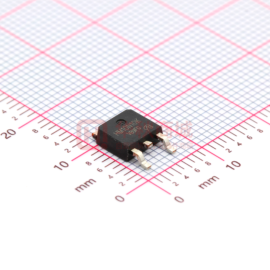

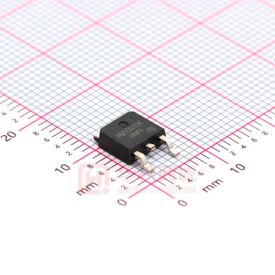

    MOS管 N-Channel VDS=100V VGS=±20V ID=15A RDS(ON)=120mΩ@4.5V TO252AA
HM10N10K 数据手册
HM10N10K www.VBsemi.tw N-Channel 100 V (D-S) MOSFET FEATURES PRODUCT SUMMARY VDS (V) RDS(on) () ID (A) 100 0.114 at VGS = 10 V 15 • • • • • TrenchFET® Power MOSFET 175 °C Junction Temperature PWM Optimized 100 % Rg Tested Compliant to RoHS Directive 2002/95/EC APPLICATIONS • Primary Side Switch D TO-252 G S G D S N-Channel MOSFET ABSOLUTE MAXIMUM RATINGS (TA = 25 °C, unless otherwise noted) Symbol Limit Drain-Source Voltage Parameter VDS 100 Gate-Source Voltage VGS ± 20 Continuous Drain Current (TJ = 175 °C)b TC = 25 °C TC = 125 °C Pulsed Drain Current Continuous Source Current (Diode Conduction) Avalanche Current Single Pulse Avalanche Energy Maximum Power Dissipation L = 0.1 mH TC = 25 °C TA = 25 °C V 15 ID 13 IDM 40 IS 3 A IAS 3 EAS 18 mJ 96b W PD 3a TJ, Tstg Operating Junction and Storage Temperature Range Unit - 55 to 175 °C THERMAL RESISTANCE RATINGS Parameter Junction-to-Ambienta Junction-to-Case (Drain) Symbol t  10 s Steady State RthJA RthJC Typical Maximum 15 18 40 50 0.85 1.1 Unit °C/W Notes: a. Surface mounted on 1" x 1" FR4 board. b. See SOA curve for voltage derating. E-mail:China@VBsemi TEL:86-755-83251052 1 HM10N10K www.VBsemi.tw SPECIFICATIONS (TJ = 25 °C, unless otherwise noted) Parameter Symbol Test Conditions Min. VDS VGS = 0 V, ID = 250 µA 100 VGS(th) VDS = VGS, ID = 250 µA 1.0 IGSS VDS = 0 V, VGS = ± 20 V Typ.a Max. Unit Static Drain-Source Breakdown Voltage Gate Threshold Voltage Gate-Body Leakage Zero Gate Voltage Drain Current On-State Drain Currentb Drain-Source On-State Resistanceb IDSS ± 100 VDS = 100 V, VGS = 0 V 1 VDS = 100 V, VGS = 0 V, TJ = 125 °C 50 VDS = 100 V, VGS = 0 V, TJ = 175 °C 250 ID(on) VDS =5 V, VGS = 10 V RDS(on) 40 Forward 0.114 VGS = 10 V, ID = 3 A, TJ = 125 °C 0.120 VGS = 10 V, ID = 3 A, TJ = 175 °C 0.140 µA  0.120 VDS = 15 V, ID = 3 A gfs nA A VGS = 10 V, ID = 3 A VGS = 4.5 V ID = 3 A Transconductanceb V 2.5 35 S Dynamica Input Capacitance Ciss Output Capacitance Coss Reverse Transfer Capacitance Crss Total Gate Chargec Qg Gate-Source Chargec Qgs c Gate-Drain Charge Qgd Gate Resistance Rg Timec td(on) Turn-Off Delay Timec td(off) Turn-On Delay Rise Timec 950 VGS = 0 V, VDS = 25 V, F = 1 MHz pF 60 24 VDS = 50 V, VGS = 10 V, ID = 3 A tr Fall Timec 120 41 nC 8 12 0.5 VDD = 50 V, RL = 5.2 Ω ID ≅ 3 A, VGEN = 10 V, Rg = 2.5 Ω tf 2.9 15 25 50 75 30 45 60 90  ns Source-Drain Diode Ratings and Characteristics (TC = 25 °C) Diode Forward Voltage 5 ISM Pulsed Current b Source-Drain Reverse Recovery Time A VSD IF = 3 A, VGS = 0 V 0.9 1.5 V trr IF = 3 A, dI/dt = 100 A/µs 180 250 ns Notes: a. Guaranteed by design, not subject to production testing. b. Pulse test; pulse width  300 µs, duty cycle  2 %. c. Independent of operating temperature. Stresses beyond those listed under “Absolute Maximum Ratings” may cause permanent damage to the device. These are stress ratings only, and functional operation of the device at these or any other conditions beyond those indicated in the operational sections of the specifications is not implied. Exposure to absolute maximum rating conditions for extended periods may affect device reliability. E-mail:China@VBsemi TEL:86-755-83251052 2 HM10N10K www.VBsemi.tw TYPICAL CHARACTERISTICS (25 °C, unless otherwise noted) 40 8 VGS = 10 V thru 5 V 4V 6 I D - Drain Current (A) I D - Drain Current (A) 30 20 3V 10 4 TC = 125 °C 2 25 °C - 55 °C 2V 0 0 0 2 4 6 8 0 10 2 3 4 5 VDS - Drain-to-Source Voltage (V) VGS - Gate-to-Source Voltage (V) Output Characteristics Transfer Characteristics 70 6 0.4 R DS(on) - On-Resistance () TC = - 55 °C 60 g fs - Transconductance (S) 1 50 25 °C 40 125 °C 30 20 0.3 0.2 VGS = 5 V VGS = 10 V 0.1 10 0.0 0 0 10 20 30 0 40 20 30 40 ID - Drain Current (A) ID - Drain Current (A) Transconductance On-Resistance vs. Drain Current 1500 VGS - Gate-to-Source Voltage (V) 20 1200 C - Capacitance (pF) 10 Ciss 900 600 300 Crss VDS = 100 V ID = 19 A 16 12 8 4 Coss 0 0 0 20 40 60 80 VDS - Drain-to-Source Voltage (V) Capacitance E-mail:China@VBsemi TEL:86-755-83251052 100 0 10 20 30 40 50 60 Qg - Total Gate Charge (nC) Gate Charge 3 HM10N10K www.VBsemi.tw TYPICAL CHARACTERISTICS (25 °C, unless otherwise noted) 0.3 100 VGS = 10 V ID = 5 A I S - Source Current (A) (Normalized) R DS(on) - On-Resistance 0.25 0.2 0.15 0.1 TJ = 150 °C 10 TJ = 25 °C 0.05 0.0 - 50 - 25 0 25 50 75 100 125 150 1 175 0 0.3 0.6 0.9 1.2 VSD - Source-to-Drain Voltage (V) TJ - Junction Temperature ( °C) On-Resistance vs. Junction Temperature Source-Drain Diode Forward Voltage THERMAL RATINGS 10 7 100 µs ID - Drain Current (A) I D - Drain Current (A) 10 µs Limited by R DS(on)* 6 5 4 5 1 ms 10 ms 1 100 ms 1 s, DC TC = 25 °C Single Pulse 3 0 0 25 50 75 100 125 TC - Case Temperature (°C) 150 175 0.1 0.1 Maximum Avalanche Drain Current vs. Case Temperature 1 10 1000 100 VDS - Drain-to-Source Voltage (V) * VGS > minimum VGS at which RDS(on) is specified Safe Operating Area 2 1 Normalized Effective Transient Thermal Impedance Duty Cycle = 0.5 0.2 0.1 0.1 0.05 0.02 Single Pulse 0.01 10- 4 10- 3 10- 2 10- 1 Square Wave Pulse Duration (s) 1 10 30 Normalized Thermal Transient Impedance, Junction-to-Case E-mail:China@VBsemi TEL:86-755-83251052 4 HM10N10K www.VBsemi.tw TO-252AA CASE OUTLINE E MILLIMETERS A C2 e b2 D1 e1 E1 L gage plane height (0.5 mm) L4 b L5 H D L3 b3 C A1 DIM. MIN. INCHES MAX. MIN. MAX. A 2.18 2.38 0.086 0.094 A1 - 0.127 - 0.005 b 0.64 0.88 0.025 0.035 b2 0.76 1.14 0.030 0.045 b3 4.95 5.46 0.195 0.215 C 0.46 0.61 0.018 0.024 C2 0.46 0.89 0.018 0.035 D 5.97 6.22 0.235 0.245 D1 5.21 - 0.205 0.265 E 6.35 6.73 0.250 E1 4.32 - 0.170 - H 9.40 10.41 0.370 0.410 e 2.28 BSC 0.090 BSC e1 4.56 BSC 0.180 BSC L 1.40 1.78 0.055 0.070 L3 0.89 1.27 0.035 0.050 L4 - 1.02 - 0.040 L5 1.14 1.52 0.045 0.060 ECN: X12-0247-Rev. M, 24-Dec-12 DWG: 5347 Note • Dimension L3 is for reference only. E-mail:China@VBsemi TEL:86-755-83251052 5 HM10N10K www.VBsemi.tw RECOMMENDED MINIMUM PADS FOR DPAK (TO-252) 0.224 (6.180) 0.087 (2.202) 0.090 (2.286) 0.420 (10.668) 0.243 (5.690) 0.180 0.055 (4.572) (1.397) Recommended Minimum Pads Dimensions in Inches/(mm) E-mail:China@VBsemi TEL:86-755-83251052 6 HM10N10K www.VBsemi.tw Disclaimer All products due to improve reliability, function or design or for other reasons, product specifications and data are subject to change without notice. Taiwan VBsemi Electronics Co., Ltd., branches, agents, employees, and all persons acting on its or their representatives ( collectively, the "Taiwan VBsemi"), assumes no responsibility for any errors, inaccuracies or incomplete data contained in the table or any other any disclosure of any information related to the product.(www.VBsemi.tw) Taiwan VBsemi makes no guarantee, representation or warranty on the product for any particular purpose of any goods or continuous production. To the maximum extent permitted by applicable law on Taiwan VBsemi relinquished: ( 1) any application and all liability arising out of or use of any products; ( 2) any and all liability, including but not limited to special, consequential damages or incidental ; ( 3) any and all implied warranties, including a particular purpose, non-infringement and merchantability guarantee. Statement on certain types of applications are based on knowledge of the product is often used in a typical application of the general product VBsemi Taiwan demand that the Taiwan VBsemi of. Statement on whether the product is suitable for a particular application is non-binding. It is the customer's responsibility to verify specific product features in the products described in the specification is appropriate for use in a particular application. Parameter data sheets and technical specifications can be provided may vary depending on the application and performance over time. All operating parameters, including typical parameters must be made by customer's technical experts validated for each customer application. Product specifications do not expand or modify Taiwan VBsemi purchasing terms and conditions, including but not limited to warranty herein. Unless expressly stated in writing, Taiwan VBsemi products are not intended for use in medical, life saving, or life sustaining applications or any other application. Wherein VBsemi product failure could lead to personal injury or death, use or sale of products used in Taiwan VBsemi such applications using client did not express their own risk. Contact your authorized Taiwan VBsemi people who are related to product design applications and other terms and conditions in writing. The information provided in this document and the company's products without a license, express or implied, by estoppel or otherwise, to any intellectual property rights granted to the VBsemi act or document. Product names and trademarks referred to herein are trademarks of their respective representatives will be all. Material Category Policy Taiwan VBsemi Electronics Co., Ltd., hereby certify that all of the products are determined to be R oHS compliant and meets the definition of restrictions under Directive of the European Parliament 2011/65 / EU, 2011 Nian. 6. 8 R i Yue restrict the use of certain hazardous substances in electrical and electronic equipment (EEE) - modification, unless otherwise specified as inconsistent.(www.VBsemi.tw) Please note that some documents may still refer to Taiwan VBsemi RoHS Directive 2002/95 / EC. We confirm that all products identified as consistent with the Directive 2002/95 / EC European Directive 2011/65 /. Taiwan VBsemi Electronics Co., Ltd. hereby certify that all of its products comply identified as halogen-free halogen-free standards required by the JEDEC JS709A. Please note that some Taiwanese VBsemi documents still refer to the definition of IEC 61249-2-21, and we are sure that all products conform to confirm compliance with IEC 61249-2-21 standard level JS709A. E-mail:China@VBsemi TEL:86-755-83251052 7
