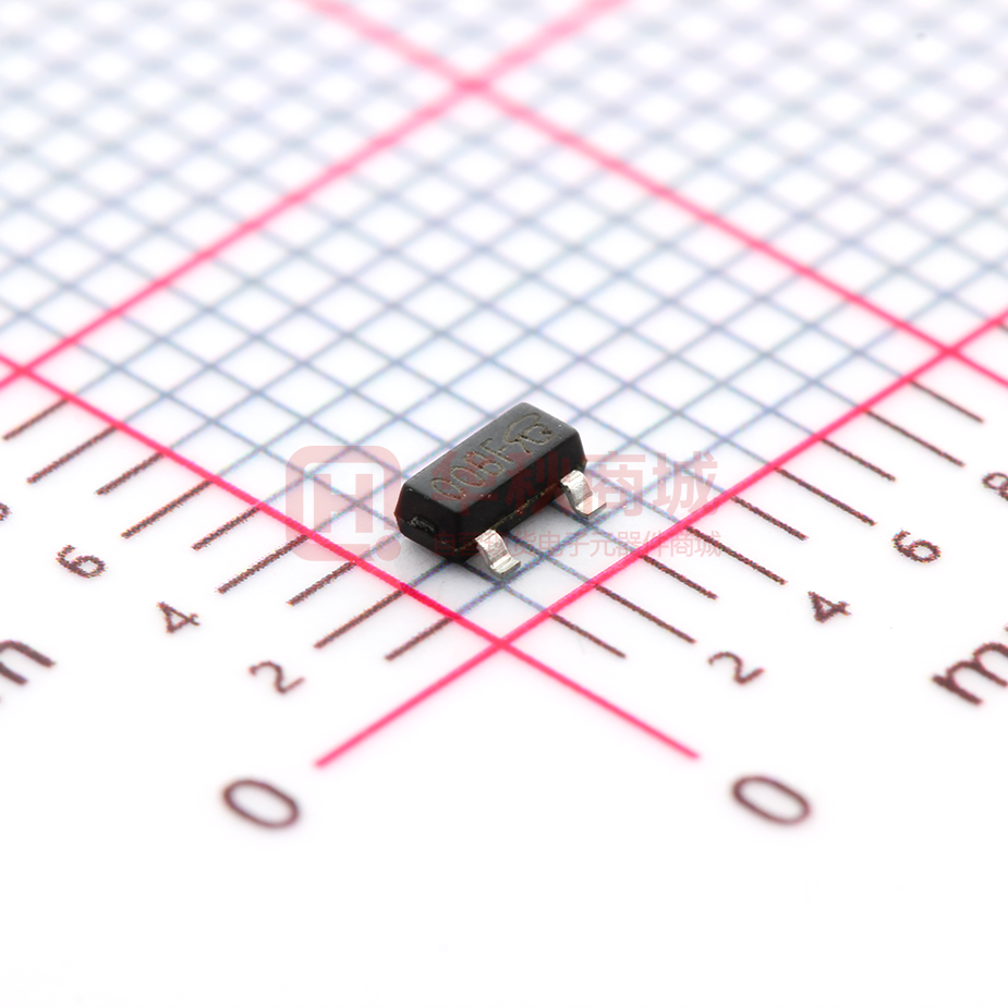

    MOS管 N-Channel VDS=20V VGS=±12V ID=5A RDS(ON)=28mΩ@4.5V SOT23
CJ2312 数据手册
CJ2312 www.VBsemi.tw N-Channel 20 V (D-S) MOSFET FEATURES PRODUCT SUMMARY VDS (V) 20 ID (A)e RDS(on) (Ω) 0.028 at VGS = 4.5 V 6a 0.042 at VGS = 2.5 V 6a 0.050 at VGS = 1.8 V 5.6 • Halogen-free According to IEC 61249-2-21 Definition • TrenchFET® Power MOSFET • 100 % Rg Tested • Compliant to RoHS Directive 2002/95/EC Qg (Typ.) 8.8 nC APPLICATIONS • DC/DC Converters • Load Switch for Portable Applications SOT-23 G 1 3 S D 2 Top View ABSOLUTE MAXIMUM RATINGS TA = 25 °C, unless otherwise noted Parameter Drain-Source Voltage Gate-Source Voltage Symbol VDS VGS TC = 25 °C TC = 70 °C TA = 25 °C Continuous Drain Current (TJ = 150 °C) Limit 20 ± 12 ID 5b, c 4b, c 20 1.75 IDM TC = 25 °C TA = 25 °C TC = 25 °C TC = 70 °C TA = 25 °C Continuous Source-Drain Diode Current Maximum Power Dissipation TA = 70 °C Operating Junction and Storage Temperature Range V 6a 5.1 TA = 70 °C Pulsed Drain Current Unit IS A 1.04b, c 2.1 1.3 PD W 1.25b, c 0.8b, c - 55 to 150 260 TJ, Tstg Soldering Recommendations (Peak Temperature) °C THERMAL RESISTANCE RATINGS Parameter Maximum Junction-to-Ambientb, d Maximum Junction-to-Foot (Drain) t≤5s Symbol RthJA Typical 80 Maximum 100 Steady State RthJF 40 60 Unit °C/W Notes: a. Package limited b. Surface Mounted on 1" x 1" FR4 board. c. t = 5 s. d. Maximum under steady state conditions is 125 °C/W. e. Based on TC = 25 °C. E-mail:China@VBsemi TEL:86-755-83251052 1 CJ2312 www.VBsemi.tw SPECIFICATIONS TJ = 25 °C, unless otherwise noted Parameter Symbol Test Conditions Min. VDS VGS = 0 V, ID = 250 µA 20 Typ. Max. Unit Static Drain-Source Breakdown Voltage VDS Temperature Coefficient ΔVDS/TJ V 25 ID = 250 µA mV/°C VGS(th) Temperature Coefficient ΔVGS(th)/TJ Gate-Source Threshold Voltage VGS(th) VDS = VGS , ID = 250 µA 1.0 V IGSS VDS = 0 V, VGS = ± 8 V ± 100 nA VDS = 20 V, VGS = 0 V 1 VDS = 20 V, VGS = 0 V, TJ = 70 °C 10 Gate-Source Leakage Zero Gate Voltage Drain Current IDSS On-State Drain Currenta ID(on) Drain-Source On-State Resistancea Forward Transconductancea RDS(on) gfs VDS ≤ 5 V, VGS = 4.5 V - 2.6 0.45 µA A 20 VGS = 4.5 V, ID = 5.0 A 0.028 VGS = 2.5 V, ID = 4.7 A 0.042 VGS = 1.8 V, ID = 4.3 A 0.050 VDS = 10 V, ID = 5.0 A 24 Ω S b Dynamic Input Capacitance Ciss Output Capacitance Coss Reverse Transfer Capacitance Crss Total Gate Charge Qg Gate-Source Charge Qgs Gate-Drain Charge Qgd Gate Resistance Rg Turn-On Delay Time Rise Time Turn-Off Delay Time Fall Time Turn-On Delay Time Rise Time Turn-Off Delay Time Fall Time 865 VDS = 10 V, VGS = 0 V, f = 1 MHz td(off) pF 55 VDS = 10 V, VGS = 5 V, ID = 5.0 A 12 18 8.8 14 1.1 VDS = 10 V, VGS = 4.5 V, ID = 5.0 A VDD = 10 V, RL = 2.2 Ω ID ≅ 4 A, VGEN = 4.5 V, Rg = 1 Ω 0.5 2.4 4.8 8 16 17 26 31 47 tf 8 16 td(on) 5 10 13 20 21 32 6 12 tr td(off) nC 0.7 f = 1 MHz td(on) tr 105 VDD = 10 V, RL = 2.2 Ω ID ≅ 4 A, VGEN = 5 V, Rg = 1 Ω tf Ω ns Drain-Source Body Diode Characteristics Continuous Source-Drain Diode Current IS Pulse Diode Forward Current ISM Body Diode Voltage VSD TC = 25 °C 1.75 20 IS = 4 A, VGS = 0 V A 0.75 1.2 Body Diode Reverse Recovery Time trr 12 20 ns Body Diode Reverse Recovery Charge Qrr 5 10 nC Reverse Recovery Fall Time ta Reverse Recovery Rise Time tb IF = 4 A, dI/dt = 100 A/µs, TJ = 25 °C 7 5 V ns Notes: a. Pulse test; pulse width ≤ 300 µs, duty cycle ≤ 2 % b. Guaranteed by design, not subject to production testing. Stresses beyond those listed under “Absolute Maximum Ratings” may cause permanent damage to the device. These are stress ratings only, and functional operation of the device at these or any other conditions beyond those indicated in the operational sections of the specifications is not implied. Exposure to absolute maximum rating conditions for extended periods may affect device reliability. E-mail:China@VBsemi TEL:86-755-83251052 2 CJ2312 www.VBsemi.tw TYPICAL CHARACTERISTICS 25 °C, unless otherwise noted 5 20 V GS = 1 0 V t h r u 3 V 4 V GS = 2 . 5 V I D - Drain Current (A) I D - Drain Current (A) 15 10 3 2 T C = 25 °C 5 1 T C = 125 °C V GS = 1 V 0 0.0 0.5 1.0 1.5 T C = - 55 °C 0 0.0 2.0 0.3 V DS - Drain-to-Source Voltage (V) 1.2 1.5 Transfer Characteristics Output Characteristics 1200 0.045 V GS = 1.8 V 0.040 Ciss 900 0.035 C - Capacitance (pF) R DS(on) - On-Resistance (Ω) 0.9 0.6 V GS - Gate-to-Source Voltage (V) V GS = 2.5 V 0.030 V GS = 4.5 V 600 300 0.025 Coss Crss 0 0.020 0 5 10 15 0 20 5 10 15 ID - Drain Current (A) V DS - Drain-to-Source Voltage (V) On-Resistance vs. Drain Current and Gate Voltage Capacitance 20 1.70 5 4 V DS = 10 V 3 V DS = 5 V 2 V DS = 16 V V GS = 2.5 V, I D = 4.7 A 1.45 (Normalized) R DS(on) - On-Resistance VGS - Gate-to-Source Voltage (V) ID = 5 A 1.20 V GS = 4.5 V, I D = 5 A 0.95 1 0 0 2 4 6 Qg - Total Gate Charge (nC) Gate Charge E-mail:China@VBsemi TEL:86-755-83251052 8 10 0.70 - 50 - 25 0 25 50 75 100 125 150 T J - Junction Temperature (°C) On-Resistance vs. Junction Temperature 3 CJ2312 www.VBsemi.tw TYPICAL CHARACTERISTICS 25 °C, unless otherwise noted 100 0.06 R DS(on) - On-Resistance (Ω) I S - Source Current (A) ID = 5 A T J = 150 °C 10 T J = 25 °C 1 0.05 0.04 T J = 125 °C 0.03 T J = 25 °C 0.02 0.1 0.0 0.3 0.6 0.9 1.2 0 2 4 6 8 V GS - Gate-to-Source Voltage (V) V SD - Source-to-Drain Voltage (V) On-Resistance vs. Gate-to-Source Voltage Source-Drain Diode Forward Voltage 32 0.9 0.7 24 Power (W) VGS(th) (V) ID = 250 μA 0.5 0.3 0.1 - 50 16 8 - 25 0 25 50 75 100 125 0 0.001 150 0.01 0.1 1 10 100 Time (s) T J - Temperature (°C) Single Pulse Power (Junction-to-Ambient) Threshold Voltage 100 I D - Drain Current (A) Limited by R DS(on)* 10 100 μs 1 ms 1 10 ms TA = 25 °C Single Pulse 100 ms 0.1 1 s, 10 s DC BVDSS Limited 0.01 0.1 1 10 100 V DS - Drain-to-Source Voltage (V) * V GS > minimum VGS at which RDS(on) is specified Safe Operating Area, Junction-to-Ambient E-mail:China@VBsemi TEL:86-755-83251052 4 CJ2312 www.VBsemi.tw TYPICAL CHARACTERISTICS 25 °C, unless otherwise noted 7.5 I D - Drain Current (A) 6.0 Package Limited 4.5 3.0 1.5 0.0 0 25 50 75 100 125 150 T C - Case Temperature (°C) Current Derating* 2.5 1.2 2.0 1.5 Power (W) Power (W) 0.9 1.0 0.6 0.3 0.5 0.0 0.0 0 25 50 75 100 125 150 0 25 50 75 100 125 T C - Case Temperature (°C) TA - Ambient Temperature (°C) Power Derating, Junction-to-Foot Power Derating, Junction-to-Ambient 150 * The power dissipation PD is based on TJ(max.) = 150 °C, using junction-to-case thermal resistance, and is more useful in settling the upper dissipation limit for cases where additional heatsinking is used. It is used to determine the current rating, when this rating falls below the package limit. E-mail:China@VBsemi TEL:86-755-83251052 5 CJ2312 www.VBsemi.tw TYPICAL CHARACTERISTICS 25 °C, unless otherwise noted 1 Normalized Effective Transient Thermal Impedance Duty Cycle = 0.5 0.2 0.1 Notes: 0.05 PDM 0.1 t1 0.02 t2 1. Duty Cycle, D = t1 t2 2. Per Unit Base = R thJA = 125 °C/W 3. T JM - TA = PDMZthJA(t) Single Pulse 0.01 10 -4 4. Surface Mounted 10 -3 10 -2 10 -1 1 10 100 1000 10 000 Square Wave Pulse Duration (s) Normalized Thermal Transient Impedance, Junction-to-Ambient Normalized Effective Transient Thermal Impedance 1 Duty Cycle = 0.5 0.2 0.1 0.02 Single Pulse 0.05 0.1 10 -4 10 -3 10 -2 10 -1 Square Wave Pulse Duration (s) 1 10 Normalized Thermal Transient Impedance, Junction-to-Foot E-mail:China@VBsemi TEL:86-755-83251052 6 CJ2312 www.VBsemi.tw SOT-23 (TO-236): 3-LEAD b 3 E1 1 E 2 e S e1 D 0.10 mm C 0.004" A2 A C q Gauge Plane Seating Plane Seating Plane C A1 Dim 0.25 mm L L1 MILLIMETERS INCHES Min Max Min Max A 0.89 1.12 0.035 0.044 A1 0.01 0.10 0.0004 0.004 A2 0.88 1.02 0.0346 0.040 b 0.35 0.50 0.014 0.020 c 0.085 0.18 0.003 0.007 D 2.80 3.04 0.110 0.120 E 2.10 2.64 0.083 0.104 E1 1.20 1.40 0.047 e 0.95 BSC e1 L 1.90 BSC 0.40 L1 q 0.0748 Ref 0.60 0.016 0.64 Ref S 0.024 0.025 Ref 0.50 Ref 3° 0.055 0.0374 Ref 0.020 Ref 8° 3° 8° ECN: S-03946-Rev. K, 09-Jul-01 DWG: 5479 E-mail:China@VBsemi TEL:86-755-83251052 7 CJ2312 www.VBsemi.tw 0.049 (1.245) 0.029 0.022 (0.559) (0.724) 0.037 (0.950) (2.692) 0.106 RECOMMENDED MINIMUM PADS FOR SOT-23 0.053 (1.341) 0.097 (2.459) Recommended Minimum Pads Dimensions in Inches/(mm) Return to Index E-mail:China@VBsemi TEL:86-755-83251052 8 CJ2312 www.VBsemi.tw Disclaimer All products due to improve reliability, function or design or for other reasons, product specifications and data are subject to change without notice. Taiwan VBsemi Electronics Co., Ltd., branches, agents, employees, and all persons acting on its or their representatives ( collectively, the "Taiwan VBsemi"), assumes no responsibility for any errors, inaccuracies or incomplete data contained in the table or any other any disclosure of any information related to the product.(www.VBsemi.tw) Taiwan VBsemi makes no guarantee, representation or warranty on the product for any particular purpose of any goods or continuous production. To the maximum extent permitted by applicable law on Taiwan VBsemi relinquished: ( 1) any application and all liability arising out of or use of any products; ( 2) any and all liability, including but not limited to special, consequential damages or incidental ; ( 3) any and all implied warranties, including a particular purpose, non-infringement and merchantability guarantee. Statement on certain types of applications are based on knowledge of the product is often used in a typical application of the general product VBsemi Taiwan demand that the Taiwan VBsemi of. Statement on whether the product is suitable for a particular application is non-binding. It is the customer's responsibility to verify specific product features in the products described in the specification is appropriate for use in a particular application. Parameter data sheets and technical specifications can be provided may vary depending on the application and performance over time. All operating parameters, including typical parameters must be made by customer's technical experts validated for each customer application. Product specifications do not expand or modify Taiwan VBsemi purchasing terms and conditions, including but not limited to warranty herein. Unless expressly stated in writing, Taiwan VBsemi products are not intended for use in medical, life saving, or life sustaining applications or any other application. Wherein VBsemi product failure could lead to personal injury or death, use or sale of products used in Taiwan VBsemi such applications using client did not express their own risk. Contact your authorized Taiwan VBsemi people who are related to product design applications and other terms and conditions in writing. The information provided in this document and the company's products without a license, express or implied, by estoppel or otherwise, to any intellectual property rights granted to the VBsemi act or document. Product names and trademarks referred to herein are trademarks of their respective representatives will be all. Material Category Policy Taiwan VBsemi Electronics Co., Ltd., hereby certify that all of the products are determined to be R oHS compliant and meets the definition of restrictions under Directive of the European Parliament 2011/65 / EU, 2011 Nian. 6. 8 R i Yue restrict the use of certain hazardous substances in electrical and electronic equipment (EEE) - modification, unless otherwise specified as inconsistent.(www.VBsemi.tw) Please note that some documents may still refer to Taiwan VBsemi RoHS Directive 2002/95 / EC. We confirm that all products identified as consistent with the Directive 2002/95 / EC European Directive 2011/65 /. Taiwan VBsemi Electronics Co., Ltd. hereby certify that all of its products comply identified as halogen-free halogen-free standards required by the JEDEC JS709A. Please note that some Taiwanese VBsemi documents still refer to the definition of IEC 61249-2-21, and we are sure that all products conform to confirm compliance with IEC 61249-2-21 standard level JS709A. E-mail:China@VBsemi TEL:86-755-83251052 9
