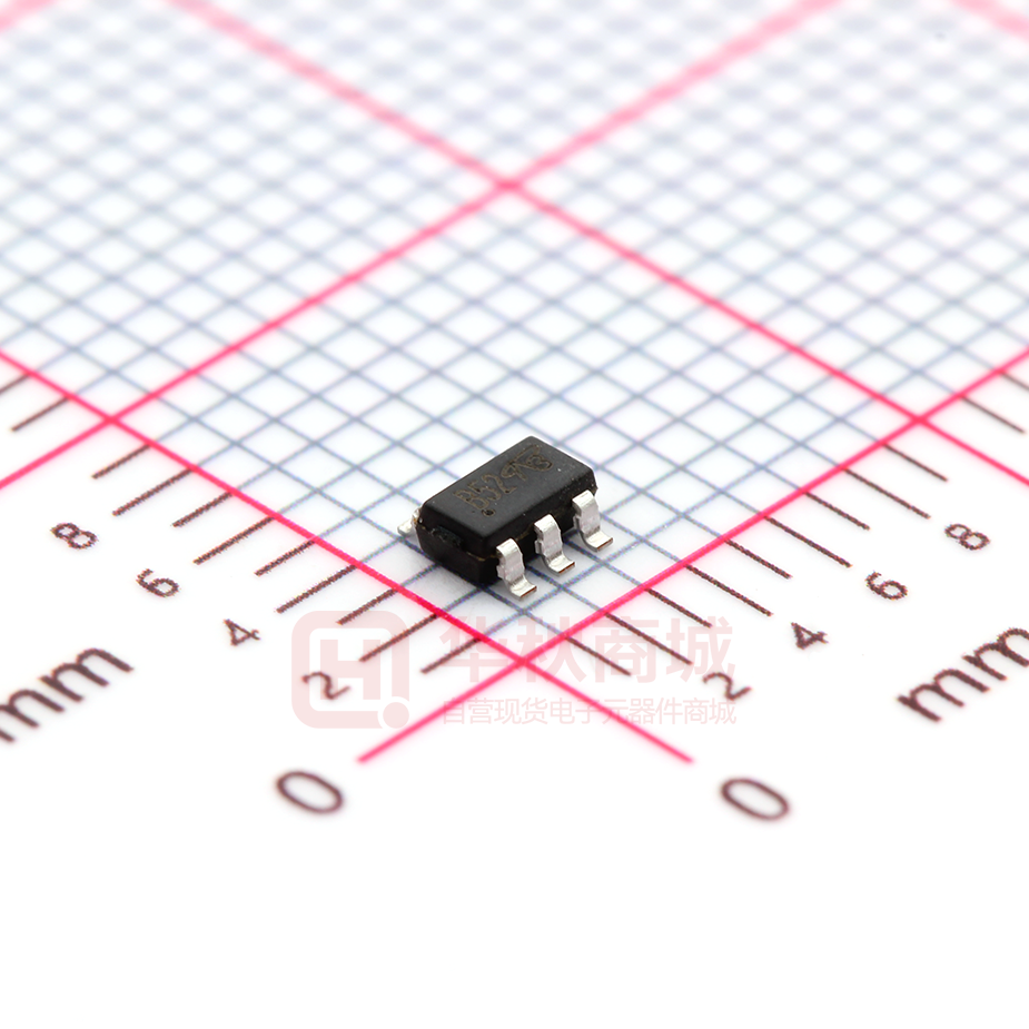

AO6601 www.VBsemi.tw N- and P-Channel 2 0 V (D-S) MOSFET FEATURES PRODUCT SUMMARY VDS (V) N-Channel P-Channel 20 - 20 RDS(on) (Ω) ID (A) 0.024 at VGS = 10 V 5.5 0.036 at VGS = 4.5 V 4.2 0.069 at VGS = - 10 V - 3.4 0.083 at VGS = - 4.5 V - 2.5 • Halogen-free According to IEC 61249-2-21 Definition • TrenchFET® Power MOSFET • 100 % Rg Tested • Compliant to RoHS Directive 2002/95/EC S2 D1 TSOP-6 Top View 3 mm G1 1 6 D1 S2 2 5 S1 G2 3 4 D2 G2 G1 S1 D2 N-Channel MOSFET P-Channel MOSFET 2.85 mm ABSOLUTE MAXIMUM RATINGS TA = 25 °C, unless otherwise noted Parameter Symbol N-Channel P-Channel Drain-Source Voltage VDS 20 - 20 Gate-Source Voltage VGS ± 20 ± 20 5.5 - 3.4 Continuous Drain Current (TJ = 150 °C)a, b TA = 25 °C TA = 70 °C Pulsed Drain Current Continuous Source Current (Diode Conduction)a, b Maximum Power Dissipationa, b TA = 25 °C TA = 70 °C Operating Junction and Storage Temperature Range ID 4.0 - 2.3 IDM 15 10 IS 1.05 A W 0.73 TJ, Tstg V - 1.05 1.15 PD Unit - 55 to 150 °C THERMAL RESISTANCE RATINGS Parameter Maximum Junction-to-Ambienta Maximum Junction-to-Lead Symbol t≤5s Steady State Steady State RthJA RthJL Typical Maximum 93 110 130 150 75 90 Unit °C/W Notes: a. Surface Mounted on FR4 board. b. t ≤ 5 s. E-mail:China@VBsemi TEL:86-755-83251052 1 AO6601 www.VBsemi.tw SPECIFICATIONS TJ = 25 °C, unless otherwise noted Parameter Symbol Test Conditions Min. Typ. Max. Unit Static Gate Threshold Voltage Gate-Body Leakage Zero Gate Voltage Drain Current On-State Drain Currenta Drain-Source On-State Resistancea Forward Transconductancea Diode Forward Voltagea VGS(th) N-Ch 0.6 P-Ch - 0.7 VDS = 0 V, VGS = ± 20 V IGSS IDSS VDS = VGS, ID = 250 µA VDS = VGS, ID = - 250 µA V N-Ch ± 100 P-Ch ± 100 VDS = 24 V, VGS = 0 V N-Ch 1 VDS = - 24 V, VGS = 0 V P-Ch -1 VDS = 24 V, VGS = 0 V, TJ = 55 °C N-Ch 5 VDS = - 24 V, VGS = 0 V, TJ = 55 °C P-Ch VDS = 5 V, VGS = 10 V N-Ch VDS = - 5 V, VGS = - 10 V P-Ch ID(on) RDS(on) gfs VSD nA µA -5 3.7 A -3 VGS = 10 V, ID = 2.5 A N-Ch 0.022 0.024 VGS = - 10 V, ID = - 1.8 A P-Ch 0.055 0.069 VGS = 4.5 V, ID = 2.0 A N-Ch 0.030 0.036 VGS = - 4.5 V, ID = - 1.2 A P-Ch 0.079 0.083 VDS = 10 V, ID = 2.5 A N-Ch 4.3 VDS = - 15 V, ID = - 1.8 A P-Ch 2.4 IS = 1.05 A, VGS = 0 V N-Ch 0.81 1.10 IS = - 1.05 A, VGS = 0 V P-Ch - 0.83 - 1.10 Ω S V Dynamicb Total Gate Charge Qg Gate-Source Charge Qgs Gate-Drain Charge Qgd Gate Resistance Rg Turn-On Delay Time Rise Time Turn-Off Delay Time N-Channel VDS = 15 V, VGS = 5 V, ID = 1.8 A P-Channel VDS = - 15 V, VGS = - 5 V, ID = - 1.8 A td(on) N-Channel VDD = 15 V, RL = 15 Ω ID ≅ 1 A, VGEN = 10 V, Rg = 6 Ω tr td(off) Fall Time tf Source-Drain Reverse Recovery Time trr P-Channel VDD = - 15 V, RL = 15 Ω ID ≅ - 1 A, VGEN = - 10 V, Rg = 6 Ω N-Ch 2.1 3.2 P-Ch 2.4 3.6 N-Ch 0.7 P-Ch 0.9 N-Ch 0.7 P-Ch 0.8 nC N-Ch 0.5 2.4 P-Ch 3 11 N-Ch 7 P-Ch 8 12 N-Ch 9 14 18 Ω 11 P-Ch 12 N-Ch 13 20 P-Ch 12 18 N-Ch 5 8 P-Ch 7 11 IF = 1.05 A, dI/dt = 100 A/µs N-Ch 35 60 IF = - 1.05 A, dI/dt = 100 A/µs P-Ch 30 60 ns Notes: a. Pulse test; pulse width ≤ 300 µs, duty cycle ≤ 2 %. b. Guaranteed by design, not subject to production testing. Stresses beyond those listed under “Absolute Maximum Ratings” may cause permanent damage to the device. These are stress ratings only, and functional operation of the device at these or any other conditions beyond those indicated in the operational sections of the specifications is not implied. Exposure to absolute maximum rating conditions for extended periods may affect device reliability. E-mail:China@VBsemi TEL:86-755-83251052 2 AO6601 www.VBsemi.tw N-CHANNEL TYPICAL CHARACTERISTICS 25 °C, unless otherwise noted 5 10 TC = - 55 °C VGS = 10 V thru 5 V 3 4V 2 1 4 2 0 0 0 1 2 3 4 0 5 1 2 3 4 5 6 25 30 VDS - Drain-to-Source Voltage (V) VGS - Gate-to-Source Voltage (V) Output Characteristics Transfer Characteristics 300 0.05 250 0.04 VGS = 4.5 V C - Capacitance (pF) R DS(on) - On-Resistance (Ω) 125 °C 6 3V 2V 0.03 VGS = 10 V 0.02 0.01 Ciss 200 150 100 Coss 50 Crss 0 0.00 0 1 2 3 4 5 6 0 7 5 10 15 20 ID - Drain Current (A) VDS - Drain-to-Source Voltage (V) On-Resistance vs. Drain Current Capacitance 10 1.8 1.6 VDS = 15 V ID = 1.8 A 8 R DS(on) - On-Resistance (Normalized) VGS - Gate-to-Source Voltage (V) 25 °C 8 I D - Drain Current (A) I D - Drain Current (A) 4 6 4 VGS = 10 V ID = 2.5 A 1.4 1.2 1.0 0.8 2 0.6 0 0 1 2 3 Qg - Total Gate Charge (nC) Gate Charge E-mail:China@VBsemi TEL:86-755-83251052 4 0.4 - 50 - 25 0 25 50 75 100 125 150 TJ - Junction Temperature (°C) On-Resistance vs. Junction Temperature 3 AO6601 www.VBsemi.tw N-CHANNEL TYPICAL CHARACTERISTICS 25 °C, unless otherwise noted 0.10 10 R DS(on) - On-Resistance (Ω) I S - Source Current (A) ID = 2 A TJ = 150 °C 1 TJ = 25 °C 0.08 ID = 2.5 A 0.06 0.04 0.02 0.00 0.1 0 0.2 0.4 0.6 0.8 1.0 1.2 0 2 4 6 8 10 VSD - Source-to-Drain Voltage (V) VGS - Gate-to-Source Voltage (V) Source-Drain Diode Forward Voltage On-Resistance vs. Gate-to-Source Voltage 0.4 8 ID = 250 µA 0.2 0.0 Power (W) V GS(th) Variance (V) 6 - 0.2 4 - 0.4 2 - 0.6 - 0.8 - 50 0 - 25 0 25 50 75 100 125 150 0.01 0.1 TJ - Temperature (°C) 10 1 30 Time (s) Threshold Voltage Single Pulse Power (Junction-to-Ambient) 2 1 Normalized Effective Transient Thermal Impedance Duty Cycle = 0.5 Notes: 0.2 PDM 0.1 0.1 t1 0.05 t2 1. Duty Cycle, D = 0.02 t1 t2 2. Per Unit Base = RthJA = 130 °C/W 3. TJM - TA = PDMZthJA(t) 4. Surface Mounted Single Pulse 0.01 10 -4 10 -3 10 -2 10 -1 1 10 100 600 Square Wave Pulse Duration (s) Normalized Thermal Transient Impedance, Junction-to-Ambient E-mail:China@VBsemi TEL:86-755-83251052 4 AO6601 www.VBsemi.tw N-CHANNEL TYPICAL CHARACTERISTICS 25 °C, unless otherwise noted 2 Normalized Effective Transient Thermal Impedance 1 Duty Cycle = 0.5 0.2 0.1 0.1 0.05 0.02 Single Pulse 0.01 10 -4 10 -3 10 -2 10 -1 Square Wave Pulse Duration (s) 1 10 Normalized Thermal Transient Impedance, Junction-to-Foot P-CHANNEL TYPICAL CHARACTERISTICS 25 °C, unless otherwise noted 10 8 VGS = 10 V thru 7 V 6V TC = - 55 °C 5 I D - Drain Current (A) I D - Drain Current (A) 6 5V 4 3 4V 125 °C 4 2 1 2V 3V 0 0 1 0 2 3 5 4 0 1 2 3 4 5 VDS - Drain-to-Source Voltage (V) VGS - Gate-to-Source Voltage (V) Output Characteristics Transfer Characteristics 0.2 6 300 0.1 240 C - Capacitance (pF) R DS(on) - On-Resistance (Ω) 25 °C 0.09 VGS = 4.5 V 0.08 VGS = 10 V 0.07 Ciss 180 120 Coss 60 0.06 Crss 0.0 0 0 1 2 3 4 5 6 7 0 6 12 18 24 ID - Drain Current (A) VDS - Drain-to-Source Voltage (V) On-Resistance vs. Drain Current Capacitance E-mail:China@VBsemi TEL:86-755-83251052 30 5 AO6601 www.VBsemi.tw P-CHANNEL TYPICAL CHARACTERISTICS 25 °C, unless otherwise noted 1.8 VDS = 15 V ID = 1.8 A VGS = 10 V ID = 1.8 A 1.6 8 R DS(on) - On-Resistance (Normalized) V GS - Gate-to-Source Voltage (V) 10 6 4 1.4 1.2 1.0 0.8 2 0.6 0.4 - 50 0 0 1 2 3 4 5 - 25 0 5 50 75 100 125 150 TJ - Junction Temperature (°C) Qg - Total Gate Charge (nC) On-Resistance vs. Junction Temperature Gate Charge 0.2 10 ID = 1.8 A R DS(on) - On-Resistance (Ω) I S - Source Current (A) 0.1 TJ = 150 °C 1 TJ = 25 °C ID = 1 A 0.09 0.08 0.07 0.06 0.0 0.1 0.00 0.3 0.6 0.9 1.2 0 1.5 4 6 8 10 VGS - Gate-to-Source Voltage (V) VSD - Source-to-Drain Voltage (V) On-Resistance vs. Gate-to-Source Voltage Source-Drain Diode Forward Voltage 0.6 8 0.4 6 0.2 Power (W) V GS(th) Variance (V) 2 ID = 250 µA 0.0 4 2 - 0.2 - 0.4 - 50 0 - 25 0 25 50 75 TJ - Temperature (°C) Threshold Voltage E-mail:China@VBsemi TEL:86-755-83251052 100 125 150 0.01 0.1 1 10 30 Time (s) Single Pulse Power (Junction-to-Ambient) 6 AO6601 www.VBsemi.tw P-CHANNEL TYPICAL CHARACTERISTICS 25 °C, unless otherwise noted 2 1 Normalized Effective Transient Thermal Impedance Duty Cycle = 0.5 Notes: 0.2 PDM 0.1 0.1 t1 0.05 t2 1. Duty Cycle, D = 0.02 t1 t2 2. Per Unit Base = RthJA = 130 °C/W 3. TJM - TA = PDMZthJA(t) 4. Surface Mounted Single Pulse 0.01 10 -4 10 -3 10 -2 10 -1 1 100 10 600 Square Wave Pulse Duration (s) Normalized Thermal Transient Impedance, Junction-to-Ambient 2 Normalized Effective Transient Thermal Impedance 1 Duty Cycle = 0.5 0.2 0.1 0.1 0.05 0.02 Single Pulse 0.01 10 -4 10 -3 10 -2 10 -1 Square Wave Pulse Duration (s) 1 10 Normalized Thermal Transient Impedance, Junction-to-Foot E-mail:China@VBsemi TEL:86-755-83251052 7 AO6601 www.VBsemi.tw TSOP: 5/6−LEAD JEDEC Part Number: MO-193C e1 e1 5 4 6 E1 1 2 5 4 E E1 1 3 2 3 -B- e b E -B- e 0.15 M C B A 5-LEAD TSOP b 0.15 M C B A 6-LEAD TSOP 4x 1 -A- D 0.17 Ref c R R A2 A L2 Gauge Plane Seating Plane Seating Plane 0.08 C L A1 -C- (L1) 4x 1 MILLIMETERS Dim A A1 A2 b c D E E1 e e1 L L1 L2 R Min Nom Max Min Nom Max 0.91 - 1.10 0.036 - 0.043 0.01 - 0.10 0.0004 - 0.004 0.90 - 1.00 0.035 0.038 0.039 0.30 0.32 0.45 0.012 0.013 0.018 0.10 0.15 0.20 0.004 0.006 0.008 2.95 3.05 3.10 0.116 0.120 0.122 2.70 2.85 2.98 0.106 0.112 0.117 1.55 1.65 1.70 0.061 0.065 0.067 0.95 BSC 0.0374 BSC 1.80 1.90 2.00 0.071 0.075 0.079 0.32 - 0.50 0.012 - 0.020 0.60 Ref 0.024 Ref 0.25 BSC 0.010 BSC 0.10 - - 0.004 - - 0 4 8 0 4 8 7 Nom 1 ECN: C-06593-Rev. I, 18-Dec-06 DWG: 5540 E-mail:China@VBsemi TEL:86-755-83251052 INCHES 7 Nom 8 AO6601 www.VBsemi.tw RECOMMENDED MINIMUM PADS FOR TSOP-6 0.099 0.039 0.020 0.019 (1.001) (0.508) (0.493) 0.064 (1.626) 0.028 (0.699) (3.023) 0.119 (2.510) Recommended Minimum Pads Dimensions in Inches/(mm) E-mail:China@VBsemi TEL:86-755-83251052 9 AO6601 www.VBsemi.tw Disclaimer All products due to improve reliability, function or design or for other reasons, product specifications and data are subject to change without notice. Taiwan VBsemi Electronics Co., Ltd., branches, agents, employees, and all persons acting on its or their representatives ( collectively, the "Taiwan VBsemi"), assumes no responsibility for any errors, inaccuracies or incomplete data contained in the table or any other any disclosure of any information related to the product.(www.VBsemi.tw) Taiwan VBsemi makes no guarantee, representation or warranty on the product for any particular purpose of any goods or continuous production. To the maximum extent permitted by applicable law on Taiwan VBsemi relinquished: ( 1) any application and all liability arising out of or use of any products; ( 2) any and all liability, including but not limited to special, consequential damages or incidental ; ( 3) any and all implied warranties, including a particular purpose, non-infringement and merchantability guarantee. Statement on certain types of applications are based on knowledge of the product is often used in a typical application of the general product VBsemi Taiwan demand that the Taiwan VBsemi of. Statement on whether the product is suitable for a particular application is non-binding. It is the customer's responsibility to verify specific product features in the products described in the specification is appropriate for use in a particular application. Parameter data sheets and technical specifications can be provided may vary depending on the application and performance over time. All operating parameters, including typical parameters must be made by customer's technical experts validated for each customer application. Product specifications do not expand or modify Taiwan VBsemi purchasing terms and conditions, including but not limited to warranty herein. Unless expressly stated in writing, Taiwan VBsemi products are not intended for use in medical, life saving, or life sustaining applications or any other application. Wherein VBsemi product failure could lead to personal injury or death, use or sale of products used in Taiwan VBsemi such applications using client did not express their own risk. Contact your authorized Taiwan VBsemi people who are related to product design applications and other terms and conditions in writing. The information provided in this document and the company's products without a license, express or implied, by estoppel or otherwise, to any intellectual property rights granted to the VBsemi act or document. Product names and trademarks referred to herein are trademarks of their respective representatives will be all. Material Category Policy Taiwan VBsemi Electronics Co., Ltd., hereby certify that all of the products are determined to be R oHS compliant and meets the definition of restrictions under Directive of the European Parliament 2011/65 / EU, 2011 Nian. 6. 8 R i Yue restrict the use of certain hazardous substances in electrical and electronic equipment (EEE) - modification, unless otherwise specified as inconsistent.(www.VBsemi.tw) Please note that some documents may still refer to Taiwan VBsemi RoHS Directive 2002/95 / EC. We confirm that all products identified as consistent with the Directive 2002/95 / EC European Directive 2011/65 /. Taiwan VBsemi Electronics Co., Ltd. hereby certify that all of its products comply identified as halogen-free halogen-free standards required by the JEDEC JS709A. Please note that some Taiwanese VBsemi documents still refer to the definition of IEC 61249-2-21, and we are sure that all products conform to confirm compliance with IEC 61249-2-21 standard level JS709A. E-mail:China@VBsemi TEL:86-755-83251052 10

物料型号:AO6601 器件简介:N-Channel和P-Channel V (D-S) MOSFET 引脚分配:TSOP-6封装,引脚1为G1 (N-Channel MOSFET Gate),引脚3为S1 (N-Channel MOSFET Source),引脚5为D1 (N-Channel MOSFET Drain);引脚2为G2 (P-Channel MOSFET Gate),引脚4为S2 (P-Channel MOSFET Source),引脚6为D2 (P-Channel MOSFET Drain) 参数特性:N-Channel VDs范围20V,RDS(on)在VGs=10V时为0.024欧姆;P-Channel VDs范围-20V,RDS(on)在VGs=-10V时为0.069欧姆 功能详解:TrenchFET® Power MOSFET,100% Rg测试,符合RoHS指令2002/95/EC,无卤素 应用信息:适用于需要N-Channel和P-Channel MOSFET的应用,如电源管理、电机控制等 封装信息:TSOP-6封装,详细尺寸和推荐最小焊盘尺寸在文档中有详细描述
