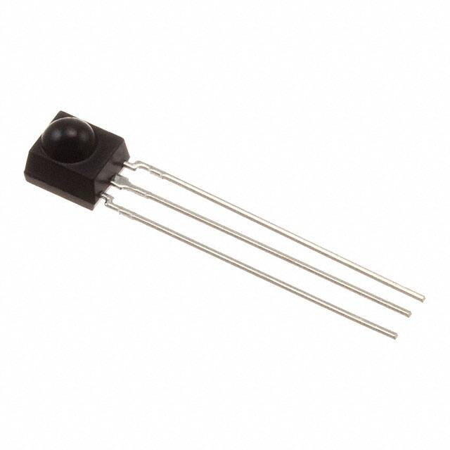

BRIGHT LED ELECTRONICS CORP. Specification for Approval SAMPLES  ATTACHED AREA  ● DEVICE NUMBER: BRM-2508 ● CUSTOMER: PAGE DATE 2016/5/17 1 2 3 4 5 1.0 1.0 1.0 1.0 1.0 6 7 CONTENTS 1.0 1.0 Initial Released FOR CUSTOMER’S APPROVAL STAMP OR SIGNATURE APPROVED PURCHASE MANUFACTURE ISSUED QUALITY APPROVED ENGINEERING PREPARED 張 郭 莫 2016.05.17 2016.05.17 2016.05.17 孝 嚴 初 榮 銳 明 BRIGHT LED ELECTRONICS CORP. BRM-2508 INFRARED RECEIVER MODULE ● Description Receivers for remote control and other applications 0.25 ●Package Dimensions: 1. The BRM-2508 is miniaturized infrared 6 5.35 5.48 R2 0.4 assembled on a single lead frame. 5.6 2. The separate PIN diode and preamplifier IC are 8.18 6.95 requiring improved ambient light rejection. .5 3. The epoxy package contains a special IR filter. 28.0±0.5 4. This module has excellent performance even in disturbed ambient light applications and provides protection against uncontrolled output pulses. 1. Photo detector and preamplifier in one package . 2. Internal filter for PCM frequency. 3. High immunity against ambient light. 4. Improved shielding against electric field disturbance. 5. 2.7V or 5.5V supply voltage; low power consumption. 6. TTL and CMOS compatibility. 7. Suitable transmission code:NEC code,RC5 code. 2.54 6 5.66 3.9 2.6 2.2 0.14 2.54 ● Features 0.28 marking area 0.4 6.95 6.53 ? 2.5 2.2 3.9 8. This product doesn't contain restriction 0.4 substance, comply ROHS standard NOTES: ● Applications: 1.All dimensions are in millimeters (inches). 1. It can be used for TVs、VTRs、audio equipment 2.Tolerance is ±0.25mm (0.01’’) unless otherwise specified. 3.Specifications are subject to change without notice. air conditioners、 car stereo radio、toys、 home computers and all other equipment requiring remote control. ● BLOCK DIAGRAM Vcc Preamp Amp Vout Limiter B.P.F Demodulator Integrator PD Comparator GND ABLC Ver:1.0 Page 1 of 7 BRIGHT LED ELECTRONICS CORP. BRM-2508  Absolute Maximum Ratings(Ta=25℃) Parameter Symbol Ratings Unit Notice Supply Voltage Vcc 2.7~5.5 V — Operating Temperature Topr -40~+85 ℃ — Storage Temperature Tstg -40~+85 ℃ — Soldering Temperature Tsol 260 ℃ 4mm from mold body less than 5 sec  Electrical And Optical Characteristics(Ta=25℃) Parameter Ratings Typ. Max. Symbol Condition Supply Voltage Vcc DC voltage 2.7 — 5.5 V Supply Current Icc No signal input(Vcc=3V) No signal input(Vcc=5V) — 0.9 1.0 1.5 1.5 mA Set-top box 12 20 — Reception Distance Min. L Unit m Electricity meter 3 6 — B.P.F Center Frequency fo — — 38 — KHz Peak Wavelength λp — — 940 — nm Half Angle θ — — 45 — deg High Level Pulse Width TH Specified by the output TH period within a range from 10cm to the arrival distance (average value of 50 pulses) 400 — 800 (S Low Level Pulse Width TL Specified by the output TL period within a range from 10cm to the arrival distance (average value of 50 pulses) 400 — 800 (S High Level Output Voltage VH 10cm over the ray axis 4.5 — — V Low Level Output Voltage VL 10cm over the ray axis — — 0.5 V Ver:1.0 Page 2 of 7 BRIGHT LED ELECTRONICS CORP. BRM-2508  Application Circuit 100Ω IRM Infrared Emitting Diode +5V Vcc Out 4.7uF uC GND GND Fig.1 Transmitter Wave Form Transmitter Output D.U.T Output Pulse VH TL TH VL 600us 600us Fig.3 Measuring System Fig.2 Measuring Method Measuring Method 20cm >10kΩ 5.0±0.1V Vcc + 10uF Standard Transmitter 100kΩ Standard Transmitter GND D.U.T Vout Vout Vout Oscilloscope Oscilloscope Ver:1.0 Page 3 of 7 BRIGHT LED ELECTRONICS CORP. BRM-2508  Electrical And Optical Curves(Ta=25℃) Fig.5 Relative Transmission Distance vs. Direction Fig.4 Relative Spectral Sensitivity vs. Wavelength (%) 1.2 0 10 20 30 Relative Responsitibity 1.0 0.8 1.0 40 0.6 0.9 50 0.4 0.8 60 0.2 0.7 70 80 90 0 750 850 1050 950 0.5 1150 (nm) 0.1 0.2 0.6 0.4 Relative Transmission Distance Wavelength Fig.6 Output Pulse Diagram (mS) 1.0 0.3 (mA) 2.0 Fig.7 Supply Current vs. Ambient Temperature 1.8 0.8 1.6 1.4 Supply Current Ton ,Toff -Output Pulse Length on 0.6 off 0.4 0.2 1.2 1.0 0.8 0.6 0.4 =950nm,Optical Test Signal,Fig.8 0.2 0.0 0.1 1 10 100 1000 10000 (mW/cm ) 0.0 2 -30 0 30 90 (° C) 60 Ambient Temperature Irradiance Fig.9 Arrival Distance Vs. Ambient Temperature Fig.8 Frequency Dependence of Responsivity (m) 20 0.8 16 Transmission Distance 1.0 Rel. Responsitivity 0.6 0.4 0.2 0 12 8 4 0 0.0 0.7 0 0.8 0.9 1.0 1.1 Relative Frequency 1.2 1.3 -40 -20 0 20 40 60 80 100 (° C) Ambient Temperature Ver:1.0 Page 4 of 7 BRIGHT LED ELECTRONICS CORP. BRM-2508 ● Dip Soldering TEMPERATURE( °C) 300 Max:260℃,5sec. Suggest:2~3sec. 250 200 150 100 Fluxing 50 30 Preheat 10 20 30 40 50 60 70 80 90 100 110 120 TIME(sec.) 1. Please avoid any external stress applied to the lead-frames and epoxy while the LEDs are at high temperature, especially during soldering 2. DIP soldering and hand soldering should not be done more than one time. 3. After soldering, avoid the epoxy lens from mechanical shock or vibration until the LEDs are back to room temperature. 4. Avoid rapid cooling during temperature ramp-down process 5. Although the soldering condition is recommended above, soldering at the lowest possible temperature is feasible for the LEDs ● IRON Soldering A:Max:350℃ Within 3 sec. One time only. B:The products of 3mm without flange, welding condition of flat plate PCB Max: 3.0(.118) 350℃ Within 2 sec. One time only PCB Ver:1.0 Page 5 of 7 BRIGHT LED ELECTRONICS CORP. BRM-2508  Packaging Box Dimensions  Packaging Bag Dimensions Notes: 1、250pcs per bag, 3Kpcs per box. 2、All dimensions are in millimeters(inches). 3、Specifications are subject to change without notice. Ver:1.0 Page 6 of 7 BRIGHT LED ELECTRONICS CORP. BRM-2508 Precautions for use: 1.Since the device is static sensitive,it is requested that anti-static measures should be taken on human body,all devices (including soldering iron) and equipment, machinery, desk and ground; 2. Do not supply unnecessary stress to lead; 3. Please pay careful attention to the lens of receivers, It might has a chace to miss-function when the lens get dust or dirty. And also please do not touch the lens. Ver:1.0 Page 7 of 7
