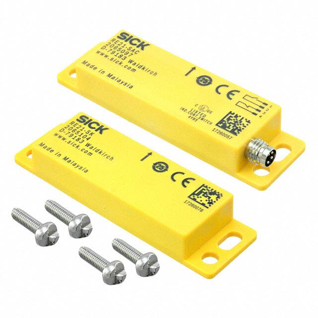

Product data sheet RE23-SAC RE2 NON-CONTACT SAFETY SWITCHES RE23-SAC | RE2 NON-CONTACT SAFETY SWITCHES A B C D E F H I J K L M N O P Q R S T Ordering information Type Part no. RE23-SAC 1059508 Other models and accessories www.sick.com/RE2 Detailed technical data Features System part Sensor with actuator Sensor principle Magnetic Number of N/O contacts 2 Number of N/C contacts 0 Number of signaling contacts 0 Safe switch on distance Sao 9 mm Safe switch off distance Sar 22 mm Active sensor surfaces 1 Actuation directions 3 Safety-related parameters B10d parameter 2 x 107 switching cycles (with small load) Type Type 4 (EN ISO 14119) Actuator coding level Low coding level (EN ISO 14119) Safe state in the event of a fault The switch has no internal fault detection and is unable to assume a safe state in the event of a fault. Fault detection is performed by the connected safety-related logic unit. Functions Safe series connection With Flexi Loop (with diagnostics) Interfaces Connection type Plug connector, M8, 4-pin Electrical data Type of output Reed contacts Switching voltage ≤ 30 V DC Switching current ≤ 100 mA Mechanical data Design Rectangular Dimensions (W x H x D) 25 mm x 88 mm x 13 mm Weight 0.1 kg 2 SAFETY SWITCHES | SICK Product data sheet | 2021-12-01 17:25:54 Subject to change without notice RE23-SAC | RE2 NON-CONTACT SAFETY SWITCHES Housing material Glass-fiber reinforced PPS Ambient data Enclosure rating IP67 (IEC 60529) Ambient operating temperature –20 °C ... +60 °C Storage temperature –20 °C ... +60 °C Vibration resistance 10 Hz ... 55 Hz, 1 mm (EN 60947-5-3) Shock resistance 30 g, 11 ms (EN 60947-5-3) Classifications ECl@ss 5.0 27272402 ECl@ss 5.1.4 27272402 ECl@ss 6.0 27272402 ECl@ss 6.2 27272402 ECl@ss 7.0 27272402 ECl@ss 8.0 27272402 ECl@ss 8.1 27272402 ECl@ss 9.0 27272402 ECl@ss 10.0 27272402 ECl@ss 11.0 27272402 ETIM 5.0 EC002544 ETIM 6.0 EC002544 ETIM 7.0 EC002544 ETIM 8.0 EC002544 UNSPSC 16.0901 39122205 Dimensional drawing (Dimensions in mm (inch)) 87.5 (3.44) 7.2 ±0.25 (0.28 ±0.01) 67.5 2.5 M8 (0.1) 13 (0.51) (2.66) 6 (0.2) (0.24) 9.5 (0.37) 12 5 (0.47) 7.2 (0.28) 25 (0.98) (0.31) 5.5 (0.22) 78 ±0.1 (3.07 ±0.004) 2021-12-01 17:25:54 | Product data sheet  Subject to change without notice SAFETY SWITCHES | SICK 3 RE23-SAC | RE2 NON-CONTACT SAFETY SWITCHES RE23 Y X Direction of approach Z Y -20 -15 Alignment marking 5 20 15 10 5 51 01 52 0 Z 10 H I J K L M N O P Q R S T Response range 15 X A B C D E F -20 Switch-on range Switch-off range Pin assignment REx3: sensor connections (plug M8) BN 2 4 WH BU 1 3 BK 1 BN 2 WH 3 BU N/O contact N/O contact 4 BK Sensor timing Input behaviour a b Sequence to be monitored a b Output behaviour 4 SAFETY SWITCHES | SICK Product data sheet | 2021-12-01 17:25:54 Subject to change without notice RE23-SAC | RE2 NON-CONTACT SAFETY SWITCHES Recommended accessories Other models and accessories www.sick.com/RE2 Brief description Type Part no. Head A: female connector, M8, 4-pin, straight, A-coded Head B: Flying leads Cable: Sensor/actuator cable, PVC, unshielded, 2 m YF8U14-020VA3XLEAX 2095888 Head A: female connector, M8, 4-pin, straight, A-coded Head B: Flying leads Cable: Sensor/actuator cable, PVC, unshielded, 5 m YF8U14-050VA3XLEAX 2095889 Head A: female connector, M8, 4-pin, straight, A-coded Head B: Flying leads Cable: Sensor/actuator cable, PVC, unshielded, 10 m YF8U14-100VA3XLEAX 2095890 • • • • • • Applications: Evaluation unit Compatible sensor types: Safety sensors with potential-free outputs Connection type: Front connector with spring terminals Restart interlock: yes External device monitoring (EDM): Integrated Outputs: 2 enabling current paths (safe), 2 application diagnostic outputs (not safe), 3 test pulse outputs (not safe) • Housing width: 18 mm RLY3-EMSS100 1085345 • • • • • • Applications: Evaluation unit Compatible sensor types: Safety sensors with potential-free outputs Connection type: Front connector with spring terminals Restart interlock: yes External device monitoring (EDM): Integrated Outputs: 3 enabling current paths (safe), 2 application diagnostic outputs (not safe), 3 test pulse outputs (not safe) • Housing width: 18 mm RLY3-EMSS300 1099973 • Applications: Evaluation unit for stop category 1 applications • Compatible sensor types: Safety sensors with OSSDs, safety sensors with potential-free outputs • Connection type: Front connector with spring terminals • Restart interlock: yes • External device monitoring (EDM): Integrated • Outputs: 2 enabling current paths (safe), 1 release-delayed enabling current path, for stop category 1 applications (safe), 2 application diagnostic outputs (not safe), 3 test pulse outputs (not safe) • Housing width: 18 mm RLY3-TIME100 1100688 Plug connectors and cables Safety relays ReLy 2021-12-01 17:25:54 | Product data sheet  Subject to change without notice SAFETY SWITCHES | SICK 5 Online data sheet SICK at a glance SICK is one of the leading manufacturers of intelligent sensors and sensor solutions for industrial applications. A unique range of products and services creates the perfect basis for controlling processes securely and efficiently, protecting individuals from accidents and preventing damage to the environment. We have extensive experience in a wide range of industries and understand their processes and requirements. With intelligent sensors, we can deliver exactly what our customers need. In application centers in Europe, Asia and North America, system solutions are tested and optimized in accordance with customer specifications. All this makes us a reliable supplier and development partner. Comprehensive services complete our offering: SICK LifeTime Services provide support throughout the machine life cycle and ensure safety and productivity. For us, that is “Sensor Intelligence.” Worldwide presence: Contacts and other locations – www.sick.com SICK AG | Waldkirch | Germany | www.sick.com
