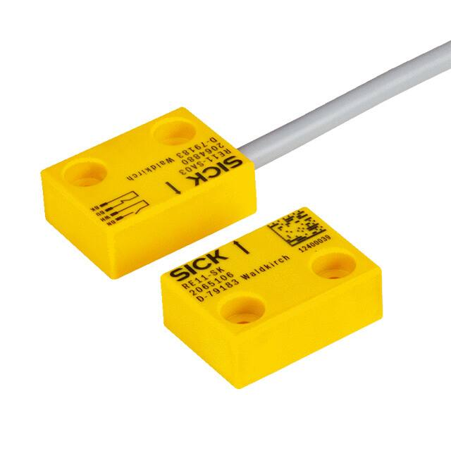

RE11-SA03 数据手册
Product data sheet RE11-SA03 RE1 NON-CONTACT SAFETY SWITCHES RE11-SA03 | RE1 NON-CONTACT SAFETY SWITCHES A B C D E F H I J K L M N O P Q R S T Ordering information Type Part no. RE11-SA03 1059411 Other models and accessories www.sick.com/RE1 Detailed technical data Features System part Sensor with actuator Sensor principle Magnetic Number of N/O contacts 1 Number of N/C contacts 1 Number of signaling contacts 0 Safe switch on distance Sao 3 mm Safe switch off distance Sar 12 mm Active sensor surfaces 1 Actuation directions 5 Safety-related parameters B10d parameter 2 x 107 switching cycles (with small load) Type Type 4 (EN ISO 14119) Actuator coding level Low coding level (EN ISO 14119) Safe state in the event of a fault The switch has no internal fault detection and is unable to assume a safe state in the event of a fault. Fault detection is performed by the connected safety-related logic unit. Functions Safe series connection None, only individual wiring (with diagnostics) Interfaces Connection type Cable Length of cable 3 m Cable material PVC Electrical data Type of output Reed contacts Switching voltage ≤ 30 V DC Switching current ≤ 400 mA Mechanical data Design 2 SAFETY SWITCHES | SICK Rectangular Product data sheet | 2021-12-01 17:25:54 Subject to change without notice RE11-SA03 | RE1 NON-CONTACT SAFETY SWITCHES Dimensions (W x H x D) 26 mm x 36 mm x 13 mm Weight 0.2 kg Housing material Glass-fiber reinforced PPS Ambient data Enclosure rating IP67 (IEC 60529) Ambient operating temperature –20 °C ... +60 °C Storage temperature –20 °C ... +60 °C Vibration resistance 10 Hz ... 55 Hz, 1 mm (EN 60947-5-3) Shock resistance 30 g, 11 ms (EN 60947-5-3) Classifications ECl@ss 5.0 27272402 ECl@ss 5.1.4 27272402 ECl@ss 6.0 27272402 ECl@ss 6.2 27272402 ECl@ss 7.0 27272402 ECl@ss 8.0 27272402 ECl@ss 8.1 27272402 ECl@ss 9.0 27272402 ECl@ss 10.0 27272402 ECl@ss 11.0 27272402 ETIM 5.0 EC002544 ETIM 6.0 EC002544 ETIM 7.0 EC002544 ETIM 8.0 EC002544 UNSPSC 16.0901 39122205 2021-12-01 17:25:54 | Product data sheet  Subject to change without notice SAFETY SWITCHES | SICK 3 RE11-SA03 | RE1 NON-CONTACT SAFETY SWITCHES Dimensional drawing (Dimensions in mm (inch)) 36 (1.42) 22 7 (0.33) 26.2 19.2 14 (0.55) (1.03) (0.28) (0.76) (0.23) 8.4 (0.87) Ø 5.8 Ø 4.5 13 5 (0.51) (0.18) (0.2) A B C D E F Ø 8.5 (0.33) H I J K L M N O P Q R S T Response range RE11 Y X Direction of approach Z -20 Alignment marking 5 10 Y 20 15 10 5 51 01 52 0 Z X 15 -20 Switch-on range Switch-off range Pin assignment BN 2 4 WH BU 1 3 BK 1 BN 2 WH 3 BU N/O contact N/C contact 4 BK 4 SAFETY SWITCHES | SICK Product data sheet | 2021-12-01 17:25:54 Subject to change without notice RE11-SA03 | RE1 NON-CONTACT SAFETY SWITCHES Sensor timing Input behaviour a b Sequence to be monitored a b Output behaviour 2021-12-01 17:25:54 | Product data sheet  Subject to change without notice SAFETY SWITCHES | SICK 5 Online data sheet SICK at a glance SICK is one of the leading manufacturers of intelligent sensors and sensor solutions for industrial applications. A unique range of products and services creates the perfect basis for controlling processes securely and efficiently, protecting individuals from accidents and preventing damage to the environment. We have extensive experience in a wide range of industries and understand their processes and requirements. With intelligent sensors, we can deliver exactly what our customers need. In application centers in Europe, Asia and North America, system solutions are tested and optimized in accordance with customer specifications. All this makes us a reliable supplier and development partner. Comprehensive services complete our offering: SICK LifeTime Services provide support throughout the machine life cycle and ensure safety and productivity. For us, that is “Sensor Intelligence.” Worldwide presence: Contacts and other locations – www.sick.com SICK AG | Waldkirch | Germany | www.sick.com
