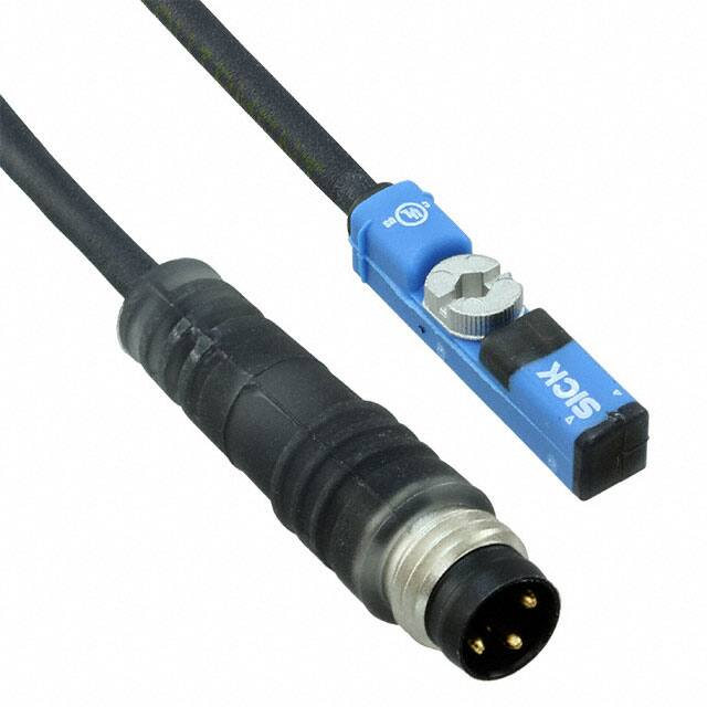

MZT8-19VPS-KP0 数据手册
Product data sheet MZT8-19VPS-KP0 MZT8 SENSORS FOR T-SLOT CYLINDERS MZT8-19VPS-KP0 | MZT8 SENSORS FOR T-SLOT CYLINDERS A B C D E F H I J K L M N O P Q R S T Ordering information Type Part no. MZT8-19VPS-KP0 1053014 Other models and accessories www.sick.com/MZT8 Detailed technical data Features Cylinder type T-slot Cylinder types with adapter Profile cylinder Tie rod cylinder Round body cylinder Dovetail groove cylinder SMC rail CDQ2 SMC rail ECDQ2 Housing length 24 mm Switching output PNP Switching frequency 1,000 Hz Output function NO Electrical wiring DC 3-wire Enclosure rating IP68 1) 1)  According to EN 60529 (IP 67 / IP 68). Mechanics/electronics Supply voltage 10 V DC ... 30 V DC Power consumption 10 mA 1) Voltage drop ≤ 2.2 V Continuous current Ia ≤ 200 mA Protection class III Time delay before availability 25 ms Response sensitivity, typ. 1.9 mT Overrun distance, typ. 9 mm Hysteresis, typ. 0.7 mT 1) 2) 2  Without load.  Ub and Ta constant. MAGNETIC CYLINDER SENSORS | SICK Product data sheet | 2021-11-27 09:08:39 Subject to change without notice MZT8-19VPS-KP0 | MZT8 SENSORS FOR T-SLOT CYLINDERS Reproducibility ≤ 0.1 mT 2) Reverse polarity protection ✔ Short-circuit protection ✔ Power-up pulse protection ✔ Ambient operating temperature –30 °C ... +80 °C Shock and vibration resistance 30 g, 11 ms / 10 ... 55 Hz, 1 mm EMC According to EN 60947-5-2 Connection type Cable with connector M8, 3-pin, drag chain use, 0.3 m Connection type Detail Conductor cross-section 0.14 mm² Cable diameter Ø 2.9 mm Bending radius With fixed installation > 3 x cable diameter For flexible use > 10 x cable diameter Torsion force ± 270° / 10 cm Torsion cycles > 2,000,000 Drag chain cycles > 2,000,000 Drag chain parameters Traversing speed max. 3.3 m/s at 5 m horizontal traversing length Acceleration max. 5 m/s² Cable outlet Axial Material Housing Plastic, PA12 Cable PUR UL File No. 1) 2) NRKH.E181493 & NRKH7.E181493  Without load.  Ub and Ta constant. Safety-related parameters MTTFD 2,289 years DCavg 0 % TM (mission time) 20 years Classifications ECl@ss 5.0 27270104 ECl@ss 5.1.4 27270104 ECl@ss 6.0 27270104 ECl@ss 6.2 27270104 ECl@ss 7.0 27270104 ECl@ss 8.0 27270104 ECl@ss 8.1 27270104 ECl@ss 9.0 27270104 ECl@ss 10.0 27270104 ECl@ss 11.0 27270104 ETIM 5.0 EC002544 ETIM 6.0 EC002544 2021-11-27 09:08:39 | Product data sheet  Subject to change without notice MAGNETIC CYLINDER SENSORS | SICK 3 MZT8-19VPS-KP0 | MZT8 SENSORS FOR T-SLOT CYLINDERS EC002544 ETIM 8.0 EC002544 UNSPSC 16.0901 39122230 Installation note Tighten screw Torque typical 0.4 Nm Insert sensor LED = Position sensor element Connection diagram Cd-002 BN 1 BK 4 BU 3 + (L+) NO - (M) Dimensional drawing (Dimensions in mm (inch)) Cable with connector M8 4 5.6 2 2 3 (2.2) H I J K L M N O P Q R S T ETIM 7.0 5 (1.97) 24 (9.45) 1 L Pin 4 M8 x 1 A B C D E F 29 ... 37 (1.14 ... 1.46) Pin 1 Pin 3 ①  Connection ②  Fixing screw SW 2.0 ③  Display LED ④  Sensor element position; short overrun distance (3 mm): 2 mm, long overrun distance (9 mm): 1.7 mm 4 Part no. Type L Number of cores 1121966 MZT8-03VPS-KPDS38 120 mm 3 MAGNETIC CYLINDER SENSORS | SICK Product data sheet | 2021-11-27 09:08:39 Subject to change without notice MZT8-19VPS-KP0 | MZT8 SENSORS FOR T-SLOT CYLINDERS Part no. Type L Number of cores 1044458 MZT8-03VPS-KP0 300 mm 3 1044930 MZT8-03VPO-KP0 300 mm 3 1044932 MZT8-03VNS-KP0 300 mm 3 1048048 MZT8-28VPS-KP0 300 mm 3 1053014 MZT8-19VPS-KP0 300 mm 3 1053415 MZT8-03VPS-KP0S06 300 mm 3 1054250 MZT8-28VPS-KP0S10 300 mm 3 1073268 MZT8-2V6PSTKP0 300 mm 3 1044461 MZT8-03VPS-KPD 750 mm 3 Recommended accessories Other models and accessories www.sick.com/MZT8 Brief description Type Part no. Mounting bracket for cylinder with dovetail slot, Aluminum, without mounting hardware BEF-KHZ-ST1 2022703 Mounting bracket for integrated profile cylinder/tie-rod cylinder, zinc diecast, mounting hardware included BEF-KHZ-PT1 2022702 1 piece, Mounting bracket on round body cylinder with piston diameter of 12 mm, ambient temperature min 0 °C max 50 °C, plastic, Aluminum BEF-KHZ-RT-12 2077681 1 piece, Mounting bracket on round body cylinder with piston diameter of 16 mm, ambient temperature min 0 °C max 50 °C, plastic, Aluminum BEF-KHZ-RT-16 2077680 1 piece, Mounting bracket on round body cylinder with piston diameter of 20 mm, ambient temperature min 0 °C max 50 °C, plastic, Aluminum BEF-KHZ-RT-20 2077679 1 piece, Mounting bracket on round body cylinder with piston diameter of 25 mm, ambient temperature min 0 °C max 50 °C, plastic, Aluminum BEF-KHZ-RT-25 2077678 1 piece, Mounting bracket on round body cylinder with piston diameter of 32 mm, ambient temperature min 0 °C max 50 °C, plastic, Aluminum BEF-KHZ-RT-32 2077677 1 piece, Mounting bracket on round body cylinder with piston diameter of 40 mm, ambient temperature min 0 °C max 50 °C, plastic, Aluminum BEF-KHZ-RT-40 2077676 1 piece, Mounting bracket on round body cylinder with piston diameter of 50 mm, ambient temperature min 0 °C max 50 °C, plastic, Aluminum BEF-KHZ-RT-50 2077675 1 piece, Mounting bracket on round body cylinder with piston diameter of 63 mm, ambient temperature min 0 °C max 50 °C, plastic, Aluminum BEF-KHZ-RT-63 2077674 1 piece, Mounting bracket on round body cylinder with piston diameter of 8 mm ... 130 mm, ambient temperature min –30 °C max 80 °C, stainless steel, Zinc cast BEF-KHZ-RT1-130 2077684 1 piece, Mounting bracket on round body cylinder with piston diameter of 8 mm ... 25 mm, ambient temperature min –30 °C max 80 °C, stainless steel, Zinc cast BEF-KHZ-RT1-25 2077682 1 piece, Mounting bracket on round body cylinder with piston diameter of 8 mm ... 63 mm, ambient temperature min –30 °C max 80 °C, stainless steel, Zinc cast BEF-KHZ-RT1-63 2077683 Brackets for cylinder sensors 2021-11-27 09:08:39 | Product data sheet  Subject to change without notice MAGNETIC CYLINDER SENSORS | SICK 5 MZT8-19VPS-KP0 | MZT8 SENSORS FOR T-SLOT CYLINDERS A B C D E F H I J K L M N O P Q R S T Brief description Type Part no. Mounting bracket for mounting on SMC rails CDQ2 (T-slot), Aluminum, without mounting hardware BEF-KHZ-TT2 2046440 Mounting bracket for mounting on SMC rails ECDQ2 (T-slot), Aluminum, without mounting hardware BEF-KHZ-TT1 2046439 BEF-SG-MRZT 2077201 Head A: female connector, M8, 3-pin, straight, A-coded Head B: Flying leads Cable: Sensor/actuator cable, PUR, halogen-free, unshielded, 2 m YF8U13020UA1XLEAX 2094782 Head A: female connector, M8, 3-pin, straight, A-coded Head B: Flying leads Cable: Sensor/actuator cable, PVC, unshielded, 2 m YF8U13020VA1XLEAX 2095860 Head A: female connector, M8, 3-pin, straight, A-coded Head B: Flying leads Cable: Sensor/actuator cable, PUR, halogen-free, unshielded, 5 m YF8U13050UA1XLEAX 2094788 Head A: female connector, M8, 3-pin, straight, A-coded Head B: Flying leads Cable: Sensor/actuator cable, PVC, unshielded, 5 m YF8U13050VA1XLEAX 2095884 Head A: female connector, M8, 3-pin, angled, A-coded Head B: Flying leads Cable: Sensor/actuator cable, PUR, halogen-free, unshielded, 2 m YG8U13020UA1XLEAX 2094794 Head A: female connector, M8, 3-pin, angled, A-coded Head B: Flying leads Cable: Sensor/actuator cable, PVC, unshielded, 2 m YG8U13020VA1XLEAX 2096165 Head A: female connector, M8, 3-pin, angled, A-coded Head B: Flying leads Cable: Sensor/actuator cable, PUR, halogen-free, unshielded, 5 m YG8U13050UA1XLEAX 2095586 Head A: female connector, M8, 3-pin, angled, A-coded Head B: Flying leads Cable: Sensor/actuator cable, PVC, unshielded, 5 m YG8U13050VA1XLEAX 2096166 Head A: female connector, M8, 3-pin, straight Head B: Cable: unshielded DOS-0803-G 7902077 Head A: female connector, M8, 3-pin, angled Head B: Cable: unshielded DOS-0803-W 7902078 Head A: male connector, M8, 3-pin, straight Head B: Cable: unshielded STE-0803-G 6037322 Device protection (mechanical) Protective adapter, die-cast zinc, mounting hardware included Plug connectors and cables 6 MAGNETIC CYLINDER SENSORS | SICK Product data sheet | 2021-11-27 09:08:39 Subject to change without notice Online data sheet SICK at a glance SICK is one of the leading manufacturers of intelligent sensors and sensor solutions for industrial applications. A unique range of products and services creates the perfect basis for controlling processes securely and efficiently, protecting individuals from accidents and preventing damage to the environment. We have extensive experience in a wide range of industries and understand their processes and requirements. With intelligent sensors, we can deliver exactly what our customers need. In application centers in Europe, Asia and North America, system solutions are tested and optimized in accordance with customer specifications. All this makes us a reliable supplier and development partner. Comprehensive services complete our offering: SICK LifeTime Services provide support throughout the machine life cycle and ensure safety and productivity. For us, that is “Sensor Intelligence.” Worldwide presence: Contacts and other locations – www.sick.com SICK AG | Waldkirch | Germany | www.sick.com
