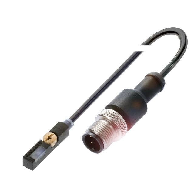

Magnetic Sensors BMF 235K-PS-C-2A-SA93-S4-00,3 Order Code: BMF00H5 1) Sensing surface, 2) see remarks, 3) see remarks, 4) see remarks Basic features Electrical data Application Approval/Conformity Pneumatic cylinder with T-slot. Assured switching field strength Ha 2 kA/m For dimensions, see sketch in Hysteresis H max. (% of Hn) 45 % product view. Load capacitance max. at Ue 1 µF cULus No-load current Io max., undamped 3 mA Operating voltage Ub 10...30 VDC Output resistance Ra Open drain Rated insulation voltage Ui 75 V DC Rated operating current Ie 200 mA Rated operating voltage Ue DC 24 V Rated short circuit current 100 A Rated switch field strength Hn 1.2 kA/m Residual current Ir max. 80 µA Ripple max. (% of Ue) 15 % Switching frequency 3000 Hz Turn-off delay toff max. 0.1 ms Turn-on delay ton max. 0.1 ms Utilization category DC -13 Voltage drop static max. 2.5 V CE WEEE EAC Basic standard IEC 60947-5-2 Principle of operation Magnetic field sensor Display/Operation Function indicator yes Electrical connection Cable PUR with silicone tube, 0.3 m Cable diameter D 4.00 mm Connection M12x1-Male, 4-pin, A-coded Polarity reversal protected yes Protection against device mix-ups no Short-circuit protection yes Internet Environmental conditions Ambient temperature -25...85 °C Contamination scale 3 EN 60068-2-27, Shock Half-sinus, 30 gn, 11 ms EN 60068-2-6, Vibration 55 Hz, amplitude 1 mm, 3x30 min ESD 3A(8KV) Emission Group 1, Class B IP rating IP67 www.balluff.com eCl@ss 9.1: 27-27-01-04 Subject to change without notice: 234180 ETIM 6.0: EC002544 BMF00H5_1.8_2021-06-21 1/3 Magnetic Sensors BMF 235K-PS-C-2A-SA93-S4-00,3 Order Code: BMF00H5 Interface Mechanical data Switching output PNP normally open (NO) Dimension 23.5 x 5 x 5.5 mm Mounting part can be installed in T-slot from above Material Tightening torque Housing material PA 12 Material jacket PUR, with silicone tube Material sensing surface PU 0.4 Nm Range/Distance Temp. drift max. (% of Hn) 0.3 % Remarks Damping magnet axially magnetized Effective operating current Ie with thermally coupled installation in metal. 4) Allen wrench 2.0 mm: max. tightening torque 0.4 Nm. Screw driver 4x0.8 mm: max. tightening torque 1 Nm 2) Application area: pneumatic cylinder with t-slot. For dimensions, see sketch in product view. UL-MARKINGS: - For use in NFPA 79 Applications only - Adapters providing field wiring means are available from the manufacturer. Refer to manufacturers information. Connector Drawings Wiring Diagrams Internet www.balluff.com eCl@ss 9.1: 27-27-01-04 Subject to change without notice: 234180 ETIM 6.0: EC002544 BMF00H5_1.8_2021-06-21 2/3 Magnetic Sensors BMF 235K-PS-C-2A-SA93-S4-00,3 Order Code: BMF00H5 Help Views Internet www.balluff.com eCl@ss 9.1: 27-27-01-04 Subject to change without notice: 234180 ETIM 6.0: EC002544 BMF00H5_1.8_2021-06-21 3/3
